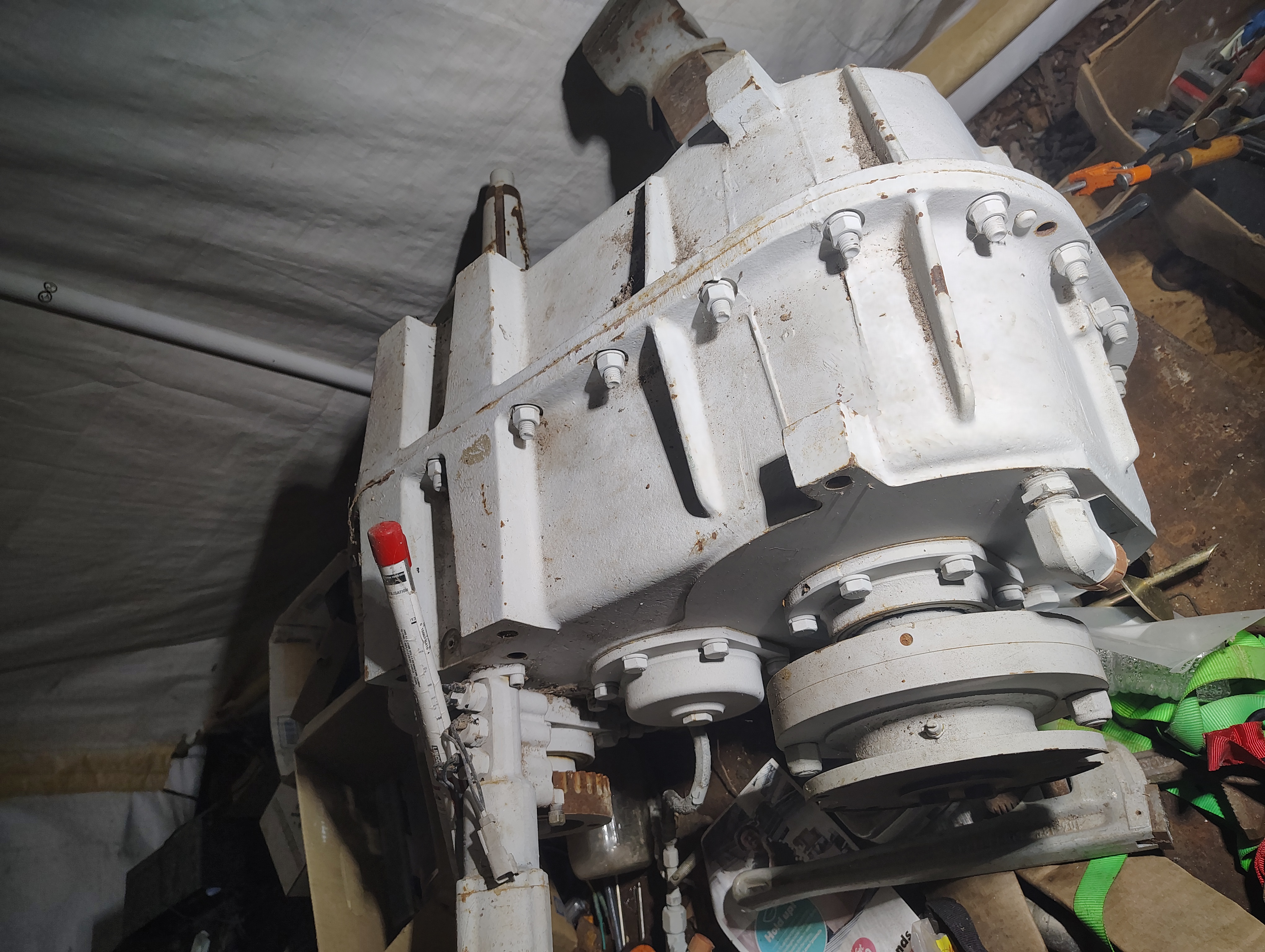

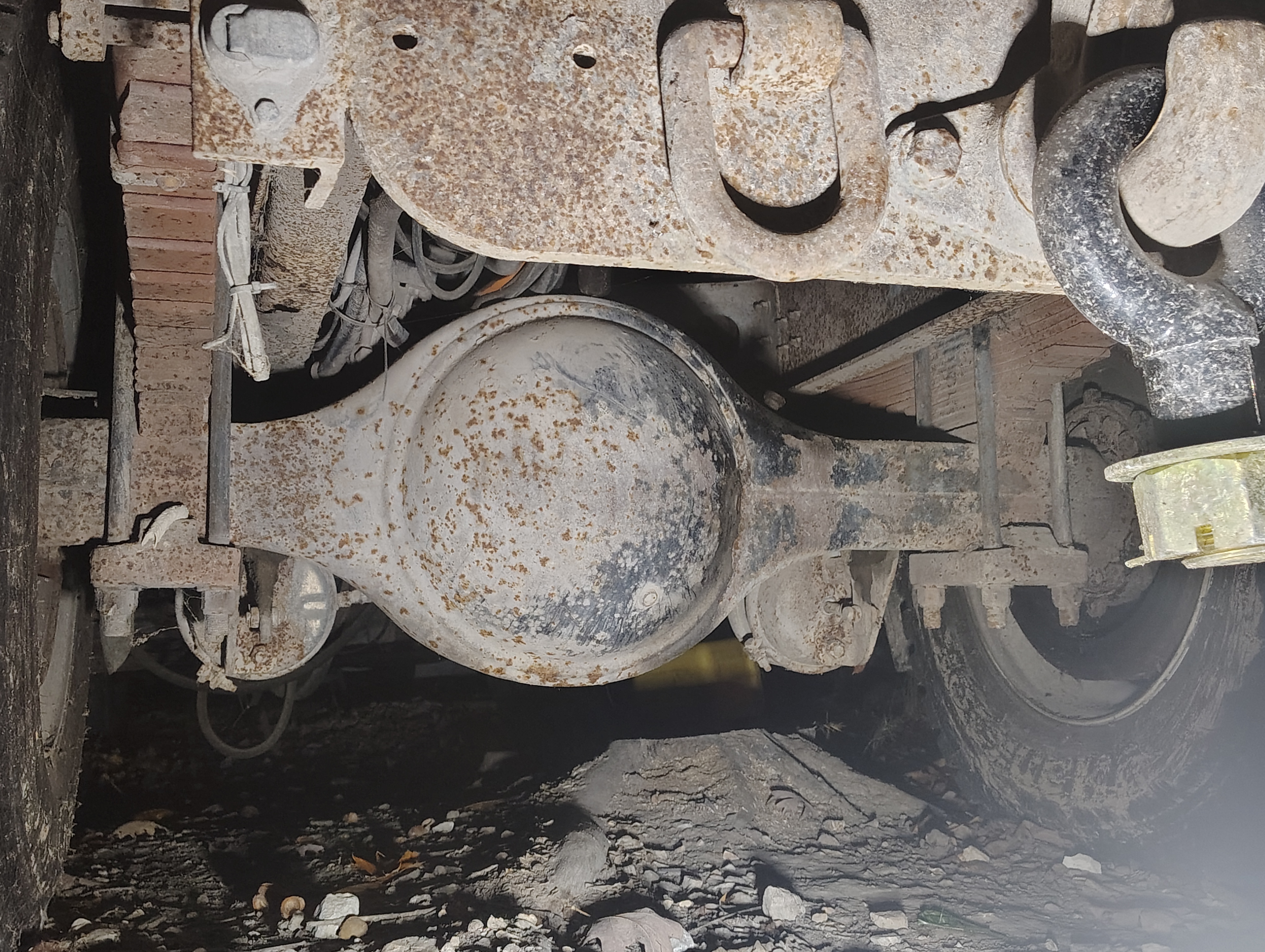

The Oshkosh 55000 transfer case that I have has a 0.99:1 high gear, 2.66:1 low gear, neutral, and an auto-locking center differential. Within the next few months, I plan to tear it down to start measuring parts and figuring out how I want/need to arrange them to adapt the Tesla motors to it.
The low gear in the t-case, combined with the TAK-4 6:1 ratio gets me 71mph at 9,000rpm. This also makes for 15,322ft.lbs. of peak torque, according to specs I'm getting from Westside EV. 1,272 peak HP as well. This is assuming that the peak 420 DC peak volts is correct.

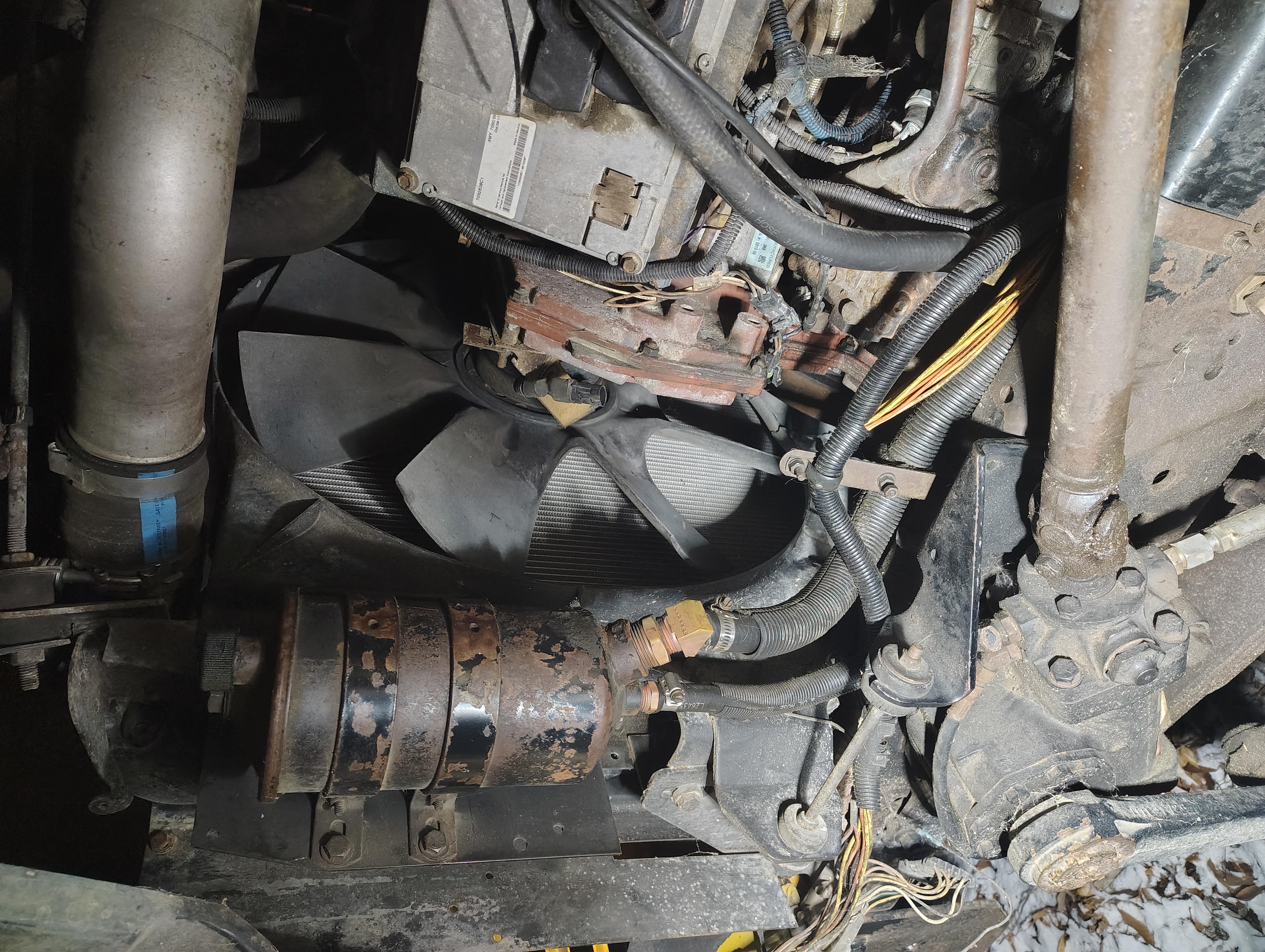

Cooling these shouldn't much much of an issue, once I figure out the plumbing and pumping. The radiator currently in the truck is a full-aluminum aftermarket unit. The radiator fan tends to draw 40-50hp. I'll be getting rid of that fan and add some electric fans.
