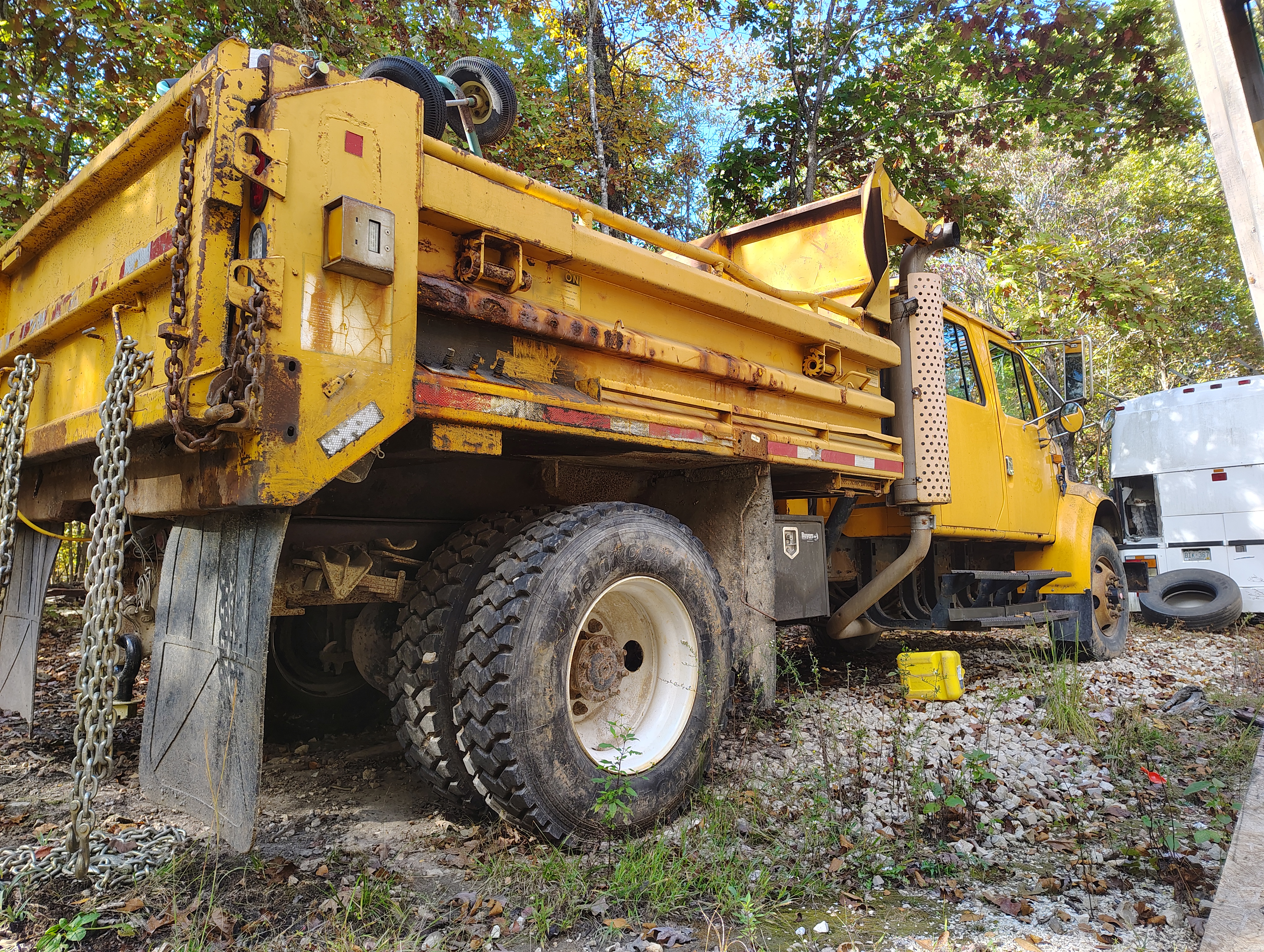

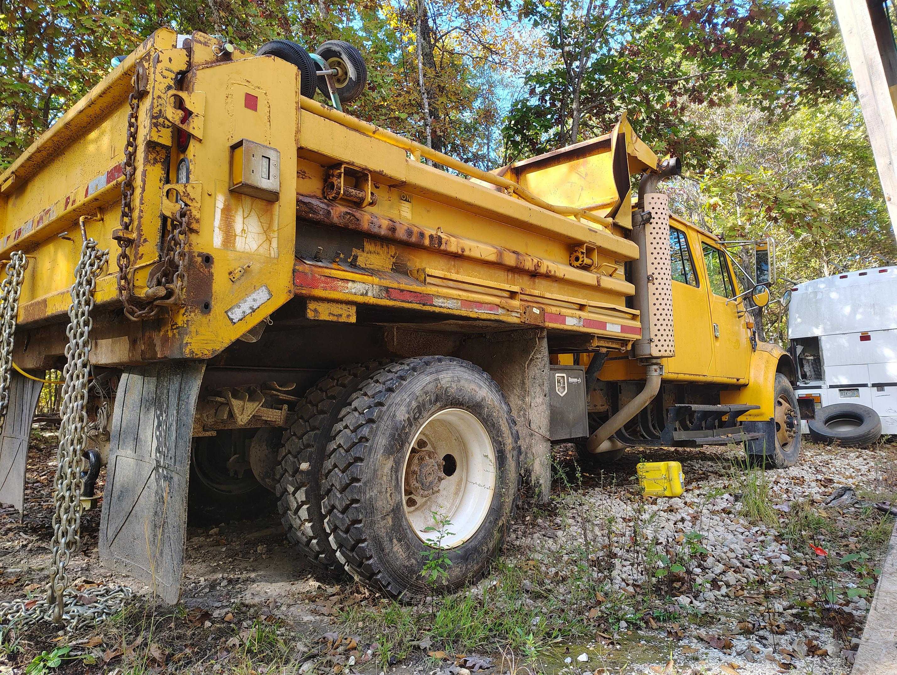

Hey, all. Quite new here. Decided to join and continue my progress with OI.
In the works is my 2002 International 4900 dump truck - formerly a MODOT salt truck. I'll post pictures as soon as I figure out how to.
Currently, it runs a DT466E that peaks at somewhere around 90kW, I believe.
Plans:
Tesla sport LDU as the drivetrain with the transaxle acting as the transfer case.
Fellten 4.1:1 gear swap
Qauife LSD
Driveshaft Shop CV axles adapted to Oshkosh driveshafts
Oshkosh TAK-4 axles front and rear with 6.0:1 final ratio
OpenInverter logic board (provided I can acquire one)
Winston LYP 200Ah cells for a 420v max traction pack. These can peak at 4kA
Viair 380C compressors for the air brakes
At this time, the truck weighs right around 9.5 tons unladen. I have eight of the Winston cells ordered. I'll be using them to start the diesel engine for the time being as the new lead acids batteries I had out in it a couple years ago are already worn down. Once I get the truck to start again, I'll work on selling off the diesel drivetrain to make room for the electric drivetrain.

Trying out image posting. Looks like I need to use third-party image hosting. Haven't done that in years.
- Posts: 1884
- Has thanked: 91 times
- Been thanked: 517 times
Re: Converting my dump truck
Could you please use the attach image function? imgurl is blocked in the UK

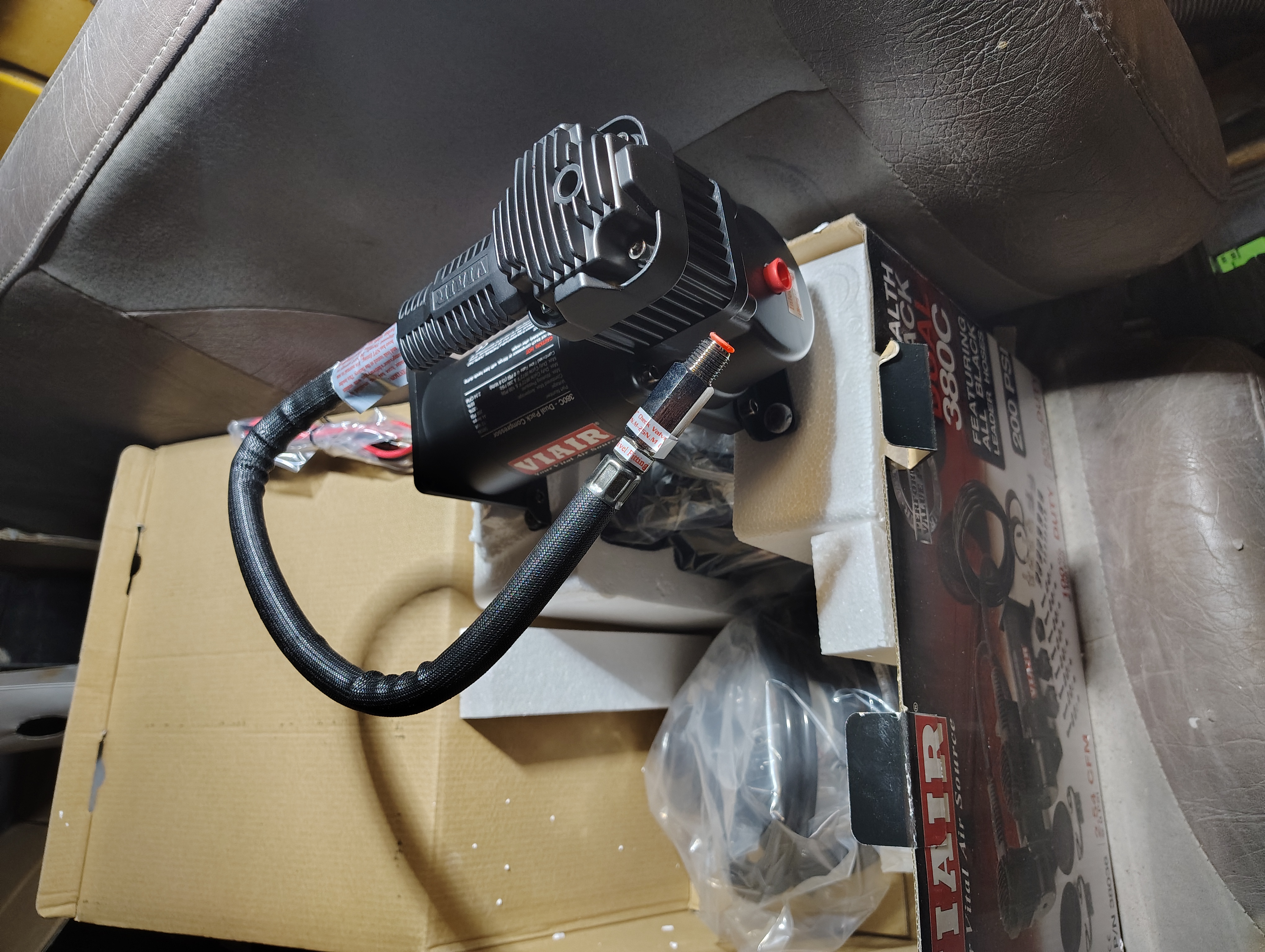

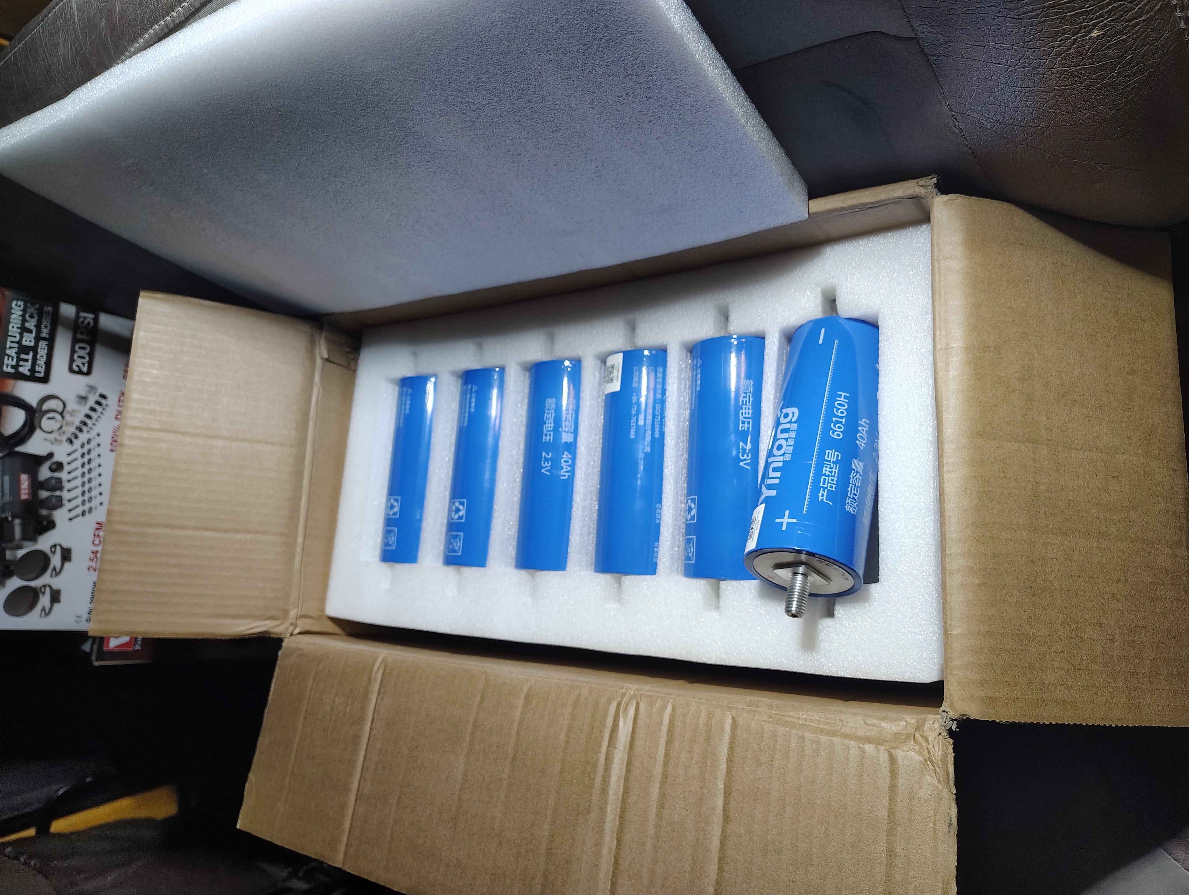

Some goodies came in a couple days ago.
Yinlong 40Ah LTO cells to make an 80Ah 12v battery. This will be for LED lighting, radio, maybe the air compressors, etc.
Set of four Viair 380C compressors to operate the air brakes and horn.

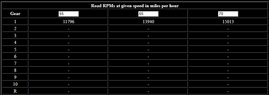

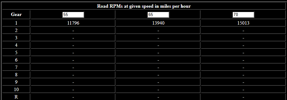

This is a maybe -
https://evwest.com/tesla-large-drive-un ... n-gear-set
480 peak ft. lbs x 4.5:1 LDU ratio x 6:1 Oshkosh TAK-4 ratio makes for 12,960 peak ft. lbs.
With those ratios, 70 mph at 15,013 rpm, 65 mph at 13.940 rpm, and 55 mph at 11,796 rpm. For the most part, I never drive this any faster than 55 mph as that's the speed limit for most rural highways.
I'll still be taking somewhere near 3,000 pounds off yet.
I'm still open to other motor and inverter suggestions. I wanted to support OI logic boards.
