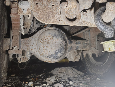

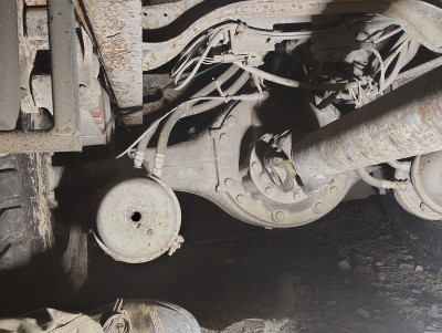

Do you have a picture of what the rear axle looks like currently?
I can't really see it in the picture of the back. May help think of different ideas. I was thinking 2 motors if it's split..

jrbe wrote: Sat Nov 22, 2025 12:20 am Do you have a picture of what the rear axle looks like currently?
I don't have much interest in making modifications to the current drive axle unless doing so costs much less.
If I remember correctly, it's a Meritor. My size 10-1/2 boot for reference.

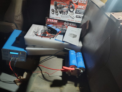

Keeping the build thread going.
Bus bars for the LTO cells showed up. Cleaned those up and fired up the EBC to top balance the cells. Wonder how long the three lead acids batteries in the truck will power this :D
Likely won't be until January that the first set of Winston 200Ah LYP cells show up. Once they do, they'll replace the lead acids. Hopefully they will encourage the engine to start again.

OI forum has been super buggy on my phone, so no pics. Got all the LTO cells balanced up and assembled into a 2p6s pack. Just need to finishing designing the case.
