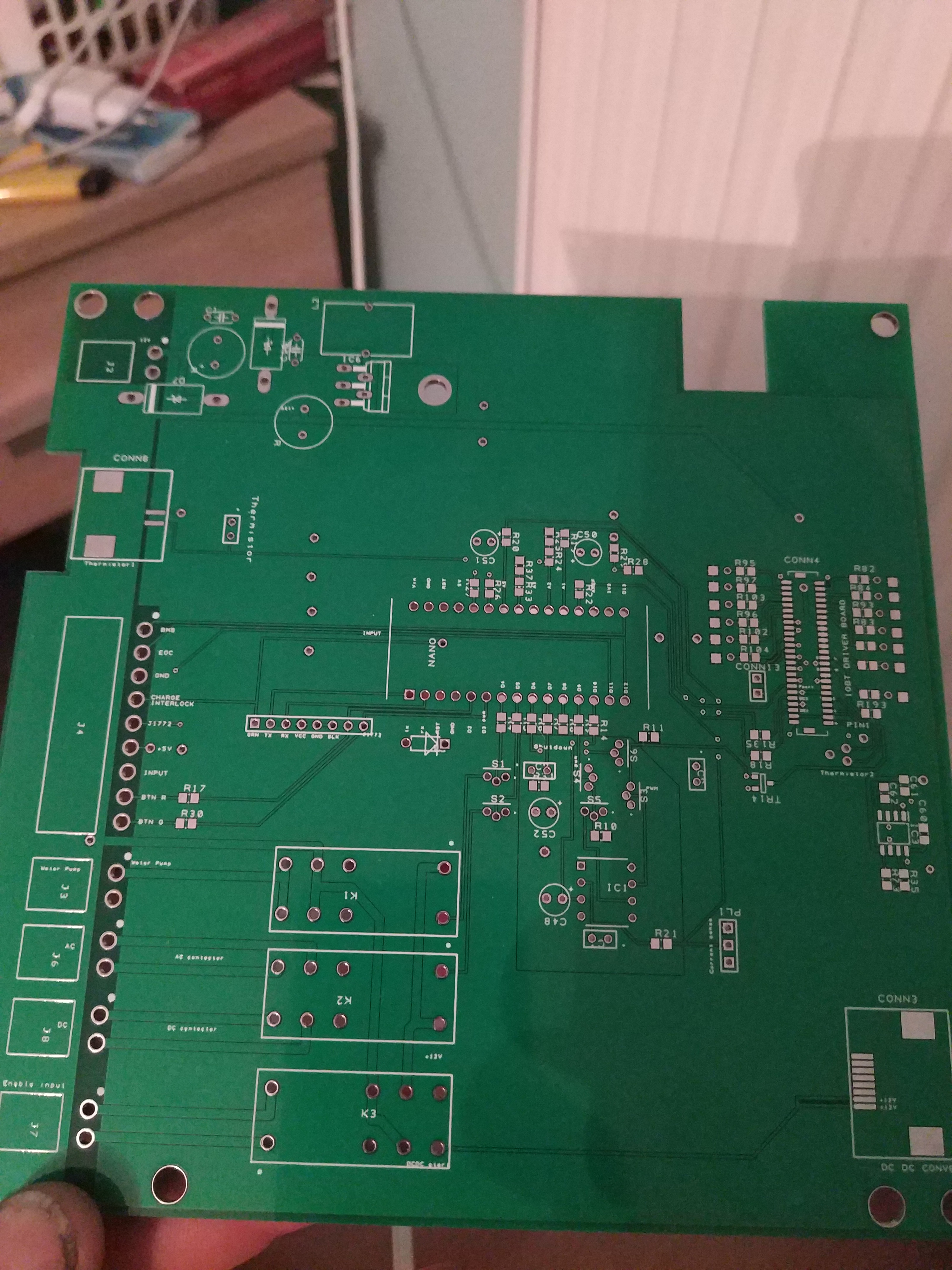

Hurah! I got the new boards from foundry. I need some time to assemble and make software corrections but i think Prius inverter will charge wirh EMW charger brain soon.

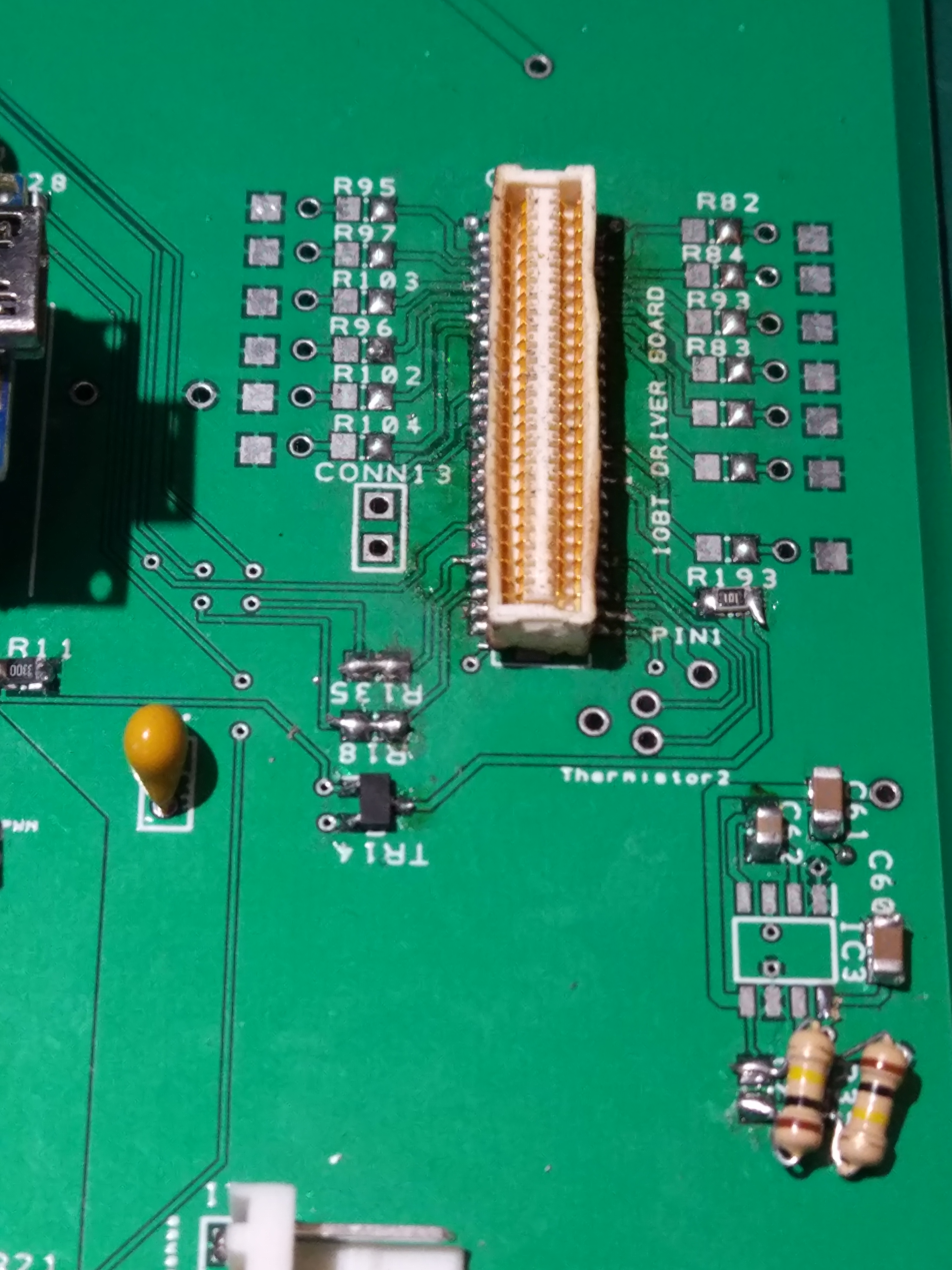

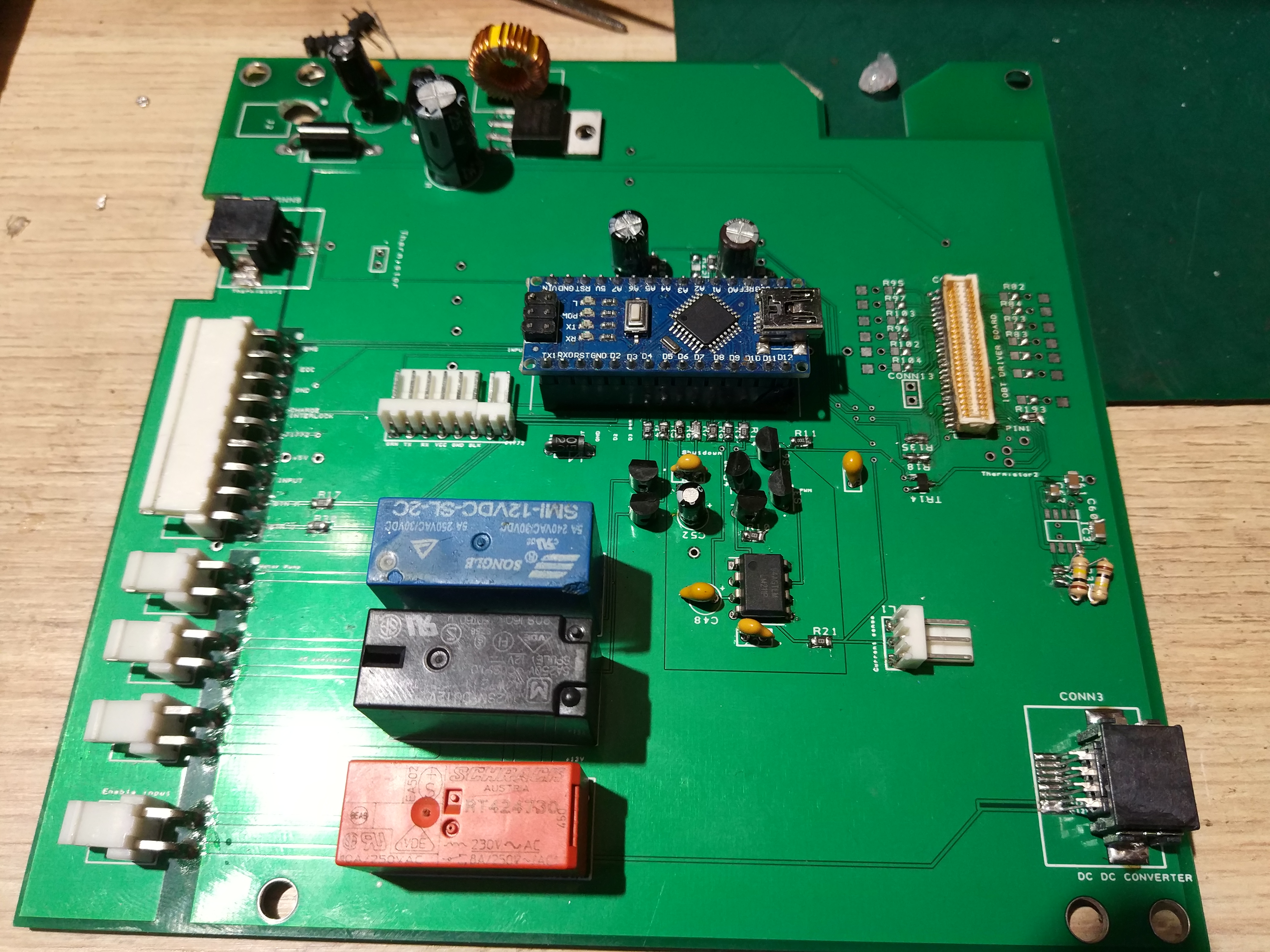

Hi, i finally found time to assemble my Prius Gen3 charger board. Now i am working on charger Arduino code. It is really simple dual comparator with PID code. Prius voltage and current signals work really adaptive and are universal in respect to other 5V uC.
Please mind the schorched connector it was salvaged from Prius main board. However a have some doubts about hardware. Can you tell me how did you manage to connect battery across AC power? What I mean to ask did you have to actuate any of the other transistors or did you just keep them off?
Next question i have is, how exactly should i keep rest of transistors off? Do i feed them 5V through the pullup or do i just leave them floating?
Does driver board have its own pullups?
I am still deciding which current sensor to use. I have Melexis sensors and boards, but i would need very accurate setting for mV per A. I am not sure if i can et repeatable results with usual chip placement. I would need signal full swing up to 100A. Alternative is Tamura 200A hall sensor which is bulkier.
Johannes, your opinion on melexis sensor placement and its accuracy? I havent used them before.

By default on the Gen 3 all transistors are off. Pulling the relevant driver line low via a 100r resistor turns them on. I would say they have a very strong pullup and doubt they would turn on by accident. But guess what? even if one DID turn on and short the dc link they don't blow. Just makes a little click sound. I think its the equivalent of a Toyota engineer tut tutting at you:)
- celeron55
- Posts: 805
- Has thanked: 39 times
- Been thanked: 136 times
Re: Toyota Gen 3 inverter charger
I keep everything off by leaving them floating and only drive the high side boost switch.

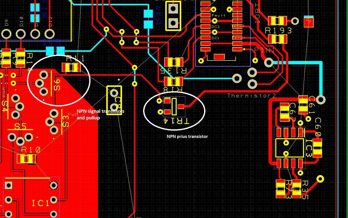

Ok i carefully applied 380V to my circuit and measured response. Battery voltage reported good.
Next i applied AC single phase voltage to 3phase connectors and i instantly got 320V rectified. I checked HV porting and true enough i got a good function. Yay! Not so fast!!!!
I messed up, grr... Luckily i verified voltages on both sides. When i tried AC i got 320V on both sides! That can only happen if transistor is letting through!
When i went back to see on my design i noticed i was using one NPN to generate PWM and another NPN to pull its signal to GND in case of trouble. Of course this circuit requires 470R pullup resistor to send the signal out. Now Prius gen3 uses another NPN with 100R pullup at collector to force power transistor to open. Guess what happened. My NPN and its pullup were driving Prius NPN to open and in turn drive power transistor DOH!
Jack Bauer, question if i may? Do you think if i replaced Prius NPN transistor with some general PNP, would it cause a problem? Right now i would use the same pads for testing, but later i would change board design to properly invert signal...

Damn! I removed pullup and put 1K pulldown on transistor, but i still get 320V rectified on both sides. Shouldnt the battery side show on both sides (due to transistors diode) but from HV there shouldnt be any voltage to the battery side.
I will have to protect battery by a diode in addition of AC contactor.

You are correct. If i connect Prius inverter to AC without control board connected i get 320Vdc on myin cap and 1.28Vdc on the battery side. I must have made an error while soldering the white connector. Something is providing power to the boost IGBT. I will check tomorrow...celeron55 wrote: ↑Sat Jan 04, 2020 10:19 pm 1. When I don't drive the boost switches, I get about 0V on the battery side. So yes, there's something wrong in your setup.
Note that the battery side has a pulldown resistor, while the HV side doesn't have a pulldown resistor. I think? Not 100% sure.
2. I intended to add an output diode later, but I'm skipping it now as changed my plans into integrating the charger into the vehicle later. So, no output diode. But that's only possible because I have an output contactor and I precharge the output in a controlled way.
EDIT: I did check and i found i used a similar device to sot23 transistor, but it was not in fact transistor but something else. I replaced it and i have correct response from inverter. I will be more carefull next time.
Now i have to connect current sensor and play with settings so i calibrate voltage to AD readings.
