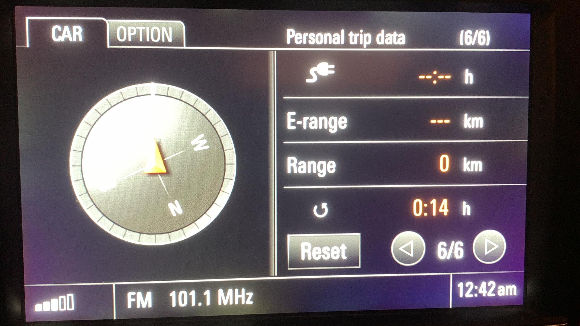

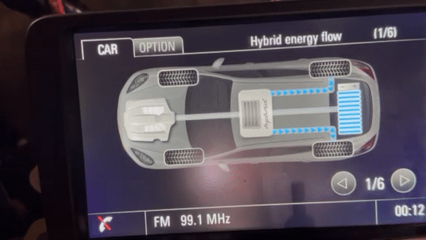

Cluster / OEM Integration

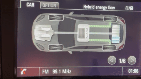

This will be a dumping spot for some of the fine details for the integration.
Also to document some of the Fails of the journey.

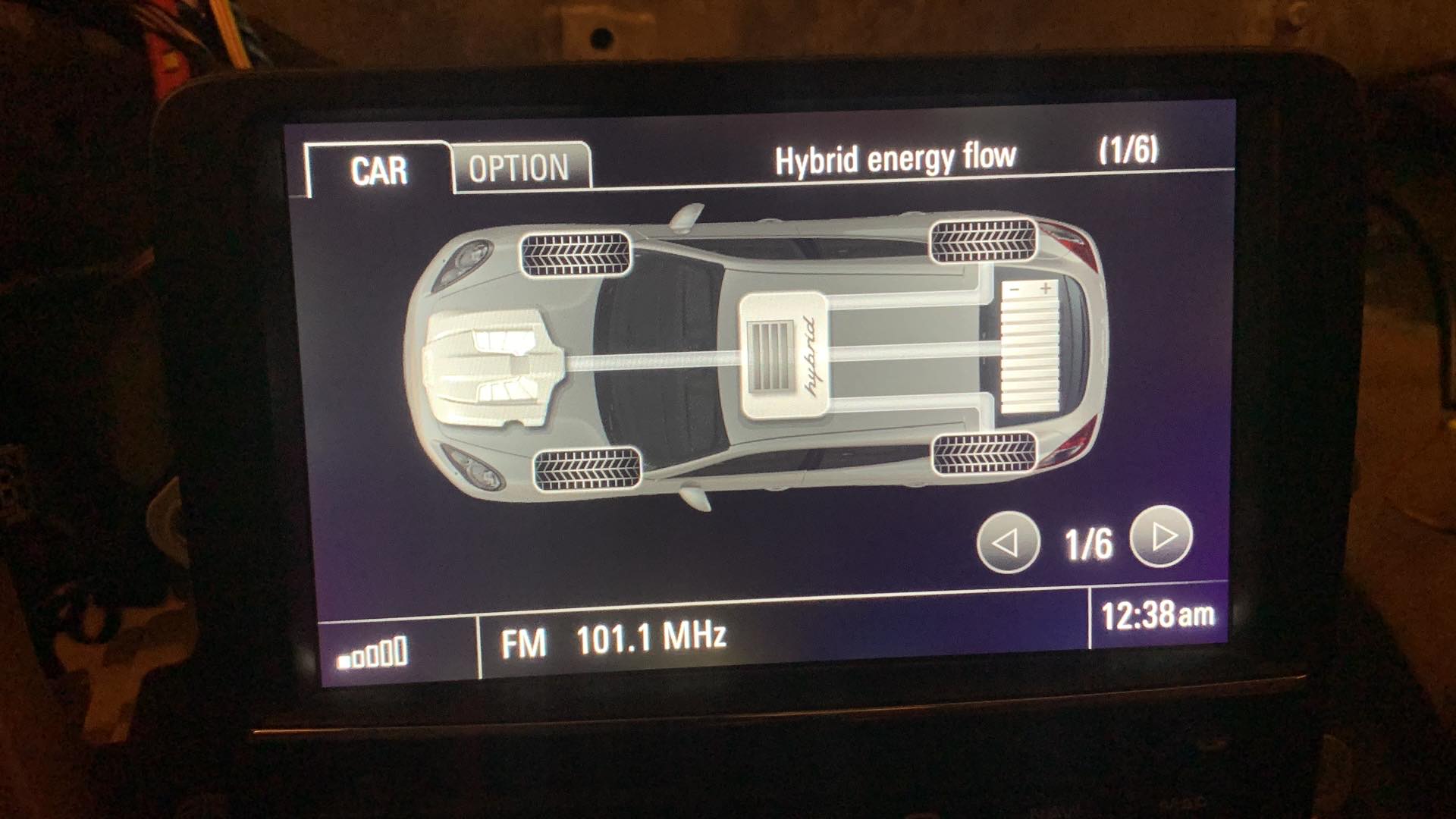

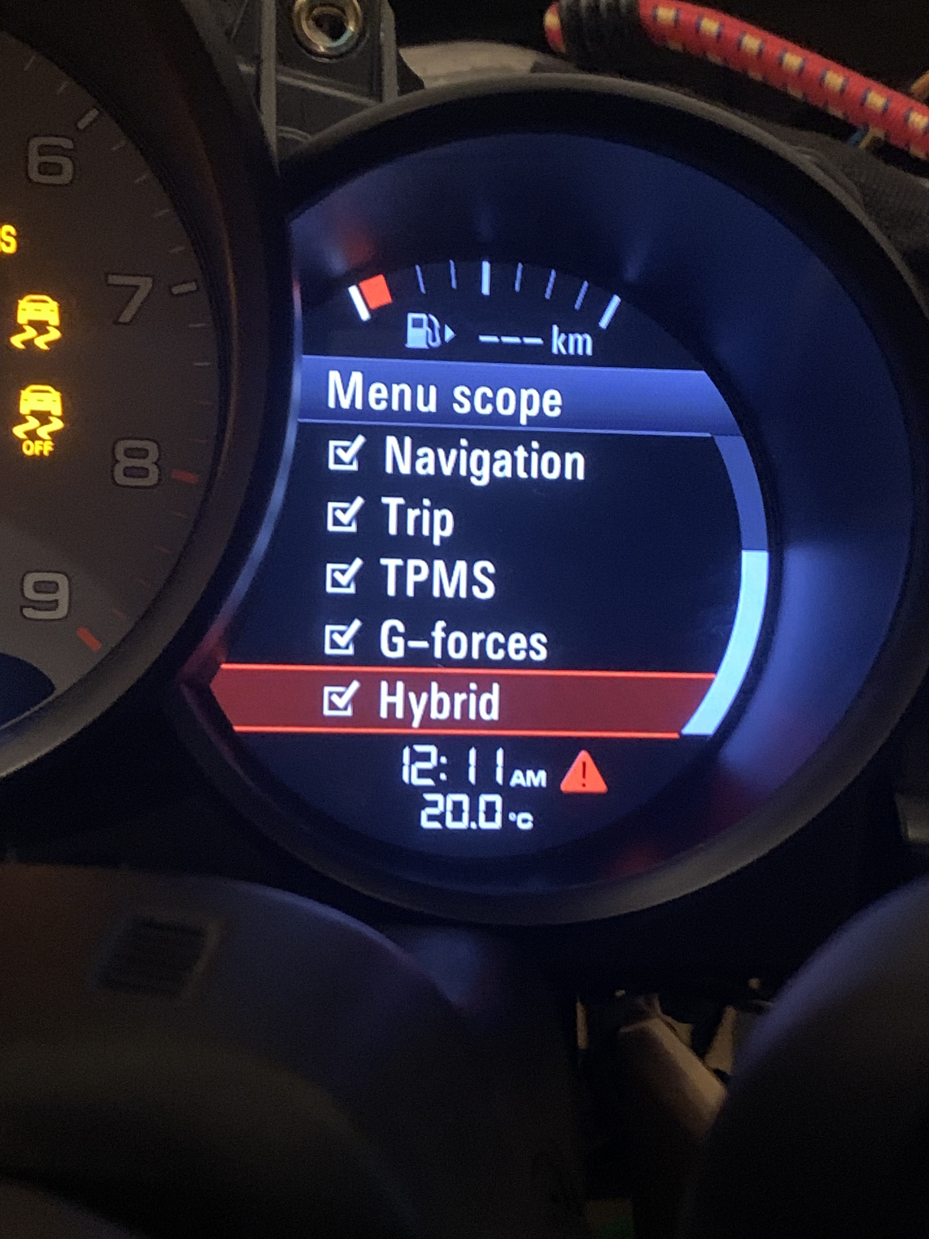

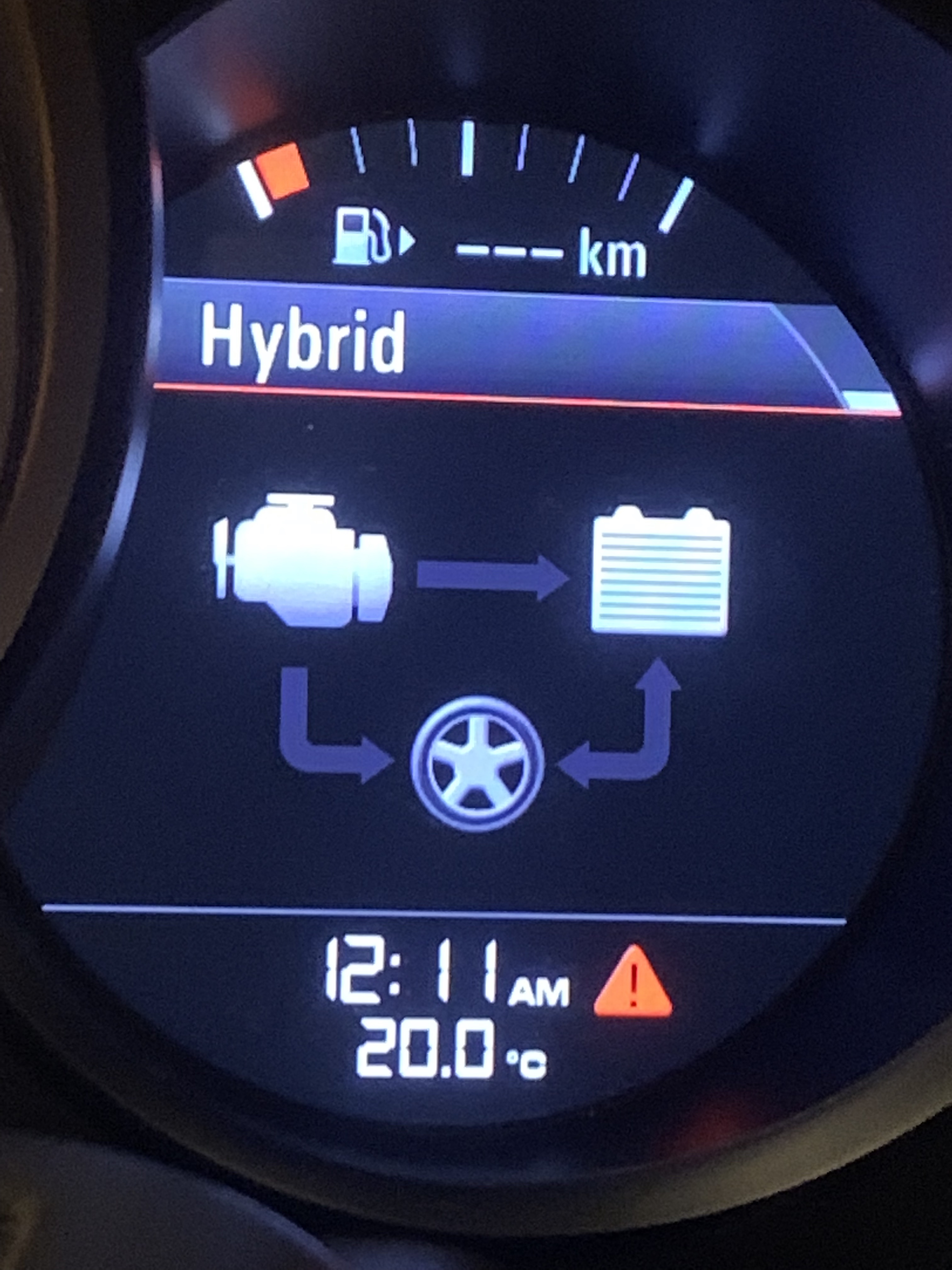

Cluster:
I was hopeful that the engineering option of turning on the Hybrid menus in the Gateway/Cluster/Radio modules would allow me to hijack the existing hybrid integration.
Unfortunately after many trials I'm pretty confident that the 991 and 981 cluster firmware lacks any deep hybrid integration.
For those wondering, you can flash a Cayman cluster with 991 firmware and gain the few perks of the 991 (better selection of the lcd panel)
But even with the latest version, the cluster fails to read the ECU Hybrid canbus signals and thus cannot forward the signals onto the PCM/Radio.
I have a feeling the Panamera/Cayenne clusters would work, but unfortunately these were made by VDO (vs Contentinal for the 991/981/macan versions) so the code is most definitely incompatible given the blocksize for the bootloaders are different.
I may try to pickup a cheap cluster to map the signals sent to the PCM to display the battery and charge status there.
Also fighting being unable to find any documentation of the BAP protocol to the PCM.
I've managed to identify 0x10E (I believe, need to check my notes) if you spoof this on the MMI bus it'll toggle the E-Range value.
Eventually I hope to just have a small CAN-in-the-middle to adjust these values to the PCM if I can't sort out the actual cluster forward
With PIWIS you can also toggle the AWD screens and mimic the Allrad block to show the torque distribution.
Some AWD cluster warnings can be triggered by 0x105, though I haven't seen any DBC showing the full breakdown, I can post the info that I've found from spoofing.
There is an AWD screen that should be easily enabled much like the hybrid screen, but on the 981/991 images this screen option does not appear. I doubt there is any selective logic on Canbus signalling (and no errors from the cluster complaining about a missing canbus message)
I was going to try the Macan cluster firmware to confirm the hybrid and AWD screens are missing from that one as well, but that may be too risky.
Finally, you can adjust the cluster bar graph scaling for most of the values, so it's easier to better represent the cooler coolant temps and such related to the electrification, as well as adjust the oil pressure and other items to better represent whatever you need them to. 🙂

Wow cool mods! How did you turn that on?
Did you use PIWIS II?
Does it involve re-programming multiple devices?
Mitchy
Posts: 147
Has thanked: 7 times
Been thanked: 92 times
Re: Porsche 981 Cayman S (2014)
Post by Mitchy »
I've been using a PIWIS 3 38.500 image, along with a VAS6154 interface.
I can give you more detail of my setup if you need (and image), it's easy enough to setup if you want.
Another positive point is that it'll still identify all modules with the ECU/TCU missing. The only issue is the automatic model selection, but all other diagnostics work, easy to tell if any module isn't happy with the bus signals.
Most of the modules have some sort of 'Hybrid' mode, either selected directly via the engineering interface (Cluster, Gateway, PCM) or by reading the MotorCode Canbus message, when this canbus bit is coded to full hybrid, a few other modules follow along (EPB, EPS)
I believe the only difference for those modules which read the motorcode from the Bus is their reaction to the motor running status; basically eliminating the need to have a >600 RPM signal.
My EPB module isn't totally happy with the change, giving a configuration error, so I may roll back after some additional troubleshooting.
Your Panamera cluster should be able to do the hybrid signals, if you enable them and spoof some signals into the Motor_Hybrid can addresses in my notes, it'll be interesting to see what you get as a result. You should also be able to swap to the powermeter dial if you can find a cluster with it, that dial (and the battery gauge) would be an awesome swap to better show the power/regen in the factory cluster.
the PIWIS images have some firmware included.
If you do this a log of the MMI bus during this would be very helpful!
I've updated the OEM integration post above with some more info related to the MMI bus and Cluster screen/AWD error messages:

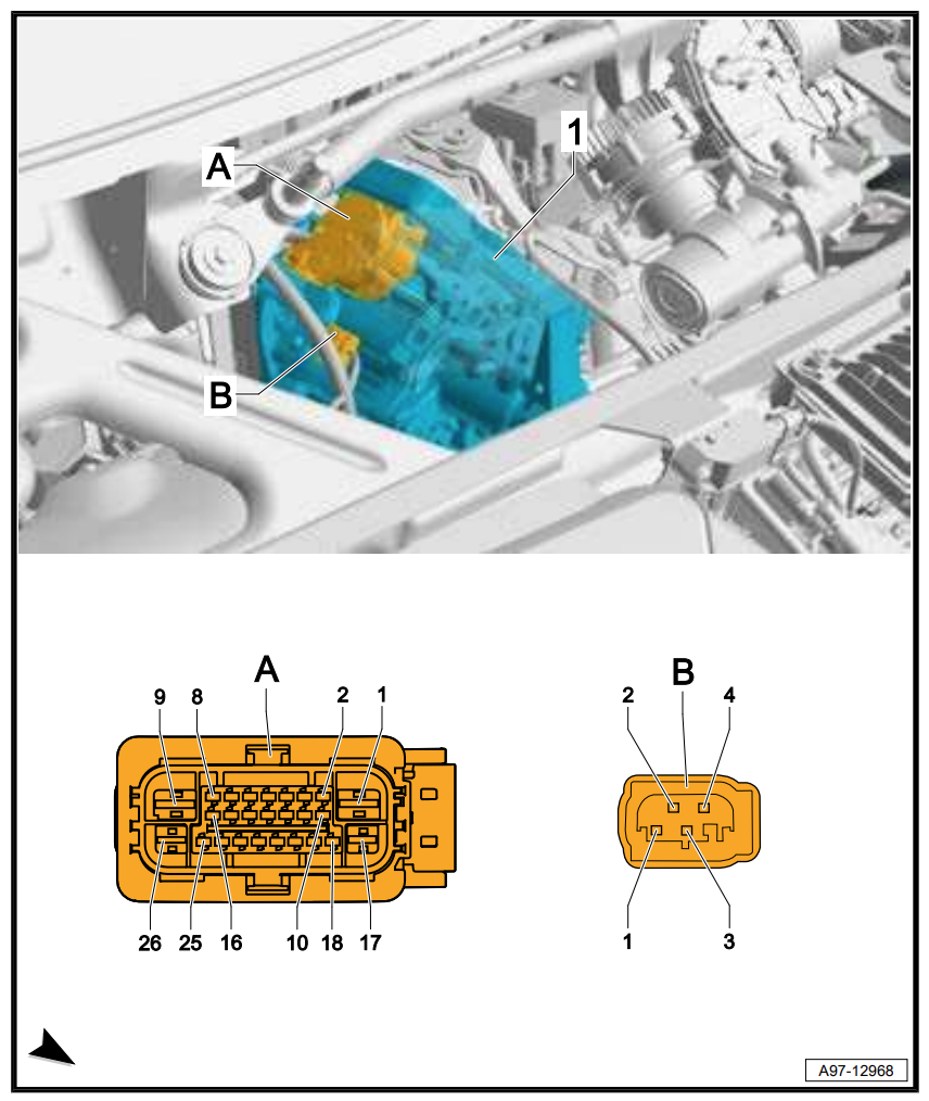

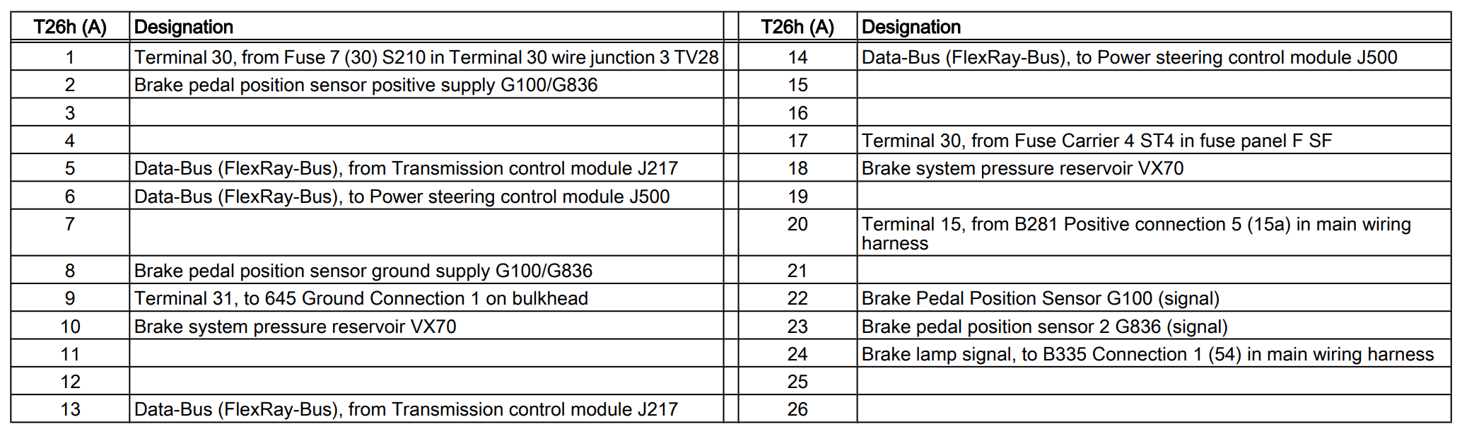

Mitchy
Posts: 147
Post by Mitchy »
Pete9008 wrote: Fri Sep 30, 2022 11:01 am Do you know whether the VW iboosters are CAN bus or Flexray (or do they support both)?
I've been digging into this lately,
From all the VCDS configuration items I can find for this unit, there isn't any switch to swap between CAN/Flexray
The unit I have is unfortunately Flexray.
There are many VAG Canbus boosters though.
eBKV is the module description, and in the VCDS world it's Module 23.
From some quick research there are multiple PartNumbers, but likely just 2 real HW versions
On the tag, you'll see H14 0195, I'm thinking the H14 is the HW# and the 0195 is the SW number
From VCDS maps, there are only 2 types of Units (regardless of the external PN):
  • 3Q0 modules are H06
  • 5QE modules are H14
It's possible that this is the CAN/Flexray split.
There are other modules, like the 918 Spyder uses a Bosch eBKV which is H09 1200, I've been trying to find one to attempt to crossflash the 918 firmware.
In the end, it looks like the control module can be removed from the eBKV module, The only reason I chose this particular unit is that it fit the existing bolting pattern, so I'm curious if the modules can be swapped.
The Flexray units also have CAN, but it seems that this is an AUX bus used to communicate directly with the pressure reservoir (VX70)

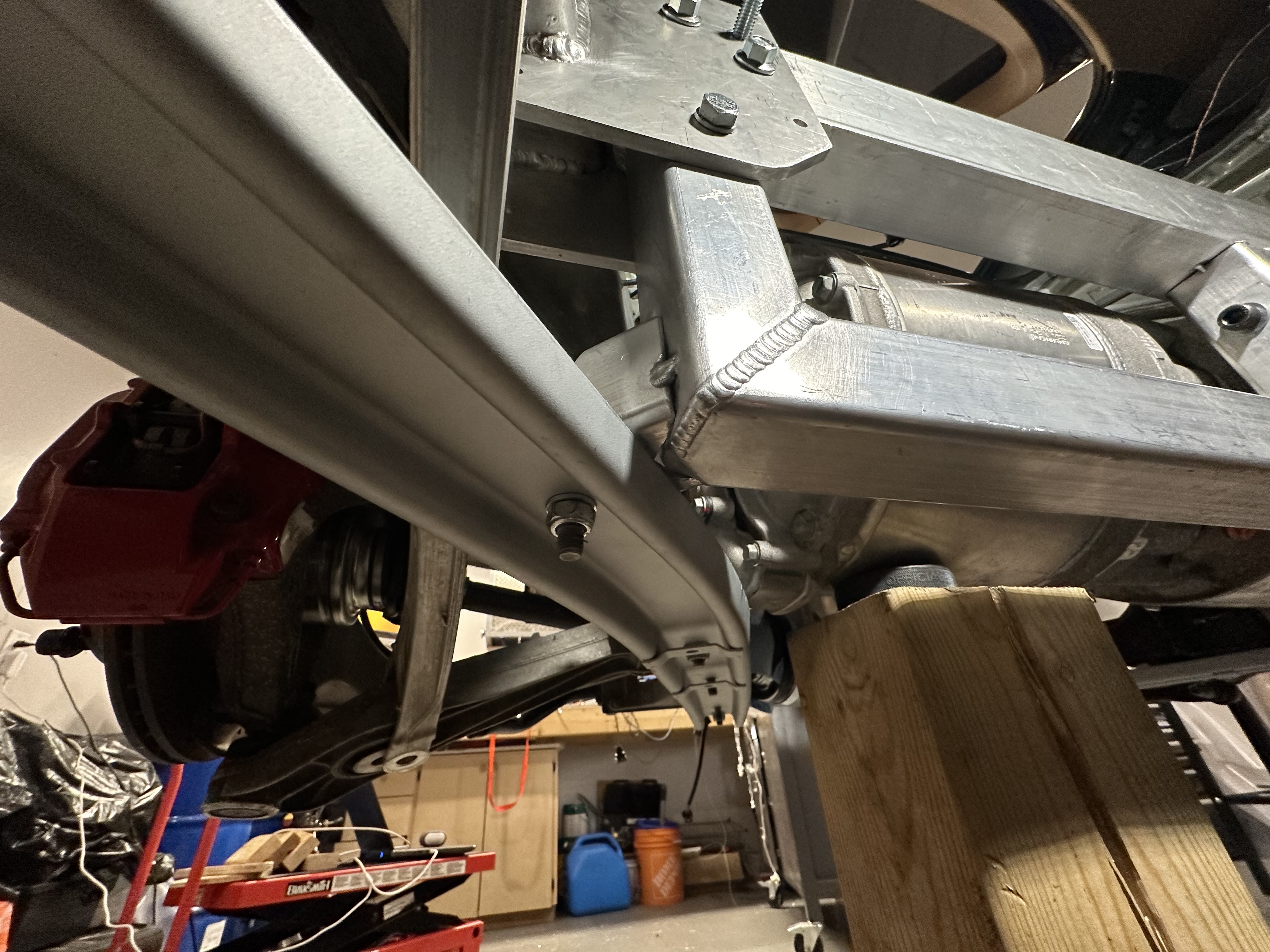

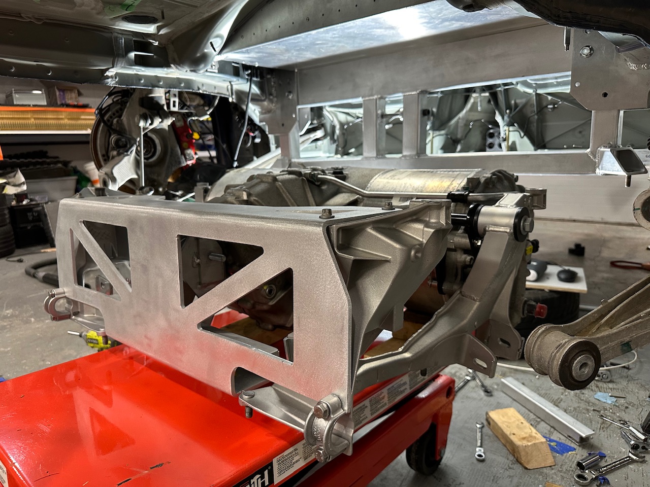

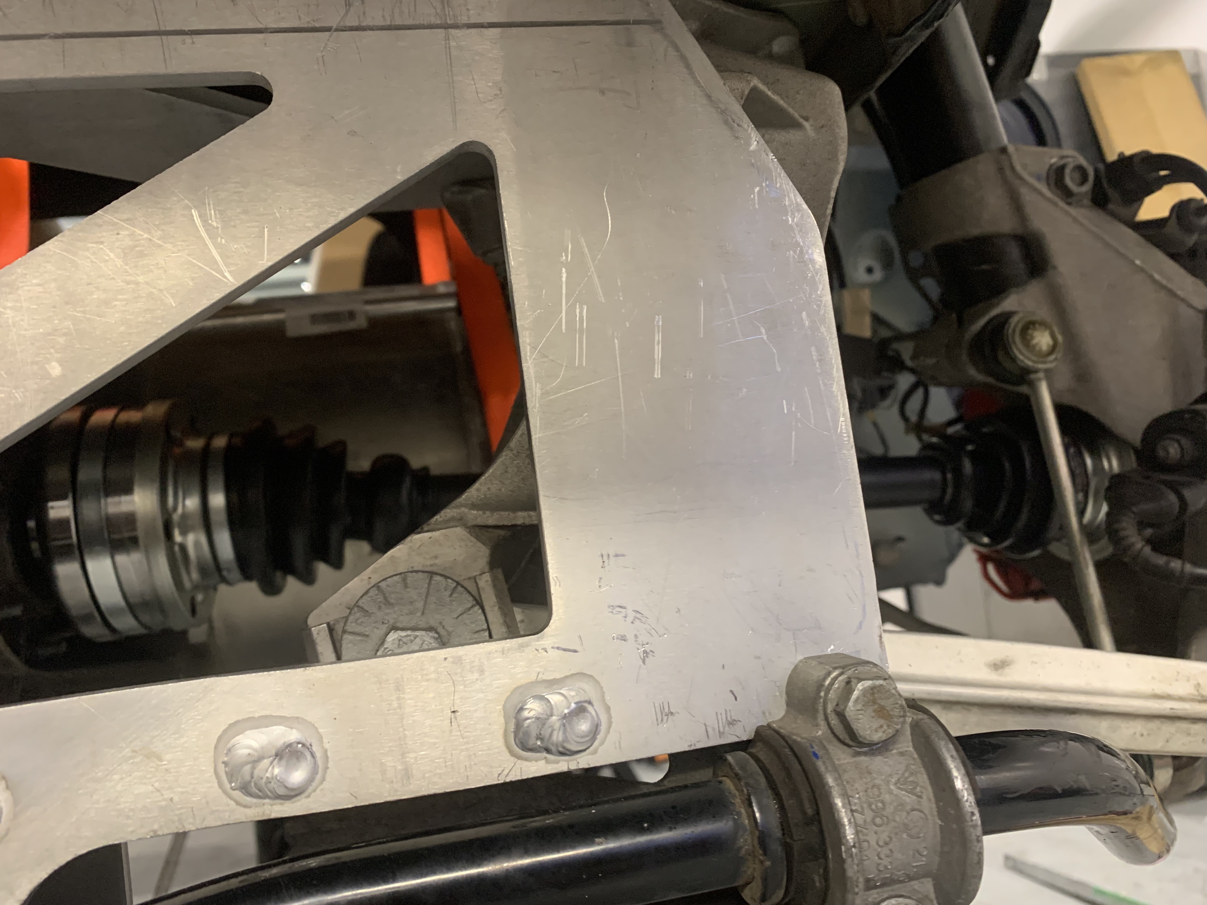

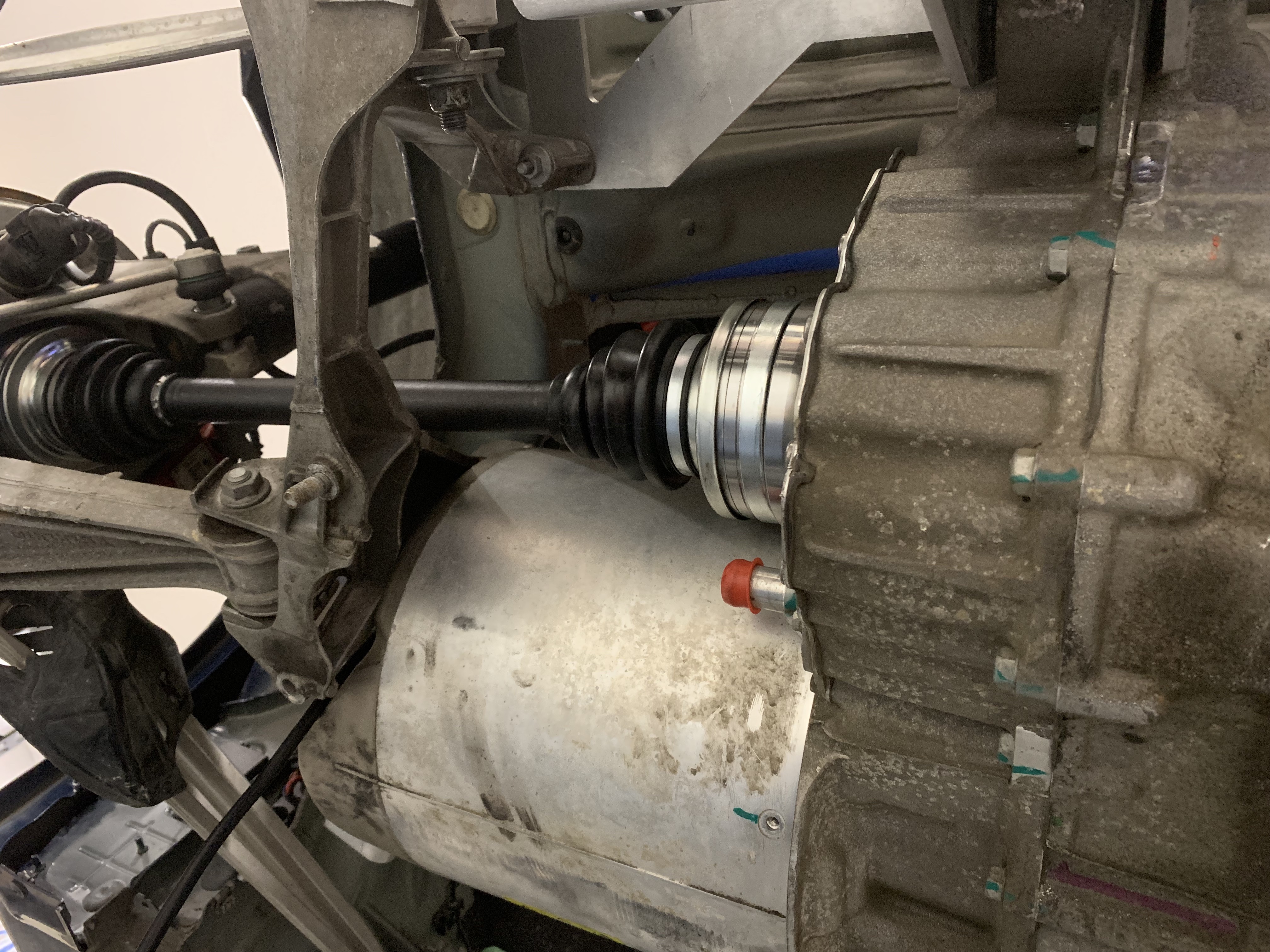

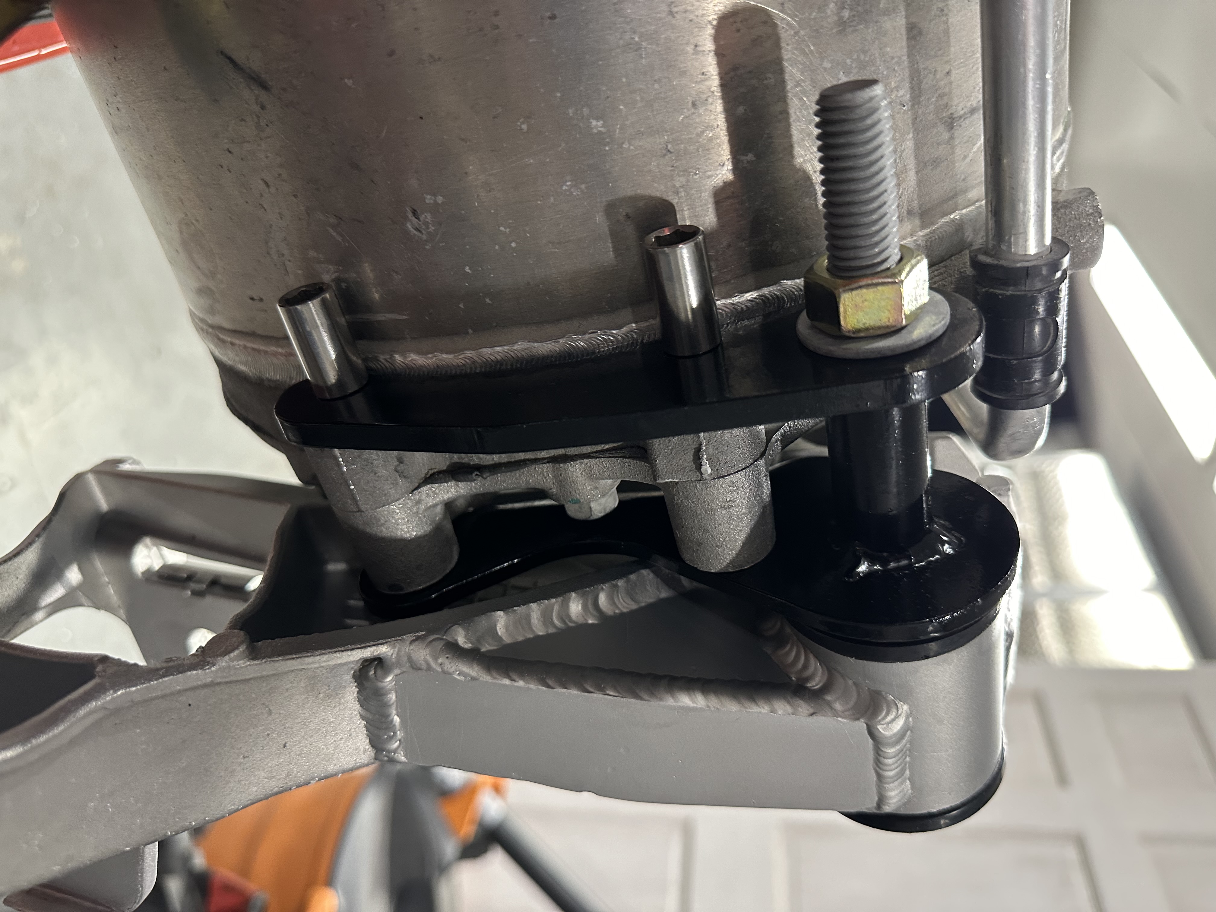

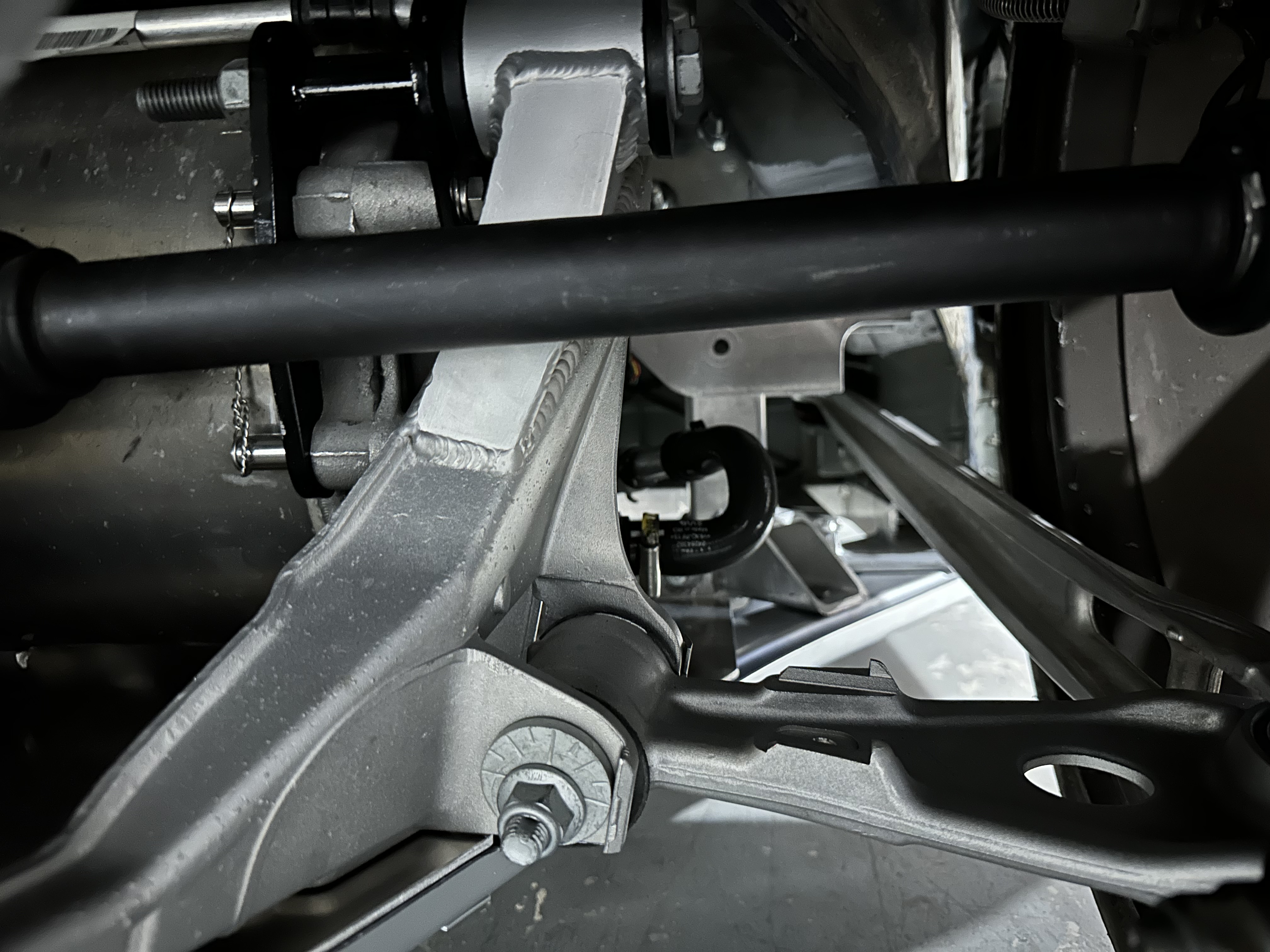

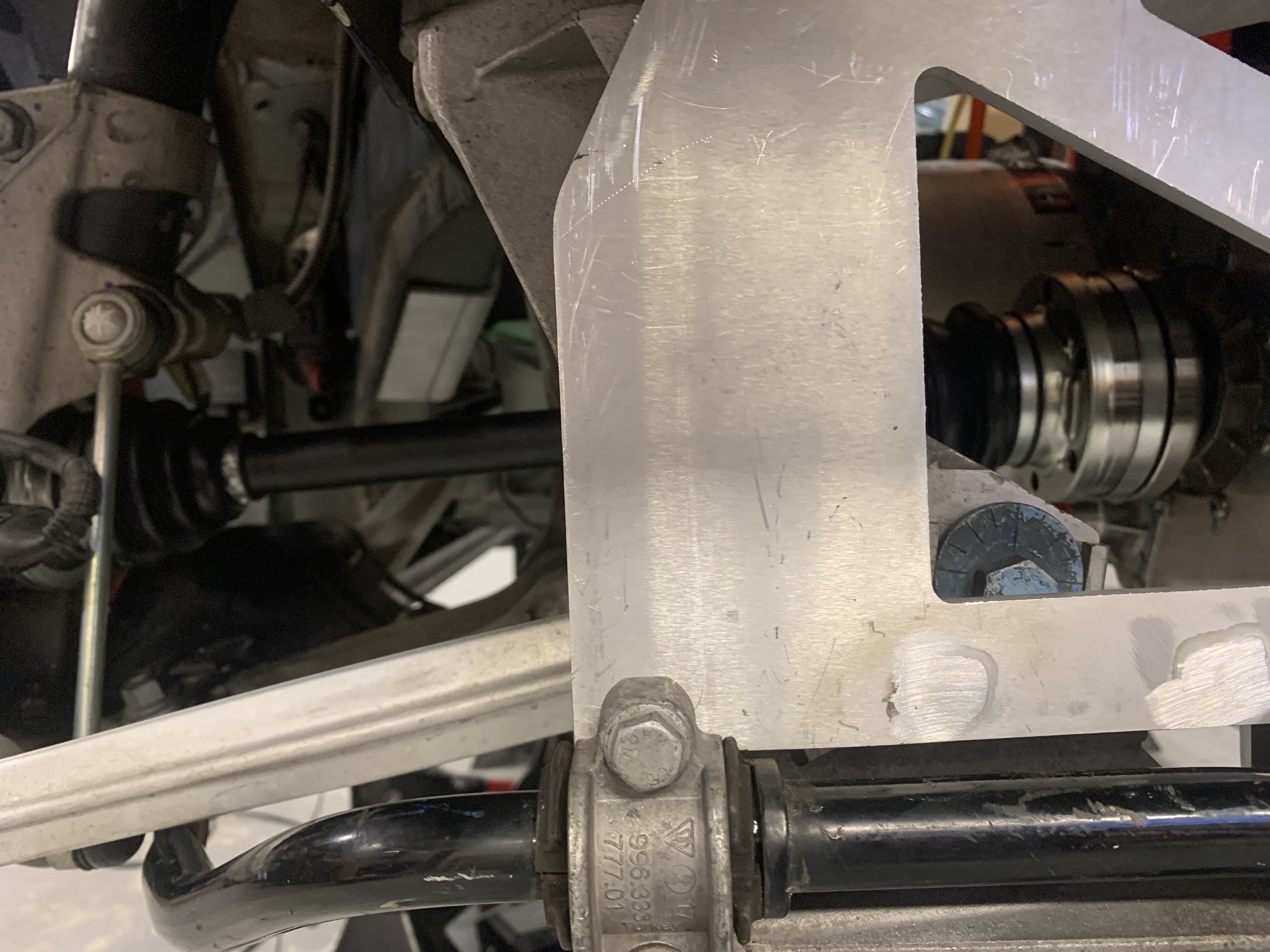

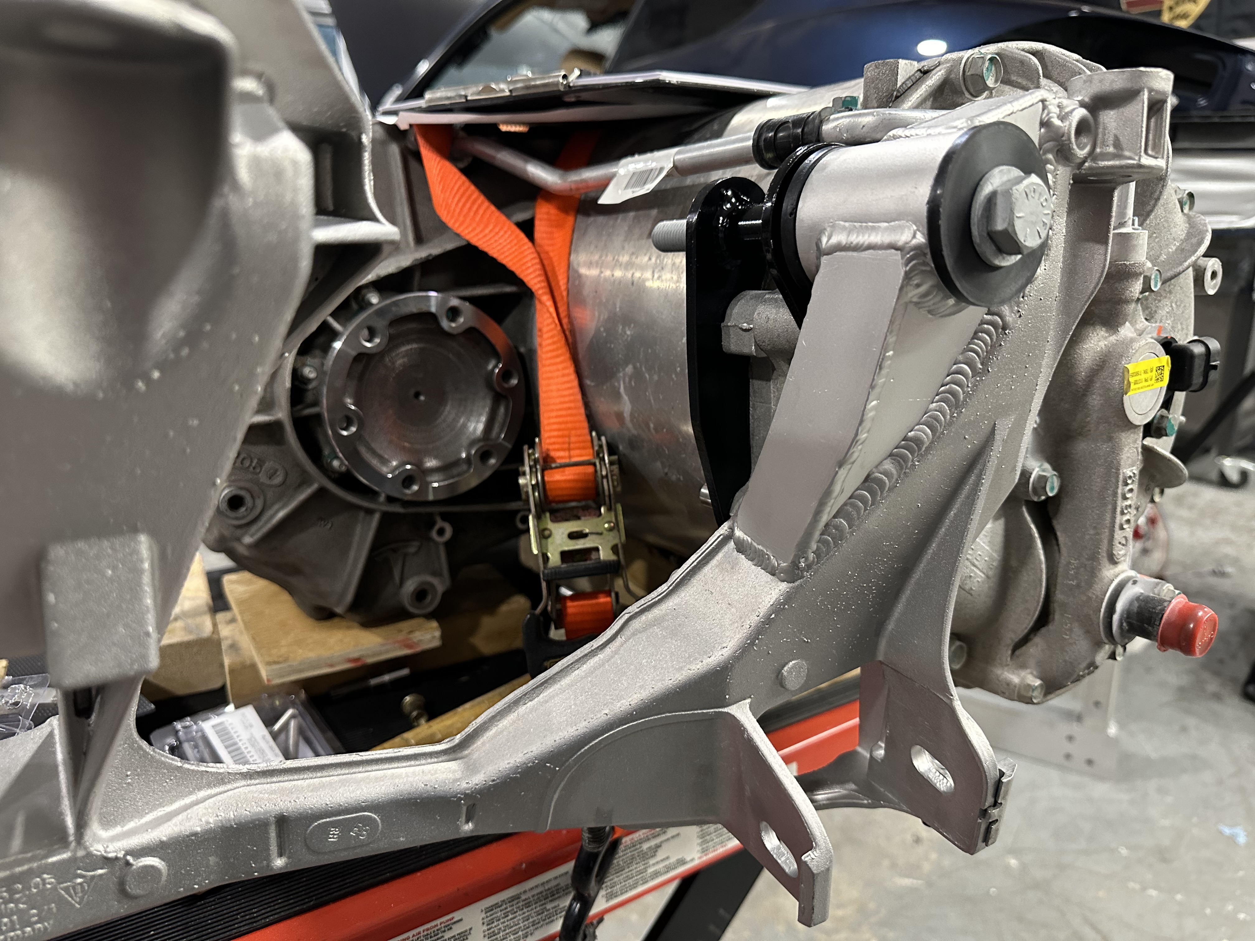

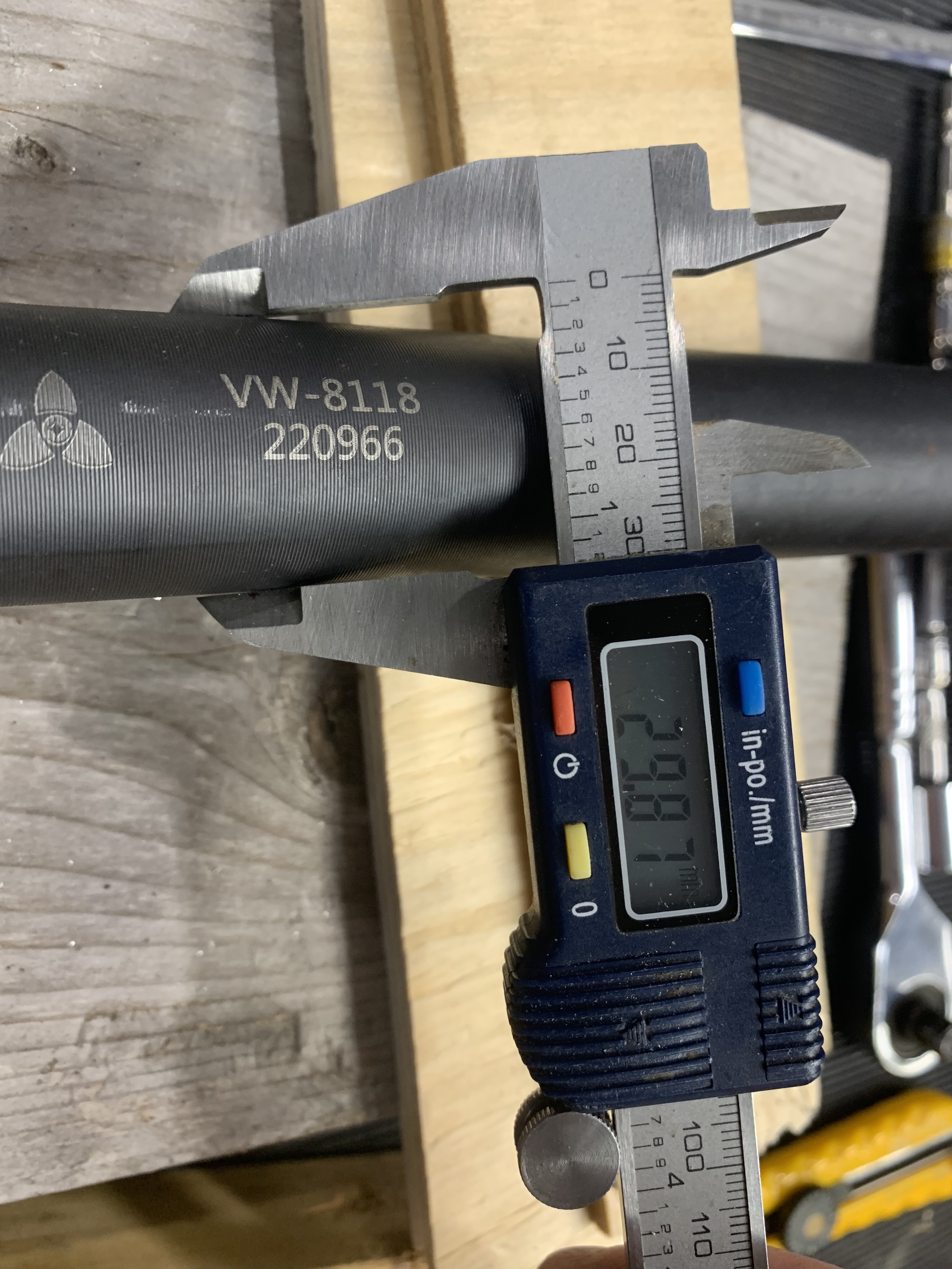

Axles:
A relatively major milestone.
After some/many hours of measurement and trolling thru various online catalogs, I managed to find some suitable CV axle shafts.
For Stub Axles, I purchased the Zero-EV 930 stubs during my mockup phase as I knew I wanted to stick with as close to a factory axle as possible.
For options:
  • Custom route, Lots of 930 type axles used by the Sand Rail crowd.
  • Air-cooled 911 axles have quite a few variations, but most likely to have some incompatibilities of the newer style hubs.
  • 986/996 shafts are suitable, these use ABS rings which can be removed, the rings likely would clash with the newer hubs, ~26mm shaft size
  • 987/997 shafts are equally suitable, no ABS rings. These newer ones have a larger diameter shaft of ~30mm
For the newer shafts, several different lengths. Trakmotive is a good source for measurements http://www.showmetheparts.com/trakmotive/
Trakmotive measurements are a bit unconventional as they're a 'tip-to-tip' measurement, taking in account the end threads and the 930 'bulb' that is on the end of the cv joint that recesses into the stub shaft.
Key to Porsche Axles is the 108mm '930' flange and 28 spline hub.
Porsche Axles and their compressed lengths are below:
VW-8164 - 653mm - 986 Boxster - 2.7L Manual - Left
VW-8165 - 694.5mm - 986 Boxster - Likely Superseded with 8180
VW-8166 - 563mm - 986 Boxster - Likely Superseded with 8167
VW-8167 - 563mm - 986 Boxster - 3.2L Auto - Right
VW-8168 - 682mm - 986 Boxster - 3.2L Manual - Left & Right
VW-8180 - 696mm - 986 Boxster - 2.7L Manual - Right
VW-8118 - 689mm - 997 Carrera
Having the 997 I did some initial measurements
Given that the VW-8118 shaft was the cheapest @ $90 ea on RockAuto, I ordered one... Then Another :)
Once installed, the total compressed length gives me 22mm of plunge space per side when the suspension is loaded with the axles totally horizontal, 22mm of the ~70mm of full travel is reasonable, as this gives 30-40mm of play at full droop or full compression.
Since the 8118 shaft appears to be also used on the Turbo models, upgrade paths are easy with various larger axles available - From Driveshaftshop and others using fancy 300m .
No bolts or anything yet as I'm still mocking up, But it all looks promising!

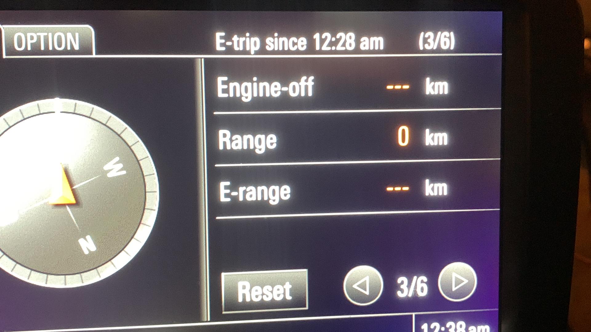

Quick update,
Ibooster is installed, the Aux CAN has some info that represents pedal position:
More info here: viewtopic.php?t=2699
Managed to get the PCM hybrid battery level and hybrid flow working:

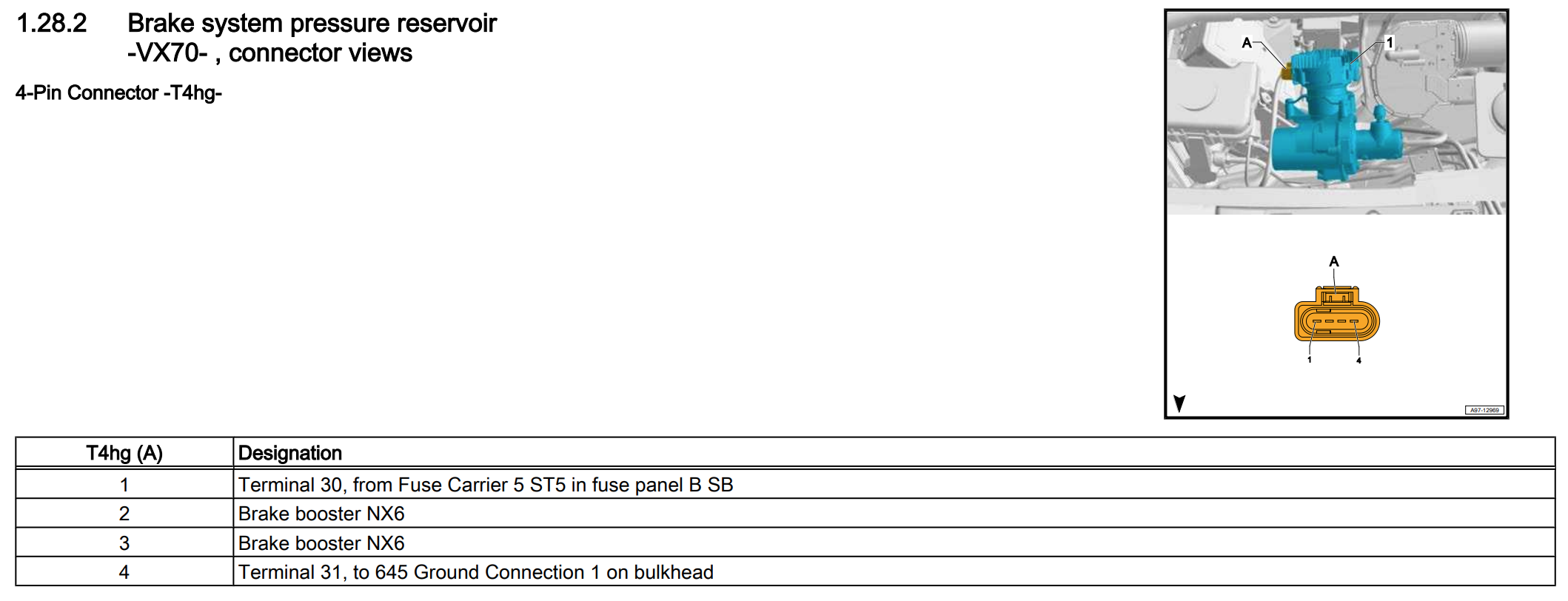

Mitchy wrote: Wed Oct 19, 2022 12:20 am Axles:
Hey Mitch,
Are you saying the ZeroEV stubs will bolt onto the 987/997 axles and all you have to do is find the right length of axle? No machine required?
Mitchy
Posts: 147
Post by Mitchy »
Yep that's correct
The ZeroEV stubs are just 108mm bolt spacing, so basically any 930/Newer Porsche axle works without issue.

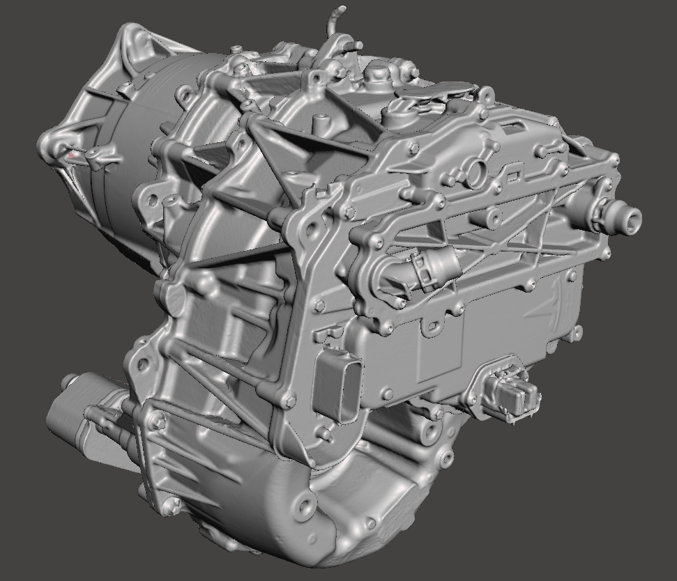

In addition to the Sport LDU in the rear, I'm hoping to run the Raven Front Drive unit from a newer Tesla Model S.
The Raven is basically a Model 3 Performance Rear Drive Unit, but in a Front Drive Unit form factor.
The Openinverter community are making real progress getting the Model 3 drive units working, and this has the same base inverter as the 980 drives.
<--- Vehicle Front // Vehicle Rear --->
Realistically it's a crazy tight fit. A Co-Axial unit would be a much better fit;

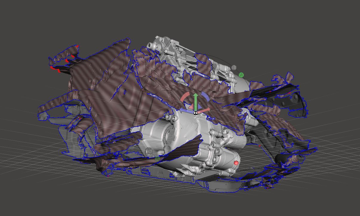

Since no scans or measurements were online for the Raven, I found a unit cheap enough to take a chance and give back to the community in the form of a 3D Scan of the drive unit for others to use:
It's uploaded to GrabCad:
Tesla Model S - Raven front drive unit scan
Motor positioning from Tesla is slightly more tilted than what is shown above,
On the bottom of the Diff, there's a Part# tag, Assuming that the tag being level would be the true position:

Boy you are doing great here.. ; can you indicate normal model S position of the unit? Is vehicle in the picture nose up or down?

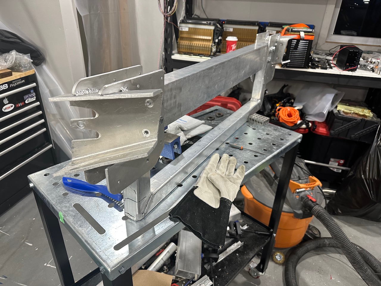

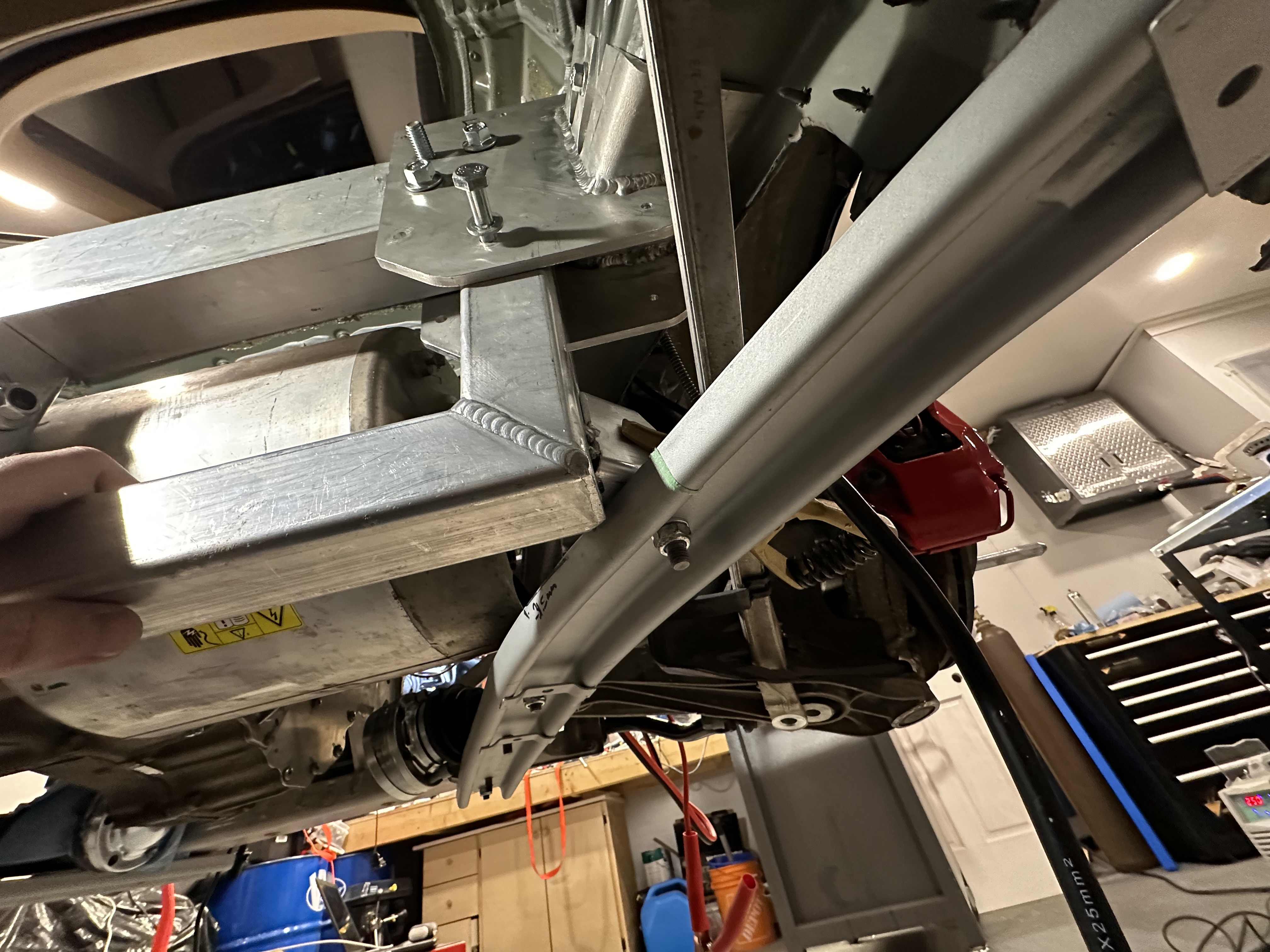

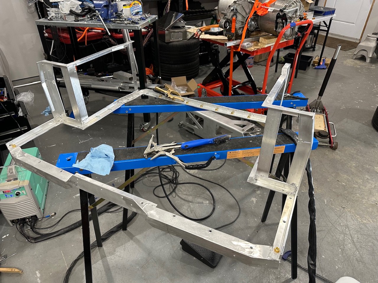

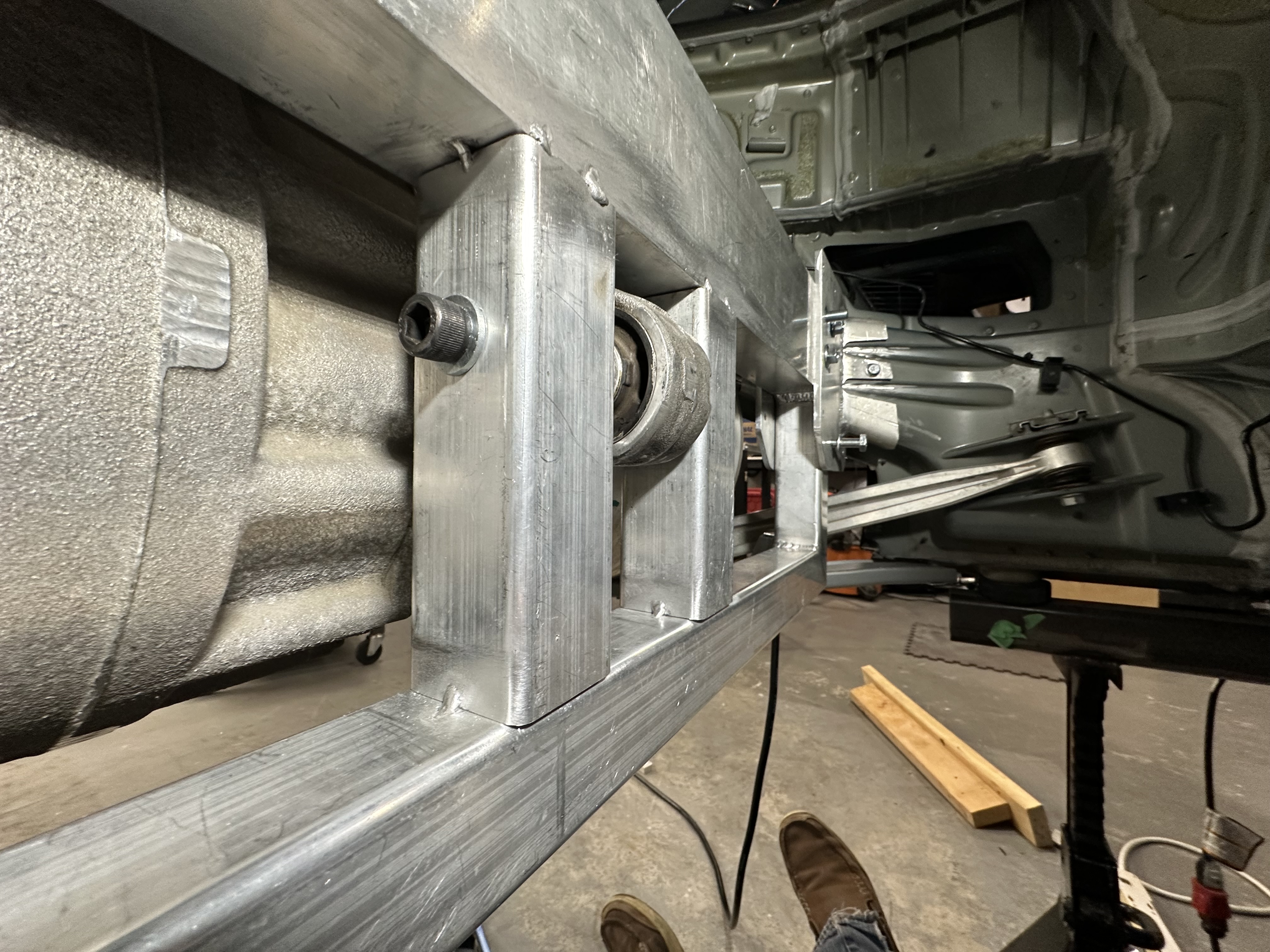

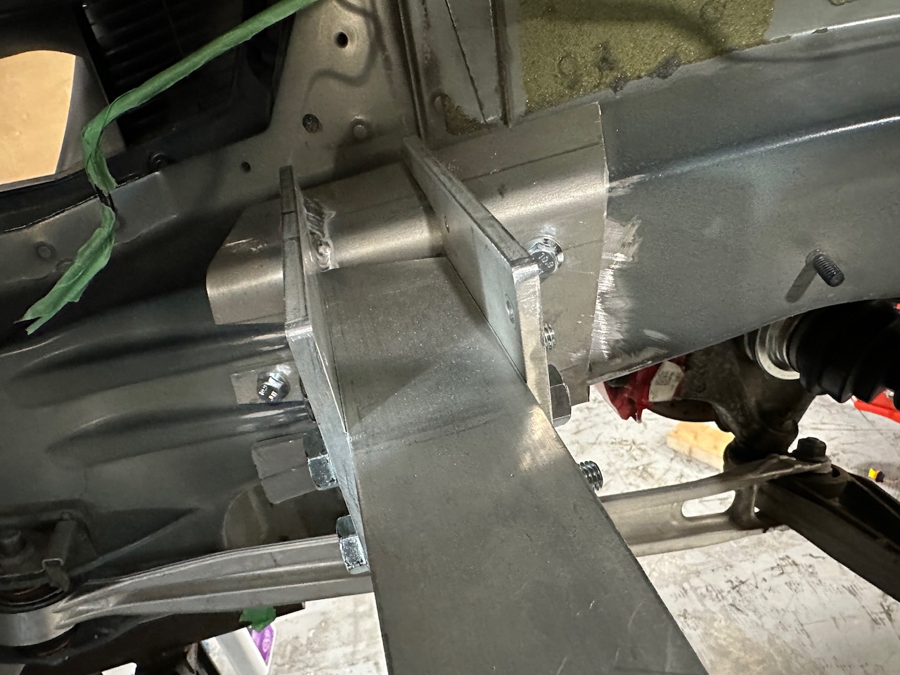

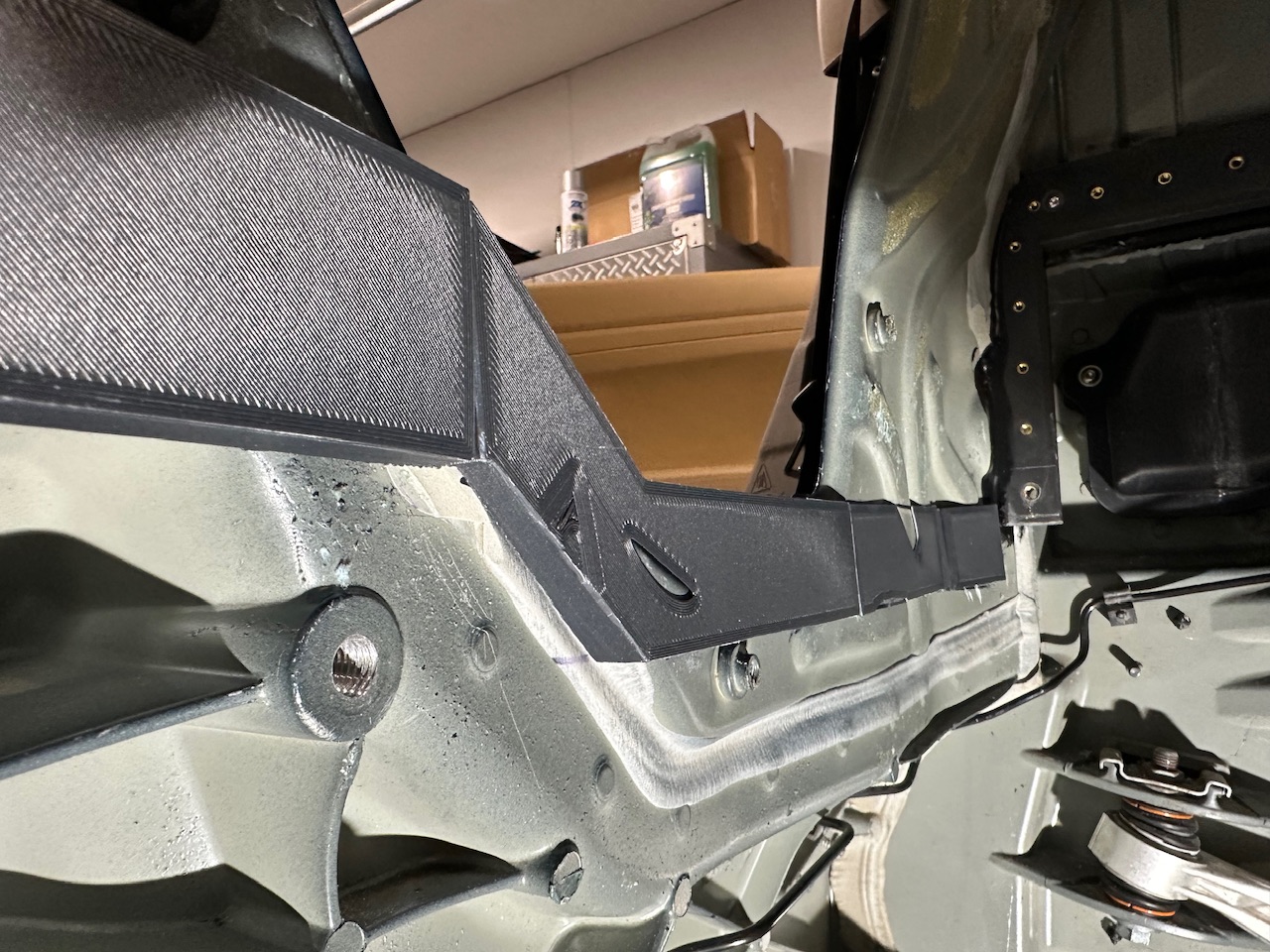

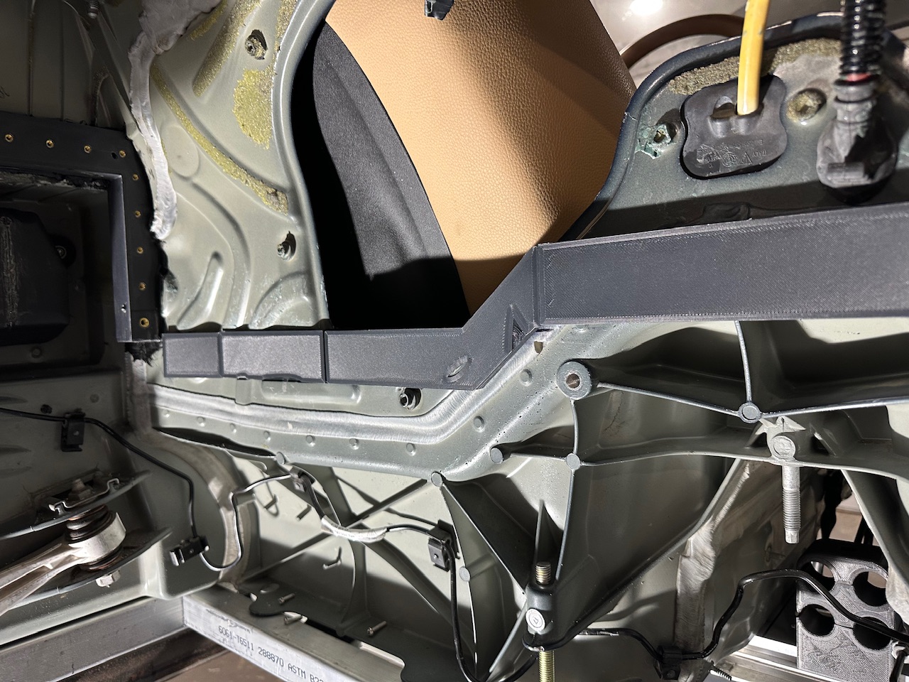

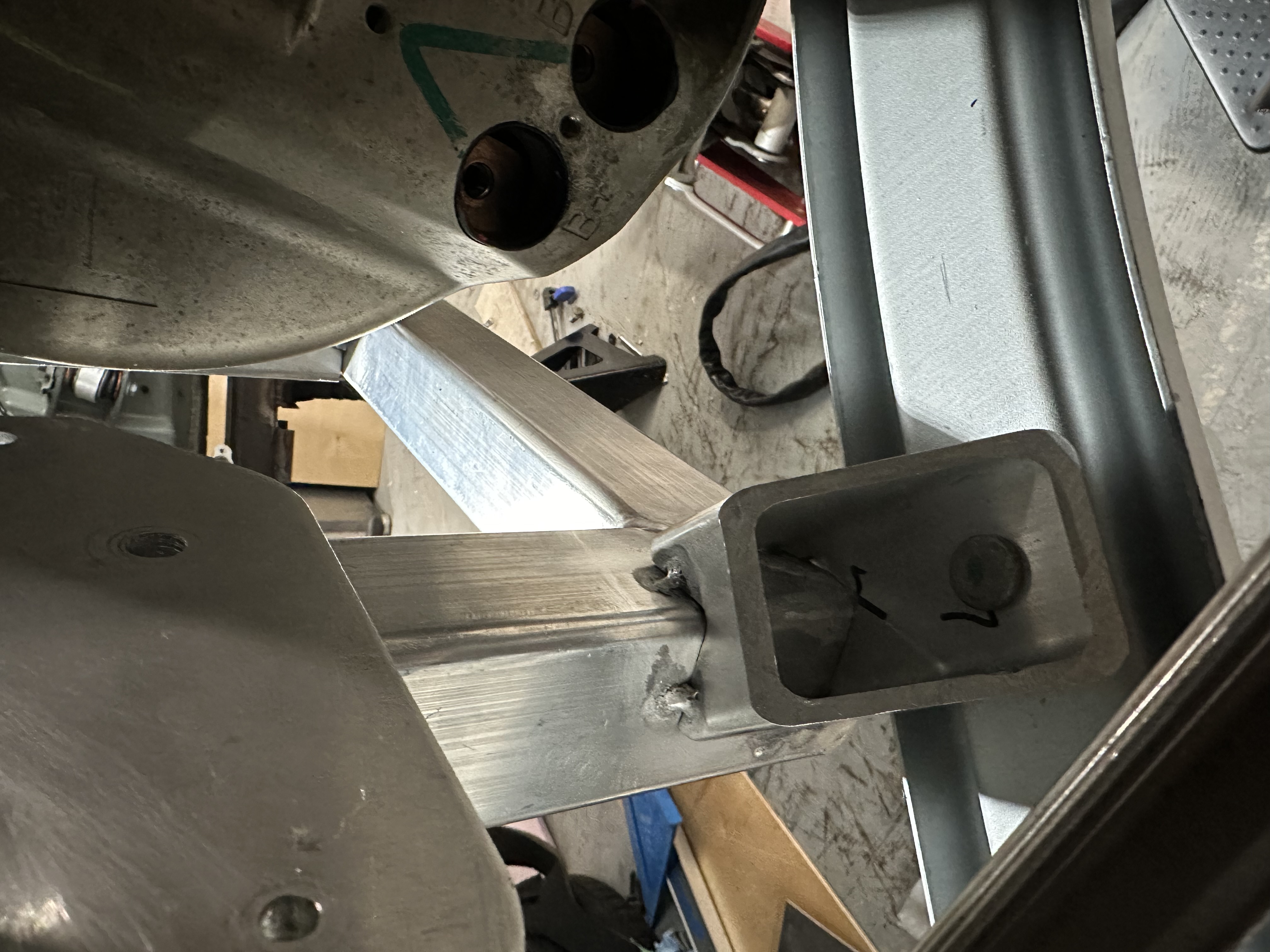

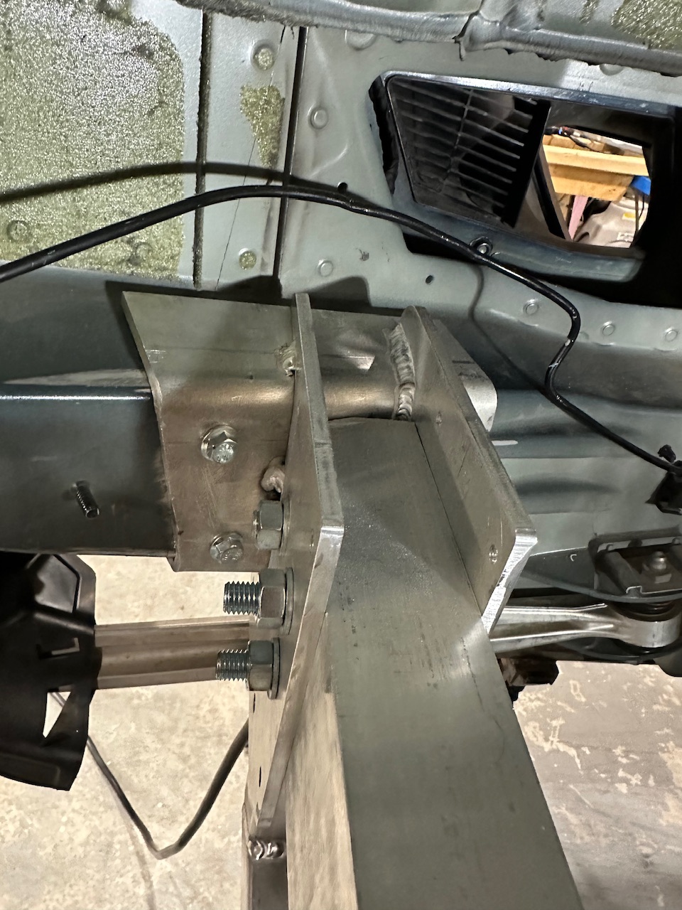

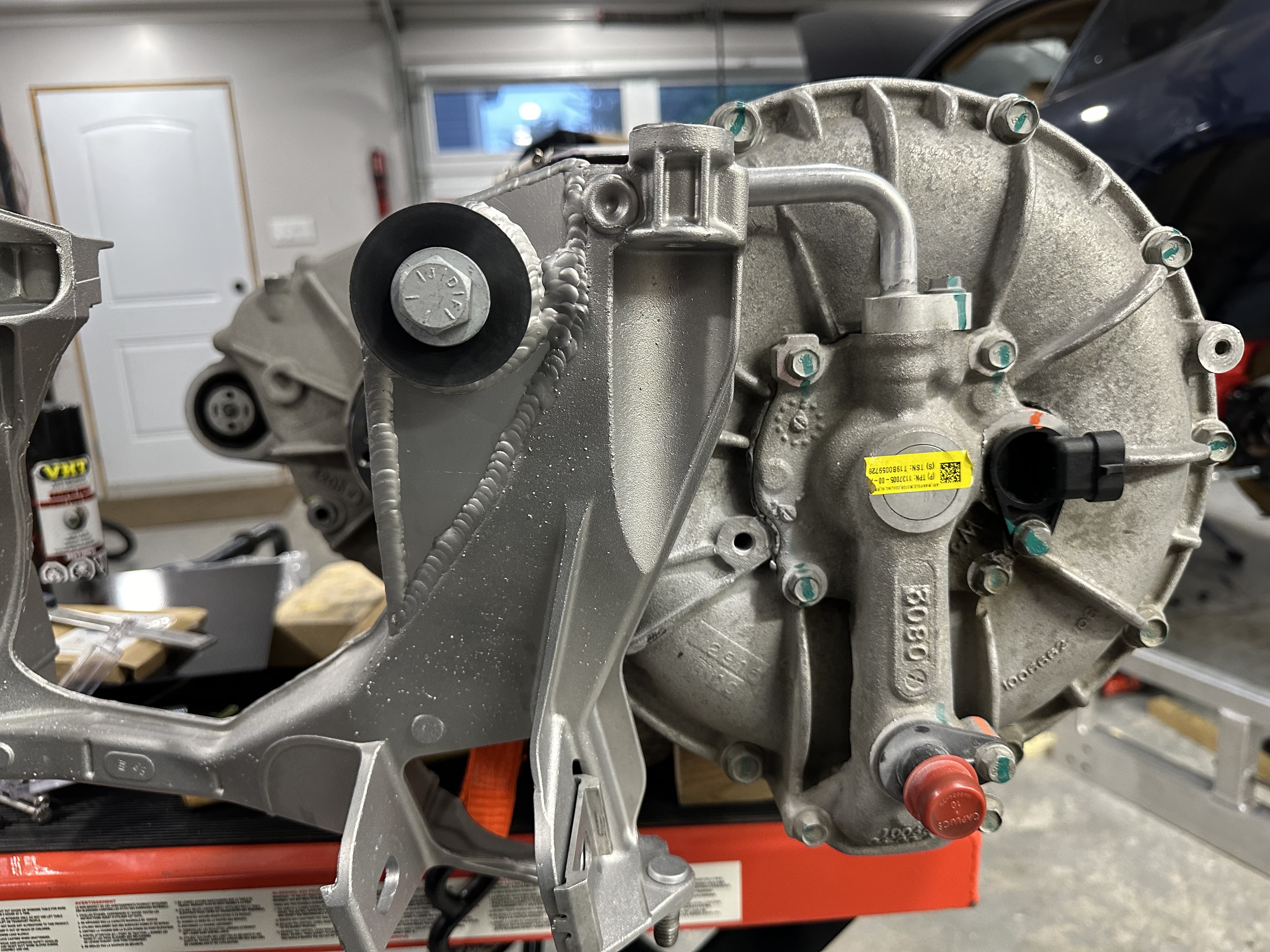

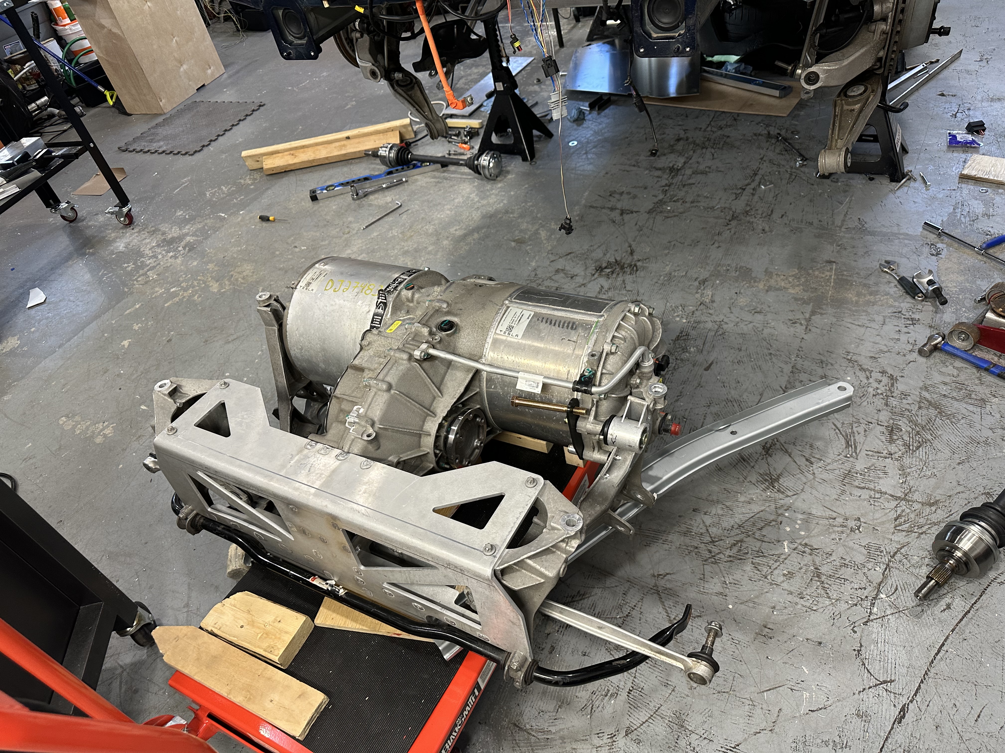

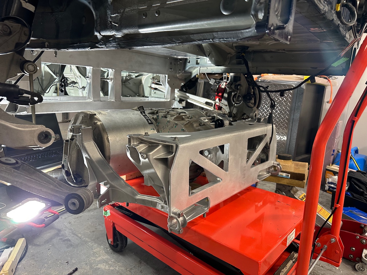

Motor Mounts continued…
So I realized that I have two previous posts for the motor mounts, you can check those out for the rear subframe adapter, as well as how the Chassis C-Channels were made.
In this post, I’ll try to put it all together, with the front mount that hangs between the C-Channels. As well as the motor side mount
Pics should be pretty self-explanatory:
Right C-Channel with Mounting Tabs:
Left C-Channel with Mounting Tabs:
Center Assembly with C-Channel sides connected:
Mounted in car - Front Mount Bolting
Center Tie-In with factory lower subframe ‘Spar’ pieces:
Left Tie-In from Below:
Right Tie-In from Below:
Side Mount - Attachment mockup on Subframe:
Motor, Subframe, and Lower Spars assembled:
Details of double shear motor mount setup, using only two of the bolt holes:
Side Mount Welded with bushing:
Side Mount Continued…:
Details of rear of motor bracket - Using Hex Slim-nuts as there isn’t much room, Lock-wired to secure:
Motor Subframe assembly, Ready for install:
Motor Subframe assembly, #2:
Mount/CV/Rear Trailing Arm Clearance:

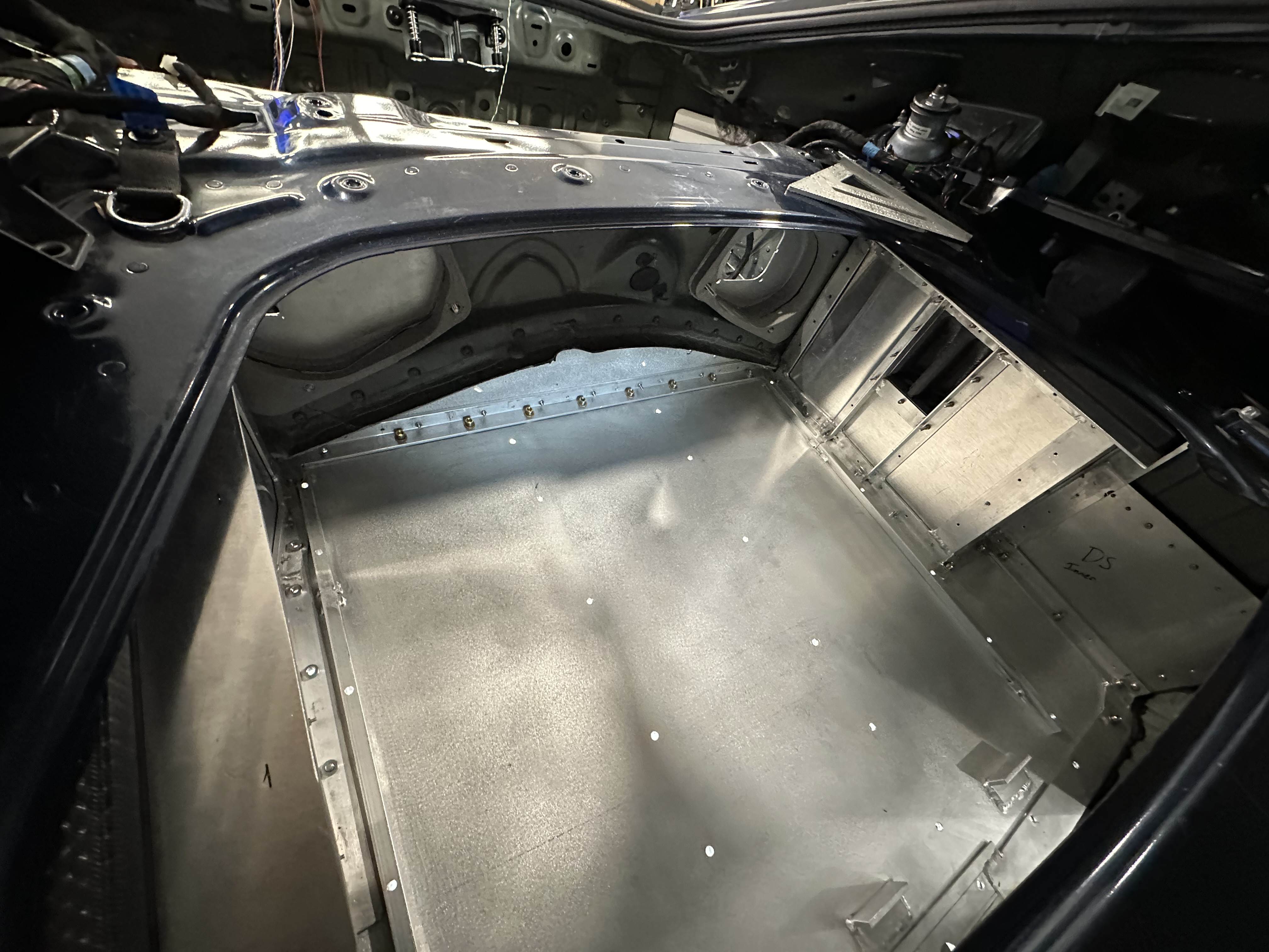

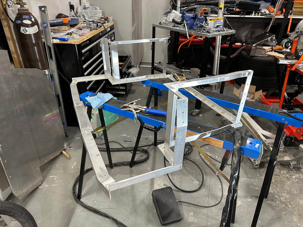

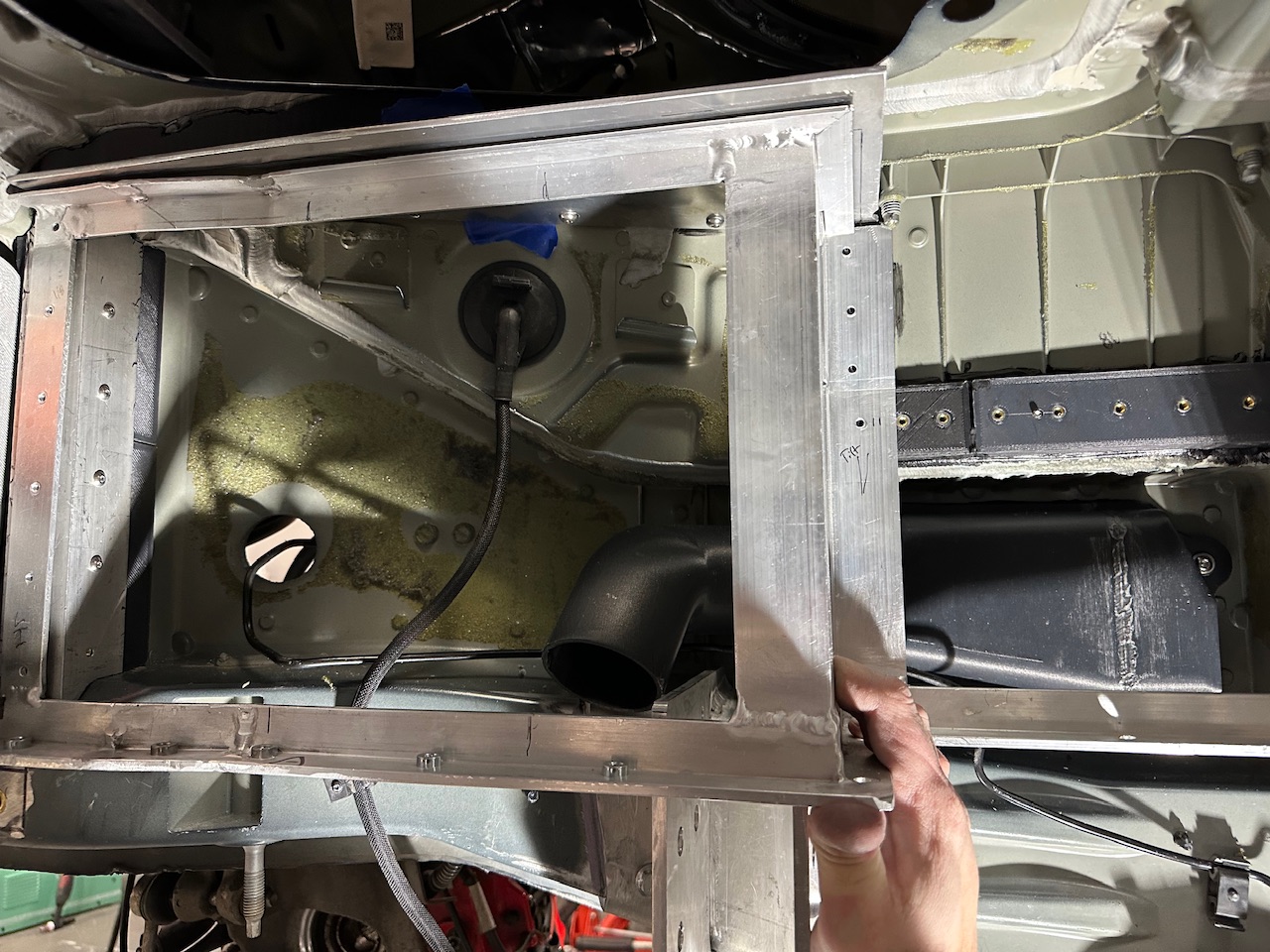

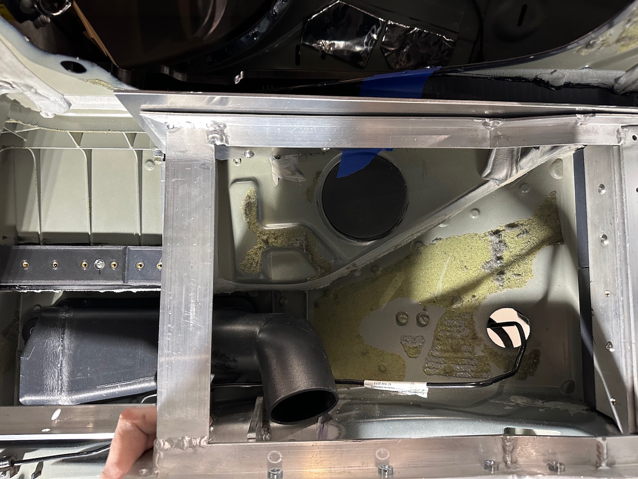

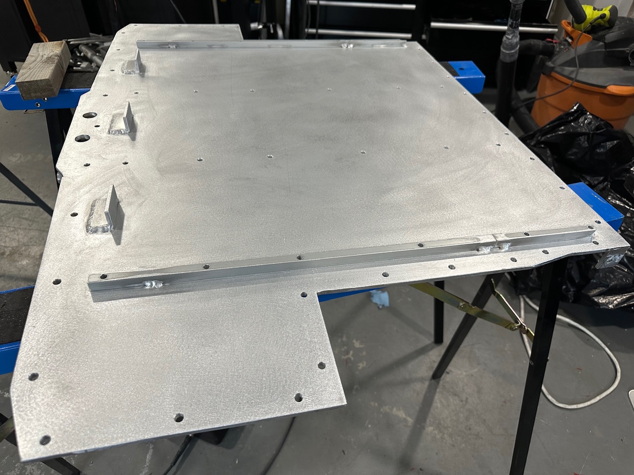

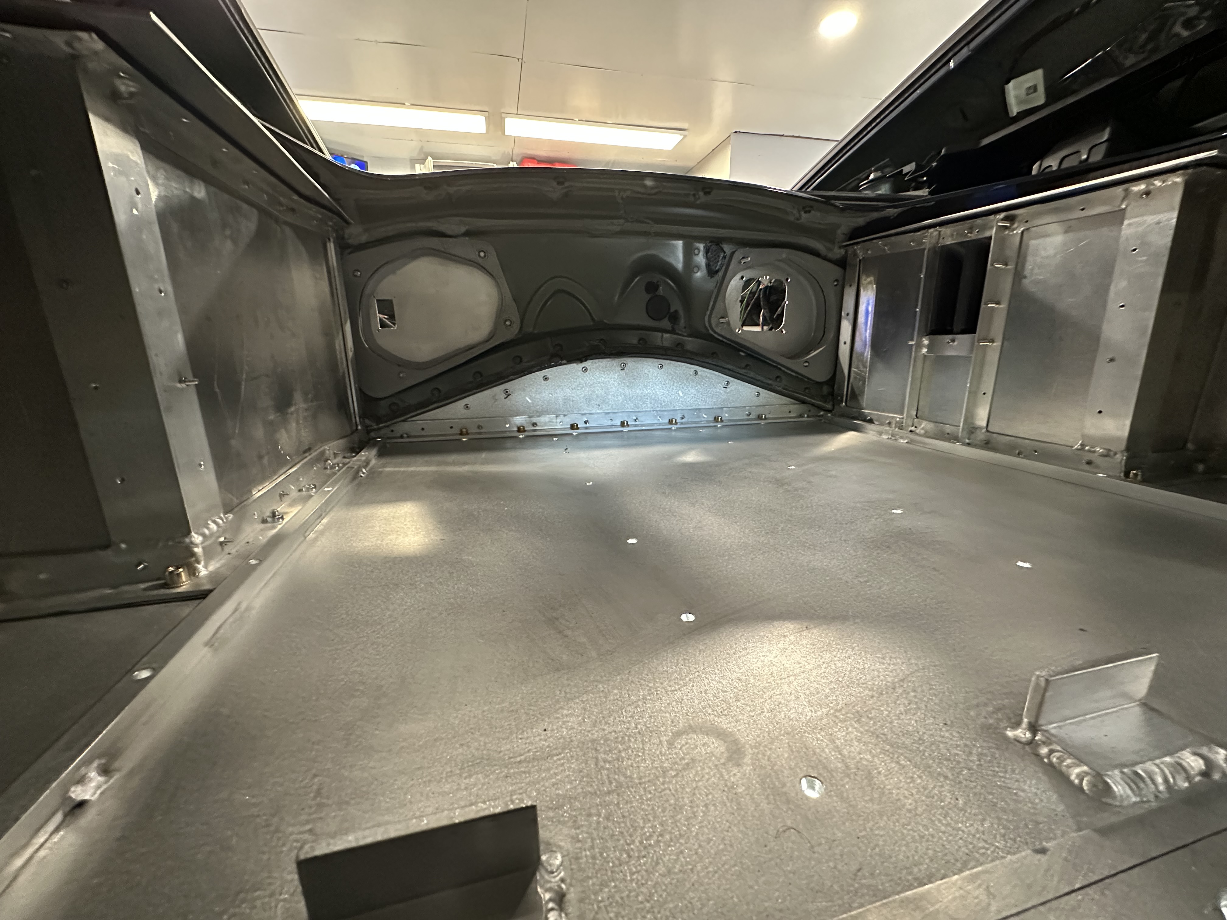

Battery Tray
I suspect this to be the most controversial part of the fabrication series :lol:
Given my poor battery choice, packaging was always going to be an issue.
Early on, it was decided to split the build into getting it moving with 1 pack, then migrating to the 2nd pack afterwards at a later time.
With the Chevy Spark packs being in a 16 cell pack config, they could be made into 32 cell modules easy enough by just eliminating the end plates for the packs, Also with my Volt Gen2 pack, I recovered a reverse coolant plate. (This is important later on)
After the decision to mount the batteries high up in the existing motor bay, it was clear that a separate box just wouldn’t fit…
With the 3d scanner, I decided to jump into making the motor bay into a battery box via 3d printed pieces to cope the vehicle stamping to straight lines. The adapter pieces were glued with polyurethane adhesive and bolted into the chassis at several points.
On the rear, the battery tray is closed off and supported off of the rear bulkhead ‘hoop’ of which I’ve used 4.8mm alu plate, riveted and structurally bonded to the chassis, from this, a angle piece is bonded and riveted.
Using a 6mm aluminum plate for the battery base structure, as well as some key structural points in the front and rear of the plate, the batteries are well sorted.
  • Did I make a squeaky mess for myself? Time will tell.
  • Is the 6mm plate basically a guillotine for ones mid section if in a rear end accident? Possibly.
Missing some key pictures for how the rear plate/support is attached right now, but will try to elaborate more on this in a later update

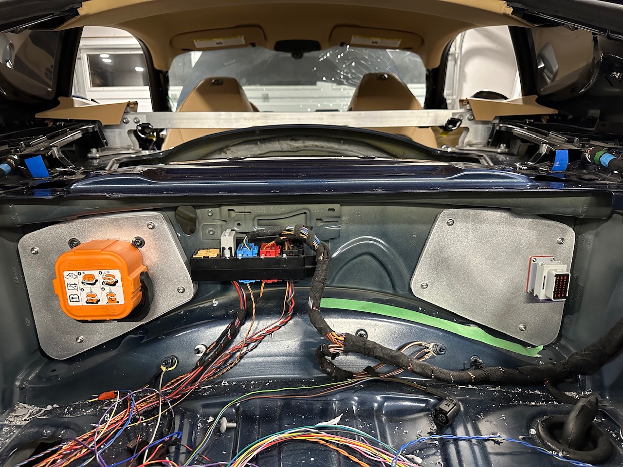

Rear Mid-Pack Disconnect. Mounted in previously bulkhead opening:
6mm Battery Tray with Front Battery Stops & Side Rails for battery mount:
Front of battery box/firewall adapter #1:
Front of battery box/firewall adapter #2:
Skeleton Frame on Left Side:
Skeleton Frame on Right Side
Skeleton Frame:
Skeleton Frame:
Frame Fully Enclosed With Battery Tray:

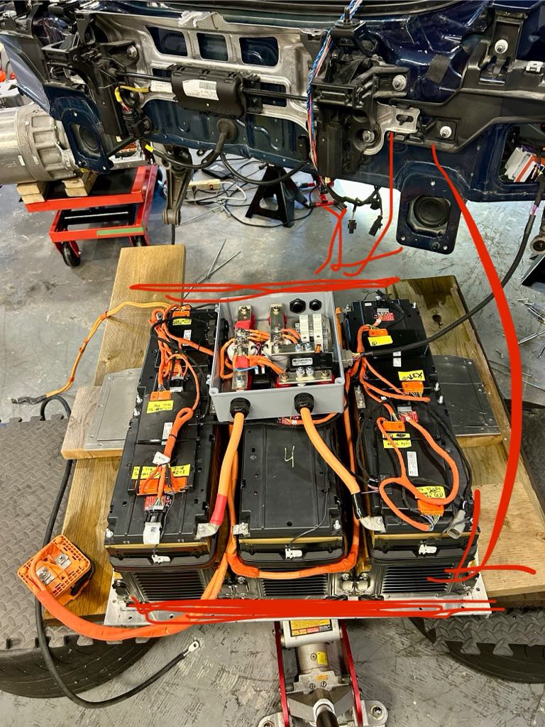

Batteries Mounted on Battery Tray, With HVJB, BMS modules & Disconnect:
Note in the above picture, the HV terminals for the JB are mounted inside, this was possible due to the previously mentioned ‘Reverse’ cooling plate, which allowed one of the 32 cell banks to be reverse of the others.
This also means that the HV terminals of the batteries are nearer to the inside, allowing more clearance to the chassis/battery box walls.
