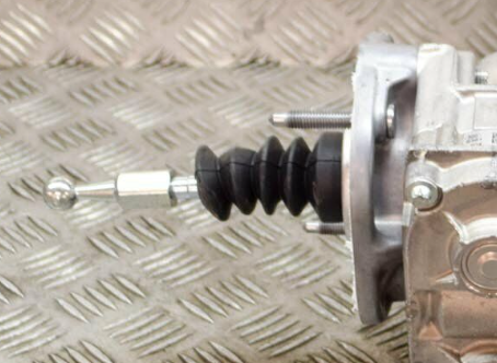

For the first generation booster, there are several bolt patterns, these match the general equivalent booster mounts.
Much of my data comes from EBay auctions and the Ross-Tech VCDS forum.

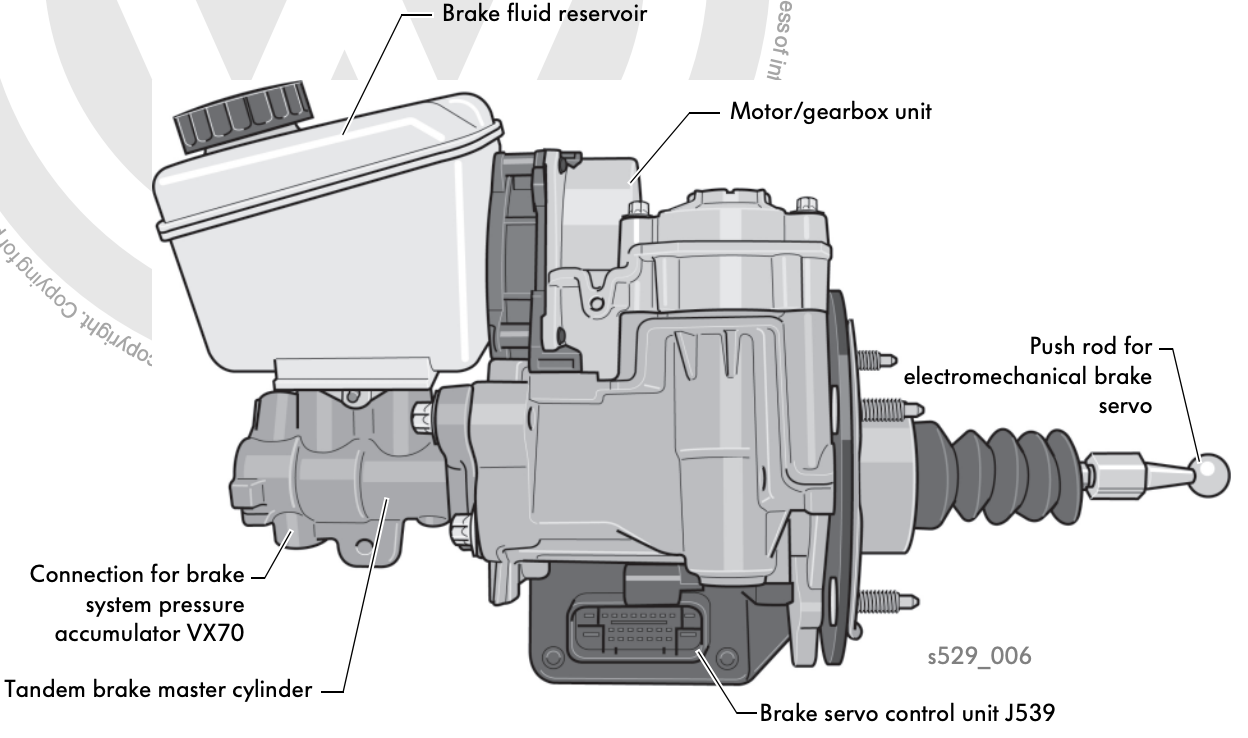

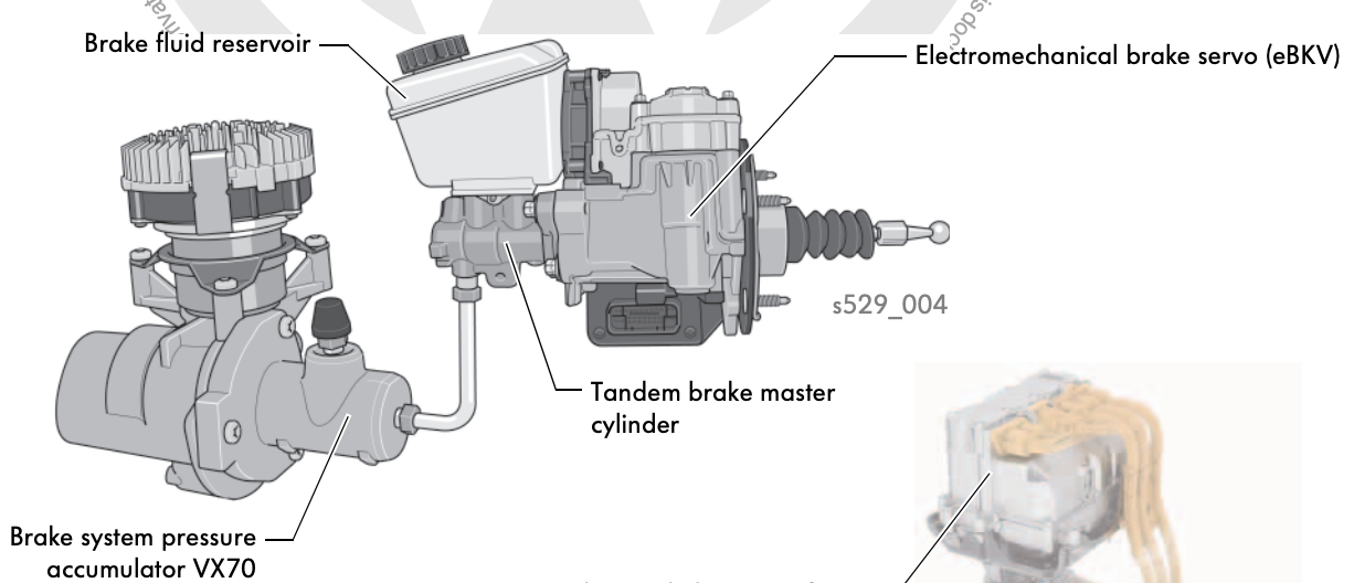

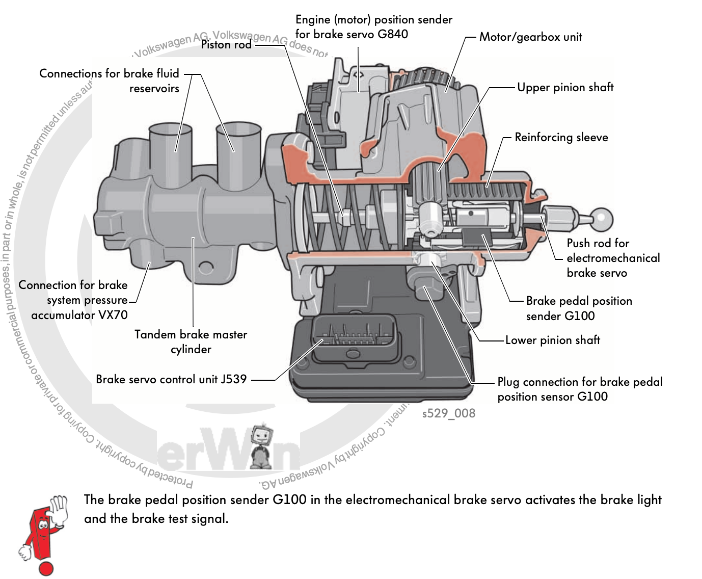

Pressure Accumulator "Smart Actuator" - There is also a brake accumulator module that ties into the 2nd port on the Brake Master Cyl. Some cars have this, others do not. I'm trying to find out what VCDS coding is responsible for this.
Seems it's there to allow to drop some pressure allowing a greater deadzone to aid regen.
I view this as more of an adjustable volume accumulator.
The Module is referred to as Vx70 in documentation
The main IBooster is referred to as the EBKV in documentation.
Module designation is J539 or NX6 in any wiring schematic.
It's Module 23 in all the ODIS/VCDS software.

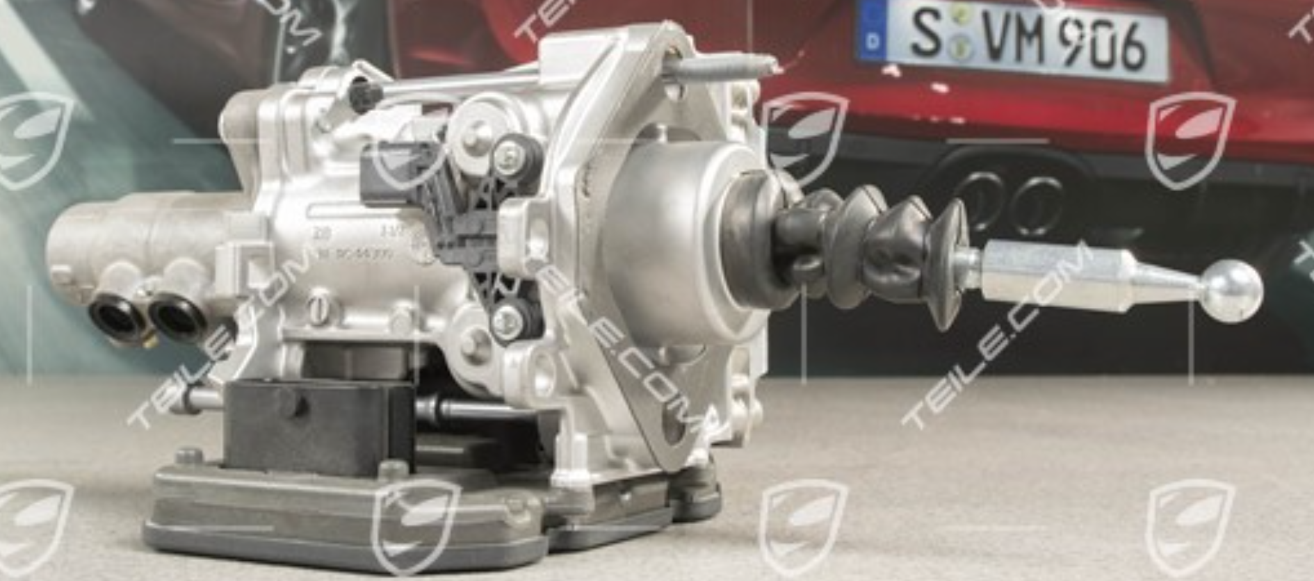

Bolt Pattern:
4 Stud Flanges:
2 Stud Flanges:
Seem to come in both a stamped steel flange and a deeper aluminum flange.

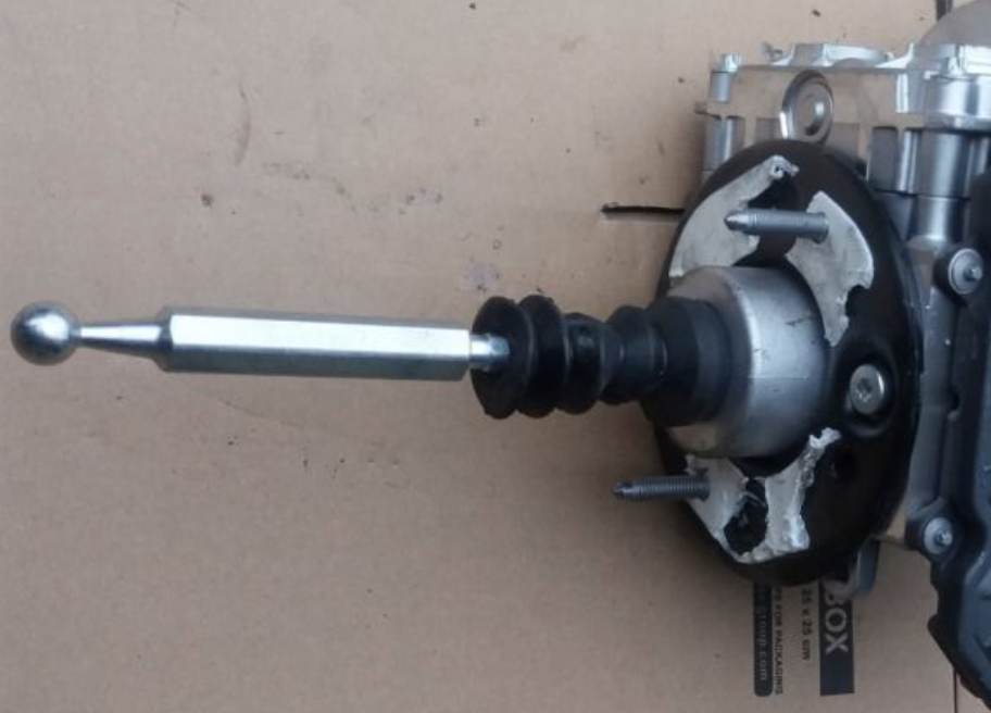

2 Bolt offset:
These best mimic many of the Vac Boosters
Have two M8 bolts and bolt into the factory firewall.

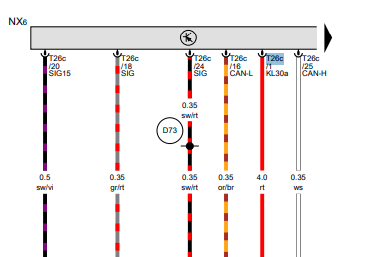

Wiring:
GEN2:
3Q0 modules - HW versions up to H06
Wiring:
ZF:
The ID4 appears to be using a ZF booster, likely not compatible with the wiring/form factor of the bosch units.
The modules will default to a fallback assist rate without CANbus, so are totally useable.
CANbus can be connected to try to have an adjustable assist rate depending on the driving mode. The CAN signal from the Booster can also be used to determine pedal position, etc.

Hey Tom, do you have the pinout for the MK8 golf Ibooster? looks like it uses different pins to the normal Ibooster setup, mainly looking for which of the two signal wires is the wake and what the other one is, permanent live and gnd and CAN are obvious.
EDIT found a wiring diagram: actually theres 3 signal wires.
Pin1 - permanent 12V
Pin9 - GND
Pin16 - CAN-L
Pin18 - Sig unsure
Pin20 - Sig15 (wake)
Pin24 - brake signal output
Pin25 - CAN-H
GEN2 Iboooster VW MK8 golf pinout.png (13.96 KiB) Viewed 1257 times
