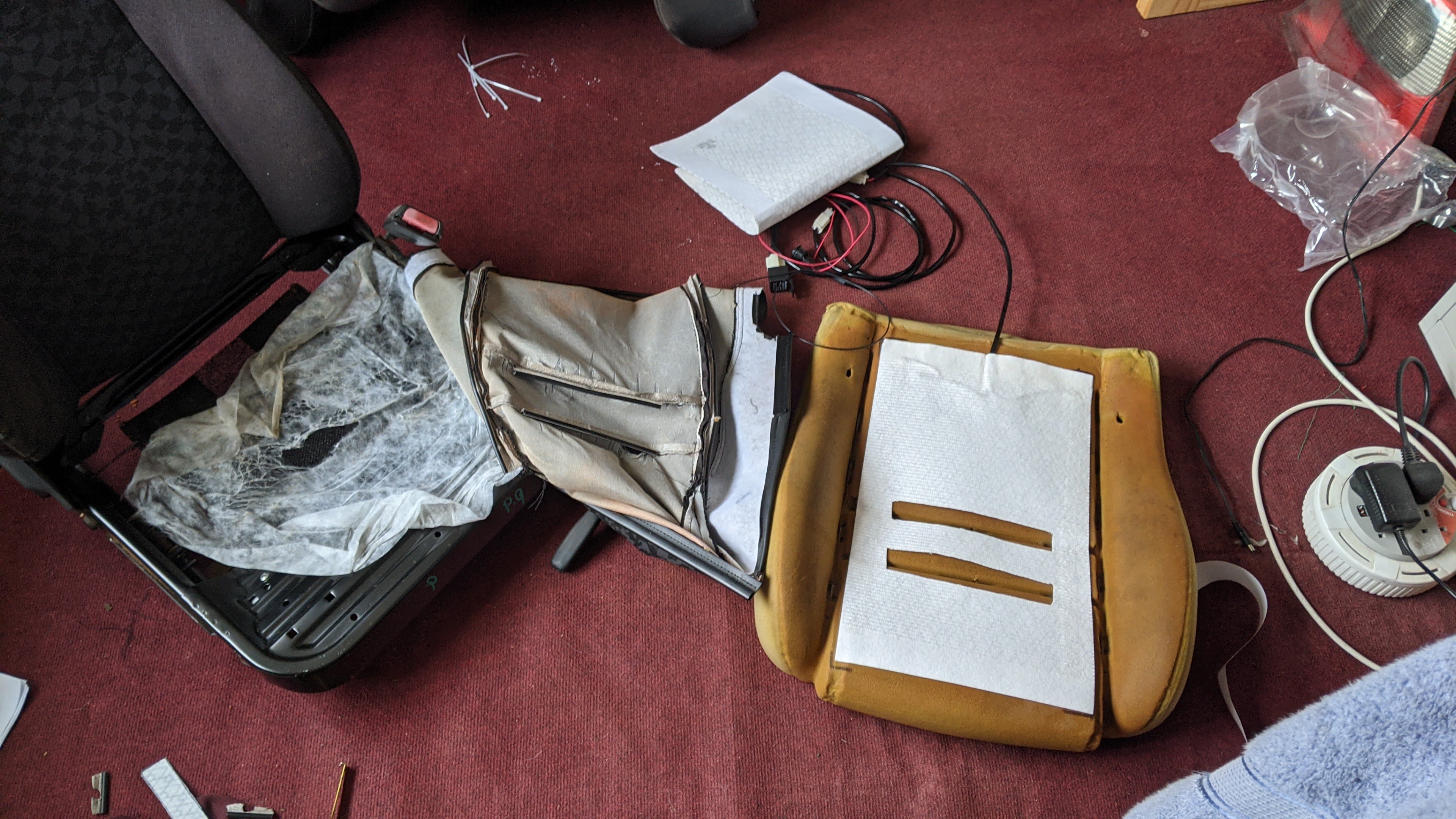

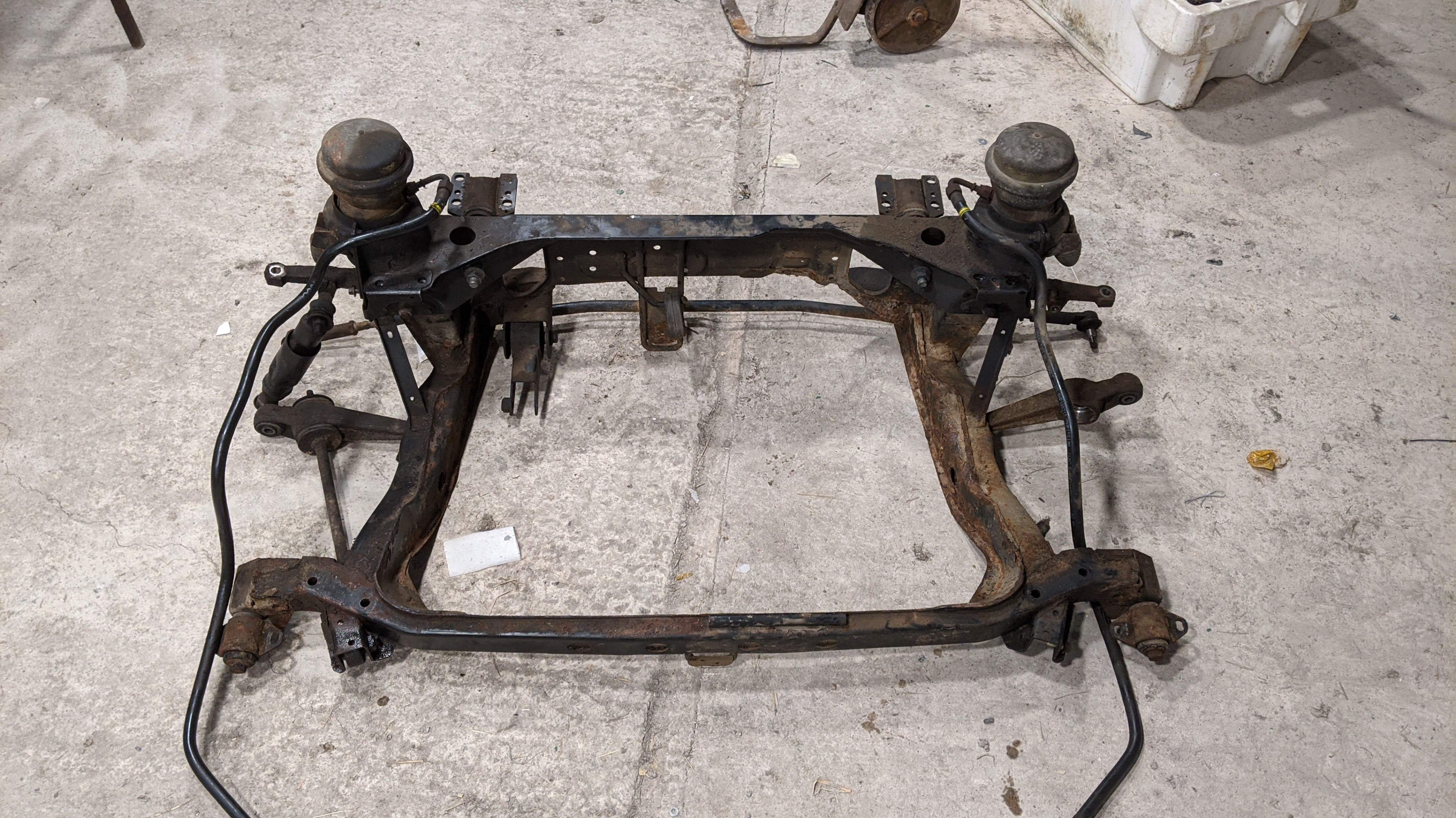

Engine has been sold. Subframe currently being cleaned up and repainted along with all the suspension components. It's all in pretty good condition given the age. No sign of anything more than just surface rust and road crude. Will wire brush everything down, treat hard to reach places with rust converter then Hammerite paint over everything.
Put a few of the smaller items in the Electrolysis tank, it's a bit overkill but it impresses people at the farm.
Took the fuel tank out after giving it a few weeks to shrink down a little bit(It's plastic). There is a good amount of space there, but I will have to wait on the batteries to arrive before I can figure out exactly how much I can fit there. It's a little narrower on the driver side so that might limit things.

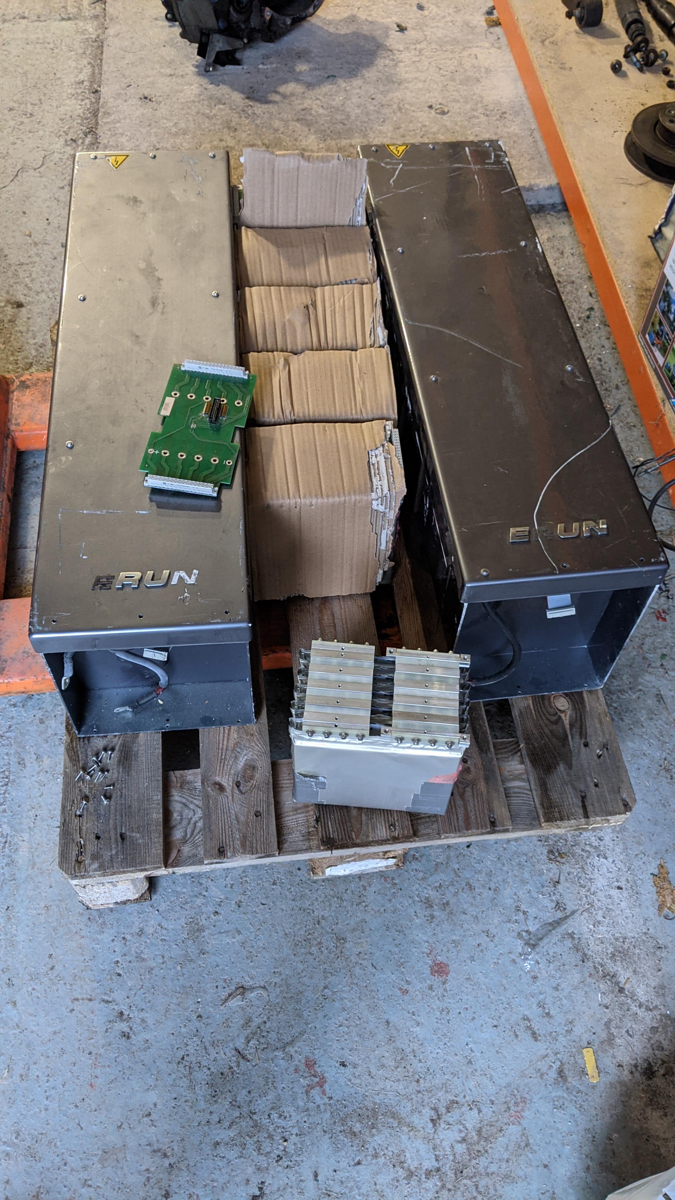

Talking of batteries I have those secured. Got in on the Kokam cells and have 180 cells on the way. Planning to use them in a 72s2p config. Should give a 266v nominal pack with a 28kWh capacity. The cells are rated at way higher discharge than my inverter can handle, so I figure that is a neat safety feature. Then I have a few spare cells for another quadbike or motorbike project.
So next steps are to carry on cleaning up the subframe, test mount the motor and inverter, make up the new battery and throw it all in. Easy...

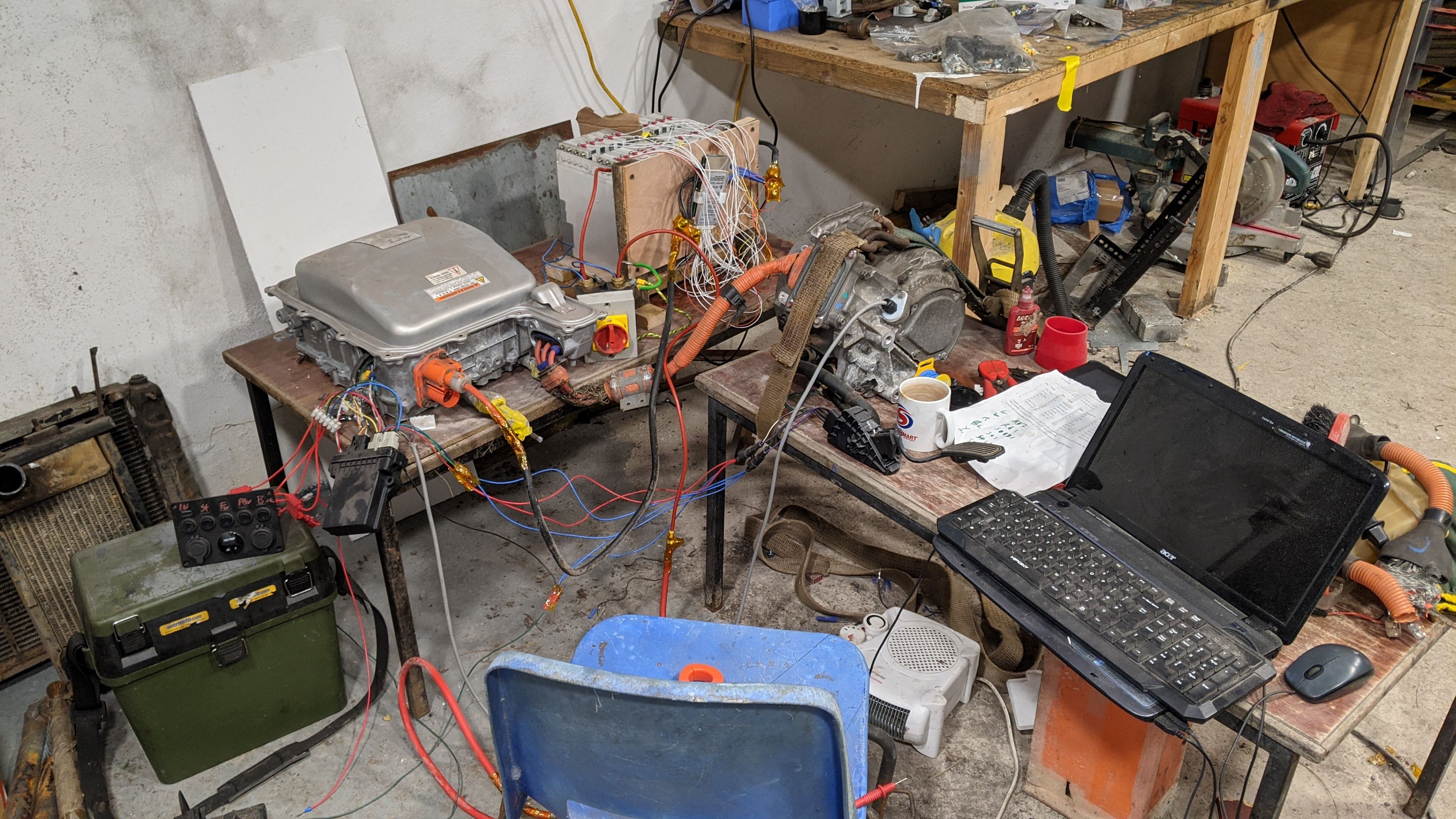

My plan is to do this and then test fit the subframe with motor and inverter mounted. This will then allow me to see how far back I can go with the batteries. Then I can make up a casing and the structure to hold the pack.

Subframe is almost all back together now with some fancy new polybushes in places and looking nicely painted. Then it's fabrication time to make the mounts. Time is being split between this, the MPCNC router build, 72v quadbike upgrade and the Defender. Too much time, not enough projects!

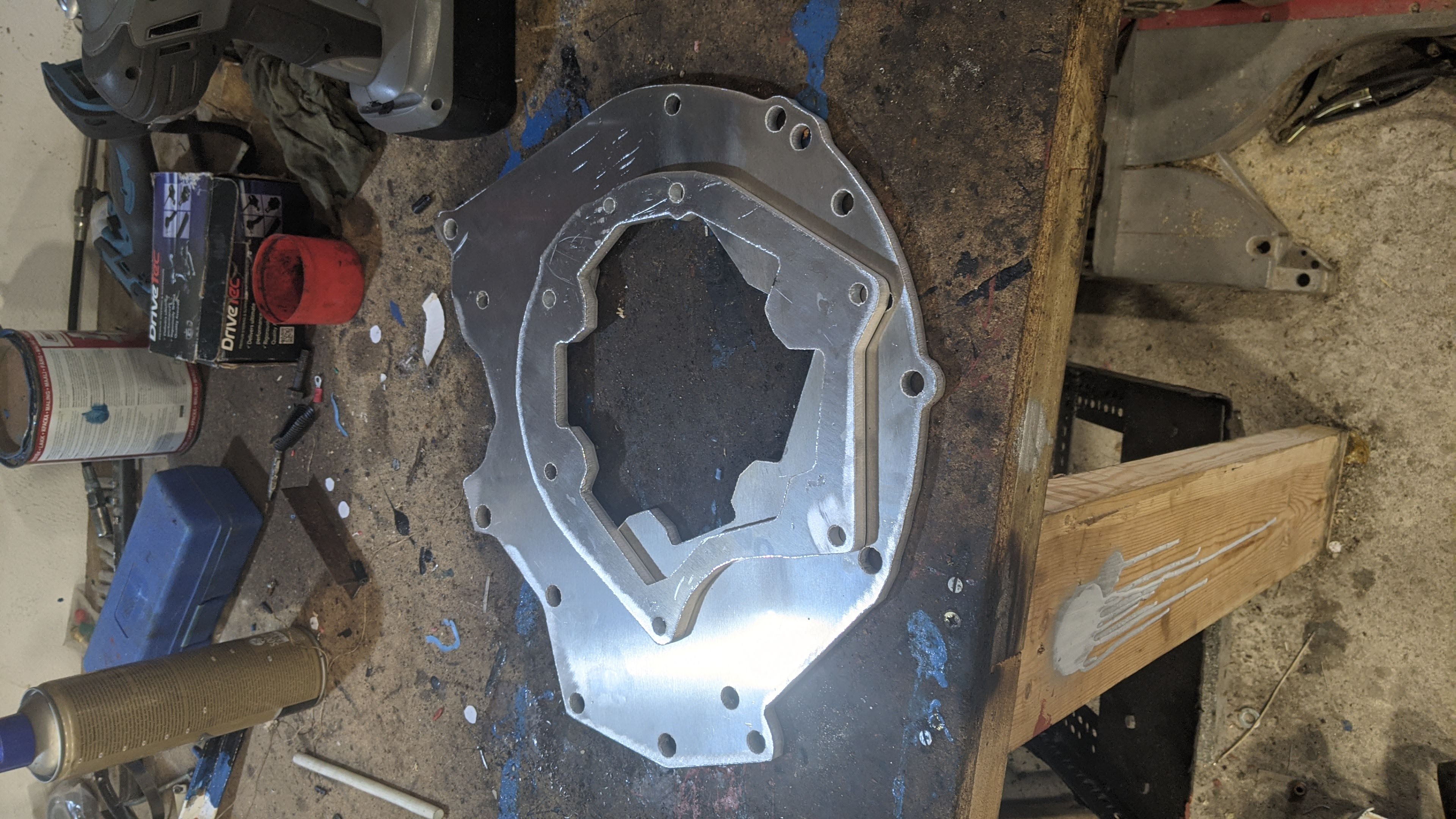

Re: MG F - Outlander Rear differential with Prius Gen 2 Inverter.
So a bit of a slight change in design now.

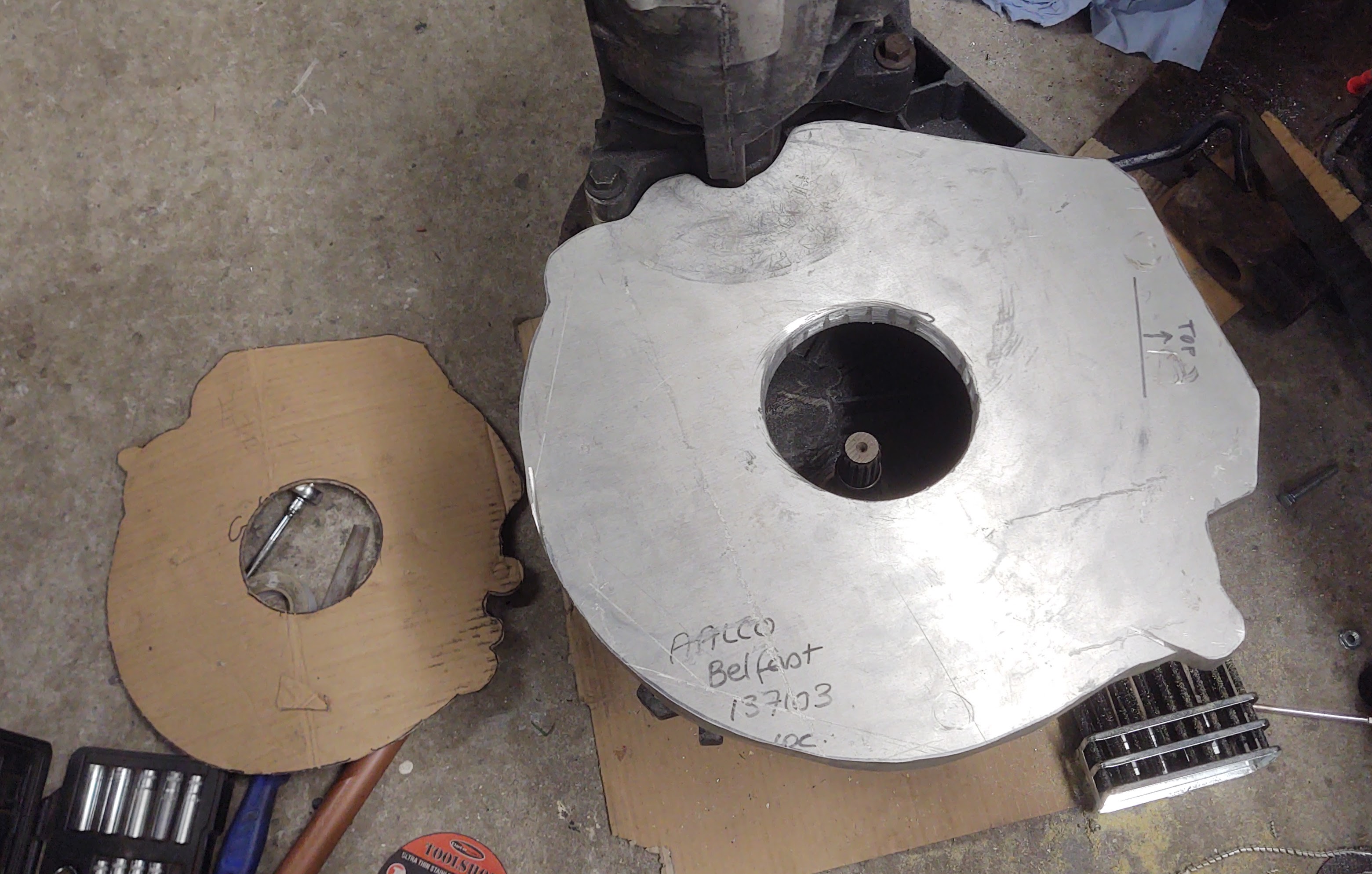

Subframe is all restored, and I was looking at mounting the Outlander motor/Diff. I did initially decide that I would make up the new driveshafts myself, using the two original pairs. Getting custom drive shafts made was was going to be around £200-300+VAT each!
However I realised that in the Outlander the motor is sat to the rear of the differential. Which meant that in my setup the motor would be backwards as that is the only way it would fit.
So I have decided that I will have the motor attach to the original gearbox via an adaptor plate. The pros of this setup:
The main con is the loss of efficiency by going through the gearbox, and now I have to put the gearstick back in the car.
- No making up drive shafts.
- Making up an adaptor plate is simpler.
- Makes mounting the motor in the subframe easier, as the gearbox already mounts on the one side.
- 2nd gear is almost exactly the same ratio as the Outlander Differential. 1st gear is a relatively big jump down in the ratio, so that will be the tyre spinning mode.
- Speedo will work again with no extra work
- Reverse light will work with no extra work.

That was pretty similar to what I had planned to do with the driveshafts.
But then I was wooed by the ease of using the gearbox and 2400nm to the wheels in first gear.

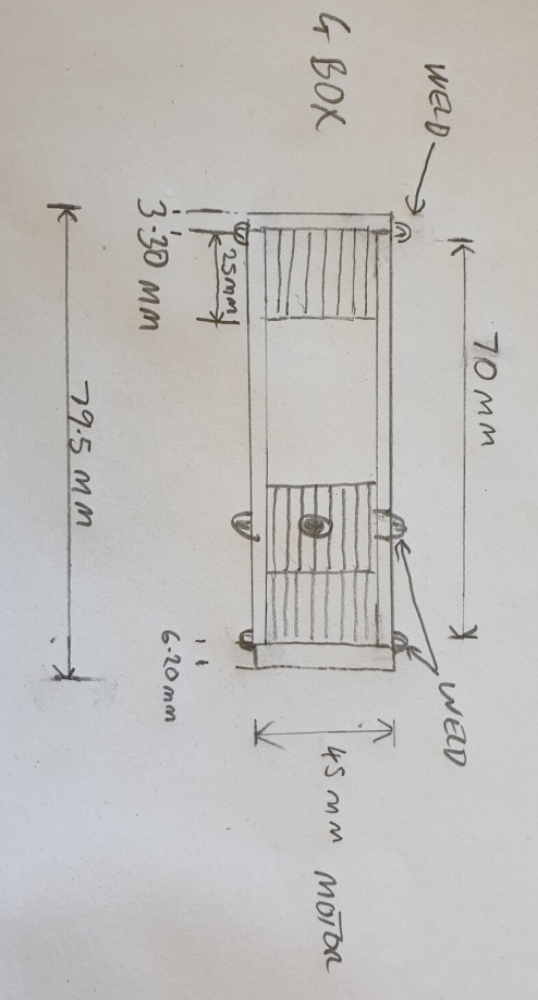

How do you plan to make the coupler?
Hopefully if it goes to plan mine will be made as shown below with two clutch disc centres on the motor side.

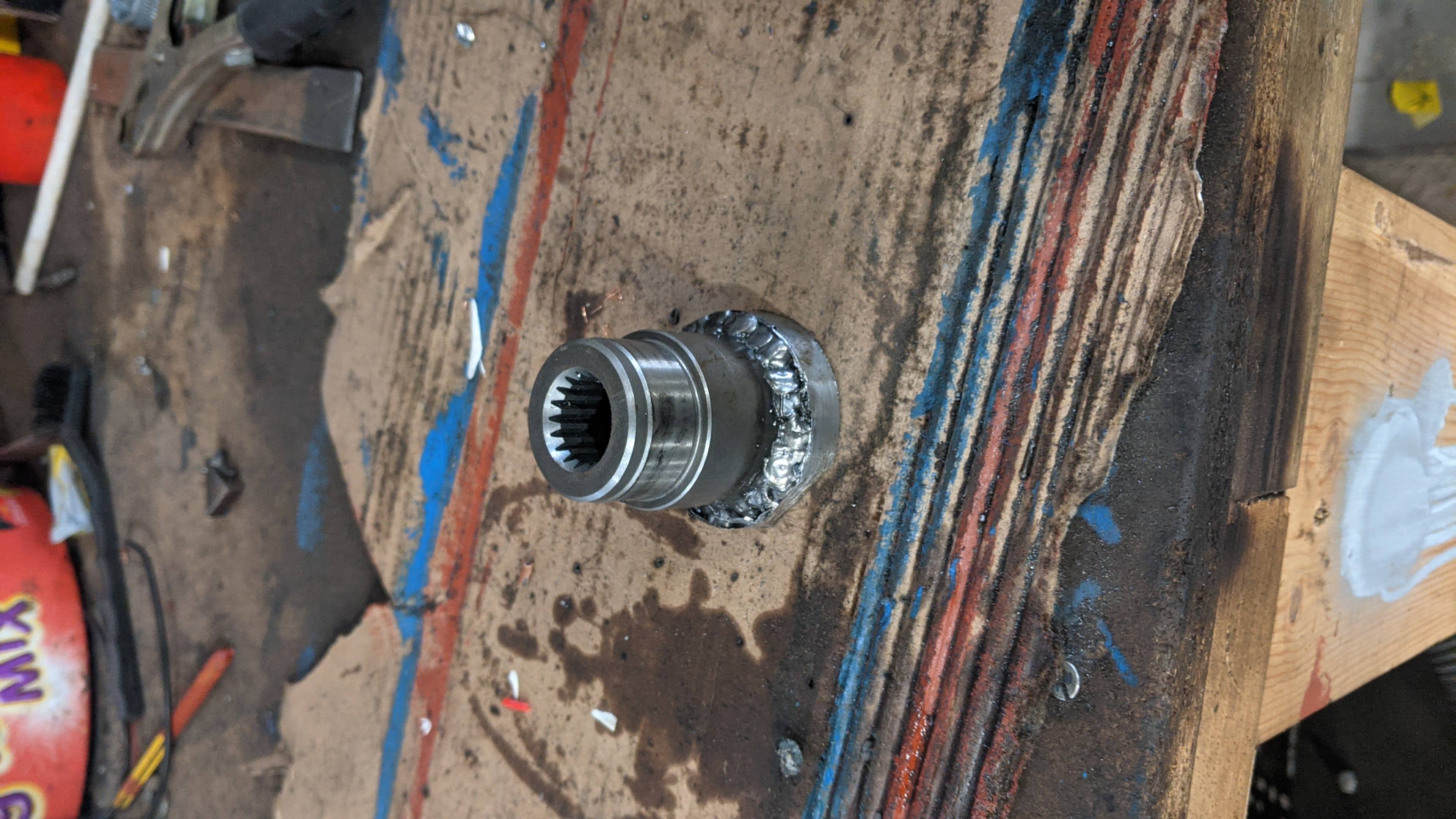

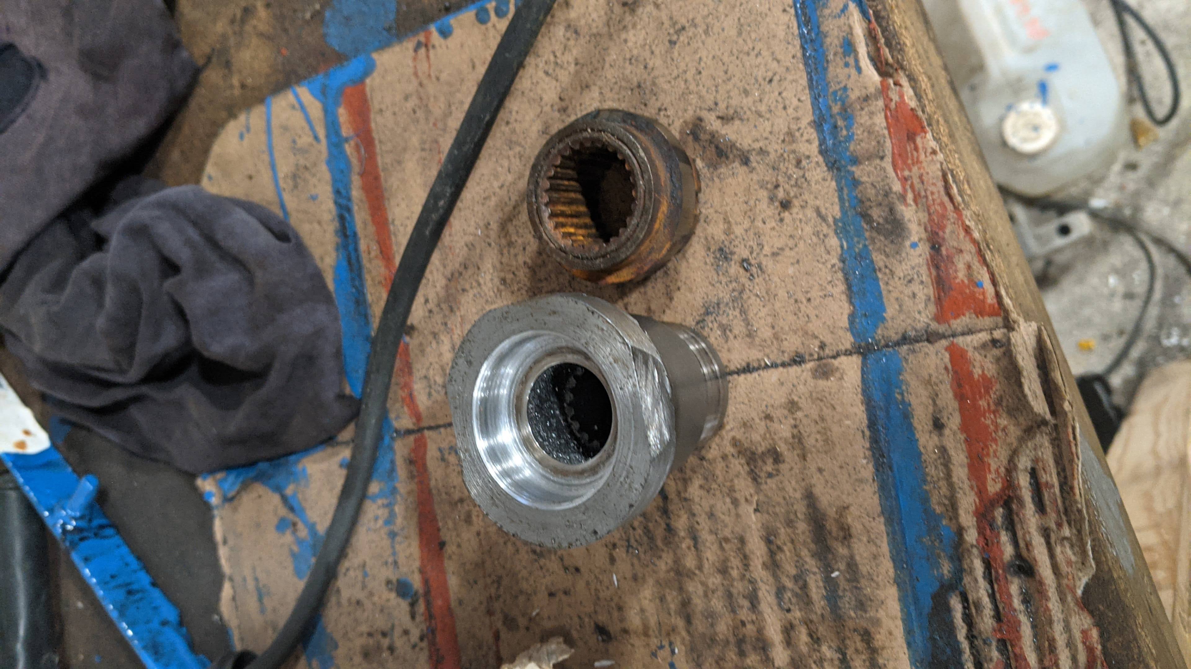

I haven't thought too far ahead to the coupler bar its going to be a tube with some internal splines in it.
Last time I was trying to get internal splines cut it was some obscure Japanese standard from the 1980s, didn't have much luck with that. I am hoping the more prevalent and modern nature of these two splines should mean they are easier to get machined.
If that doesn't work I'll use a similar approach to you. Clutch centre on the gearbox and the first gear centre from the Outlander diff.

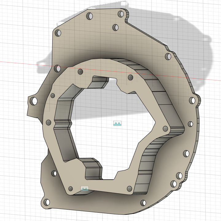

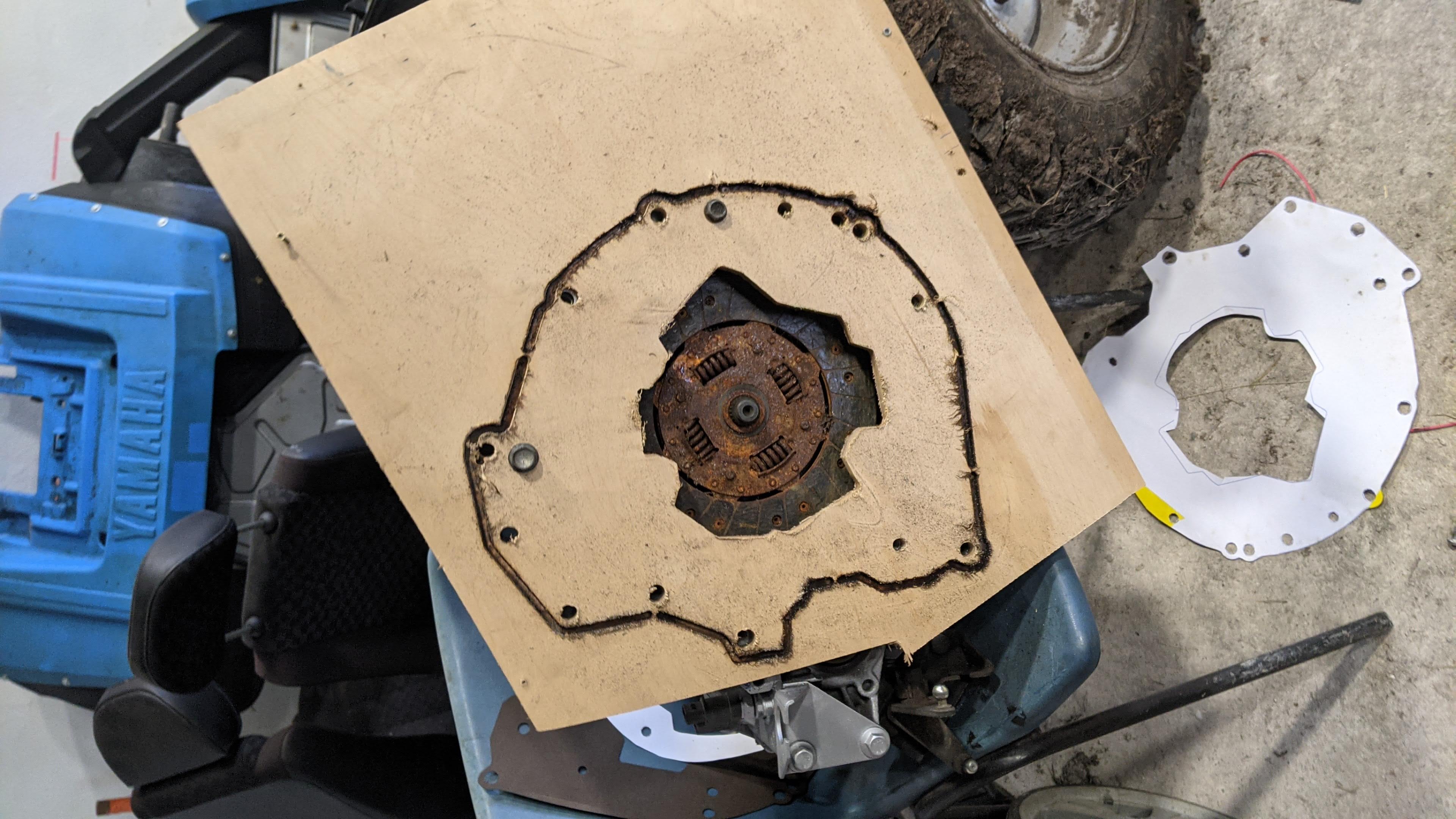

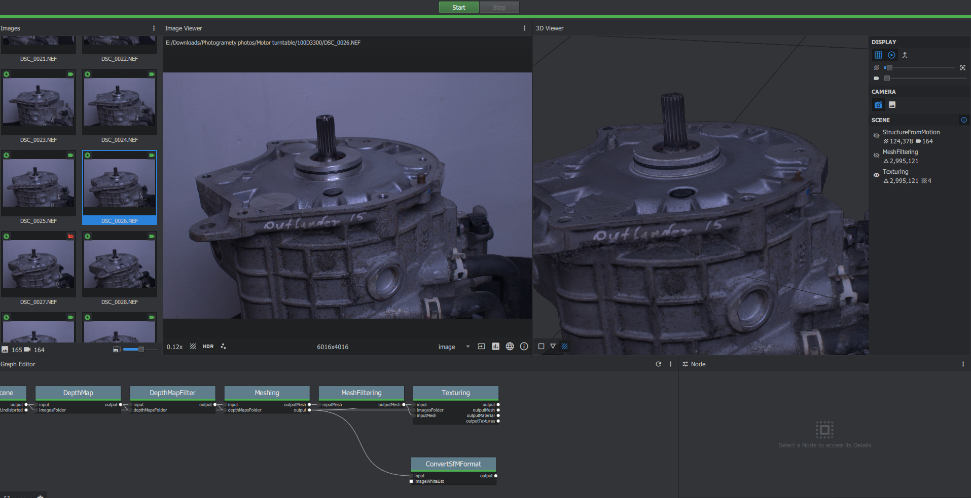

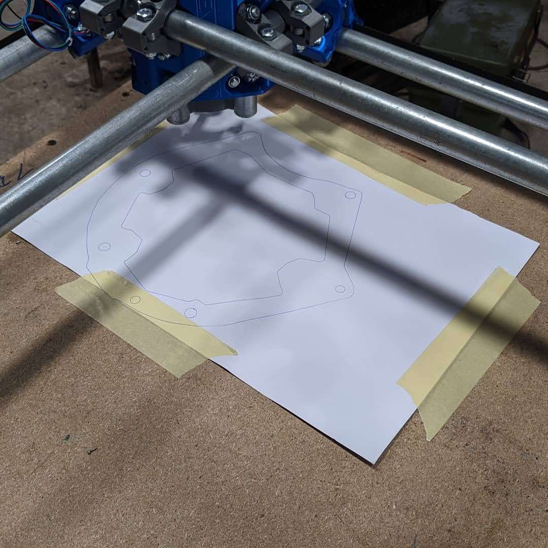

Currently working on some photogrammetry in order to design the adaptor plate. It's looking rather promising so far. Should have something to show off tomorrow. Time for a computer upgrade I think...

Lol, I just upgraded my pc with a new motherboard, processor and RAM but I would still be rubbish at creating a design for my adapter plate. I'll just stick to cardboard aided design and tracing with crayons.

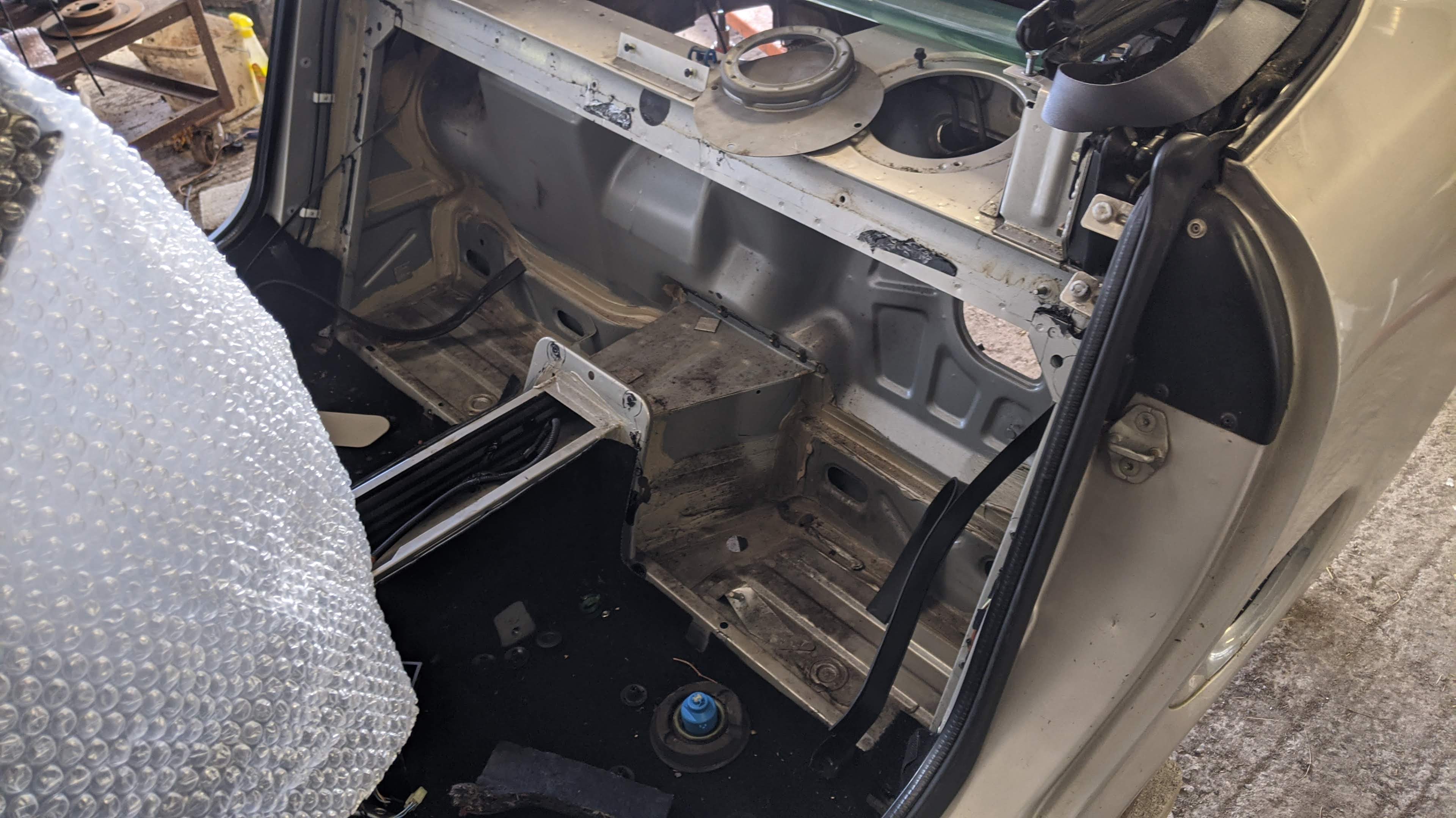

Be wary of cutting that rear bulkhead (fuel tank/engine bay fire wall). It may be made of only 1.6mm of Birmingham's finest steel, but it is a structural part of the car (torsional stiffness) - and even the boot firewall is structural in this regard. If cutting out, add cross-braces to get the torsional strength back.

I didn't realise the rear bulkhead was structural. So I'll be sure to add in cross braces if I do have to start cutting things out. I think I might be able to squeeze the batteries in above the motor, but that will be weight quite high off the ground. Once I get the motor and gearbox together and back in the subframe I will have a better idea of what space I have to use. I'm very keen to keep the boot area if I can. I don't like losing utility in a conversion.

What type of cells are you using?LRBen wrote: ↑Mon Nov 23, 2020 5:37 pm That's very useful information!
I'm currently only looking to put 40 cells in the front, I can fit this in the spare wheel area without cutting anything. I think I might look at putting 100 cells in the front and make some changes. That would be around 70KG of extra weight, minus spare wheel.

Managed to get my photogrammetry setup to a useable standard. When you add textures it actually looks pretty impressive, doesn't make it anymore accurate though.
I have now designed the adaptor plates to mate the motor and gearbox. Planning to get some mockups made in either plywood or just thin sheet steel to make sure the holes all line up. Then I can make up a shaft connector with a couple clutch hubs.

Looking good mate.
Better than my CAD template.

I have been making slow but steady progress on this over winter. Finished my MPCNC over christmas and used that to sketch the cad design outlines onto paper, made a few adjustments and then tried it on plywood.
Still need to figure out correct spindle speeds and feed rates, as well as find some router bits that are not made of chinesium. However I managed to cut enough of a template out of plywood to confirm that the holes are in the right place. I have sent the designs off for laser cutting now.
Having heard nothing back from enquiries I made about getting a coupler made up I think I might have to do this myself. Current plan in my head is to use the hub from the gearbox clutch for that side, then the input gear from the Outlander differential for the motor side. Smoosh them together with a lathe/press/hammer/welder and it should be good. There was an old Ben Nelson video on couplers for electric cars which actually explained it much better. I'll go into more detail if I do it myself, otherwise I might get an engineering friend to do the complicated machining for me.
I have also put the motor back on the test bench and I'm attempting the FOC tuning finally. This time with a 72v battery made up from some of the spare Kokam cells and my old quad BMS. I realised that I need to go back to the resolver wiring and ensure the sin/cos polarities are correct, so cycling those those and then doing the FOC tune is my current plan for the weekend. It is slowly coming together in my head and making sense.

Got my adaptor plates this week. Only done a very quick test but it looks like they fit good enough. Standoffs are now also on order.
Just need to get my lathe working so I can complete the coupler then I can do a real test fit. Also played around with some other parts that need doing on the car. Got some heat pads from Ebay and installed those under the covers, the end results look pretty good.

Finally got my lathe in a semi functional state this last week so I was able to get started on the coupler to connect the motor and gearbox.
I did keep pretty closely to my original plan, I used the hub from the PG1 clutch plate and the input gear from the Outlander motor differential.
First I welded on a 10mm plate to the differential gear then put this on the lathe and machined it down, then machined the other side to accept the clutch hub. I then froze the clutch hub overnight and in the morning put a little bit of heat on the other side and pressed them together. Stuck some weld around the sides for good measure. The weld looks a bit messy but I was spot welding on four opposite spots each time before letting it cool down completely, so no fancy weld beads for me. I also cut the corners of the plate off before putting it in the lathe, this was a mistake as I cut off a bit too much.
I forgot to actually take a photo of the coupler when it was done. I was too excited to attach the motor to the gearbox. It spins up nice and smoothly so its a good first sign. I have some different spacers on order and some more bolts, as Mitsubushi like their fine pitch threaded bolts. So next week I plan to drill out out the rest of the holes on the adaptor plate and fully mount the motor to the gearbox. Then I can do some test fits to the subframe and get a better idea for how much battery space I actually have.
If I were to do this again, I would start with some round stock big enough to act as a collar for both gears, then machine it down and shrink fit on both ends.
Would you be able to share a DXF or similar of the Outlander flange details?
The Outlander flange was taken from the differential. I just took out the first gear that the motor connects to and chopped off the bit I didn't want.
