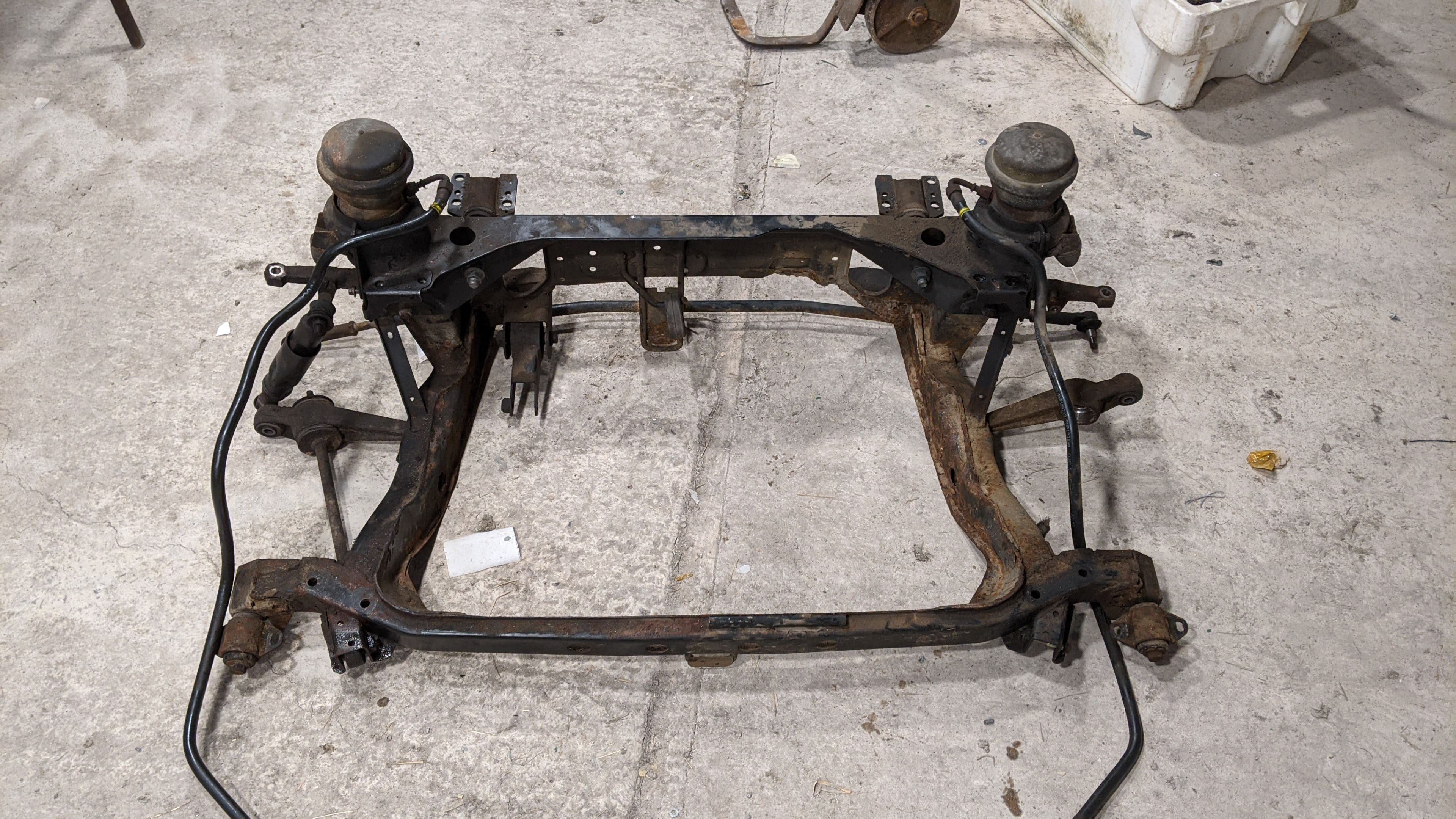

Engine has been sold. Subframe currently being cleaned up and repainted along with all the suspension components. It's all in pretty good condition given the age. No sign of anything more than just surface rust and road crude. Will wire brush everything down, treat hard to reach places with rust converter then Hammerite paint over everything.
Put a few of the smaller items in the Electrolysis tank, it's a bit overkill but it impresses people at the farm.
Took the fuel tank out after giving it a few weeks to shrink down a little bit(It's plastic). There is a good amount of space there, but I will have to wait on the batteries to arrive before I can figure out exactly how much I can fit there. It's a little narrower on the driver side so that might limit things.
Talking of batteries I have those secured. Got in on the Kokam cells and have 180 cells on the way. Planning to use them in a 72s2p config. Should give a 266v nominal pack with a 28kWh capacity. The cells are rated at way higher discharge than my inverter can handle, so I figure that is a neat safety feature. Then I have a few spare cells for another quadbike or motorbike project.
So next steps are to carry on cleaning up the subframe, test mount the motor and inverter, make up the new battery and throw it all in. Easy...

Subframe is almost all back together now with some fancy new polybushes in places and looking nicely painted. Then it's fabrication time to make the mounts. Time is being split between this, the MPCNC router build, 72v quadbike upgrade and the Defender. Too much time, not enough projects!

So a bit of a slight change in design now.
Subframe is all restored, and I was looking at mounting the Outlander motor/Diff. I did initially decide that I would make up the new driveshafts myself, using the two original pairs. Getting custom drive shafts made was was going to be around £200-300+VAT each!
However I realised that in the Outlander the motor is sat to the rear of the differential. Which meant that in my setup the motor would be backwards as that is the only way it would fit.
So I have decided that I will have the motor attach to the original gearbox via an adaptor plate. The pros of this setup:
The main con is the loss of efficiency by going through the gearbox, and now I have to put the gearstick back in the car.
- No making up drive shafts.
- Making up an adaptor plate is simpler.
- Makes mounting the motor in the subframe easier, as the gearbox already mounts on the one side.
- 2nd gear is almost exactly the same ratio as the Outlander Differential. 1st gear is a relatively big jump down in the ratio, so that will be the tyre spinning mode.
- Speedo will work again with no extra work
- Reverse light will work with no extra work.
