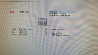

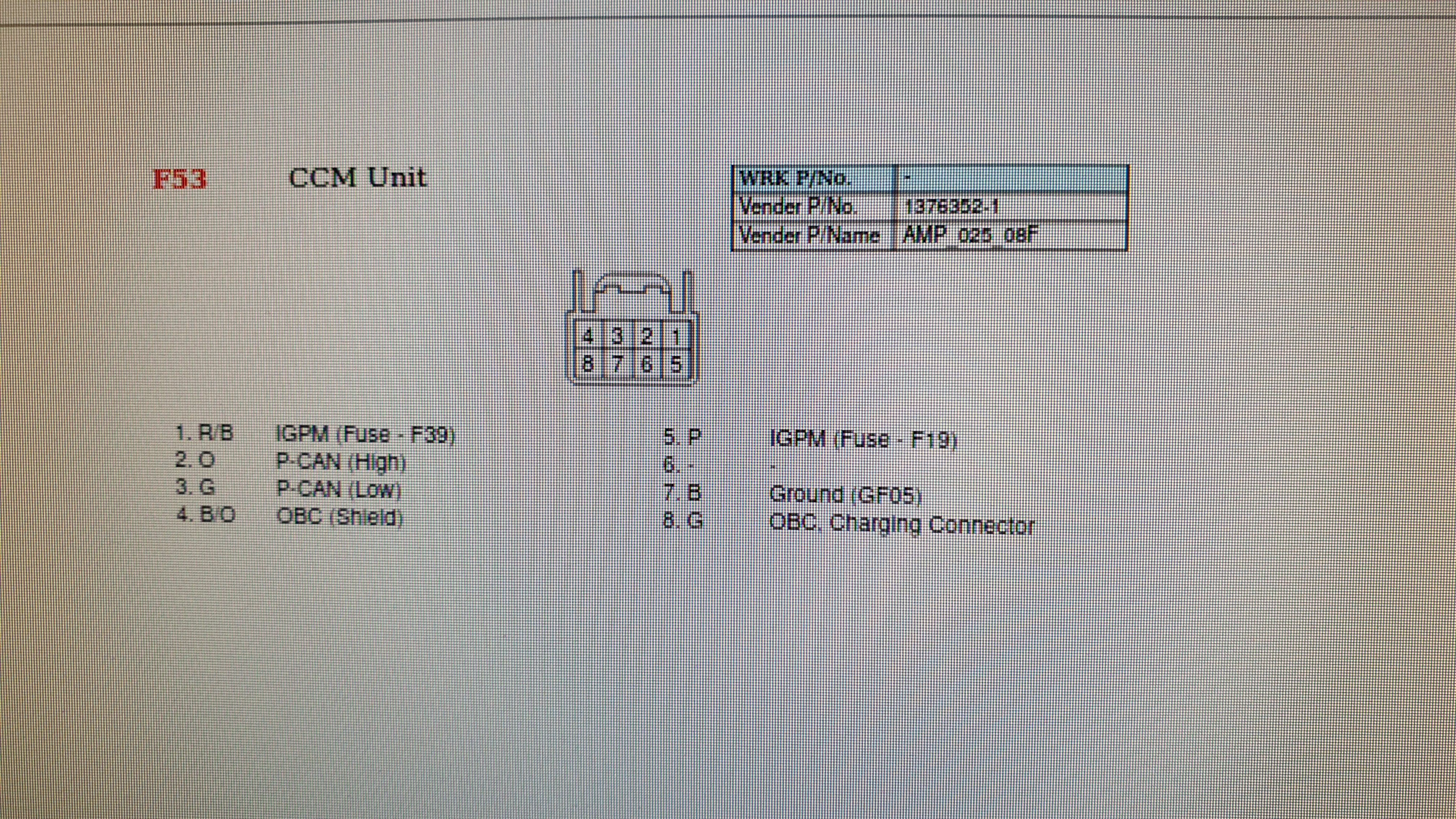

Finally found in in the very-hard-to-navigate Hyundai service site
1 CANH
2 CANL
3 CP
4 GND
5 CP Shield
6 Permanent power
7 Unused
8 Ignition
2 CANL
3 CP
4 GND
5 CP Shield
6 Permanent power
7 Unused
8 Ignition

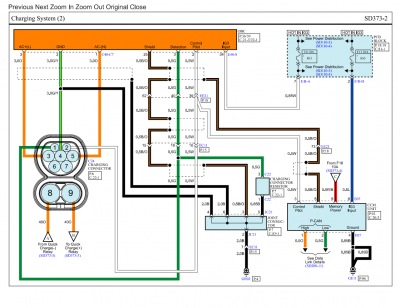

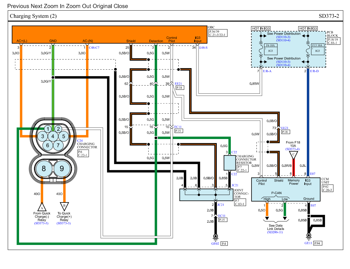

Great!mikeselectricstuff wrote: ↑Tue Dec 01, 2020 5:38 pm Finally found in in the very-hard-to-navigate Hyundai service site
We have access to a Ioniq and will build a T cable so we can monitor the signals without damaging the car. We hope to have some CAN logs in a couple of weeks
mikeselectricstuff
- Posts: 120
Re: Hyundai Kona CCS controller

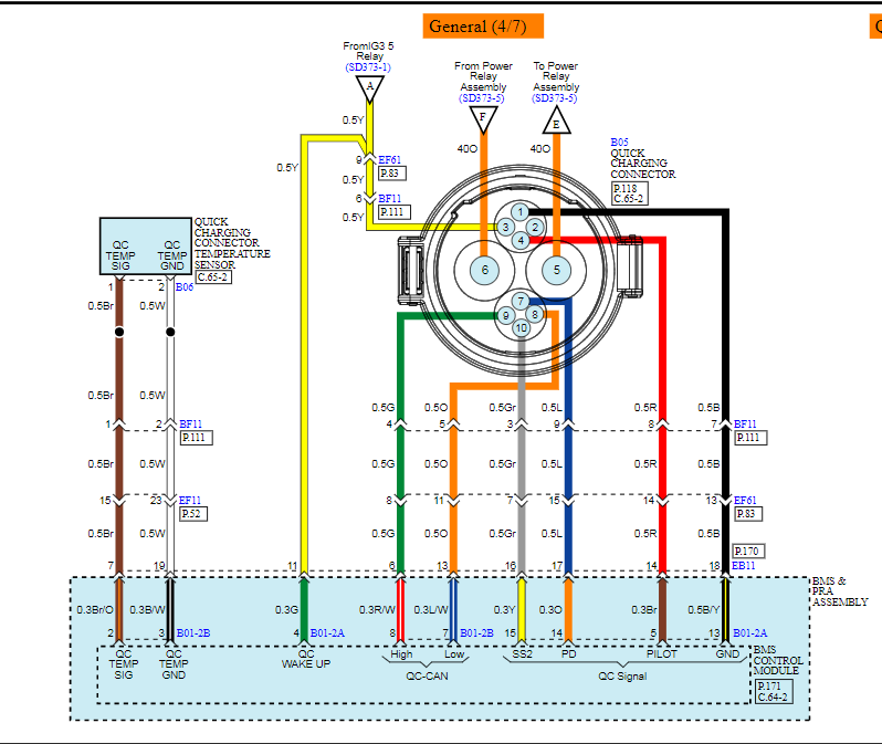

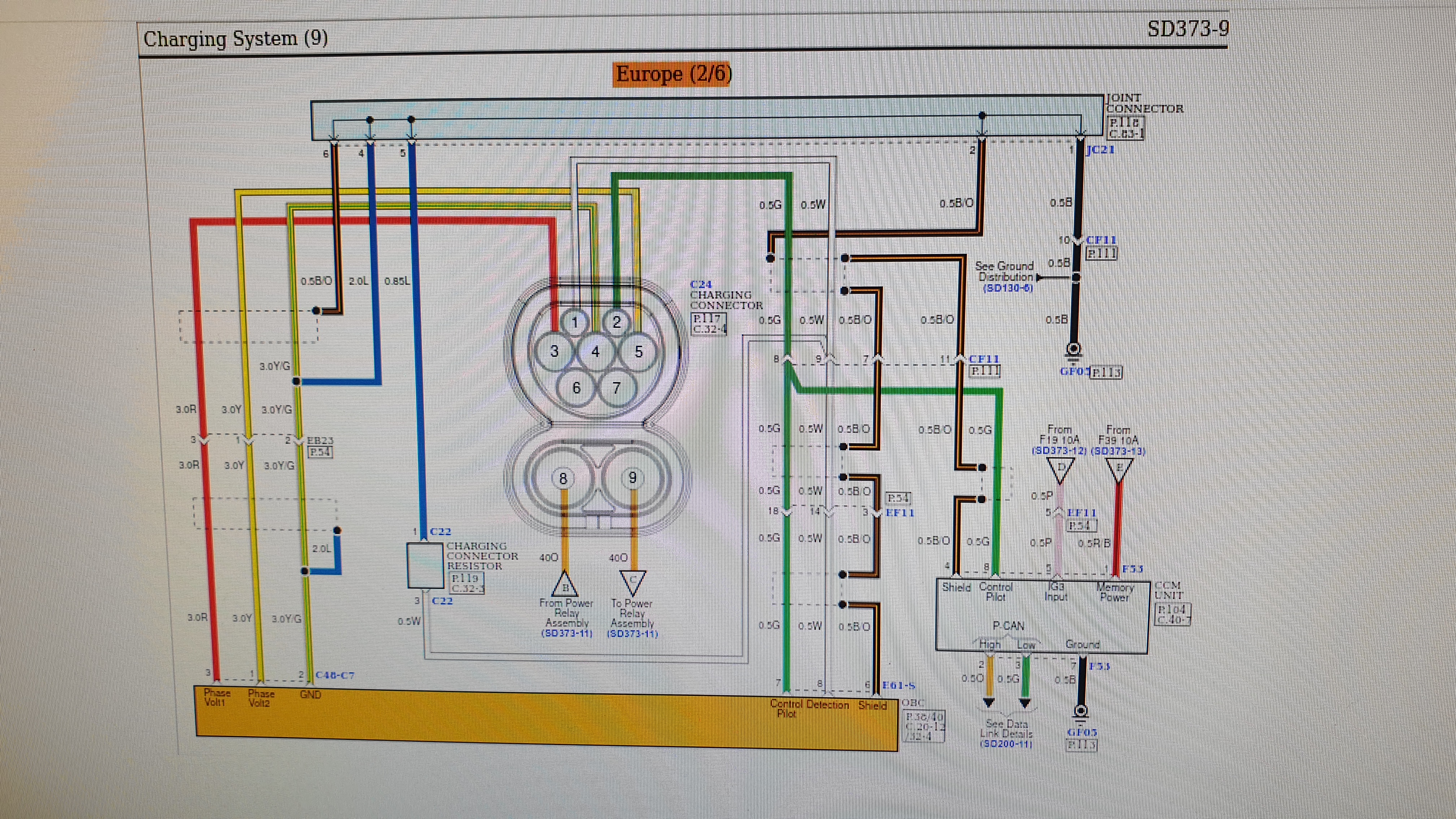

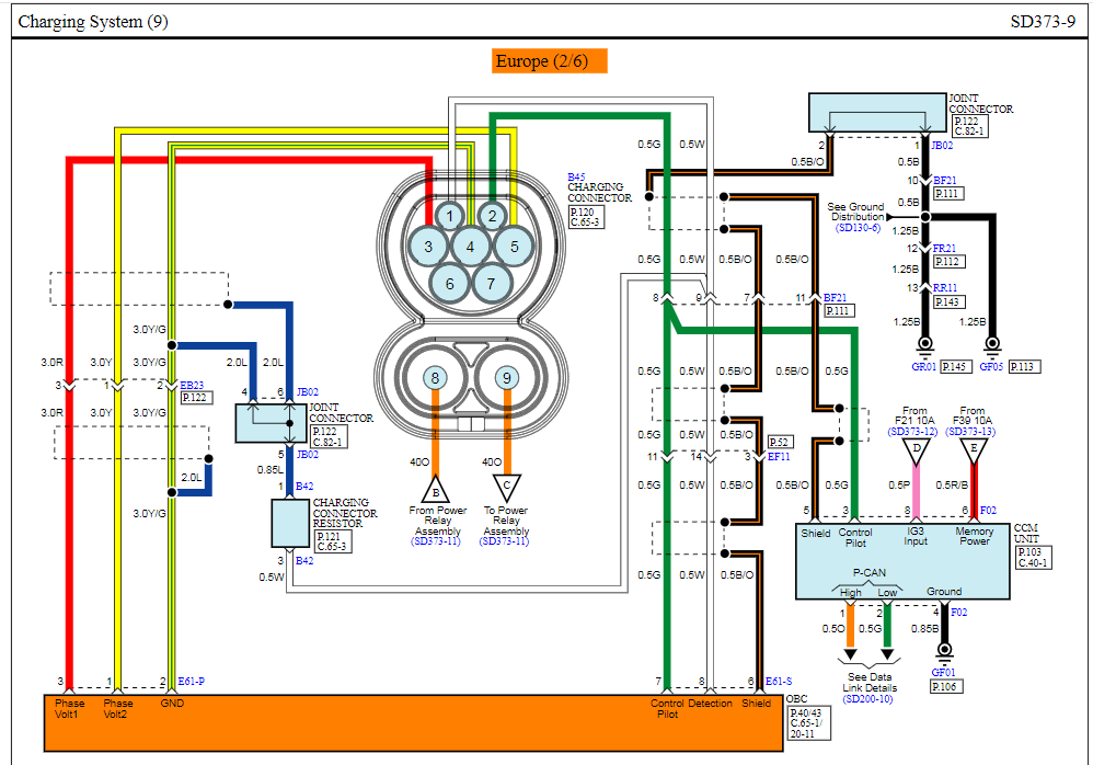

On the Ioniq, it shows basically the same diagram for Europe, and Chademo for "General"
mikeselectricstuff
- Posts: 120
Can't see anything specifically US - not entirely clear exactly which region the service info is for...

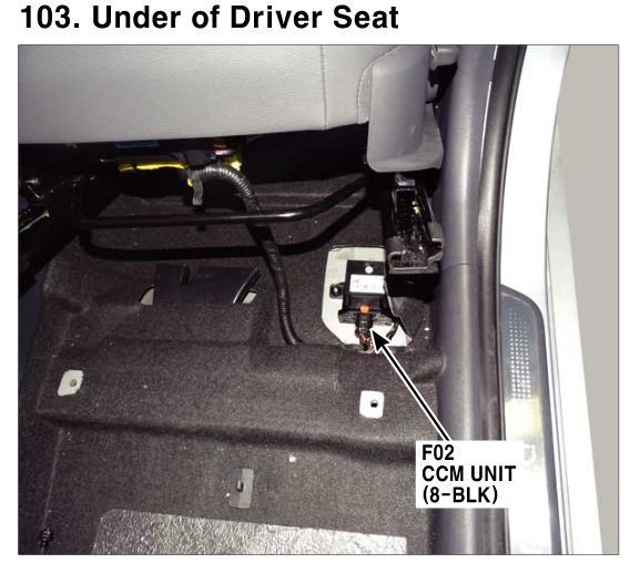

On the Ioniq, it's located under one of the front seats - shows as Driver's side on Hyundai Service site, but most pics on there are for LHD, so might be on the passenger side on RHD cars.

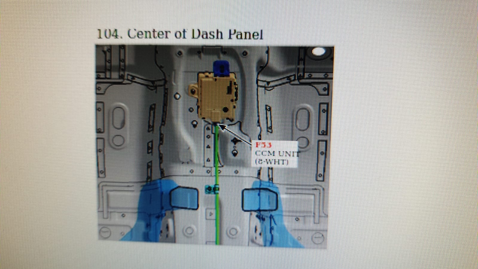

So, Hyundai really do have the crappiest service info website. Anyway, I have been trying to get my breaker to find the ccm unit in a 2020 Ioniq. Not under the seats... So I got the vin and did the dance with the service info page and got this super helpful info
Seems its under the dash somewhere...
