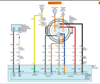

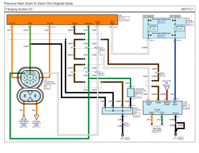

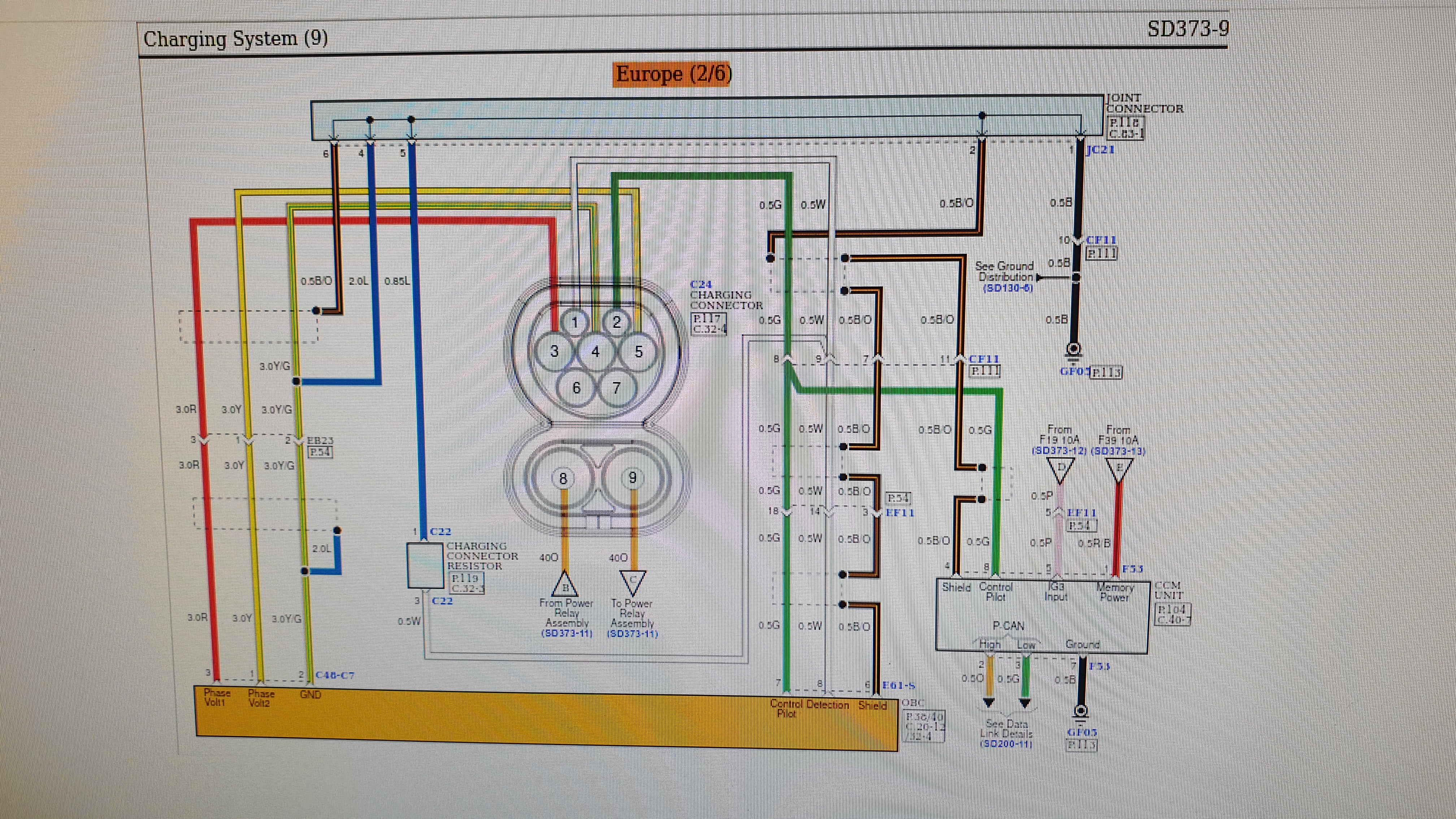

Finally found in in the very-hard-to-navigate Hyundai service site
1 CANH
2 CANL
3 CP
4 GND
5 CP Shield
6 Permanent power
7 Unused
8 Ignition

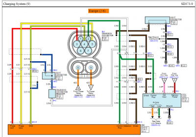

On the Ioniq, it shows basically the same diagram for Europe, and Chademo for "General"

mdrobnak wrote: Tue Dec 01, 2020 6:47 pm Do you have the US version of that diagram as well?
Can't see anything specifically US - not entirely clear exactly which region the service info is for...

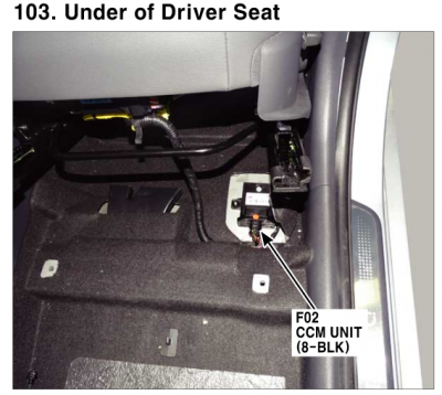

On the Ioniq, it's located under one of the front seats - shows as Driver's side on Hyundai Service site, but most pics on there are for LHD, so might be on the passenger side on RHD cars.

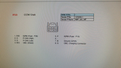

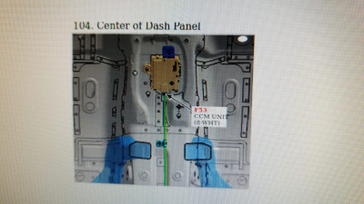

So, Hyundai really do have the crappiest service info website. Anyway, I have been trying to get my breaker to find the ccm unit in a 2020 Ioniq. Not under the seats... So I got the vin and did the dance with the service info page and got this super helpful info :twisted:
Seems its under the dash somewhere...

I've taken some logs - attached - not actually CCS charging yet, but I did give it a 5% PWM on CP, which is the indicator for DCFC.
This thinks about it for about 10 secs then gives a red chargeport light, and a "Check DC charger" error next time you start, so it probably involves the CCS module telling the car it can't establish a data link. I don't see any high frequency GreenPhy gunk on CP, so assume the charger sends first to establish a link.
I did a comparison between logs for AC and (failed) DC charging, and found no IDs specific to DC, but a few specific to AC (7B3,7BB,7E2,7E4,7EA,7EC). I couldn't immediately see any obvious patterns in these.
The CCM sits on the D-CAN bus:
Will get some logs during CCS charging when I get a chance - not many rapids near me.
