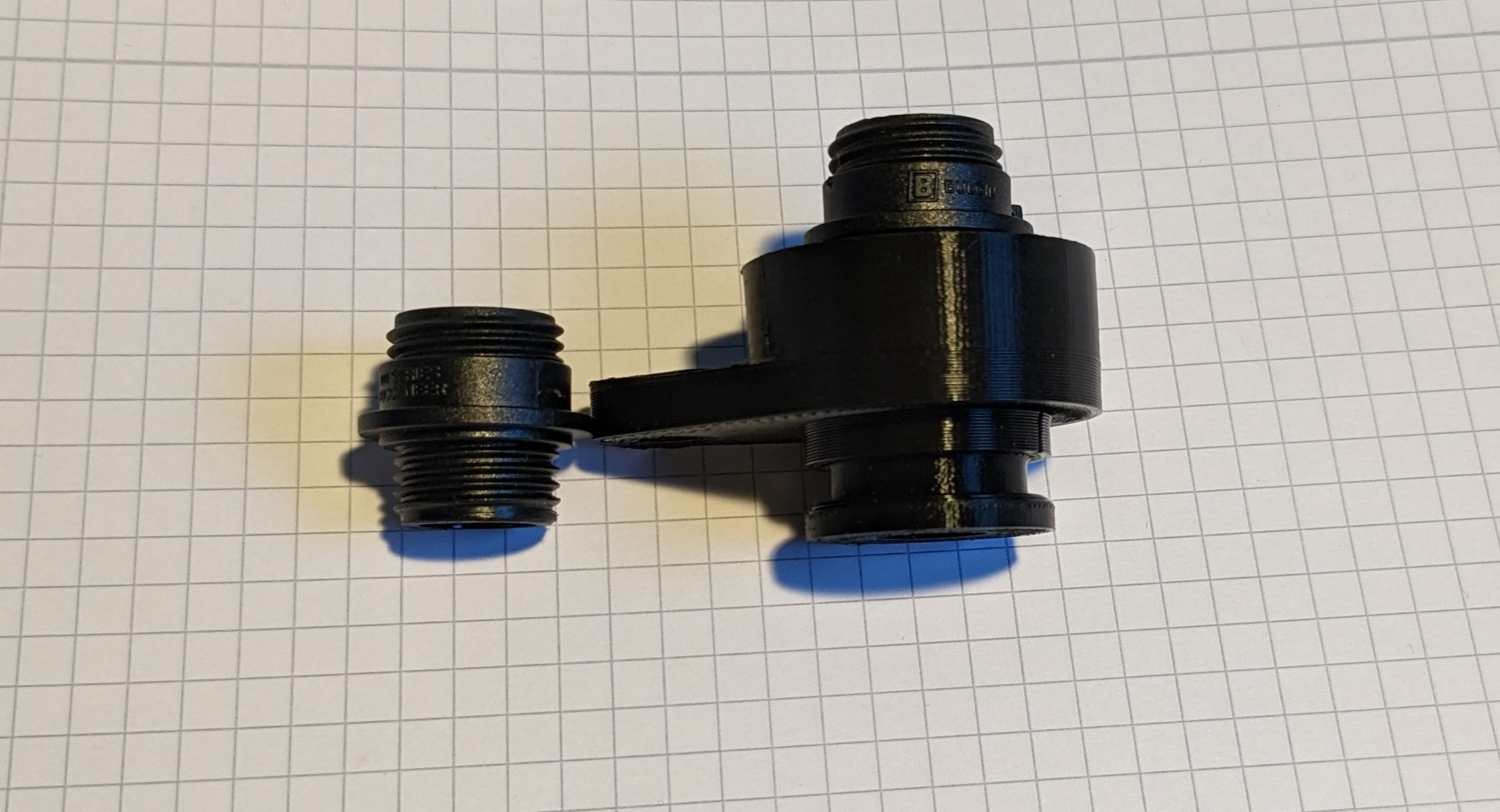

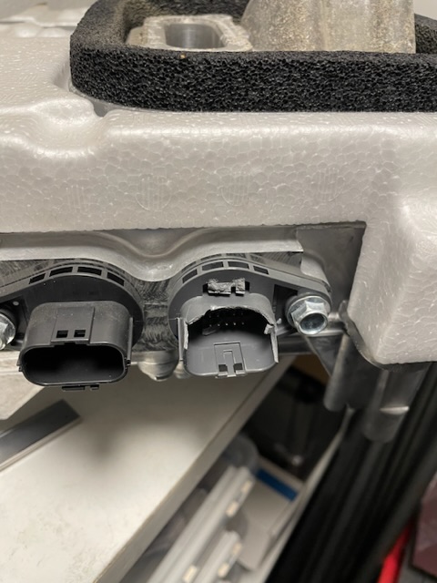

Tomas wrote: Mon Mar 27, 2023 9:54 am EB754A6C-5436-4275-A181-A41116F888E0.jpeg
Is there any good solution for a broken connector 😬
Here you see alternative to cable side connectors:
viewtopic.php?p=37298#p37298
viewtopic.php?p=38005#p38005
And here is total replacement. I suggest you make it from PETG not ABS because of moisture...
viewtopic.php?p=14728#p14728

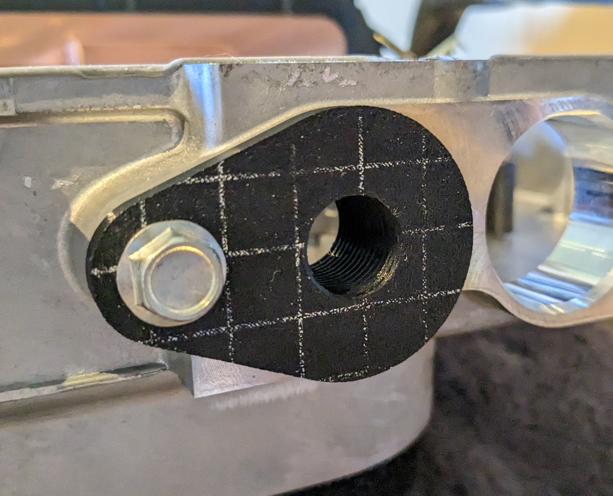

I'm currently working on a replacement with M16/M20/M25 thread for either the standard M16/M20/M25 cable glands or the Bulgin Buccanneer 400 Series connectors as shown in the second picture
(The oval holes for the signal connectors are identical to the power connector)
But I don't have the right O-rings for test fitting them yet, so I don't want to release the files just yet.

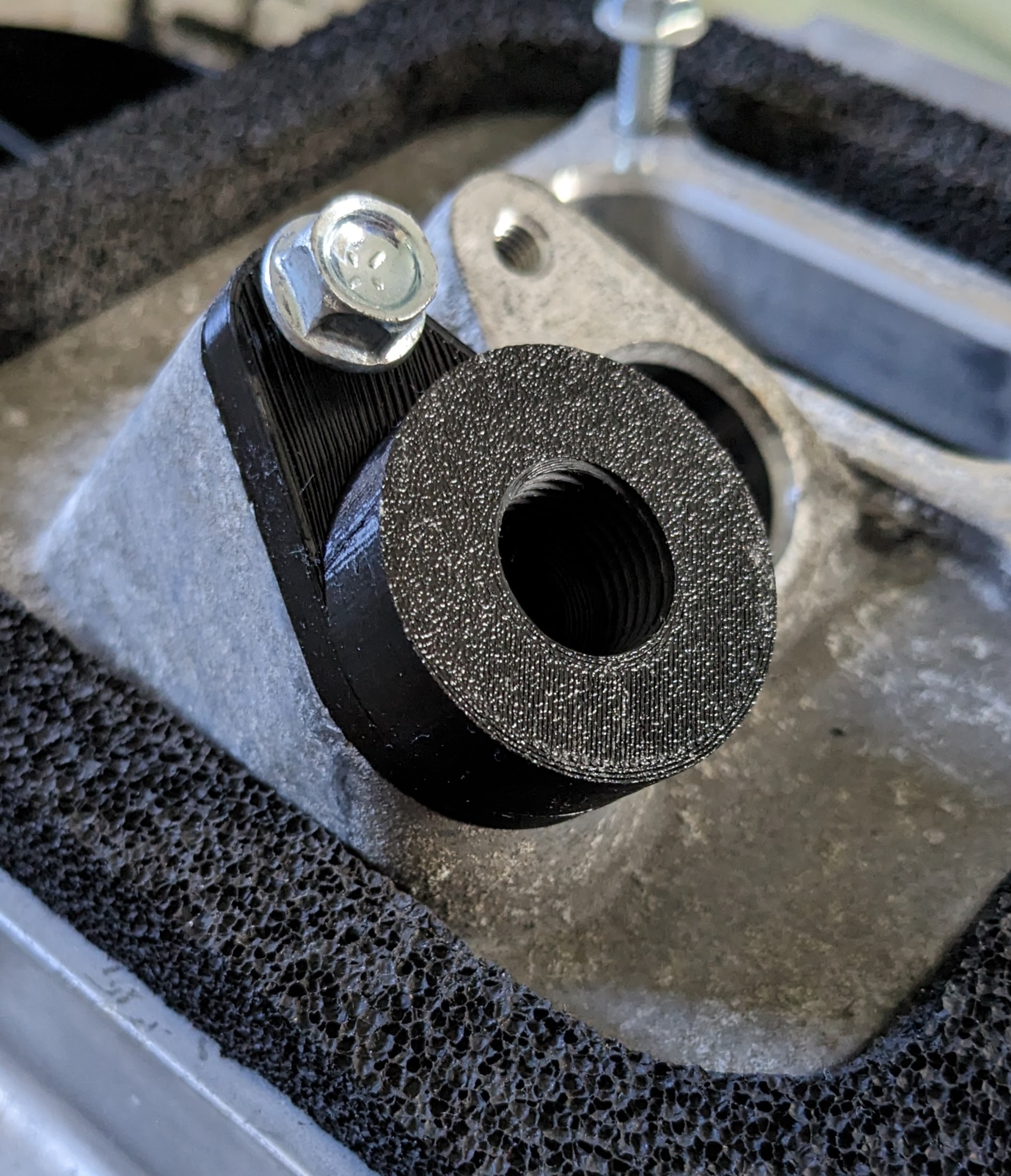

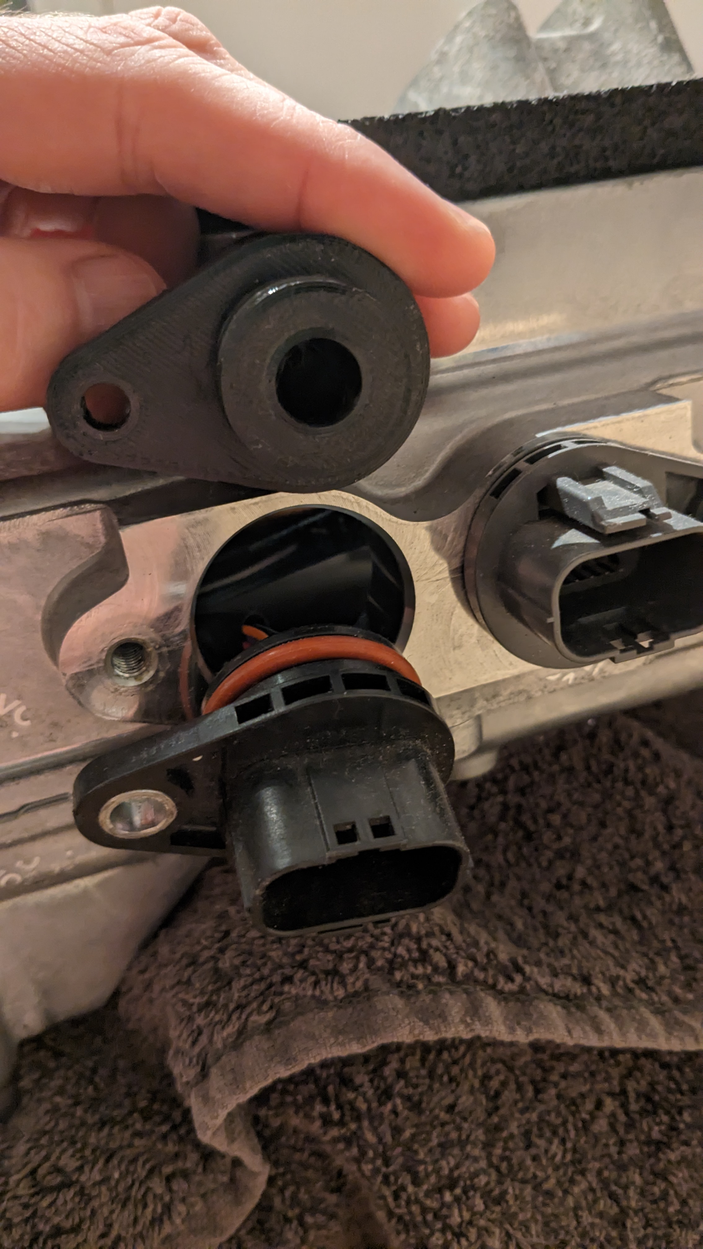

crasbe wrote: Mon Mar 27, 2023 3:57 pm I'm currently working on a replacement with M16/M20/M25 thread for either the standard M16/M20/M25 cable glands or the Bulgin Buccanneer 400 Series connectors as shown in the second picture
looking good, id throw on a few fillets in the corners, really strengthens the part up

Bratitude wrote: Wed Mar 29, 2023 1:19 am looking good, id throw on a few fillets in the corners, really strengthens the part up
If it helps with printing, I might do that :D
On the other hand you really can't break or even bend these without a stupidly excessive amount of force.
As promised I published my solution for the Outlander cable glands: viewtopic.php?t=3563

I noticed yesterday that the holes for the DC supply lines and the holes for the signal cables do NOT have the same dimensions.
In a couple of days I'll have a version for the signal holes as well, but it'll take some time for the new O-rings to be delivered (oh how I missed it...).
Edit: On a positive note though: I just published the gland for the auxiliary ports :)
