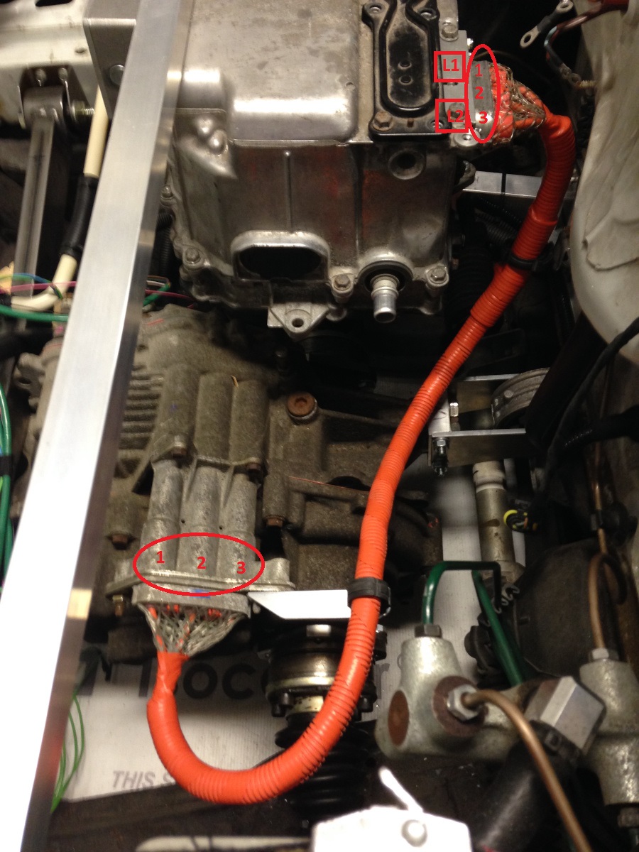

dear Bexander.
I've been following your work for a long time.
and I appreciate your work.
could you please help me and answer some questions.
1. according to your photo of the installation between the inverter and the motor, I can not see the order of connection of three-phase wires, I need to see the order of connection.
on the inverter, the numbers for the current sensor and the numbering of the phases I marked correctly. and correctly marked on the engine?

1. With the phase order markings on the motor, on the inverter I have the opposite order i.e. switch 1 & 3. Phase order as in picture above. I don't know the order of the current sensors but it is the stock Toyota placement and then using the logic board to handle the connections.

Maybe my phase order is as described in the picture... I will have to double check when I get home.

Phase order double checked and the picture has the same order as I do.

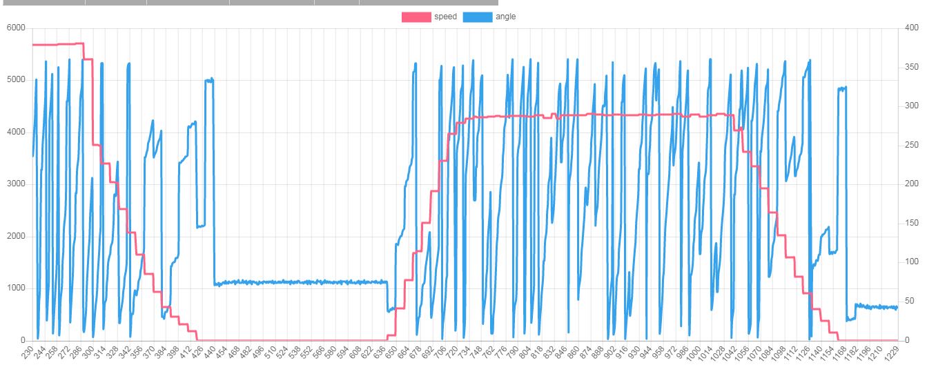

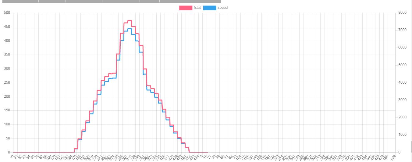

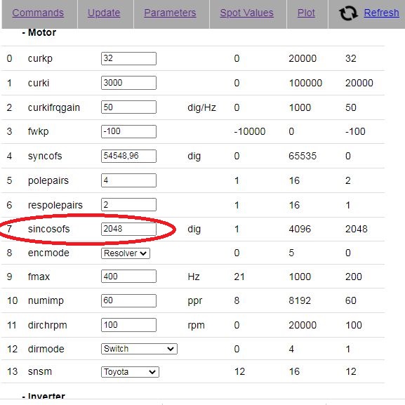

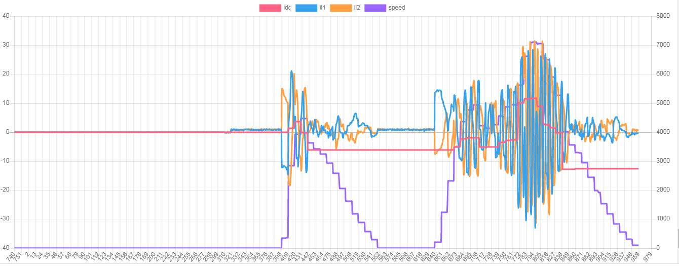

Post by mikmur »

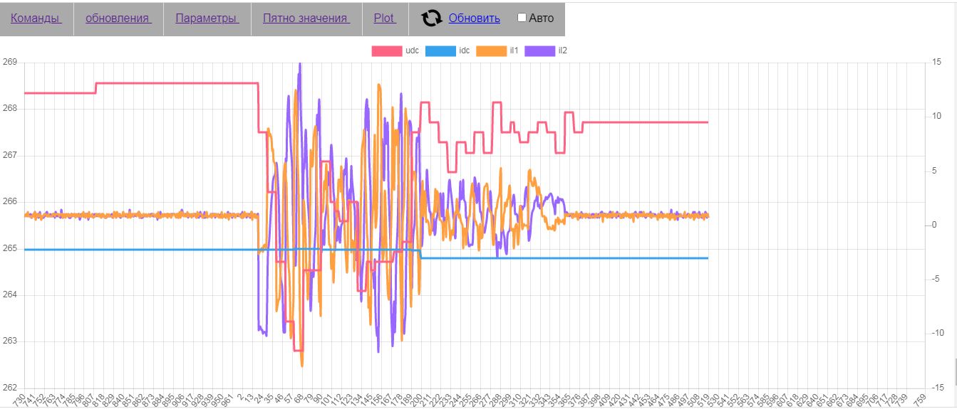

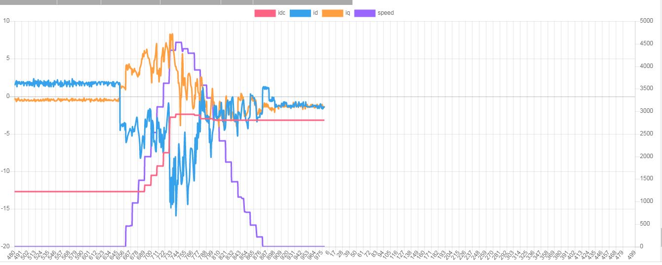

Hello everybody.
после долгих мучений мотор вроде нормально раскрутился.
after long torment, the engine seemed to spin normally.
для установки sincosofs необходимо измерить напряжение с энкодера (после резистивного делителя)
to install the sincosofs, you need to measure the voltage from the encoder (after the resistive divider)
чтобы раскрутить мотор-редуктор медленно, руками, один оборот трудно.
to unwind the geared motor slowly, by hand, one revolution is difficult.
как-то раскрутил и замерил напряжение между GND и с энкодера (после резистивного делителя).
somehow unwound and measured the voltage between GND and from the encoder (after the resistive divider).
от минимум бил 0 вольт, до максимума 0,65 вольт.
from a minimum beat 0 volts, to a maximum of 0.65 volts.
according to instructions (((U1+U2)/2)/3.3)X4096
U1=0.00V
U2=0.65V
Sincosofs=806.78
вот видео и если что не так с параметрами жду комментариев
here is a video and if something is wrong with the parameters I am waiting for comments
обновление:
renewal:
напряжение поднял до 270 вольт
voltage raised to 270 volts
переснял видео заново
reshoot the video
добавил графики разные
added different graphics
udc located left. Idc, il1 and il2  located right
Idc, il1 and il2  located left. speed located right
idc, id and iq  located left. speed located right
ftart located left.  speed located right
speed located left. angle located right
