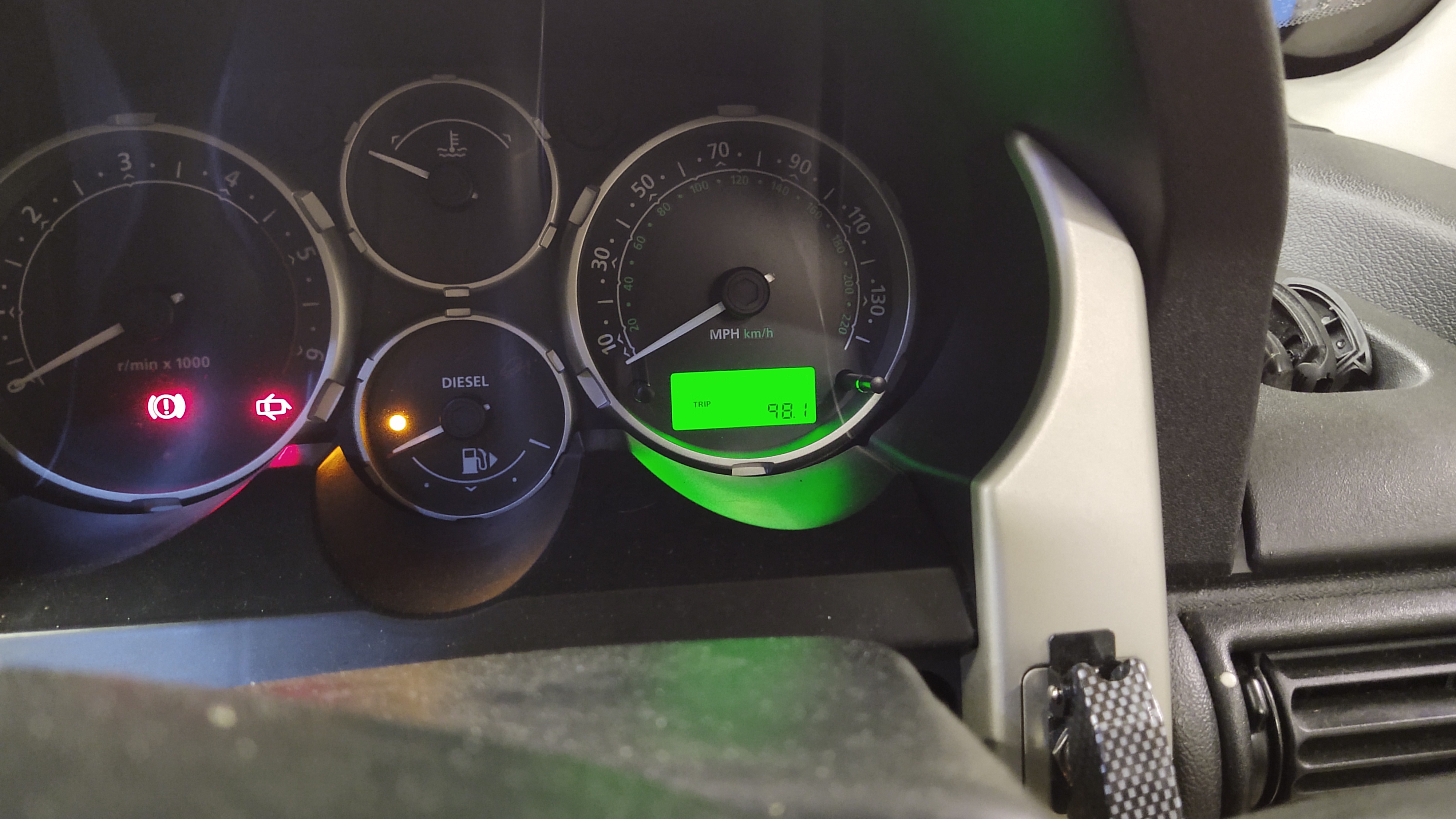

Alibro wrote: Sun Oct 29, 2023 4:43 pm MOT passed. :D
Well done :)
Alibro
Posts: 1113
Location: Northern Ireland
Has thanked: 507 times
Been thanked: 325 times
Re: #Driving# Freelander EV With Gen1 Leaf electrics and EVBMW VCU
Post by Alibro »
Thanks mate

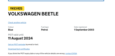

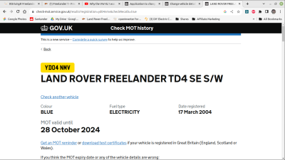

New fuel status on gov.uk site. :)
Posts: 1884
Has thanked: 91 times
Been thanked: 517 times
How?
Well done BTW.
Alibro
Posts: 1113
Post by Alibro »
Bigpie wrote: Sun Oct 29, 2023 7:14 pm How?
Well done BTW.
Thanks mate, must be the MOT guy did it. The system is different here so maybe that's why.

My rx8 also shows as electric under fuel type in the mot system, I’m guessing Jamie’s mot guy didn’t know he can change the fuel type when he logs into the vehicle details on the mot system, in fact if the beatle is still on the system as petrol it should be subject to an emissions test still… odd

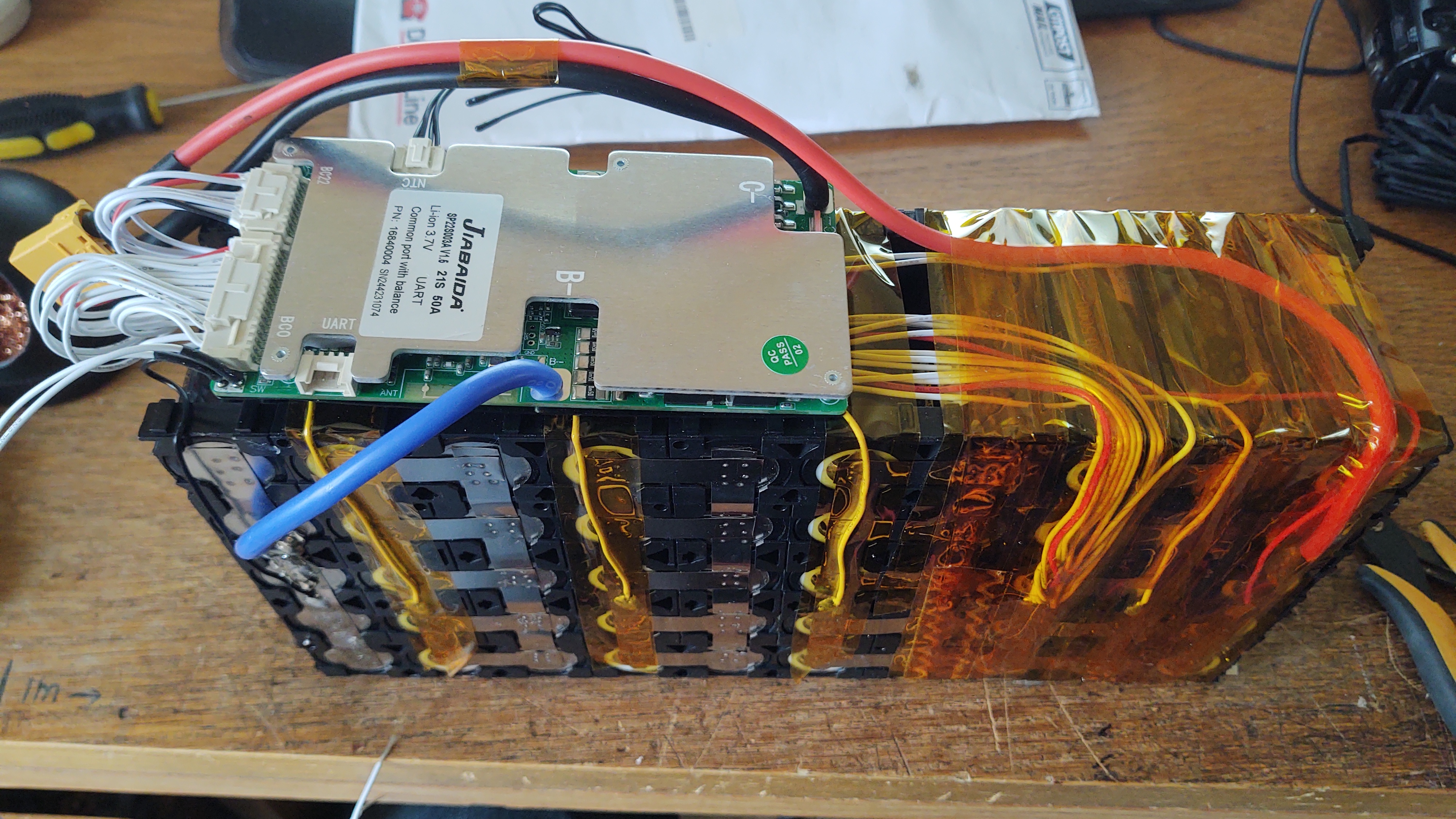

So since I had trashed the old battery a new power source has been sourced.
That is I've built a new bigger battery pack. 😋
The problem with the old setup was I had to manually turn on the battery, then turn up a potentiometer to get the desired power assistance. While this works it is easy to accidentally leave the battery turned on which is still sending 6V to the brushes on the alternator. I think this is what happened but for some reason the motor controller I was using to send the 6V had failed and was sending full pack voltage (36V) to the alternator hence the smoke. How it is still working I don't know but I fear the insulation in the coils will be irreparably damaged so I may have to make a big decision in the near future.
But for now I'm pushing on with the new pack. I built it with a smart BMS which has a BT connection to an App on the phone and sends all the details of each cell, pack voltage and current draw.
It also has a switch option so I can turn off the output of the battery remotely. Initially to keep things simple I'll connect the switch to the POT that I'm using to control the PS. Eventually the plan will be to automate everything through an Arduino.

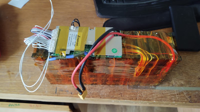

I thought you guys might be interested in the battery pack I built.
The cells are Liitokala Lii-50A 26650's so a good bit bigger than standard 18650. I bought them a year or two ago but they were tested when bought and charged to storage voltage. Before building the pack I checked the voltage of each one and they were all identical.
They can provide around 5000mAh each and if we say the average voltage is 3.7V then they have approx 3.7V x 5A = 18.5Wh
I have 10 in series with 5 in parallel therefore 50 in total so if we multiply by 18.5Wh x 50 the pack should be good for 925Wh or 0.925kWh
The power steering draws around 3A at 37V so approx 111W or 111Wh so in theory the pack should be good for 9 hours.
Maybe a little over specced. 🤣
The BMS is "Smart" so it has a Bluetooth connection to an Android or Apple device. It allows me to monitor cell voltages, output current and voltage but also gives a great deal of control over charging and allows me to turn the the pack output on or off remotely. I also have the option of a switch to turn the pack off which I plan to use with a switched POT. Eventually if I ever get around to it I'll use an Arduino to control the power steering but for now a POT mounted beside the boot window switch works well.

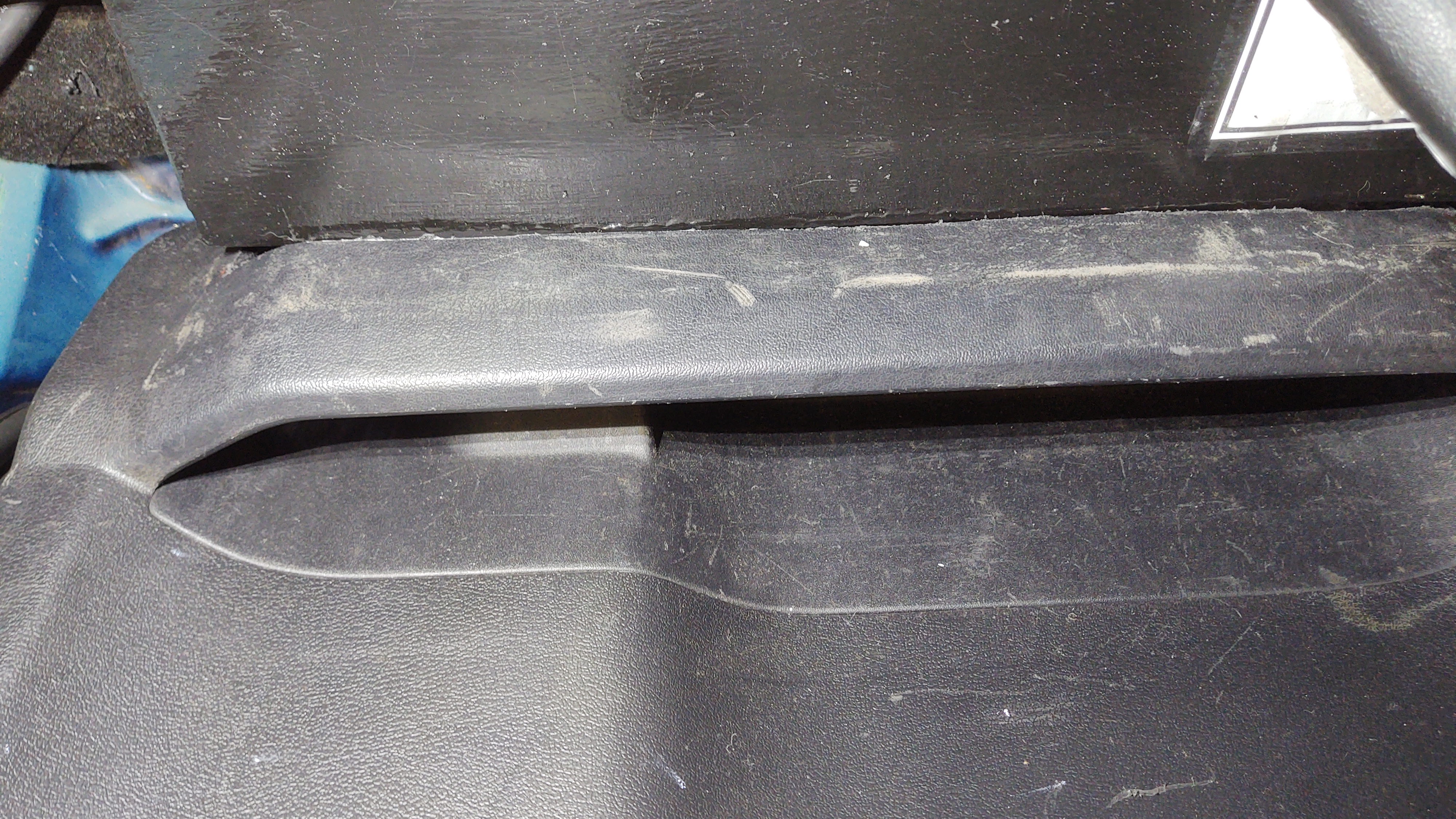

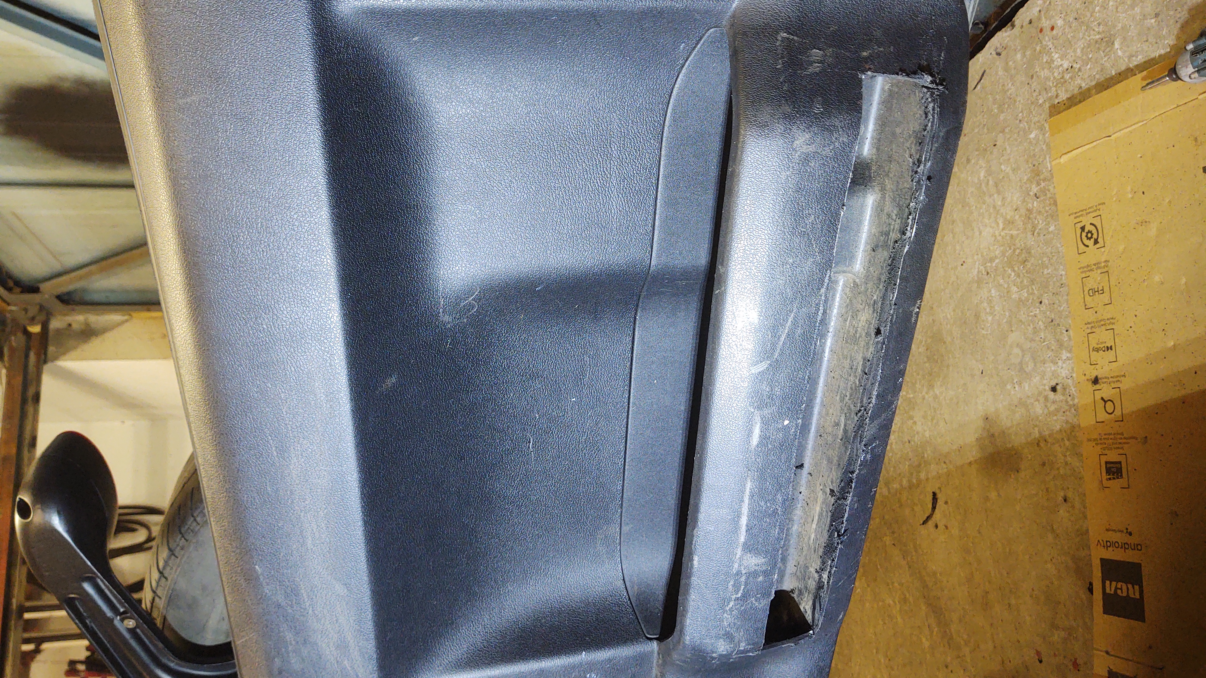

I also refitted the boot door card last night but had to do a little mod to make it fit.
This is from the inside with the boot door closed.
It was up against the lid of the battery box preventing the door from closing but now is a nice tight fit. In all the years I've had Freelanders I don't think I ever used the boot door storage so I'm not too bothered to have a gaping hole in it. 😉

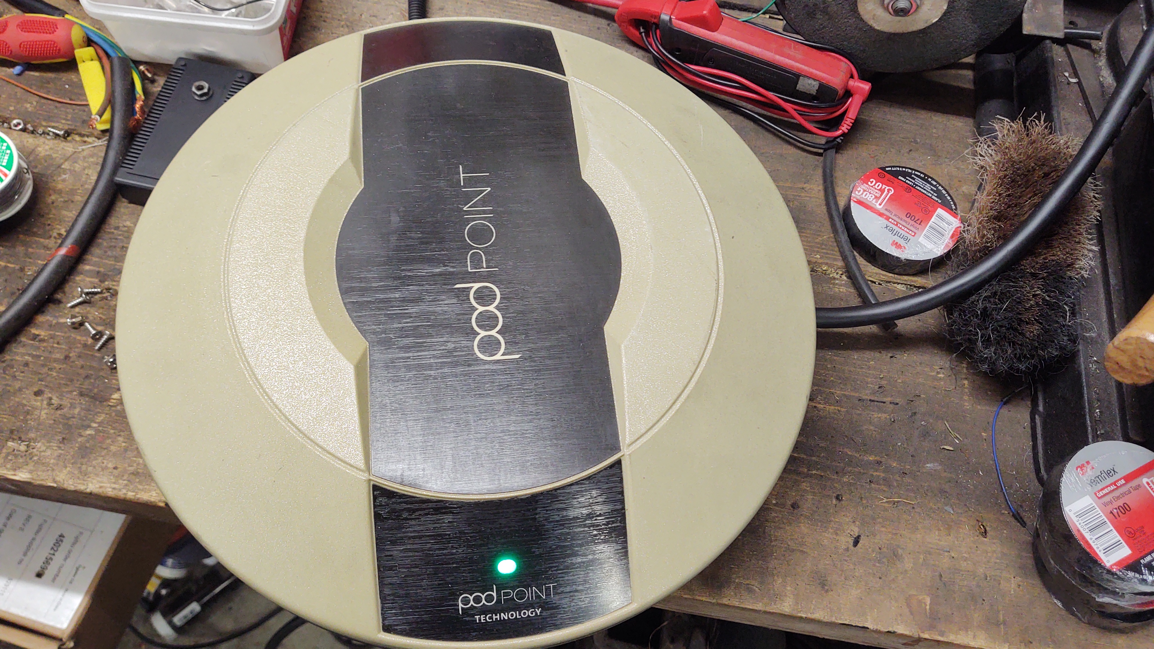

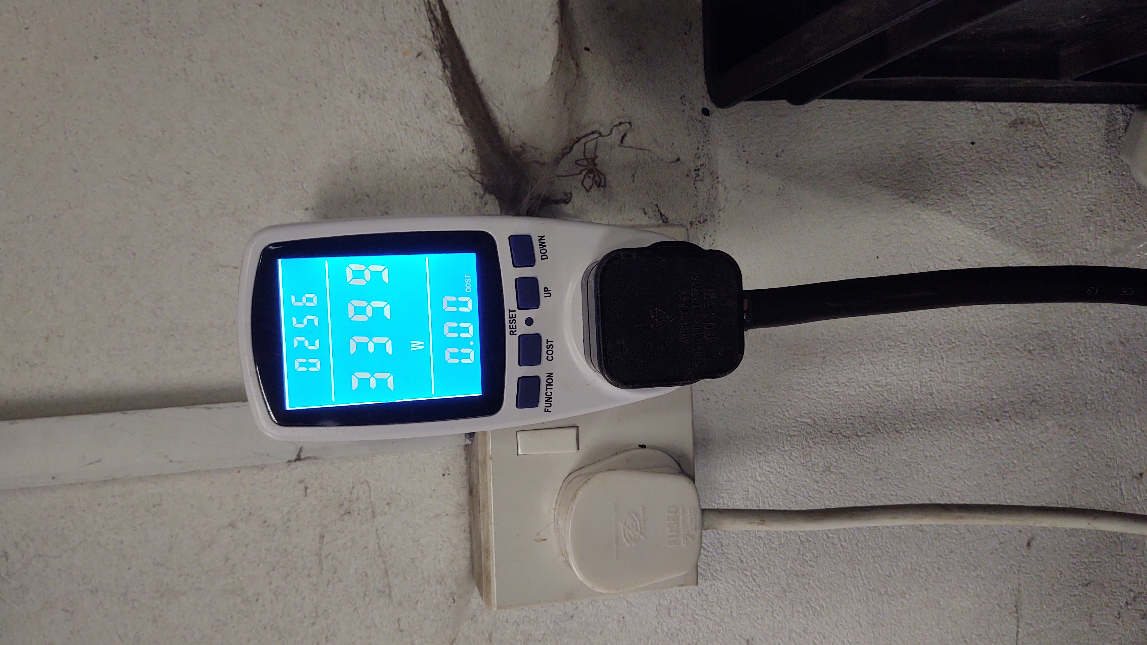

I think I've managed to max out the Mitsibishi Outlander OBC (On Board Charger)
I know using a 13A plug for current drain of just over 14A is a little dodgy but it was just for testing and a 32A wall socket should be arriving tomorrow or the next day This way I could see the power being drawn and confirm it is working correctly.
This is the Wall charger EVSE I bought off ebay
It's stupidly big but should do the job and if I ever upgrade to a 7kW OBC it should be able to deliver that.

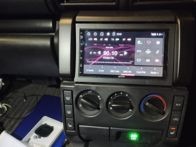

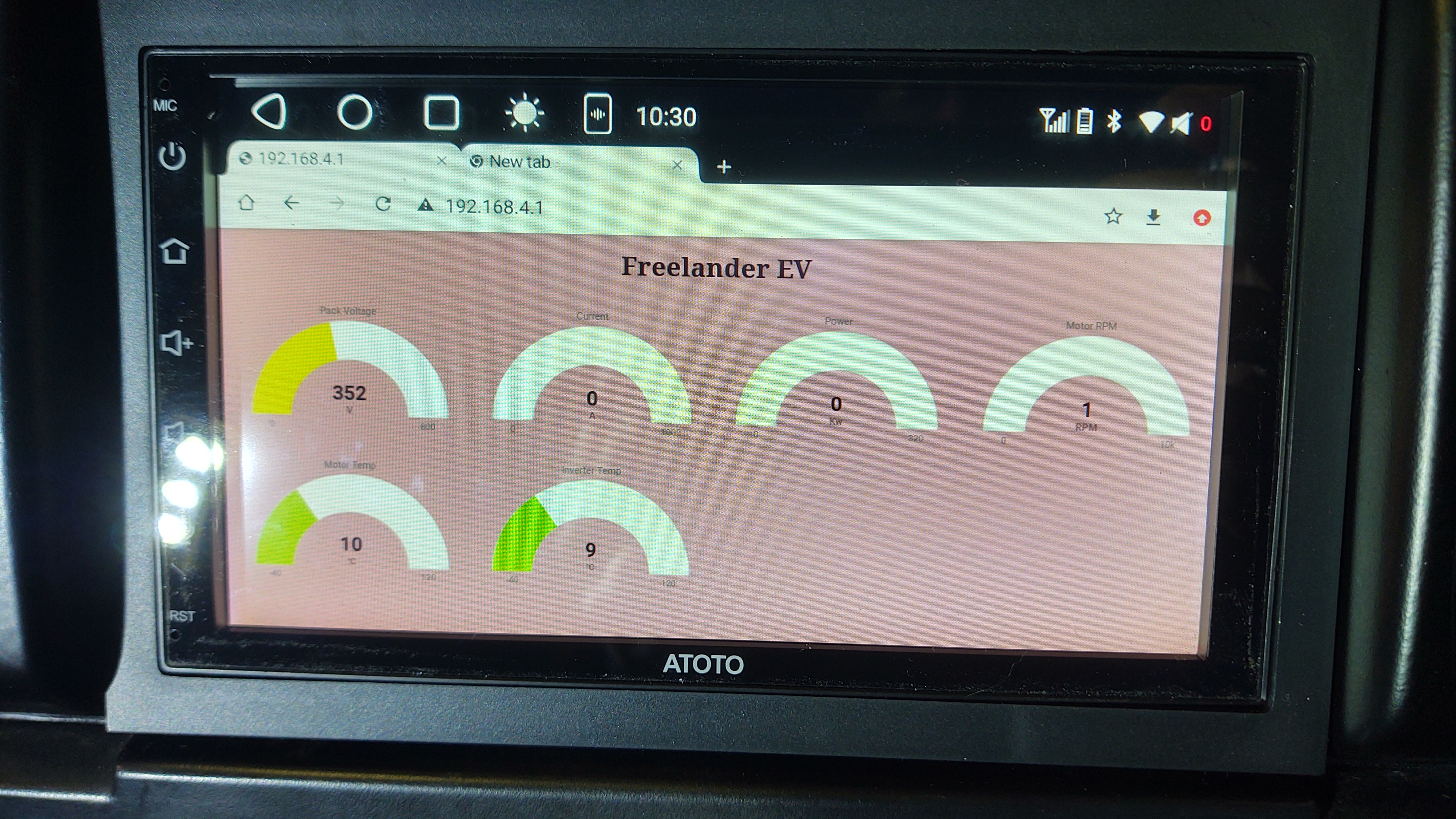

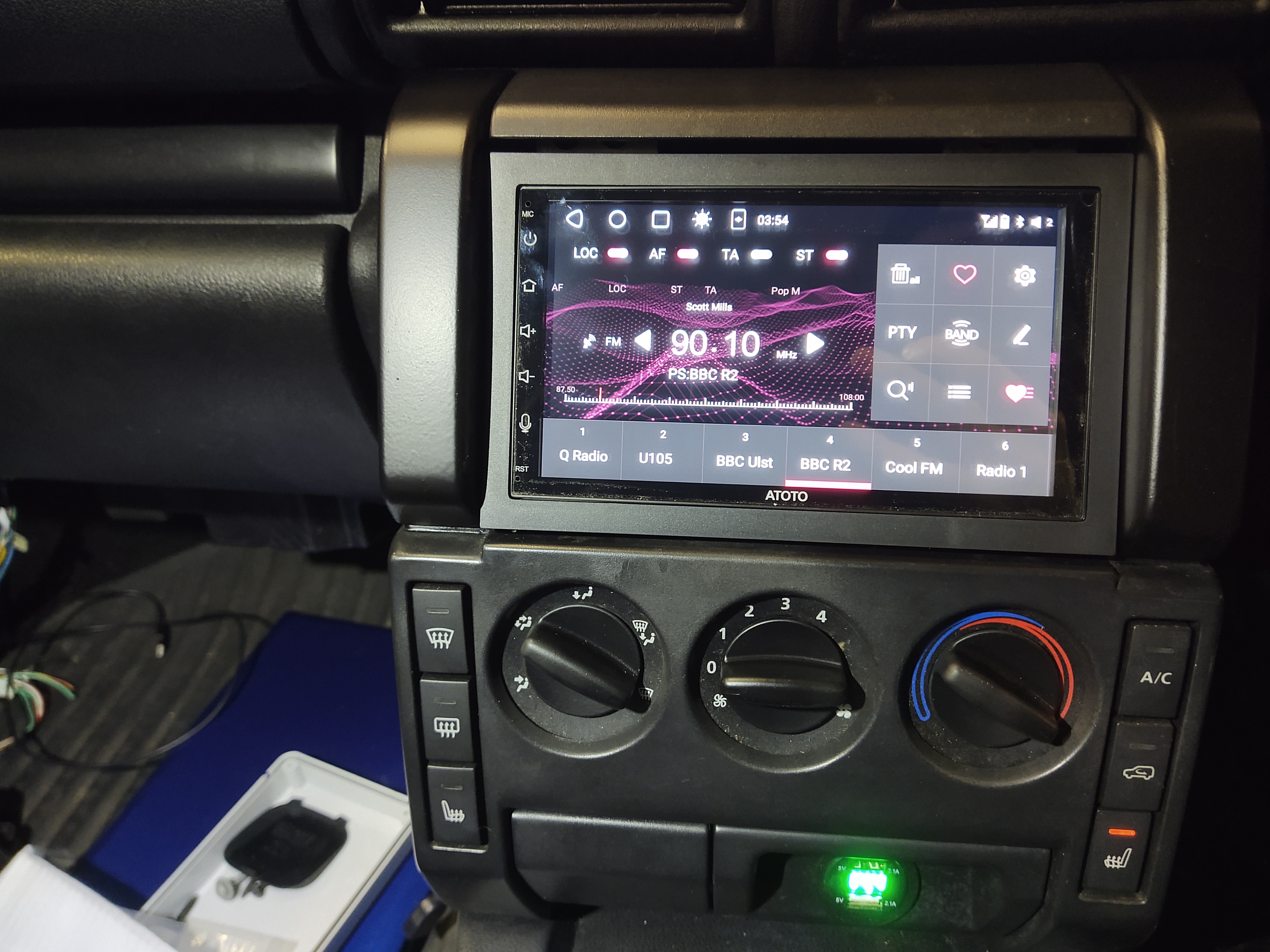

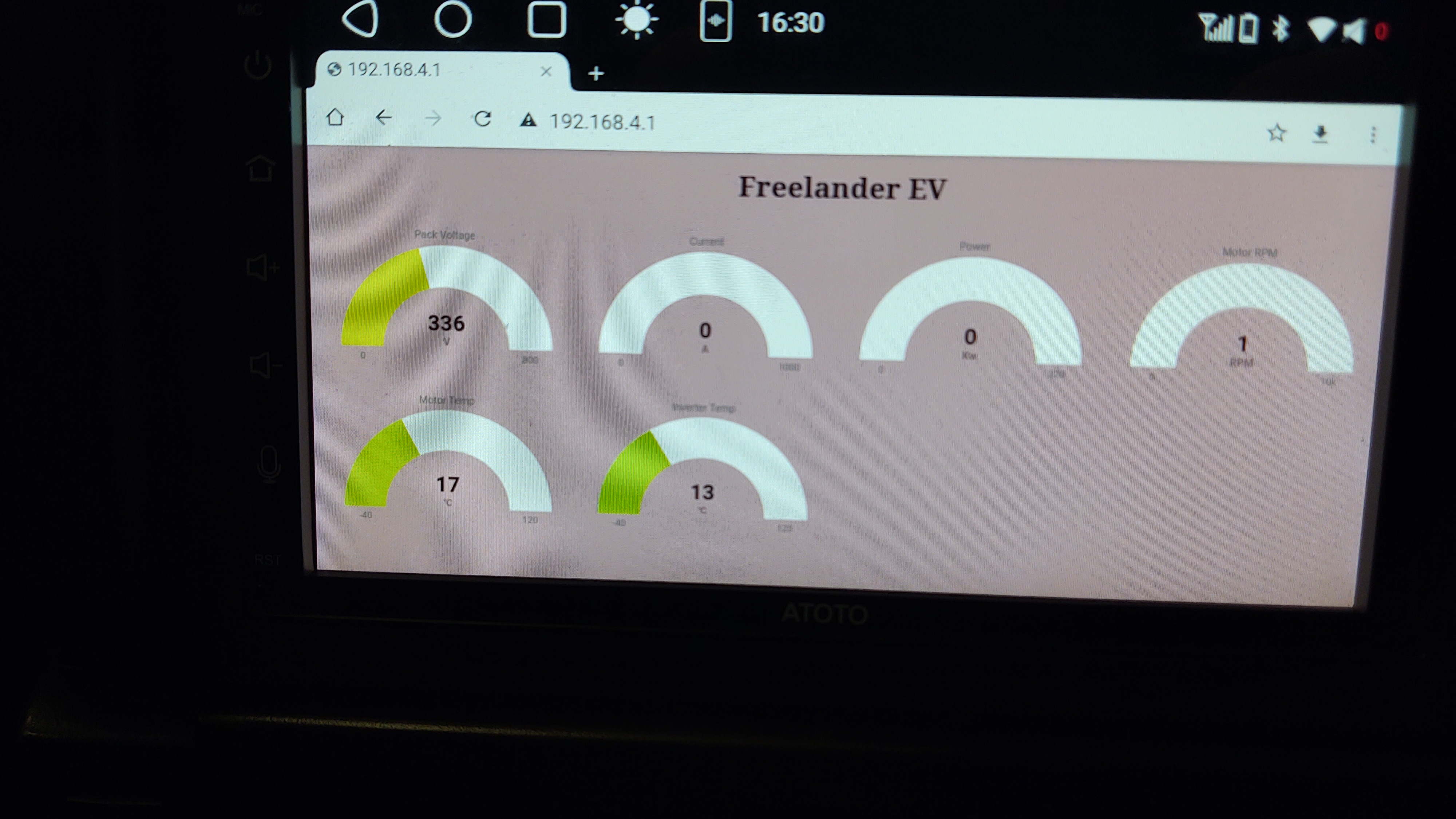

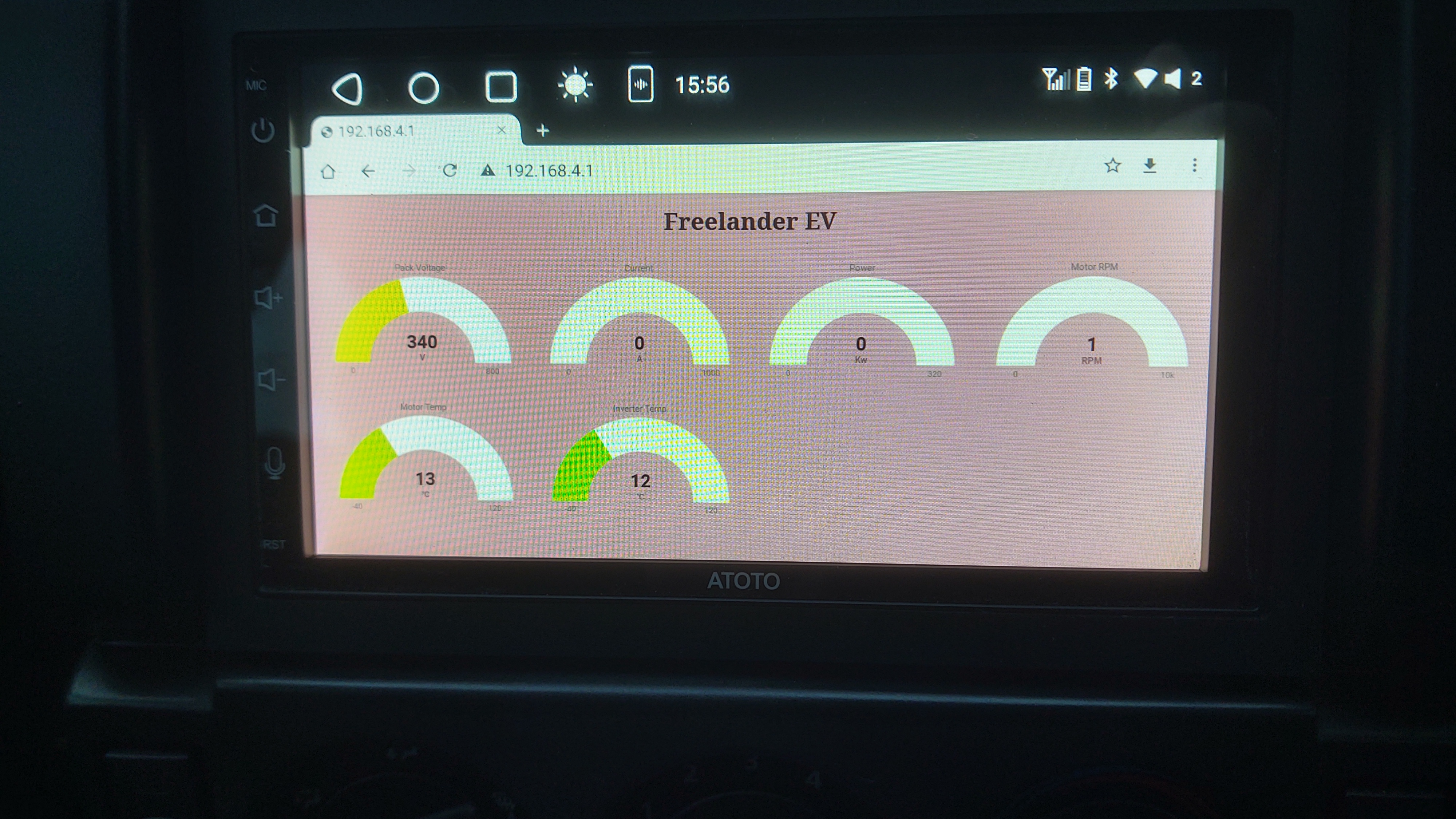

A new toy arrived during the week.
This is the main reason for getting an Android Head Unit.
If you look carefully you can see the latest achievement. :D

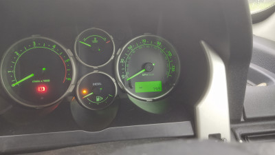

I managed to get the Pack Voltage showing in the VCU web page with just a tiny change to the sketch.
I still haven't managed to get the shunt working so no current or power but at least now I know the SOC. ;)

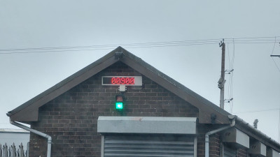

In the last week or two since the last full charge I had driven 50 miles on small back roads around home while testing different changes, so the pack voltage had dropped from 400V to 352V. These were not easy miles as there was lots of start stop and hard acceleration involved.
As the weigh bridge is 15 miles from home I figured it would be a good test and hopefully well within my theoretical range of around 100 miles.
Here are the results
Before leaving
Gross weight with fatso and and some tools adding around 100kg
Rear axle
Miles since last charge after test
Voltage after test
To say that I am pleased with this is a big understatement. I was driving at between 50 and 60mph most of the time so I believe the realistic range to be at least 100 miles and probably more. I never saw the voltage drop below 335V even when accelerating so the individual cell voltage never dropped below 3.49V so this is well above what I believe to be the sensible minimum of 3.2V

So good news and bad news today.
I took the car for a drive without any real destination in mind but it seemed to be going well so I decided to try a range test. The battery was charged a few days ago and I stopped the charging at 402V. As expected it dropped back so by this morning it was 396V. I have no way to set a constant voltage variable current so this will always happen.
Anyway I drove to a town approx 35 miles from home and back, then did another 9 miles before parking up for lunch so had 79 miles on the clock but the voltage was still around 345V. I was driving between 55 and 60mph most of the time.
This afternoon I drove another 19 miles to pick up my mum and when we got home the voltage was still at 336V after doing 98 miles.
I was watching the voltage the whole time and it looks like initially it gets just over 1 mile per volt then levels out to 1.5 ish miles per volt.
If we call 400V 100% SOC and 310V 0% SOC then in theory I still have over 25 miles or a max range of over 120 miles without really trying.
With a 38kWh pack it works out over 3 miles per kWh which I think is pretty good for DIY conversion in a not particularly aerodynamic car.
The bad news is that a few miles from home the brake boost stopped boosting. 😕
I'm hoping to it's just a blown fuse but will confirm tomorrow.

Some more good and bad news. 😯
The good news is after some rewiring the car is working again and it there was no harm done. It looks like passing the 12V pos through several connections caused a problem with stray voltages so I've tried to simplify things a bit and it seems to have helped a couple of issues.
The bad news is I didn't have the 20 or so miles in the battery I thought I had. :shock:
I called with some friends to let them have a short drive but the car only got a further 4 or 5 miles before I noticed the voltage falling off a cliff and shortly after it died. 😭
Thankfully I had my laptop with me and was able to tweak a setting to let me limp back to their house. We plugged it in for a couple of hours to let me get home, but lessen learned I should never let the voltage fall below 335V and preferably not below 340V.
Also in the current temperatures I think the range should be counted as 100 miles max. To go any further safely would require driving a bit slower.
