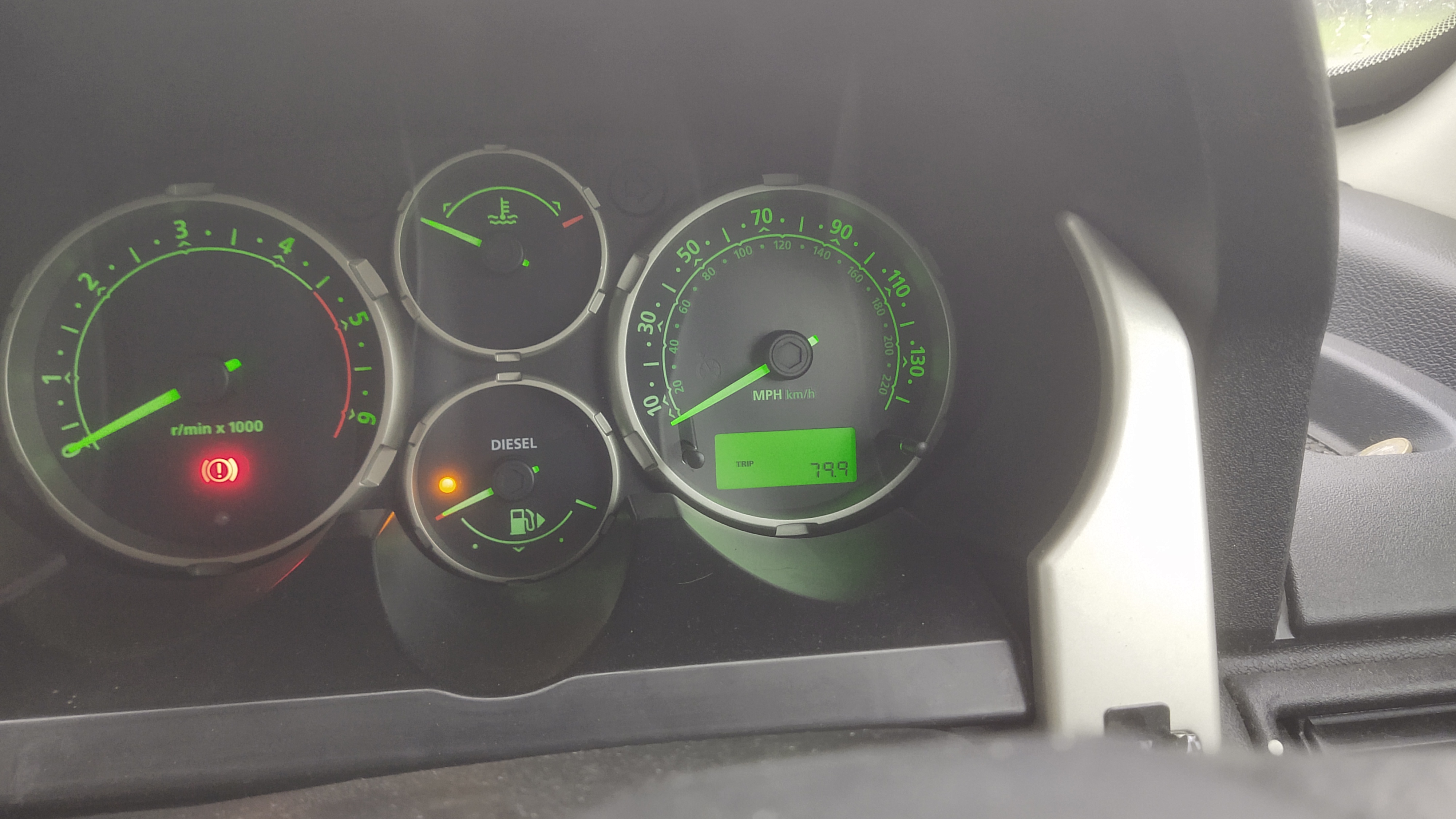

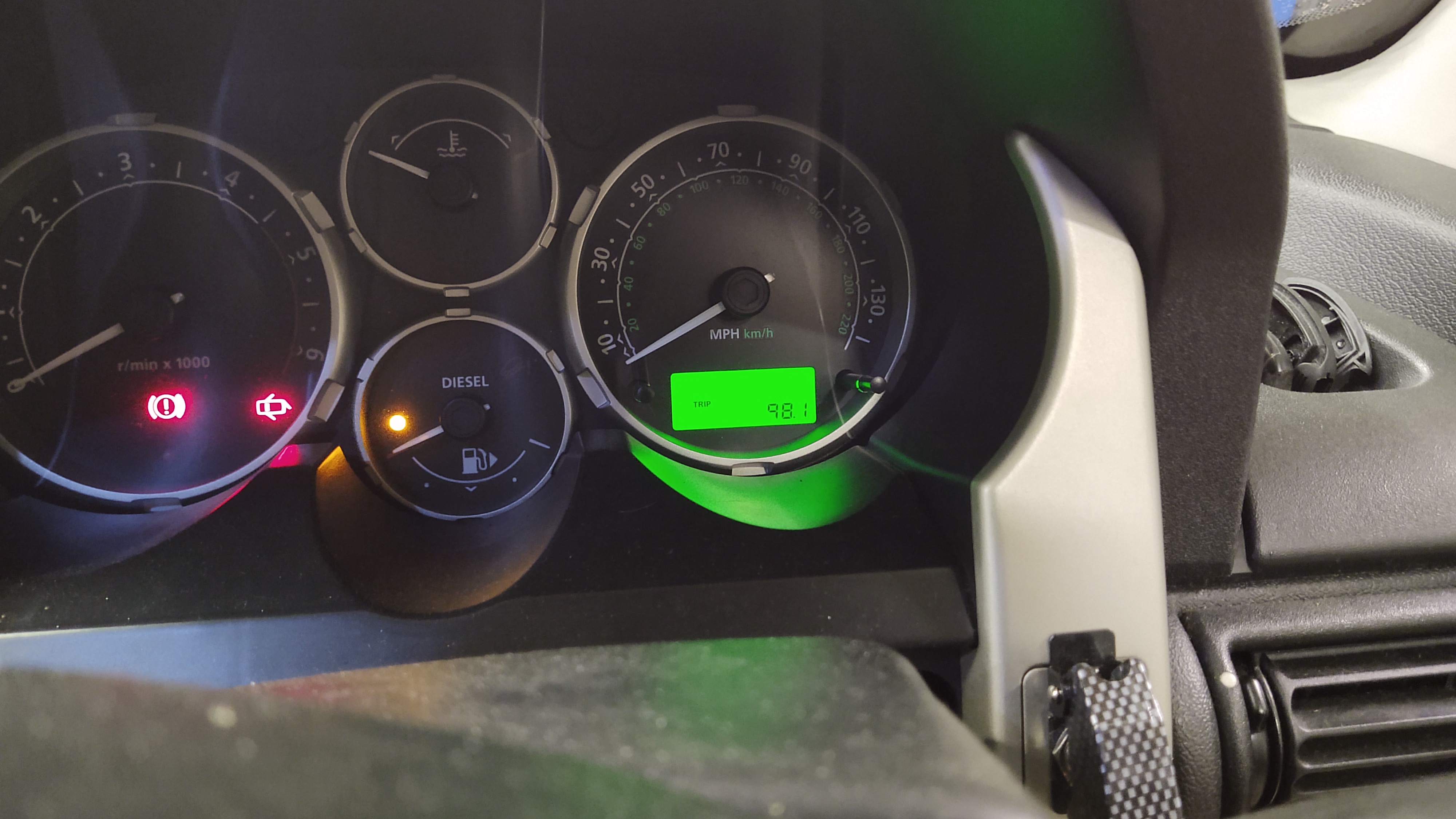

A new toy arrived during the week.
This is the main reason for getting an Android Head Unit.
If you look carefully you can see the latest achievement.
I managed to get the Pack Voltage showing in the VCU web page with just a tiny change to the sketch.
I still haven't managed to get the shunt working so no current or power but at least now I know the SOC.

Re: [Driving] Freelander EV With Gen1 Leaf electrics and EVBMW VCU
That does look good, unless you were in the know it looks completely normal.
its a shame we cant just replace our whole dashboard display with a web interface would make our lives alot easier

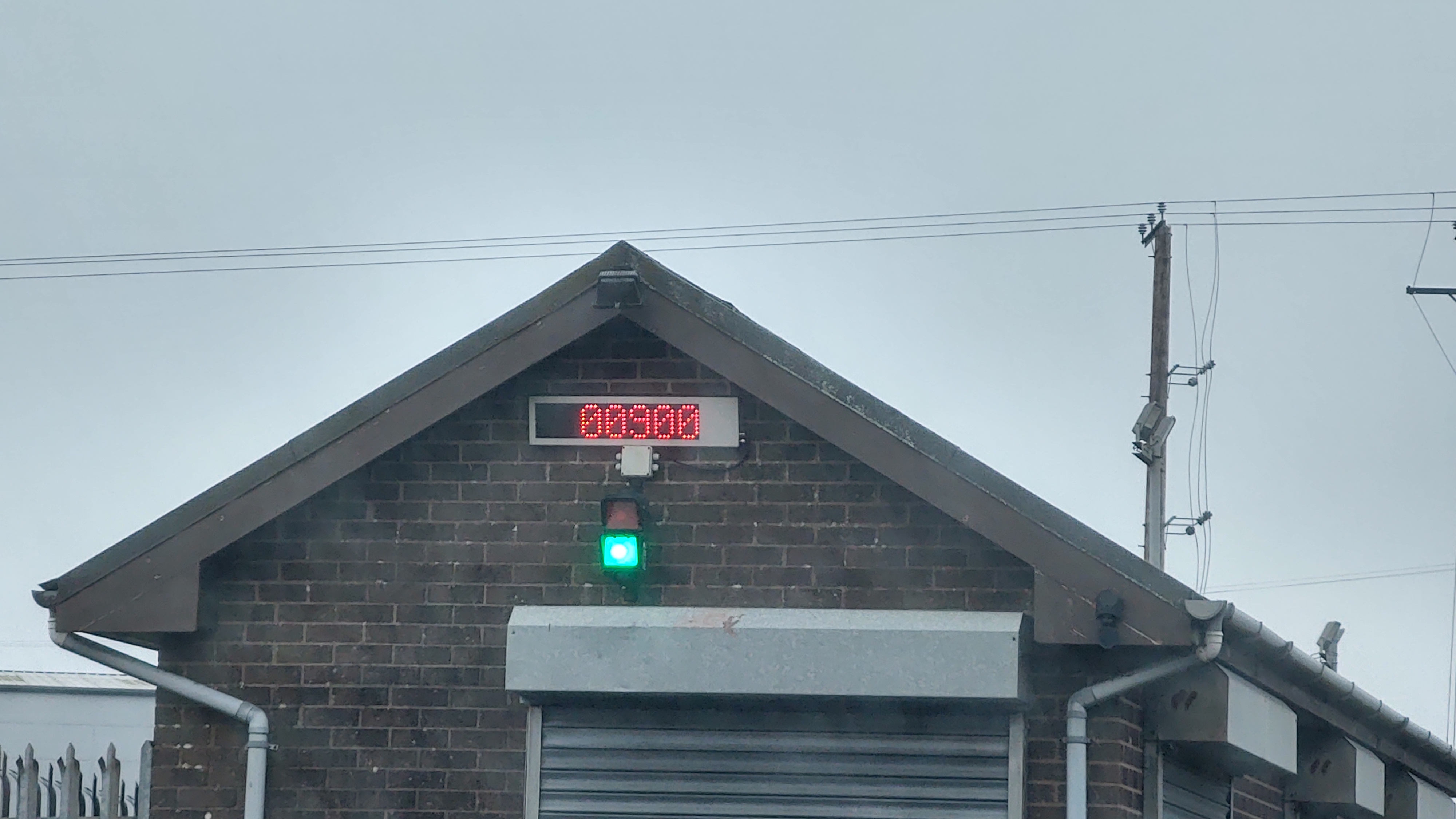

On a more exciting note, now I can see the Pack Voltage I decided to take the car a little further than before to test the range and at the same time drive it onto a weigh bridge.
In the last week or two since the last full charge I had driven 50 miles on small back roads around home while testing different changes, so the pack voltage had dropped from 400V to 352V. These were not easy miles as there was lots of start stop and hard acceleration involved.
As the weigh bridge is 15 miles from home I figured it would be a good test and hopefully well within my theoretical range of around 100 miles.
Here are the results
Before leaving
Gross weight with fatso and and some tools adding around 100kg
Rear axle
Miles since last charge after test
Voltage after test
To say that I am pleased with this is a big understatement. I was driving at between 50 and 60mph most of the time so I believe the realistic range to be at least 100 miles and probably more. I never saw the voltage drop below 335V even when accelerating so the individual cell voltage never dropped below 3.49V so this is well above what I believe to be the sensible minimum of 3.2V
Before leaving
Rear axle
Voltage after test

So good news and bad news today.
I took the car for a drive without any real destination in mind but it seemed to be going well so I decided to try a range test. The battery was charged a few days ago and I stopped the charging at 402V. As expected it dropped back so by this morning it was 396V. I have no way to set a constant voltage variable current so this will always happen.
Anyway I drove to a town approx 35 miles from home and back, then did another 9 miles before parking up for lunch so had 79 miles on the clock but the voltage was still around 345V. I was driving between 55 and 60mph most of the time.
This afternoon I drove another 19 miles to pick up my mum and when we got home the voltage was still at 336V after doing 98 miles.
I was watching the voltage the whole time and it looks like initially it gets just over 1 mile per volt then levels out to 1.5 ish miles per volt.
If we call 400V 100% SOC and 310V 0% SOC then in theory I still have over 25 miles or a max range of over 120 miles without really trying.
With a 38kWh pack it works out over 3 miles per kWh which I think is pretty good for DIY conversion in a not particularly aerodynamic car.
The bad news is that a few miles from home the brake boost stopped boosting.
I'm hoping to it's just a blown fuse but will confirm tomorrow.
