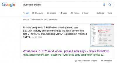

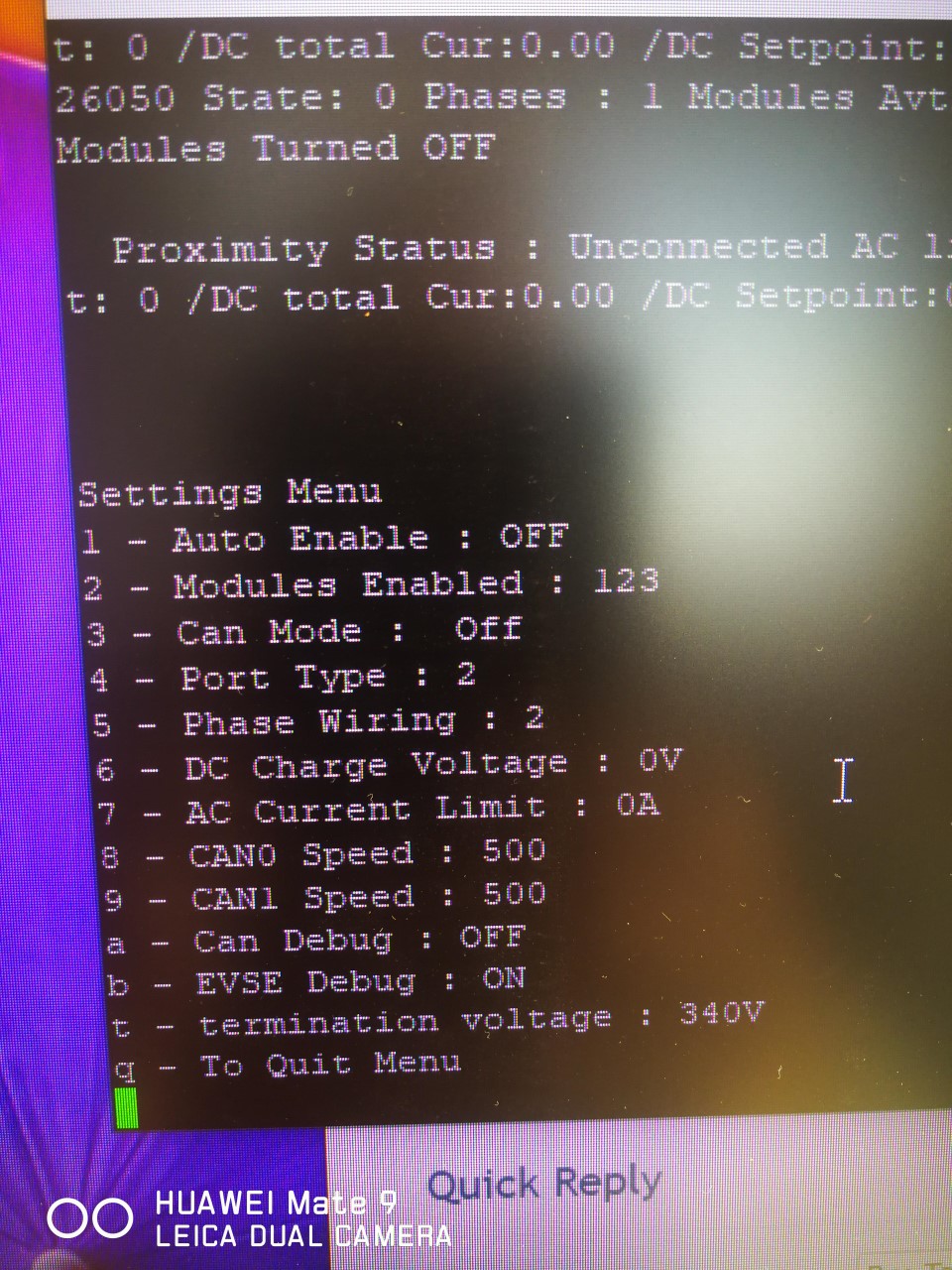

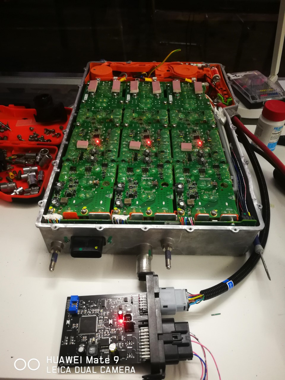

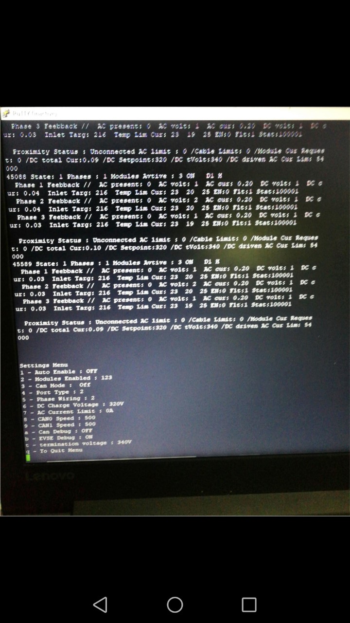

Hi
I have Trouble to config Damiens Controller for Gen3.
I did all well and read the Manual carefully and install the program PuTTy on my Computer.
I start and connect to Controller,press d for stopping the traffic.
press 1 changes Auto eneble is ok!
but i cannot Change Parameter with value!!! only on/off
for example Pressing 3 then 1 or "31" is only switching 1 enable onoff!
does anyone know this Problem?
THX
Thomas

Post by Kevin Sharpe »
nesto1972 wrote: Sat Jan 11, 2020 7:46 pm does anyone know this Problem?
What version hardware and software are you using?
Can you post a video showing this behaviour and show how you've wired up the charger for test? The more information you provide the more likely you are to get help :)

Post by nesto1972 »
i use Windows 10,PuTTY 0.73 x64
I have Gen3 North Amerika Version.
So must the Controller connected to charger modules for config????
I tryed both,no difference!
actual Status when i connect to charger:when i put IN1 to 12 V all three modules led turn on.(god sign??)
I will later post a Video !

nesto1972 wrote: Sun Jan 12, 2020 11:20 am I have Gen3 North Amerika Version.
Assuming you're testing in Austria, how have you wired the mains input? Single Phase or have you modified the charger hardware?
Is this a tested controller board from Damien or one you made yourself?
What firmware version are you using? If you don't know where did you get it from?
nesto1972
Posts: 48
Joined: Sat Jan 11, 2020 7:14 pm
Location: Austria
Post by nesto1972 »
Modified 3 Phase
Yes its a board from Damien!
firmware:no idea
i bought in December so quite new!
Is Damiens Controller without charger configable?

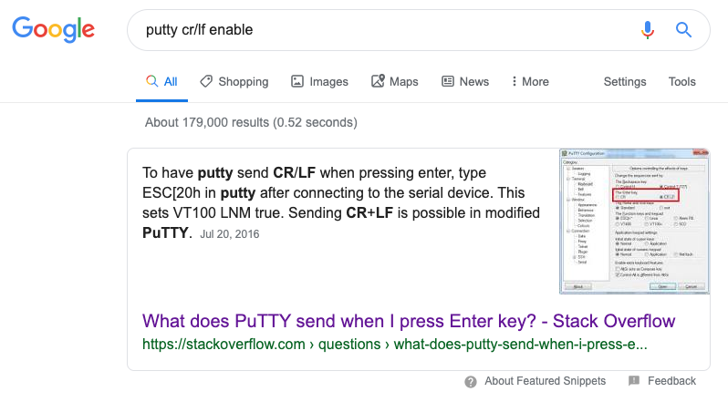

Posts: 4000
Been thanked: 1114 times
Do you have CR/LF enabled on your terminal program? There is no need to change the software on the controller. They are shipped programmed and tested.

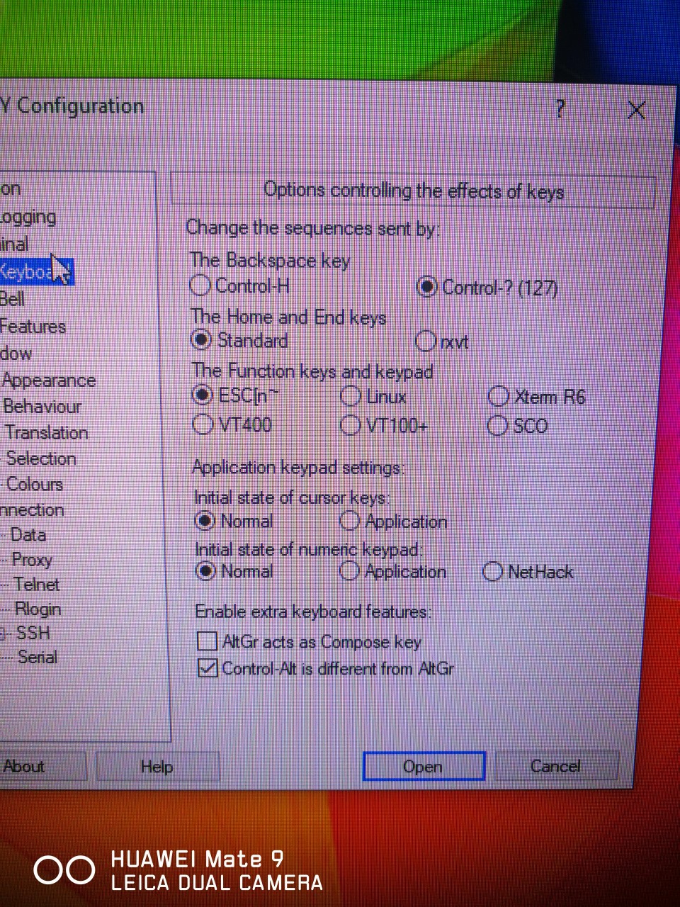

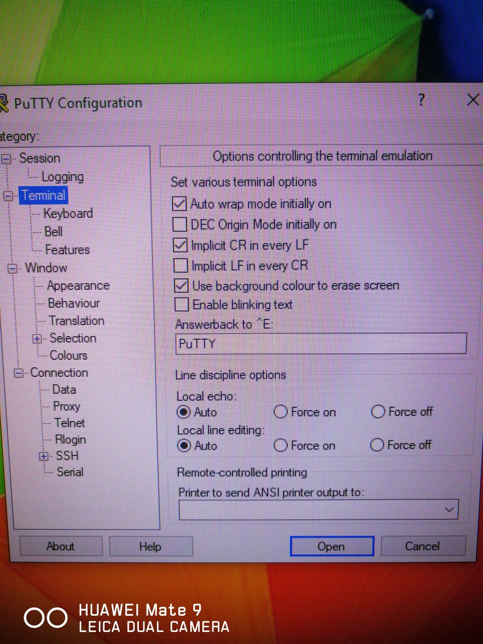

Post by nesto1972 »
Can you tell me where i will find "CR/LF enabled",i looked the whole tree but can not find!
Sorry but for me is the first time using PuTTY!
Also i make a mess trying combinations with keys and they effect programming( Voltage =0,Current =0)
Why is programming not needed??? I have 96S Tesla,and the current should be increased after testing!,no?
Kevin Sharpe
Posts: 1339
Location: Ireland and US
Been thanked: 10 times
nesto1972 wrote: Mon Jan 13, 2020 12:18 pm Can you tell me where i will find "CR/LF enabled",i looked the whole tree but can not find!

Post by nesto1972 »
I enabled CR/LF and typed ESC key [20h ???
no progress!

Posts: 4000
There was a bug on the old v1 pcb with some missing grounds but that was way back. Current designs are fine in that respect to the best of my knowledge.
Posts: 4000
nesto1972 wrote: Mon Jan 13, 2020 7:25 pm No sucess!
I give up 3 days of nightmare!
To clarify when I said you do not need to reprogram the controller I mean you do not need to change the software that is installed.
Please do the following :
Download and install arduino ide from here :
https://www.arduino.cc/en/Main/Software
Connect the controller to your pc with a usb cable
Open the arduino serial monitor at 115200 bps
You should see information scrolling on the screen
type d and press enter. This brings up the menu.
From here you can set the parameters as required.
When set type q and press enter to quit the menu.
If this does not work for whatever reason and you believe there to be a problem with the unit then please contact me via email and return the unit to me for testing.

Post by nesto1972 »
With arduino i made it !
THANKS!!!
