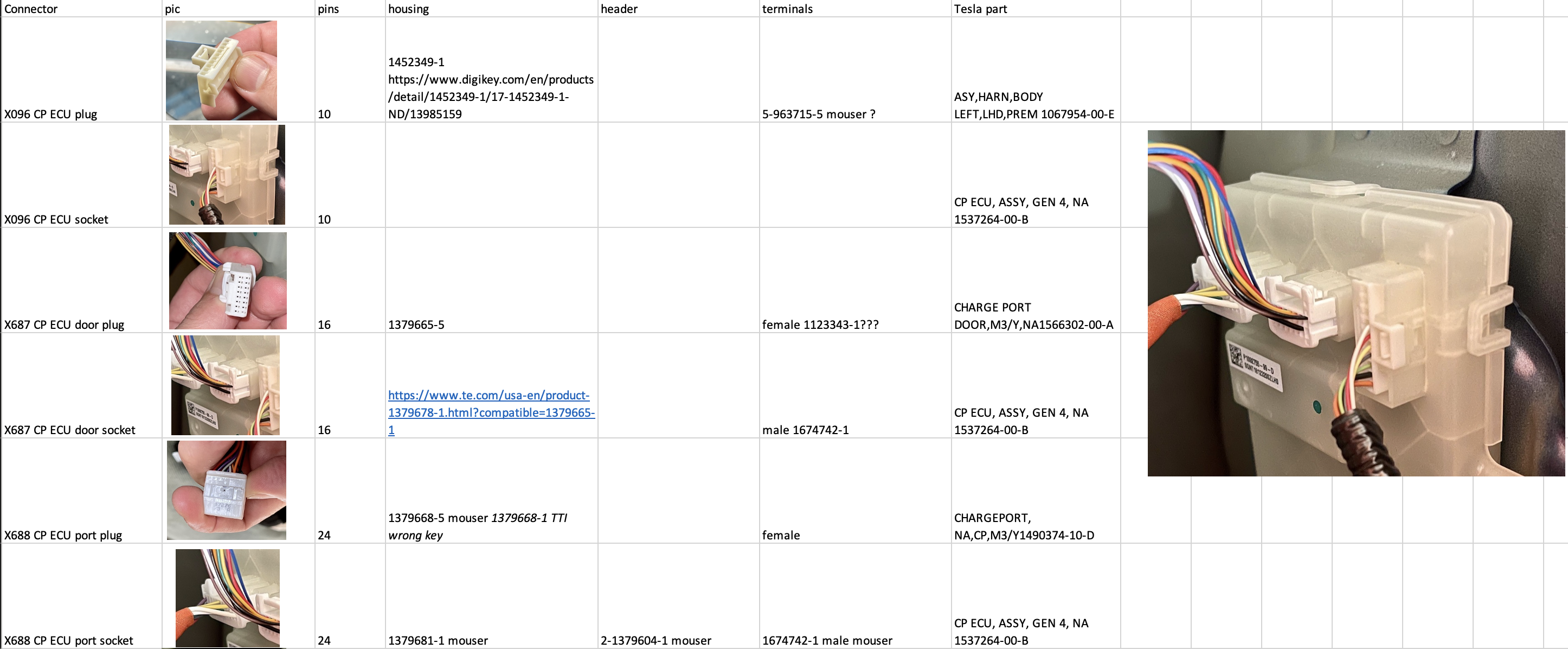

Hello all. I am wondering if anyone has identified the manufacturer and maybe part number of the first two connectors on the CP ECU.
I know the 3rd 10-pin connector is TE MQS (suspiciously not in their MQS catalog) https://www.mouser.com/ProductDetail/TE ... 6cTjbpY%3D
I'm working on a...chargeport project... and would love to plug and play cleanly with the real connectors if possible instead of splicing in.
And maybe soon diving into HV CAN too.

I mean the first two of three connectors on the actual CP ECU. They look sumitomo-ish.

Forgot about this thread, but I spent months prying with TE to figure out chargeport ECU connectors.
In the end we determined some of the sockets literally don't exist and we needed to use the actual Tesla molded housing with stuffed pins with our own PCB inside. But if anyone else needs this information, this is what I ended up with.

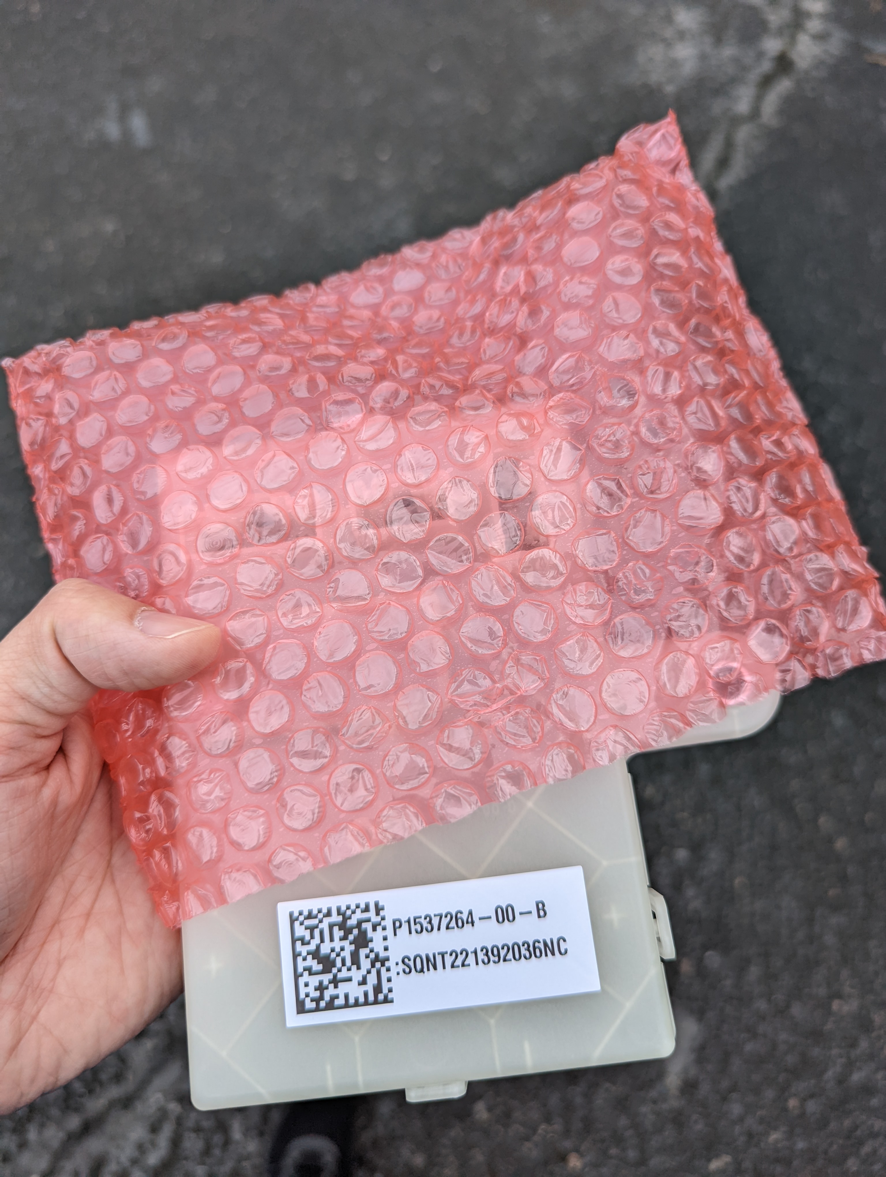

I just picked up something of interest yesterday.
My local Tesla Service Center had them in stock, and after waiting for about 35 minutes to have a conversation, I had the part 5 minutes after that. :)
No idea what state it is in at this point, nor if the data is anything similar to what I had last year.
I'm going to retrofit my 2018 Model 3 to be able to do CCS here in the US.
I would imagine capturing a CCS charge session here might help unlock that on a EU CP controller... at least one can hope.
-Matt

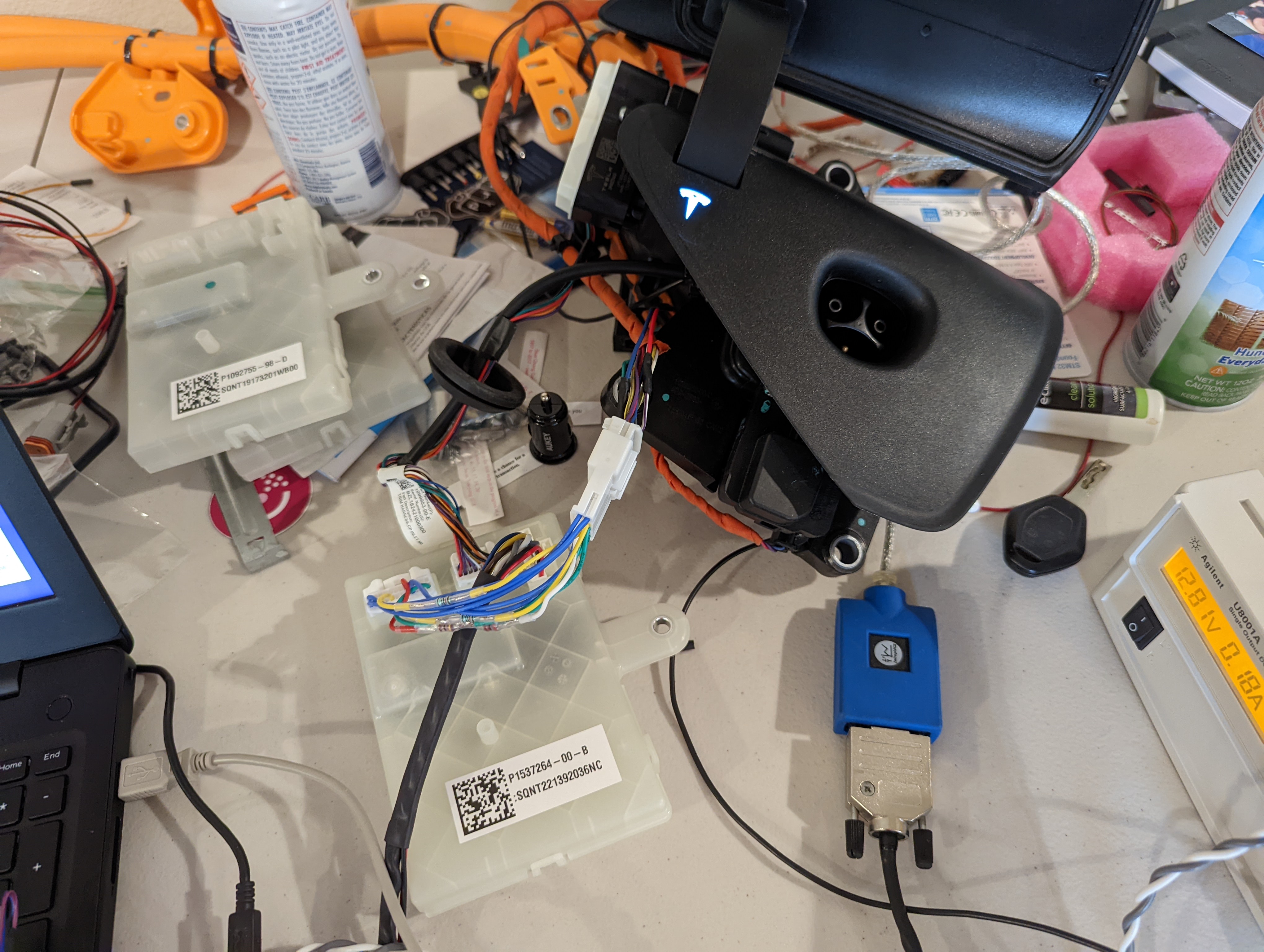

No code changes. :D

Yep, I was very surprised. Cool indeed. :)
Jack Bauer wrote: Fri Jun 17, 2022 9:22 am Matt is back in town:) Looks like a happy "T"
Yes, I'm trying to get back to the EV stuff with more regularity. The BMW reverse engineering stuff is still giving me some heartburn, but I slowly inch closer to that being correct.
Yes I was able to start an AC charge (or at least make the relay go on the wall plug side...), but no idea if the DC stuff works. Looks like the code on there is happy with either the "2019" or "2020" era data coming in to it. (The length of one message changed).
Honestly I was expecting it to be very angry considering it was the new "Gen 4" CP ECU. Apparently while the insides have changed drastically the data is still the same, which is nice.
My CCS adapter should be arriving around the end of the month (I got the case to go along with it which has delayed the order). I will do the CP ECU retrofit this weekend likely, when I can drive over to the service center to put it in service mode and redeploy the firmware.

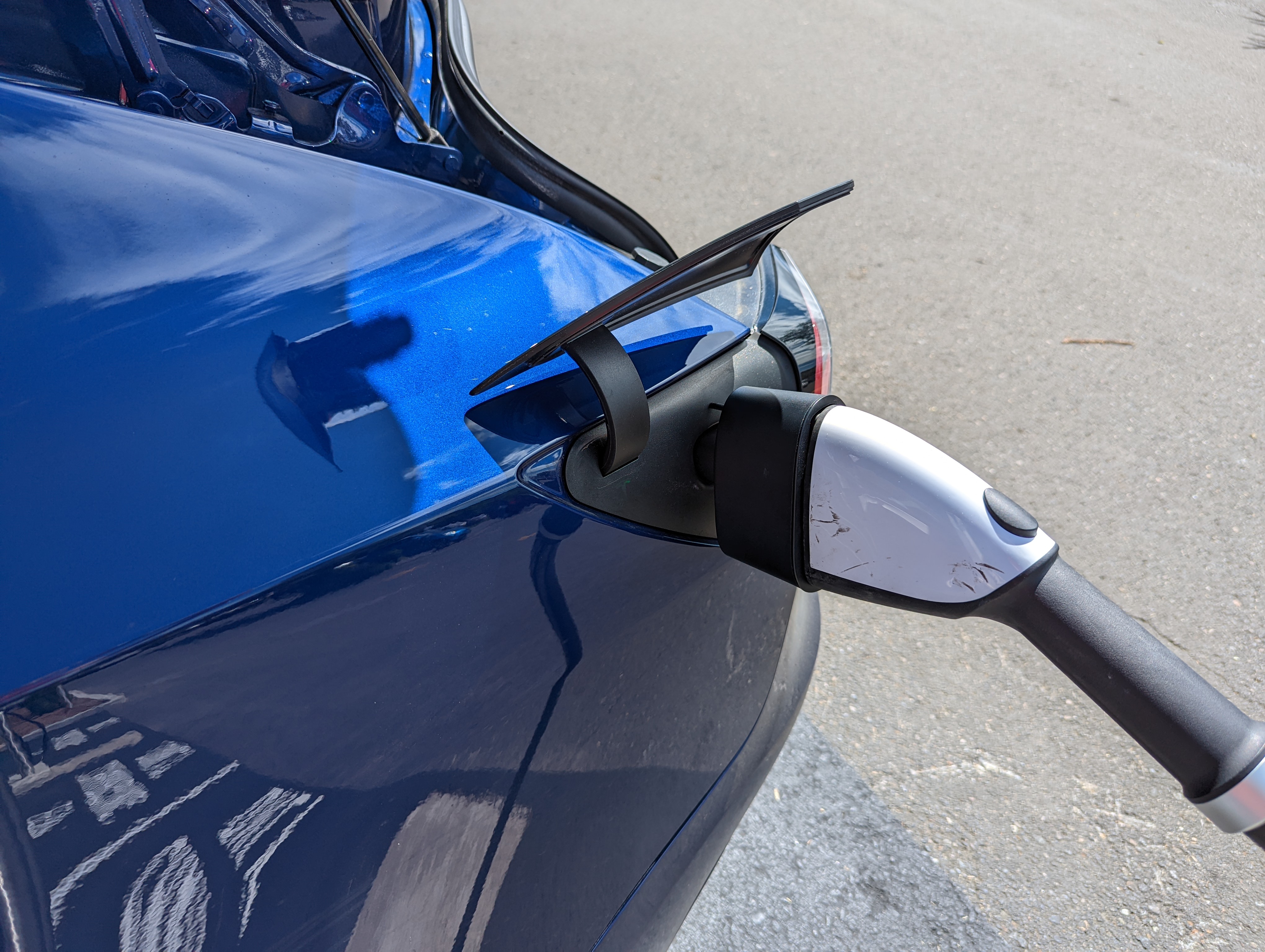

Some good news, some bad news.
Good news: my car should support CCS now. I'm still waiting on my adapter to be shipped from South Korea. I ordered it with the nice carrying case they had, which delayed things. It should be shipping out in the next dew days though.
I drove to the service center and parked in the parking lot, and was able to get the car into service mode. I requested a software reinstall, waited about 3 minutes or so, and then the update icon appeared. I started the update, and it took it about 7 minutes, which is much faster than the normal update process.
Afterwards the car was happy, and an AC charge at home works just fine.
Bad news: the newer firmware does _not_ work with my code. They added a checksum to the HV Software version / Alert, expanded some things, removed others.. and it seems to not like having replayed data fed to it as much anymore..so that's fun.
In the process of working on this I found a bug in my SoC target limit %. Wasn't shifting over enough bits. :)
All of this is suffice to say - I'm going to get this working, but for all intents and purposes the BMW LIM setup is much, much easier. I do appreciate the fact that my Model 3 will be able to charge from AC J1772, AC SWCAN, DC Supercharger, DC ChAdeMO, and DC CCS though. :)
-Matt
