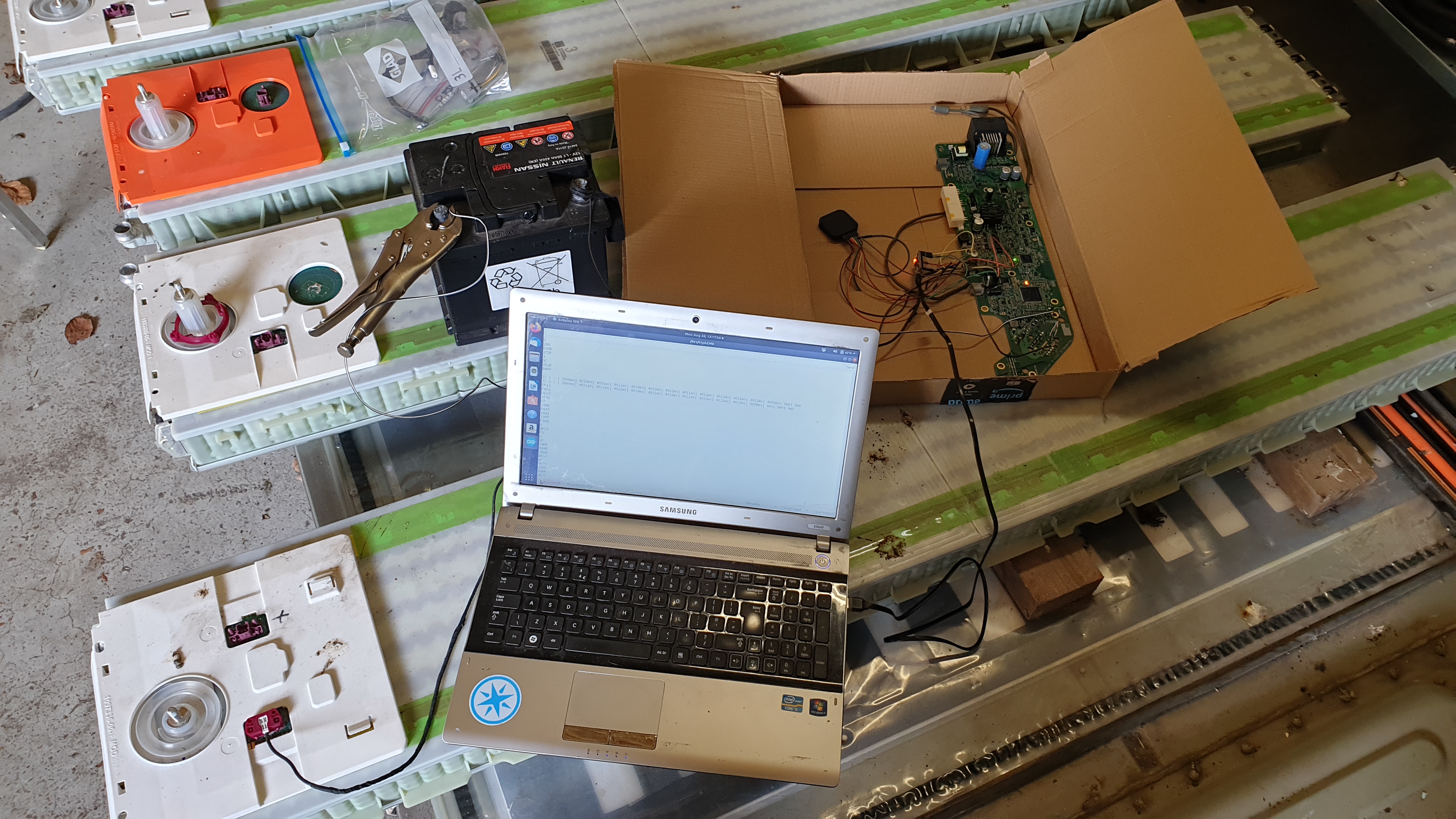

Wait, so it works?
You have to do any mods or you just running my latest software?
- Posts: 3661
- Has thanked: 10 times
- Been thanked: 334 times
Re: Tesla Model 3 Battery Hacking
Yep just works bar a few missing cell voltages:) no mods just copied from your repo.

Think something has broke on the slave?Jack Bauer wrote: ↑Sat Aug 15, 2020 2:03 pm Yep just works bar a few missing cell voltages:) no mods just copied from your repo.
Need to figure out the temperatures next, quite a wierd conversion factor they use.
Can you get a couple of temp sweep captures?
Yeah could be a bad board. I'll test it on a full m3 pack next.

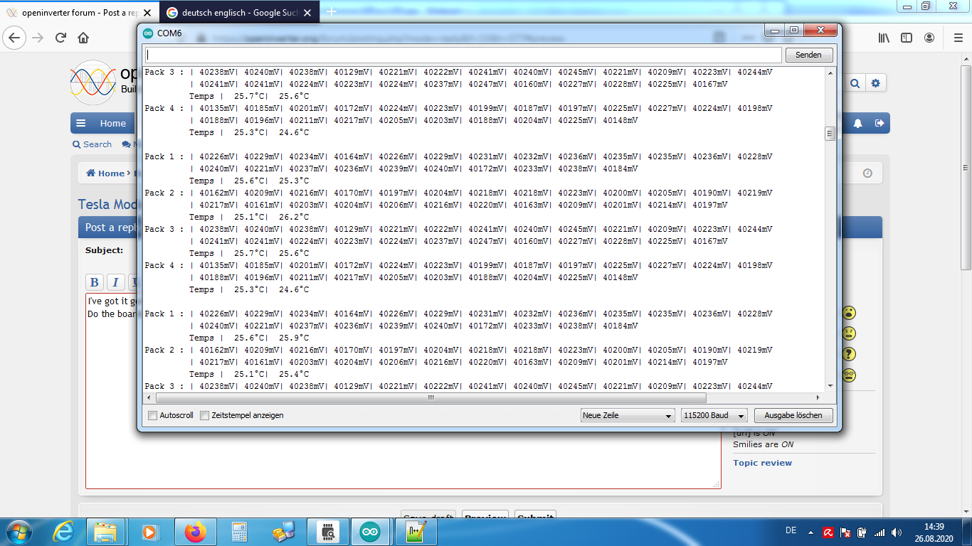

I've got it going now. The biggest problem was the 16bit transmission with the DUE. The temperatures are found. I now wonder how balancing works. Do the boards do this themselves or does a value have to be sent for each cell or a start signal for balancing?
but as already written I have completely different requests!

Well done:) Interesting how you have different requests. How did you get around the 16 bit spi on the due?

Jack Bauer wrote: ↑Wed Aug 26, 2020 1:39 pm Well done:) Interesting how you have different requests. How did you get around the 16 bit spi on the due?
I modified the arduino files SPI.h and SPI.cpp and wrote directly to the sam register.

12.5 vor the voltage to mV( the screenshot is done with 1.25!). And for the temperature 10 to °K with 160 offset
