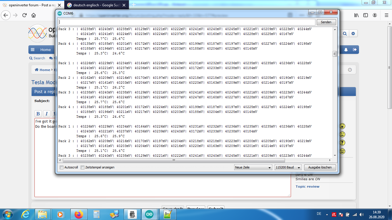

muehlpower
Posts: 807
Has thanked: 18 times
Been thanked: 186 times
Re: Tesla Model 3 Battery Hacking
Post by muehlpower »
Hello,
I did my own tests with the HV controller and got completely different results. I bought a data logger and connected it to the HV controller. Here you find the log data (I hope :? ):
https://github.com/muehlpower/EV-FFB
my battery is from a 2018 US model and both sides of the boards are connected!
muehlpower
Posts: 807
I found all 96 voltage values. But there are other measuring blocks that I cannot assign.
8 times values ​​about 38000
8 times values ​​about 1370
8 times values ​​about 62500
16 times values ​​about 6000

the requests for the voltage are: 0x0763, 0x08F9, 0x09D6, 0x0AA7, 0x0B88 followed by 32 times 0x0000. Always 3 values ​​and a checksum, gives 24 values ​​per request. The order of the values ​​depends on the order of the daisy chain, not on the number of the boards.

muehlpower
Posts: 807
I've got it going now. The biggest problem was the 16bit transmission with the DUE. The temperatures are found. I now wonder how balancing works. Do the boards do this themselves or does a value have to be sent for each cell or a start signal for balancing?
but as already written I have completely different requests!

muehlpower
Posts: 807
Jack Bauer wrote: Wed Aug 26, 2020 1:39 pm Well done:) Interesting how you have different requests. How did you get around the 16 bit spi on the due?
I modified the arduino files SPI.h and SPI.cpp and wrote directly to the sam register.
you can find the program here: https://github.com/muehlpower/EV-FFB The chanigs ar

muehlpower
Posts: 807
tom91 wrote: Wed Aug 26, 2020 2:31 pm
What is the correct divider number for you voltage? Is it 12.5 or 12.8 or something different?
12.5 vor the voltage to mV( the screenshot is done with 1.25!). And for the temperature 10 to °K with 160 offset
