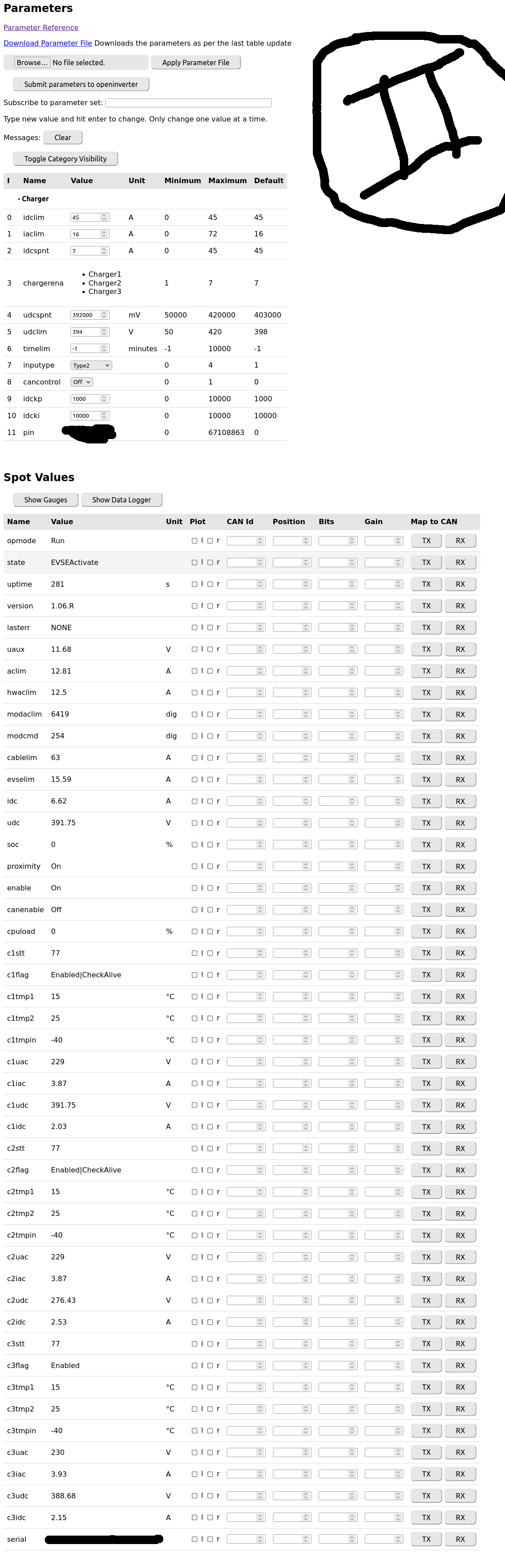

Charged yesterday at 12.5A instead of 7A!
It appears now to be limited by hwaclim @ 12.5A.
For single phase it should be 6.6kW instead of 12.5A * 360V = 4.5kW, no?
Upgraded firmware just now from 1.06.R to 1.09.R but same limit.
From the discussion earlier here I would expected it to be 14A or maybe more.

Very good. We'd need to collect a few "hwaclims" from Gen2 and Gen3 chargers, US and EU. Maybe I'm not scaling it correctly?

johu wrote: Wed Jan 05, 2022 12:45 pm Very good. We'd need to collect a few "hwaclims" from Gen2 and Gen3 chargers, US and EU. Maybe I'm not scaling it correctly?
I've got two more here, one is set up and in a vehicle, I will get a reading from it.

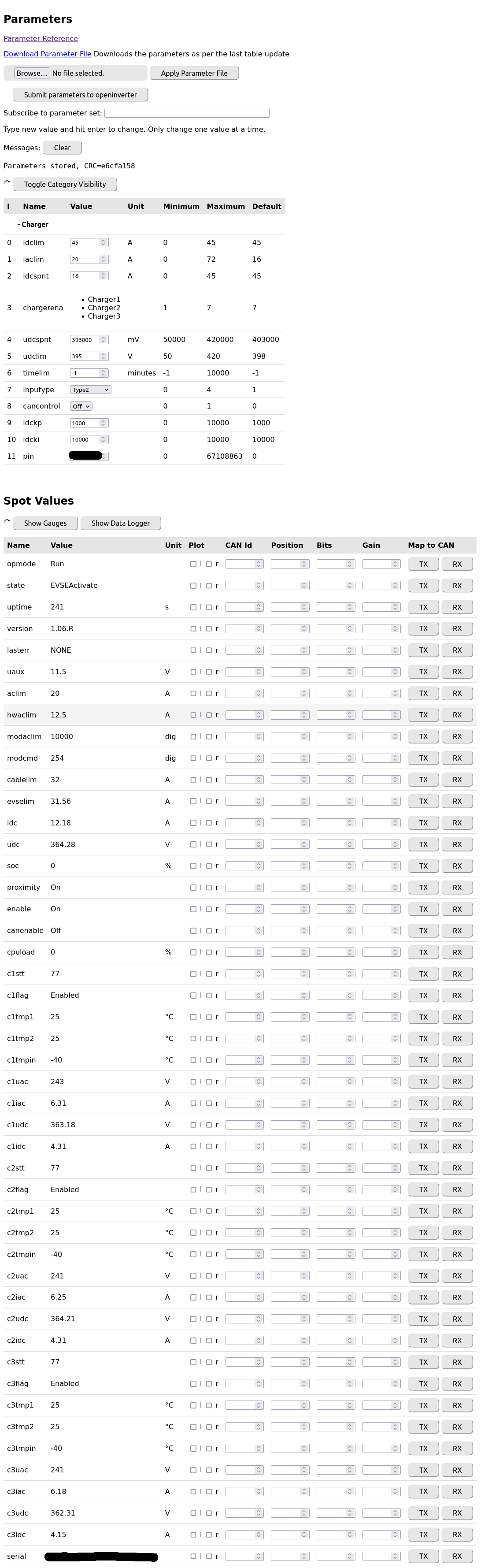

I attached a reading from the other charger, also 12.5A hwaclim.
If you have an idea for a test with different firmware, I am happy to try some variations out this week.
They are from the same vehicle, both Gen2, and with c1, c2, c3 all connected to the same phase.
One with Type 1 cable, the other with Type 2.
EV_Builder wrote: Wed Jan 05, 2022 3:23 pm Do you have a CanBus log?
Yes, I can take one if required, but it sounds like the hwaclim issue is unrelated to the one I saw a few days ago where I sent the wrong message.
Edit: Just saw, on this device udc reads (391.75V, 276.43V(!), 388.68V), but ~2.5A udc on each phase? I should check the connection. Anyway, the first charger limits to 12.5A, and has all three phases reading the same voltage.

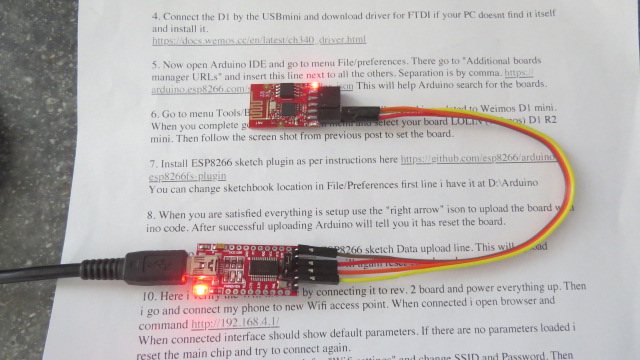

Hi Guys, So I uploaded all the goodies onto the 8266 and it seems maybe I made a mistake or did not load something correctly. I do get the new updated window and the correct ip address but I'm missing the parameters/settings tabs and the serial number is not there either. Do I need to hit the ESP8266 tab and put the Bin file there to finish? I've been reading and reading no luck yet.

Well after to trying to load this now for 3 days I've decided to buy the preloaded Mod 8266 board from you, hopefully I can just plug it in and get the serial number and buy the key from you. I can not believe I can't figure this out. I've tried the D1 Wemos too with no success. On the wemos it loaded everything and was able to get the wifi but no peramters to show up. Tried loading the loader.hex and charger.hex again with no luck. Then tried to load the stock Mod 8266 chip and everything loaded except the spiffs. Aaaarrrggg Double checked everything way too many times. It's funny one place says just use an ST-link-V2 but the Mod8266 does not have the correct inputs only tx and rx no swido so I just tried to hook it to the receive pin of the Mod8266 but no success there either. I have no idea what I'm doing wrong. I've tried every tutorial on how to do this.

Assuming the charger is programmed more or less like a standard inverter:
-Flash ESP8266 with whatever it needs (spiffs, html files, etc.). Sounds like you've got this done.
-Flash STM32 on the charger board using ST-Link. First stm32_loader, then stm32_charger (latter can be done using ESP8266?).
viewtopic.php?f=3&t=6&hilit=st+link -- this has super useful info (a bit outdated, but if you can find the swdio and swclk pins on the charger board it should work). Of course you're not flashing stm32-sine but stm32_charger.

Yes I saw your order but I suspect it might not help. Is the LED on the charger board flashing?
Also there seems to be some misconception: the 8266 board is flashed using a standard USB->UART cable while the STM32 is flashed with the ST-link
Roadstercycle

I am using the usb->UART setup. It did flash when I installed the firmware using Arduino. I got the first set of the code installed then the reset happened then installed the next set but it gave me an error spiffs not installed. Reinstalled, still nothing. Tried the Wemos D1 and everything loaded fine and got the web up but no preferences. Tried reinstalling the 2 HEX files there OTA with no luck.
I used Dima's explanation and setup for the UART is that the one you would suggest?
Why do you expect the new MOD 8266 not help? Doesn't it already come come ready to go with your new firmware and just needs your key install by OTA

OK, so maybe I screwed up here. I thought that I was suppose to program was the Mod8266. I had no idea I was supposed to do the board itself also. So I have to do the board and the Mod8266. Is this correct?

Johu, OK, alls good. I had no idea about flashing the board itself. Works perfect. So I will send you the serial number of the firmware now. Please cancel my other order if you can and use this for the charge key and keep the change.

Good morning. So this morning I plug in the charger to install the PIN and no parameters show up to be able to put the pin in. It's charging with yesterdays 5 minute parameters but they don't show up this morning on the web interface. The web interface is there.Any thoughts before I go through the whole process again? Weird.
Been thanked: 1913 times
Re: Tesla Charger alternative firmware
I don't know if it's a problem with the latest batch of Olimex modules or what, but basically they don't seem to always make good contact. Just wiggle it or press down on it to confirm. I've had this problem just 5 minutes ago on the VCU

I give that a shot. You don't have to reflash the board after the 5 minute timer, correct? It should just charge for 5 minutes every time you plug it in before you put in the Pin, correct?
yes
