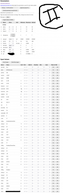

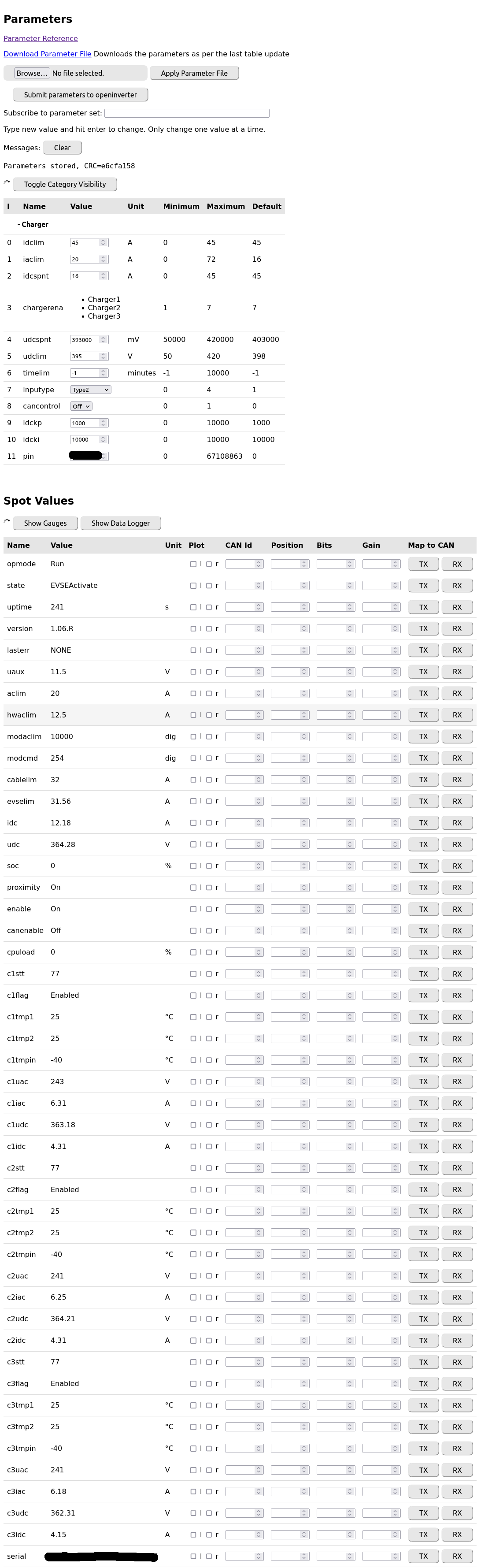

Re: Tesla Charger alternative firmware
Charged yesterday at 12.5A instead of 7A!
It appears now to be limited by hwaclim @ 12.5A.
For single phase it should be 6.6kW instead of 12.5A * 360V = 4.5kW, no?
Upgraded firmware just now from 1.06.R to 1.09.R but same limit.
From the discussion earlier here I would expected it to be 14A or maybe more.

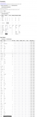

I attached a reading from the other charger, also 12.5A hwaclim.
If you have an idea for a test with different firmware, I am happy to try some variations out this week.
They are from the same vehicle, both Gen2, and with c1, c2, c3 all connected to the same phase.
One with Type 1 cable, the other with Type 2.
Yes, I can take one if required, but it sounds like the hwaclim issue is unrelated to the one I saw a few days ago where I sent the wrong message.
Edit: Just saw, on this device udc reads (391.75V, 276.43V(!), 388.68V), but ~2.5A udc on each phase? I should check the connection. Anyway, the first charger limits to 12.5A, and has all three phases reading the same voltage.

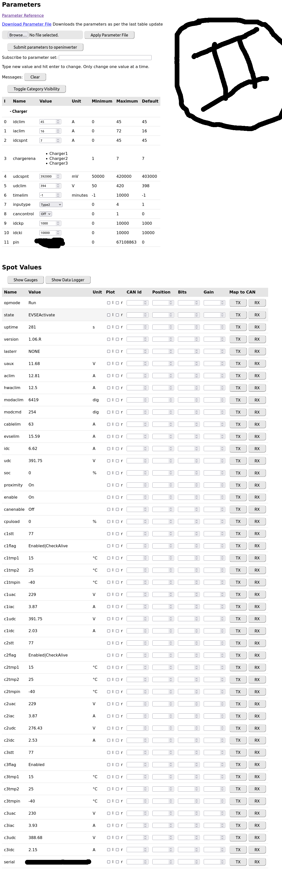

Can I pour water into my GEN2 charger and still use it?
Surprisingly: Yes, for a bit. Then it dies.
Quick update on this wet charger that landed on my desk in Apr '21: https://openinverter.org/forum/viewtopi ... 801#p26801
It worked fine for sporadic use, then failed this Wednesday morning.
I tried it on the bench and it kept dropping out, same as in the vehicle.
Now the three phases in it can be activated separately (thanks to Johu's web interface).
C1 only: Charges fine
C2 only: Charges, but reads 100V low (~230V, I wonder what happens if it goes under 200V)
C3 only: drops out
C3 & C2: drops out
C1 & C3: drops out
C1 & C2: charges fine, despite low reading on C2.
Conclusion:
C3 is gone.
C2 is on its way out.
C1 is fine for now.
This will be my bench charger until it dies completely.

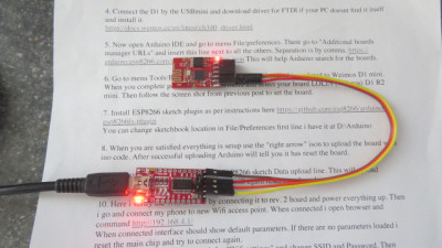

Hi Guys, So I uploaded all the goodies onto the 8266 and it seems maybe I made a mistake or did not load something correctly. I do get the new updated window and the correct ip address but I'm missing the parameters/settings tabs and the serial number is not there either. Do I need to hit the ESP8266 tab and put the Bin file there to finish? I've been reading and reading no luck yet.
- Posts: 6968
- Has thanked: 454 times
- Been thanked: 1771 times
The parameters only show up once you've flashed the firmware onto the STM32. Flashing just the ESP doesn't suffice
Thought I did all that already. I'll give it another shot. Was it the BIN and 2 Hex files?
- Posts: 6968
Just the 2 hex files. stm32_loader.hex and stm32_charger.hex

I am using the usb->UART setup. It did flash when I installed the firmware using Arduino. I got the first set of the code installed then the reset happened then installed the next set but it gave me an error spiffs not installed. Reinstalled, still nothing. Tried the Wemos D1 and everything loaded fine and got the web up but no preferences. Tried reinstalling the 2 HEX files there OTA with no luck.
I used Dima's explanation and setup for the UART is that the one you would suggest?
Why do you expect the new MOD 8266 not help? Doesn't it already come come ready to go with your new firmware and just needs your key install by OTA
