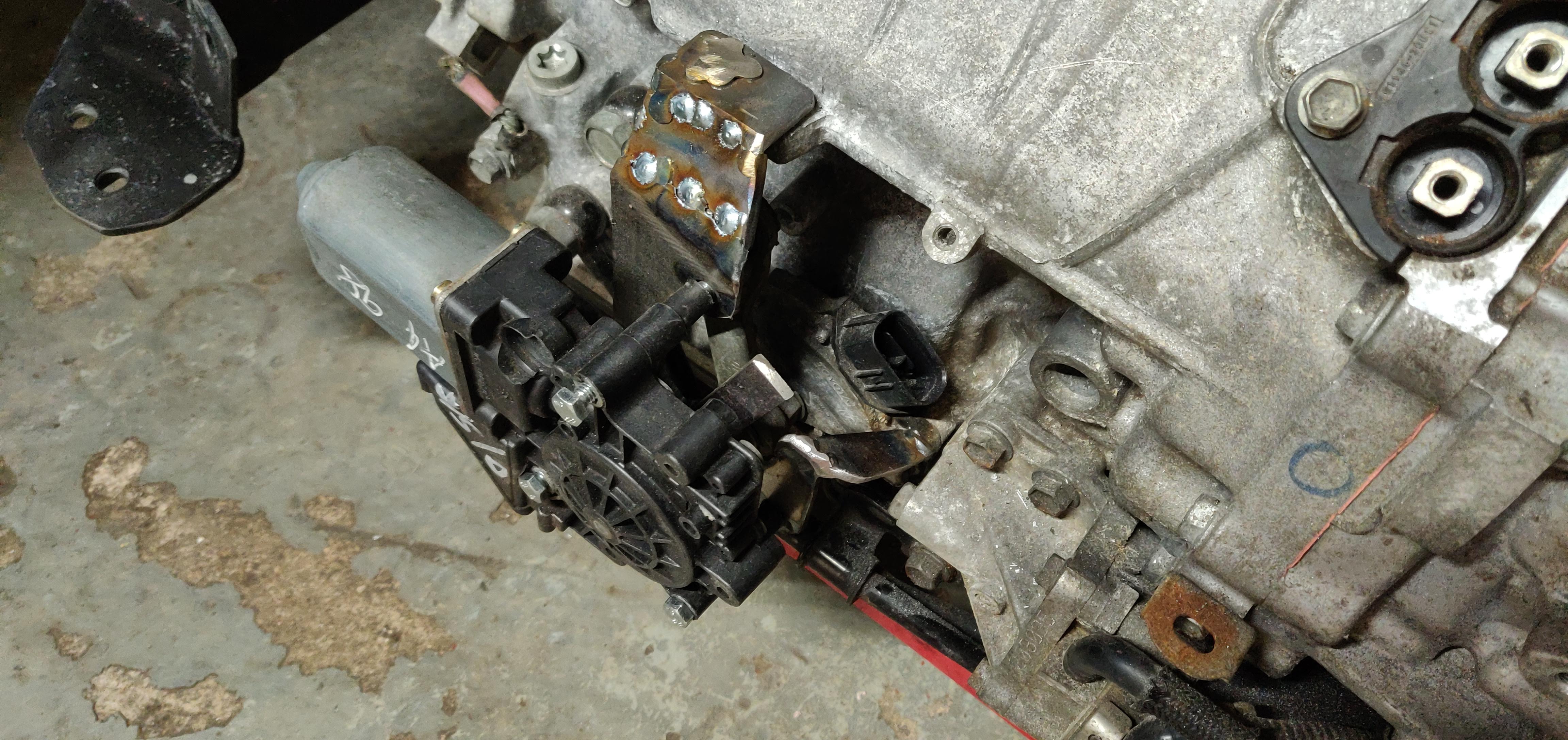

I'm also using an alternate method of selecting direction. For the park position, I used an old window motor with a crank shaped arm welded onto the output shaft. I use the Park/Reverse positions of the gear selector to tell me when to stop the motor.

Yep, the GS has a solenoid as part of the shifter assembly. For a bare transmission, you don't get that.
Since I used a motor to move in/out of park, I do the lockout in software (I take the two brake pedal sensors as inputs).
I'm not sure how you'd implement a lockout solenoid, to be honest, it might be best to find a suitable shifter assembly from an existing car (maybe a Ford or GM or something common/cheap to play around with).

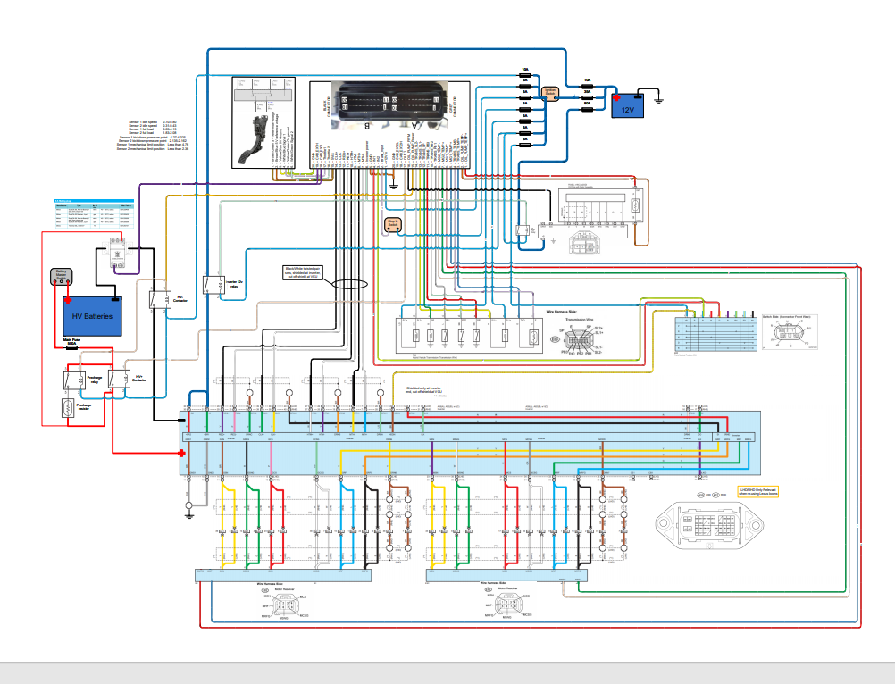

Hi Everyone,
I was finally able to wire up the complete GS450H inverter to the GS450H transmission on my work bench. What a major PITA making up the wiring harness.
supply power to the VCU, all LEDs came on
Supplying 24VDC to the HV inverter input
Triple and Quadrupled checked all the wiring connections
With the trans in drive (D) or (R) I don't not see/here anything from anywhere when I press on the gas pedal.
no oil pump, no rotating transmission, inverter power relay doesn't kick in,
only thing that happens is the pre charge relay, and the (-)High Voltage relay comes on but turns off after a few seconds.
I have a few questions
1. are both input from gas pedal needed?
2. What state does the Stop light switch need to be in? closed or open
3. I'm I missing something simple?
4, Shouldn't the oil pump come on when the VCU is powered up?
I know this are kind of open ended question but any tips would be greatly appreciated.
I followed this wiring diagram.
Thanks.

What sort of motor do you use to move in and out of park, trying to find one now (maybe you could send me the one you use)xp677 wrote: ↑Tue Jan 05, 2021 10:38 pm Yep, the GS has a solenoid as part of the shifter assembly. For a bare transmission, you don't get that.
