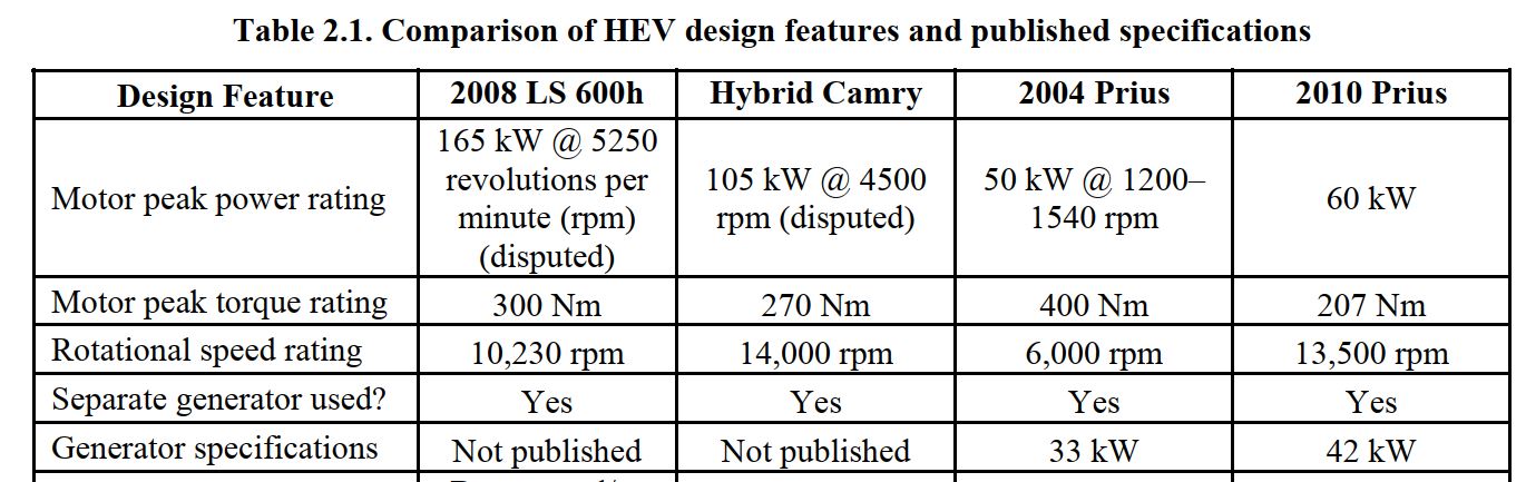

Re: Prius Gen3 Inverter Hacking
At 6006 rpm,
gear losses are: 1645.3W (25C)
motor rotor losses are: 472.8W
planetary gears,
gen rotor,
sun gear losses are: 264.9W (don't have gen on its own)
According to: pg 24 Evaluation of 2004 Toyota Prius Hybrid Drive System ORNL
planetary gears,
gen rotor,

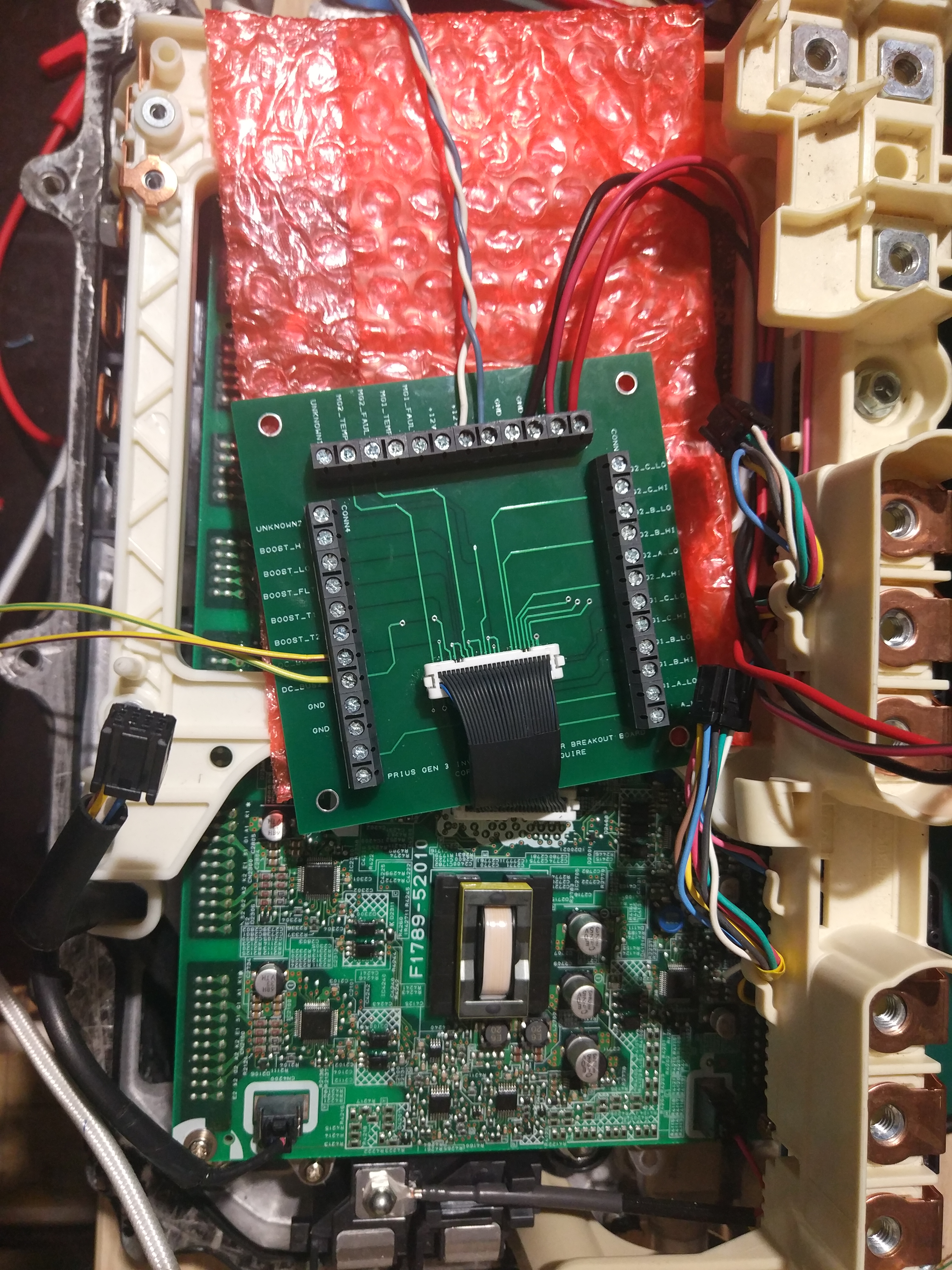

Schematic for the V2 board now done.
PriusG3_V2 - Schematic.pdf- (479.89 KiB) Downloaded 550 times

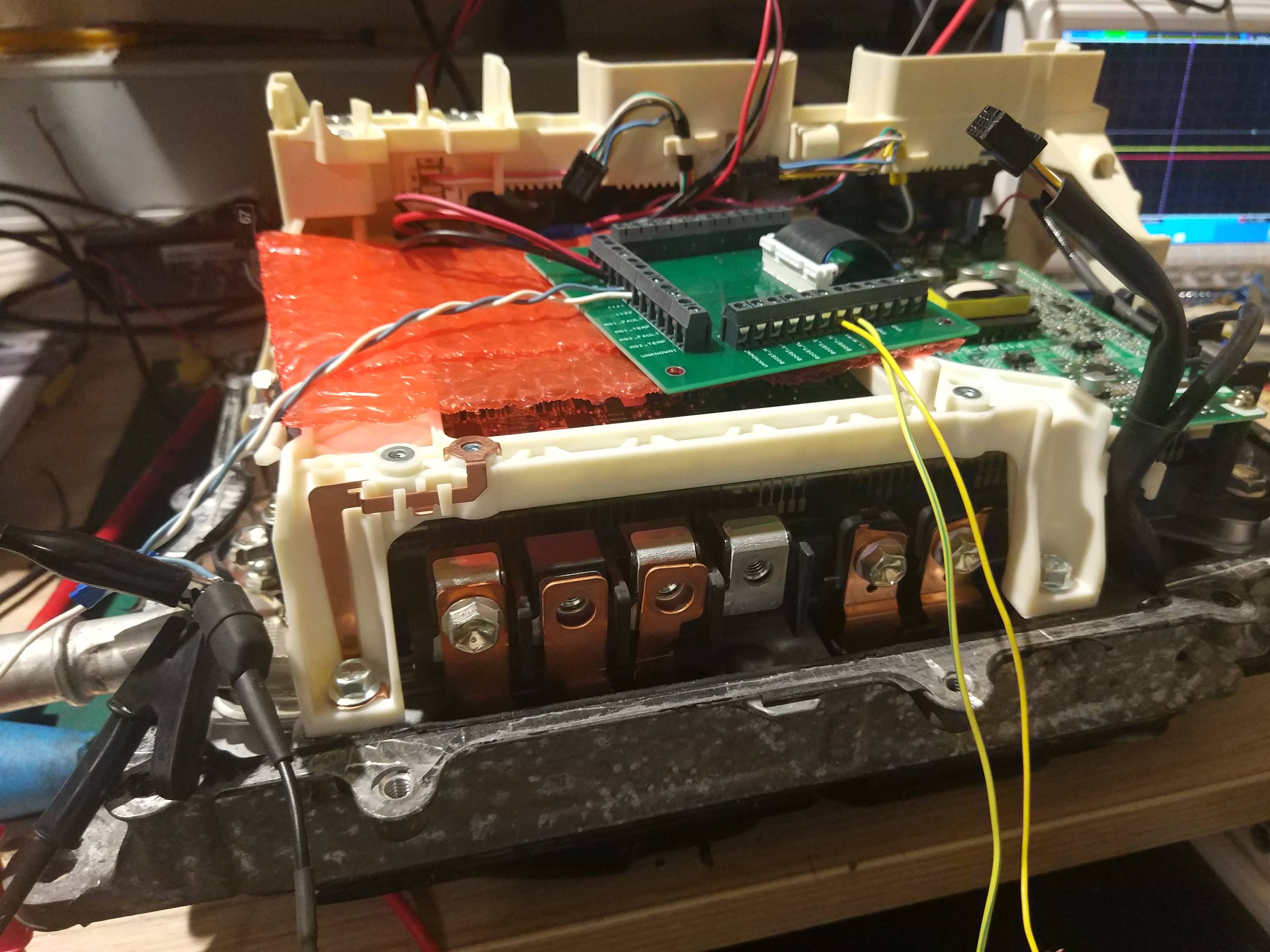

Hi JB
I am working on my Prius inverter to charger conversion.
BTW i used your board outline as a measure and will credit you of course
Now i am observing 50p control cable and others. Can you answer a question or two
- What is the purpose of conn9 pin HVIL? Is this a live HV+ signal or is it opto isolated analog signal. Or even further, digital data for HV value?
- What is the Fault signal like? Is it Active Low or Active High? It is the same for all PS, no?
- What is the characteristic of coolant sensor? Is it NTC or digital? Need to make a values table and i dont want to mess up my workshop
the table?
EDIT:
- Also, what is the polarity of IGBT signals. Are they direct or invered?
tnx
Arber

- Posts: 4006
- Been thanked: 1136 times
arber333 wrote: ↑Sat Aug 31, 2019 8:45 pmOK I found some more info on one of the posts on DIYELECTRICCARarber333 wrote: ↑Sat Aug 31, 2019 8:57 amHi JB
BTW i used your board outline as a measure and will credit you of course.
HVIL = High Voltage Interlock. It is a loop used to detect if hv connectors are properly seated, cover is in place etc. In this case I loop it into the NAND gate and have a jumper to disable for testing.
Fault signals are 5v when not faulted and pull low when a fault is detected. It is worth noting that even if you ignore fault signals the igbt drivers shut down anyway:)
- What is the characteristic of coolant sensor? Is it NTC or digital? Need to make a values table and i dont want to mess up my workshop. Do you have
the table?
I have not got that far as yet but they do look like ntc. The igbt temp sensors seem to exactly match the semikron option in tmphs.

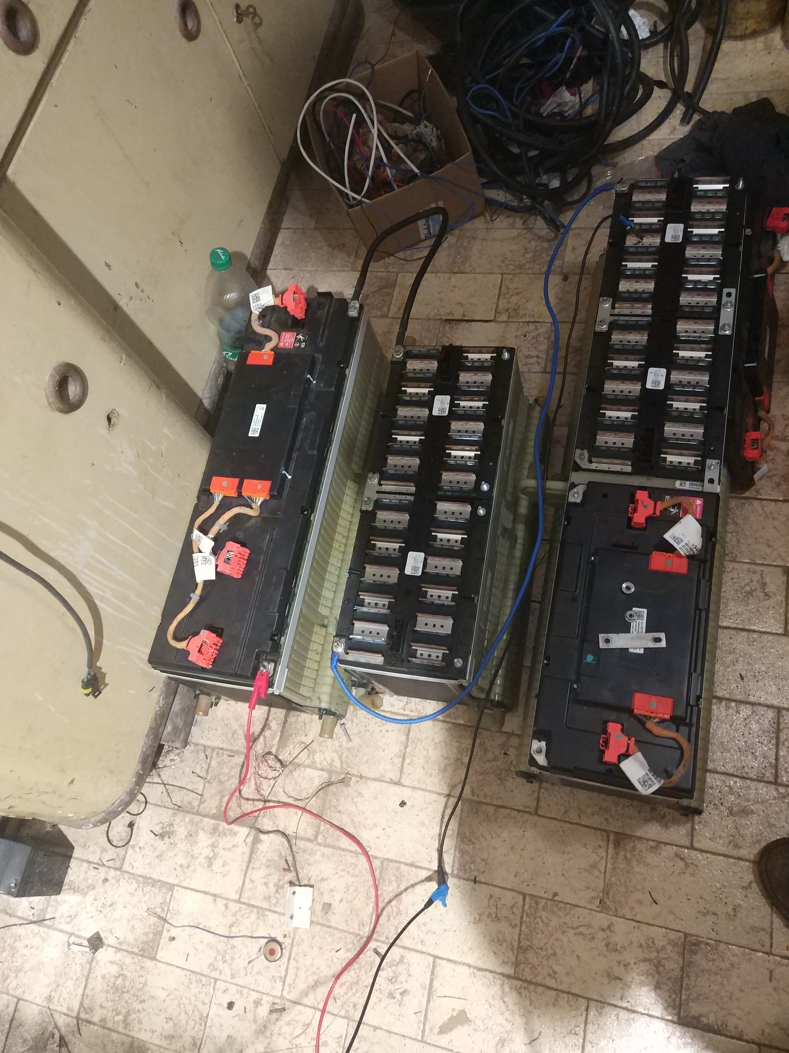

I have connected my Ampera battery to Prius inverter and observed DC_BUS1 and DC_BUS2 signals. There are three power supplies needed for operation of power section. I used Lab PSU for 13.7Vdc and 2x simple 5V 1A ACDC power supply. Since we need to supply -5V and +5V i wired outputs in series so i got +5V, GND and -5V. This can be done because both 5V supplies have isolated inputs. I see i will have to make 2 simple split supplies for my board design similarly to what JB did.
Heres what I found out:
1. DC_BUS1 measures voltage on the Battery side, when battery is disconnected it is effectively 0V.
2. DC_BUS2 measures voltage on the motor DC side. When i move outside source its value is 0.554V.
3. When battery is at 213Vdc i get DC_BUS1 value and DC_BUS2 value 1.075V.
I could go up to 380Vdc with Ampera battery and i arrived to BUS voltage 4,758V.
I can see from data that battery voltage is limited to something around 400Vdc. There DC_BUS1 becomes 5V and Arduino AD wont be able to reference above that. I have yet to try over 400Vdc. I have 32V power supply which i can wire in series with battery. This will show how high this inverter can go.
Also i intend to try to connect 3phase 400Vac and inverter should make 600Vdc rectified.
I input rest of values into XLS file to interpolate between them, see the file.
Prius Voltage response.xlsx- (25.86 KiB) Downloaded 308 times

Answered my own question, according to Oakridge 2010 Prius evaluation, page 6:
Prius Generation 3 Inverter: Generator output can be up to 42kW , therefore this should be able to drive my Prius Gen 2 50kW motor with enough voltage.
Anyway, if it is a limitation, i will work out a way to swap the transaxle MG1and MG2 cables.
