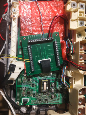

Schematic for the V2 board now done.
PriusG3_V2 - Schematic.pdf
- (479.89 KiB) Downloaded 525 times

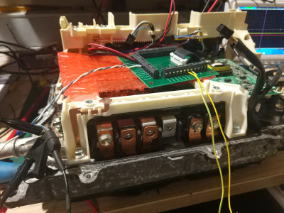

Hi JB
I am working on my Prius inverter to charger conversion.
BTW i used your board outline as a measure and will credit you of course
Now i am observing 50p control cable and others. Can you answer a question or two
- What is the purpose of conn9 pin HVIL? Is this a live HV+ signal or is it opto isolated analog signal. Or even further, digital data for HV value?
- What is the Fault signal like? Is it Active Low or Active High? It is the same for all PS, no?
- What is the characteristic of coolant sensor? Is it NTC or digital? Need to make a values table and i dont want to mess up my workshop
the table?
EDIT:
- Also, what is the polarity of IGBT signals. Are they direct or invered?
tnx
Arber

Re: Prius Gen3 Inverter Hacking
arber333 wrote: ↑Sat Aug 31, 2019 8:45 pmOK I found some more info on one of the posts on DIYELECTRICCARarber333 wrote: ↑Sat Aug 31, 2019 8:57 amHi JB
BTW i used your board outline as a measure and will credit you of course.
HVIL = High Voltage Interlock. It is a loop used to detect if hv connectors are properly seated, cover is in place etc. In this case I loop it into the NAND gate and have a jumper to disable for testing.
Fault signals are 5v when not faulted and pull low when a fault is detected. It is worth noting that even if you ignore fault signals the igbt drivers shut down anyway:)
- What is the characteristic of coolant sensor? Is it NTC or digital? Need to make a values table and i dont want to mess up my workshop. Do you have
the table?
I have not got that far as yet but they do look like ntc. The igbt temp sensors seem to exactly match the semikron option in tmphs.
EDIT:
The igbt drive lines must be pulled low via a 100R resistor in order to activate the associated gate.
tnx
Arber

Ok JB, can you confirm following?
- i will only use PWM on BOOST top driver and pull BOOST low driver up to 5V. This will give me Buck converter from 600Vdc to 380Vdc etc...
- If i dont want to use MG1 phase contacts i need to pull MG1 driver tracks up to 5V?
- If i want to use MG2 phase contacts as input for 3phase i need to pull its driver tracks to 5V. This way i will only use reverse diodes to rectify 3phase.
- Do you think i can leave MG1 and MG2 fault pins floating. Only BOOST fault pin will matter for charging anyway.
What kind of signal is DCBUS 1 and 2? Is it analog 0V - 5V? I cant test because i already took my Prius board apart.
tnx
arber333 wrote: ↑Mon Sep 02, 2019 12:37 pm Ok JB, can you confirm following?
they have their own pullups
yes that's fine.
Its in my notes. Will lookup.

Tnx Damien.
Theese days i was working couple of times late at night and comparing notes suffers somewhat...
So i will summarize
. Feel free to correct me.
- To drive charger i will use EMW setup with some of my twists
- HVIL = High Voltage Interlock. For DIY built we can ignore this one IF we use our own safety in maintenance - our brain.
- Fault signals are 5v when not faulted and pull low when a fault is detected. I will definitely use this with some NC interface to inhibit PWM
- I will use original NTC and later compare characteristic to semicron in code. If not i see i can use whatever sensor on the coolant line i can imagine
- Current sensors are 5v centered and react at 10mV/A
- MG and BOOST drivers have their own pullups in the circuit and we can ignore them if we dont use them.
- Since i will be using HCPL-7520 to sense output voltage i will ignore DCBUS contacts for now. Maybe later in adaptation we could just use that I/Os and adapt the code.
I decided i will not use original current sensors. Thay are located on MG lines that will be my inputs. I would need to calculate PWM difference etc... Rather i will put one Tamura L31S100S05FS 5V sensor after capacitor output line.
There is still a problem where (if) to mount output diode. But if we consent to keep charger permanently connected we can use a NTC resistor across DC contactor to keep DC link precharged. I always use diode like VS-RA160FA120. It could be mounted directly to the car chassis to dissipate heat.

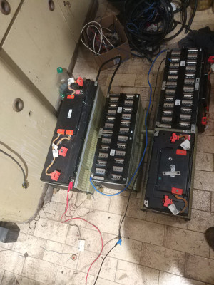

I have connected my Ampera battery to Prius inverter and observed DC_BUS1 and DC_BUS2 signals. There are three power supplies needed for operation of power section. I used Lab PSU for 13.7Vdc and 2x simple 5V 1A ACDC power supply. Since we need to supply -5V and +5V i wired outputs in series so i got +5V, GND and -5V. This can be done because both 5V supplies have isolated inputs. I see i will have to make 2 simple split supplies for my board design similarly to what JB did.
Heres what I found out:
1. DC_BUS1 measures voltage on the Battery side, when battery is disconnected it is effectively 0V.
2. DC_BUS2 measures voltage on the motor DC side. When i move outside source its value is 0.554V.
3. When battery is at 213Vdc i get DC_BUS1 value and DC_BUS2 value 1.075V.
I could go up to 380Vdc with Ampera battery and i arrived to BUS voltage 4,758V.
I can see from data that battery voltage is limited to something around 400Vdc. There DC_BUS1 becomes 5V and Arduino AD wont be able to reference above that. I have yet to try over 400Vdc. I have 32V power supply which i can wire in series with battery. This will show how high this inverter can go.
Also i intend to try to connect 3phase 400Vac and inverter should make 600Vdc rectified.
I input rest of values into XLS file to interpolate between them, see the file.
