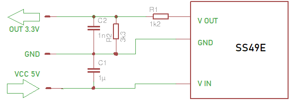

I've got some SS49E sensors. If I feed them with 3.3V will I get need signal without any dividers?

konstantin8818 wrote: Thu Apr 09, 2020 8:27 pm I've got some SS49E sensors. If I feed them with 3.3V will I get need signal without any dividers?
It seems it always centers at 2.5V? So better 5V and divide down.
I am not sure. From datasheet it looks like they are centered at 2.5V. I think you will still need a divider. What kind of line resistor do you have on your board? You can solder one pulldown resistor next to it 2x the size. E.g. if line is 3K3 than use 6K8 or if line is 10K use 20K resistor etc.
EDIT: Damien uses 1K resistors with some caps on Bluepill board. You could replace both resistors and use your sensors with 3K3/6K8 divider and 1nF cap.

And about simple divider: Is this correct scheme I draw based on your sensor board but with SS49E insteard of MLX91205?

And the gen2 current sensors are 15Vpp so you would need to change R2 and R4 in the daycounter schematic to 22k and it would be preferable to use a 1.65V reference. Cheapest option is to use a 3.3V reference followed by a precision 50:50 resistor divider as 1.65V references seem ridiculously expensive.

kiwifiat wrote: Fri Apr 10, 2020 1:54 am And the gen2 current sensors are 15Vpp so you would need to change R2 and R4 in the daycounter schematic to 22k and it would be preferable to use a 1.65V reference. Cheapest option is to use a 3.3V reference followed by a precision 50:50 resistor divider as 1.65V references seem ridiculously expensive.
The ADC uses the 3V3 supply rail as its reference and the current inputs are assumed (in the code) to be zero at pwm startup.
The offset voltage source need be no more complicated than a 1/2 supply rail divider followed by a buffer amp.
