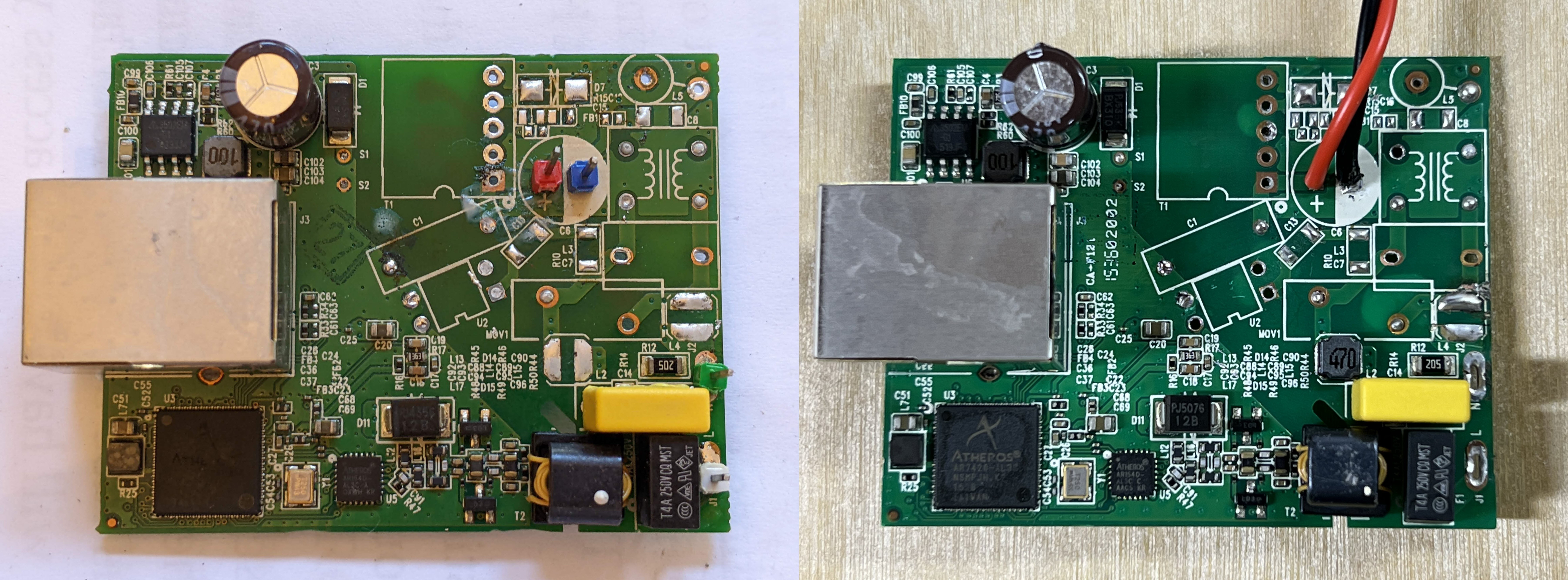

Found my solder sucker, in the wrong bin as usual.
Charlie's pic was enormously helpful, but I either bought a bum unit (foolishly, I forgot to plug it in to mains before attacking with the Dremel) or I managed to zap it, though I was being quite careful. It draws no current at all, either at 5V up to 12v, and of course none of the three LEDs light, button is non-op.
Off to buy another . . .
Charlie's on the left, mine on the right.

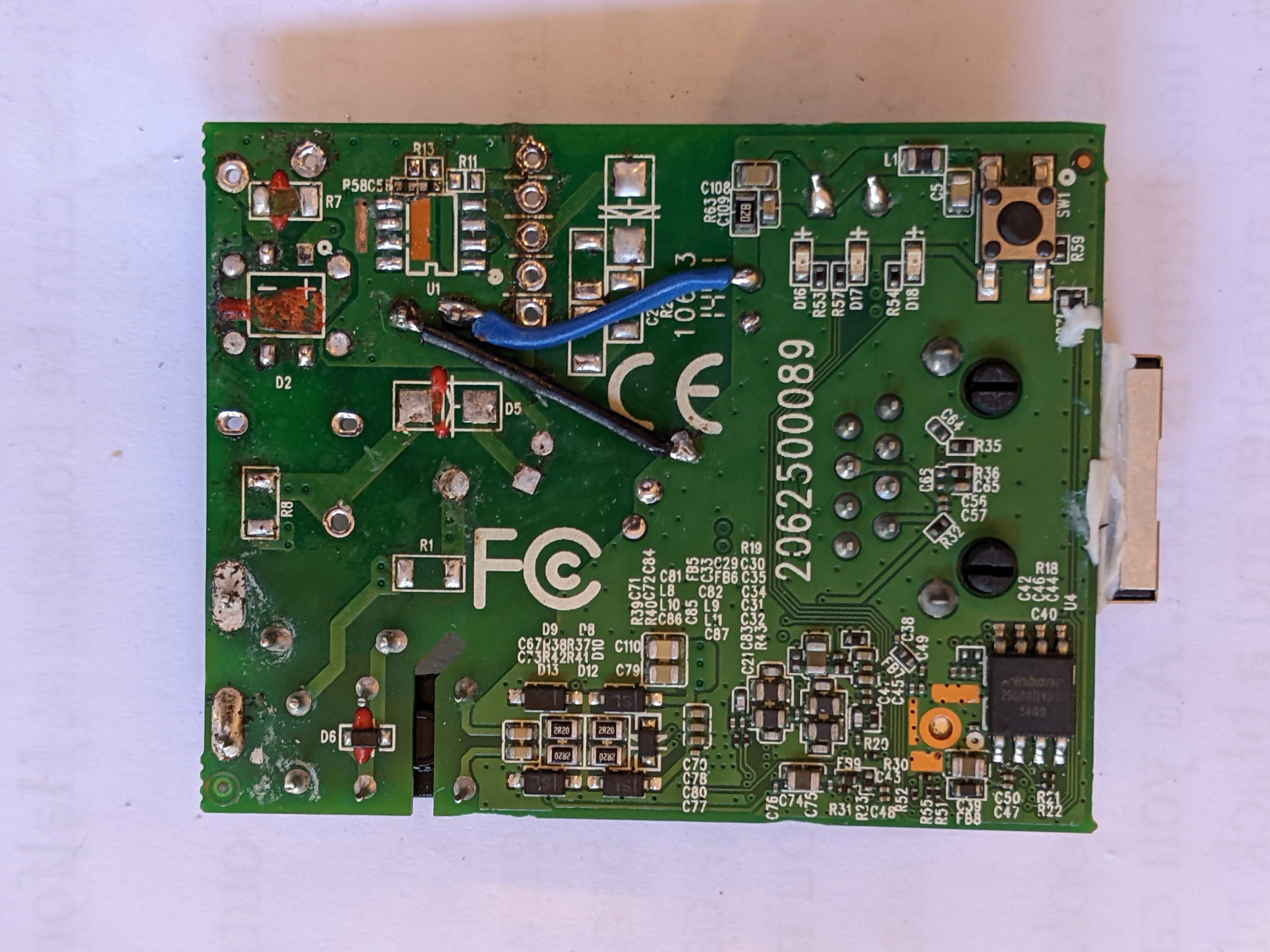

Uwe, the PLC wiring on these two pictures at https://github.com/uhi22/pyPLC/blob/master/doc/hardware.md don't seem to agree? Am I making a bad comparison?
- catphish
- Posts: 965
- Location: Dorset, UK
- Has thanked: 99 times
- Been thanked: 195 times
Sorry, my fault for not being clear enough. See rear of board! Those 2 points on the board where I connect +12V are NOT actually the supply rails, I just use them as a convenient place to add pins to connect things.asavage wrote: ↑Sun Apr 02, 2023 12:31 am Found my solder sucker, in the wrong bin as usual.
I believe with the board you and I have, the protective components for the mains voltage are are still in place. Therefore you should be able to connect "L" to CP, and "N" to PE without the need to add any additional components in between. The big yellow box should be the necessary 1uF capacitor. In any case, the exact location of the capacitor and resistor shouldn't matter, as long as they're both in series somewhere between CP, PE, and the PLC.asavage wrote: ↑Sun Apr 02, 2023 12:47 am uhi22, the PLC wiring on these two pictures at https://github.com/uhi22/pyPLC/blob/master/doc/hardware.md don't seem to agree? Am I making a bad comparison?

You are right, the pictures show different orders of the transformer, the R and the C. The important point is, that these three components are in series between the CP and the PE. The order does not matter, also the polarity does not matter. And the precise values also not, I guess everything between 33 ohms and 220 ohm should work, and also 0.5nF, 1nF and 2.2nF. Higher capacitor values could slow the edges of the 1kHz PWM, so this should be avoided.asavage wrote: ↑Sun Apr 02, 2023 12:47 am uhi22, the PLC wiring on these two pictures at https://github.com/uhi22/pyPLC/blob/master/doc/hardware.md don't seem to agree? Am I making a bad comparison?

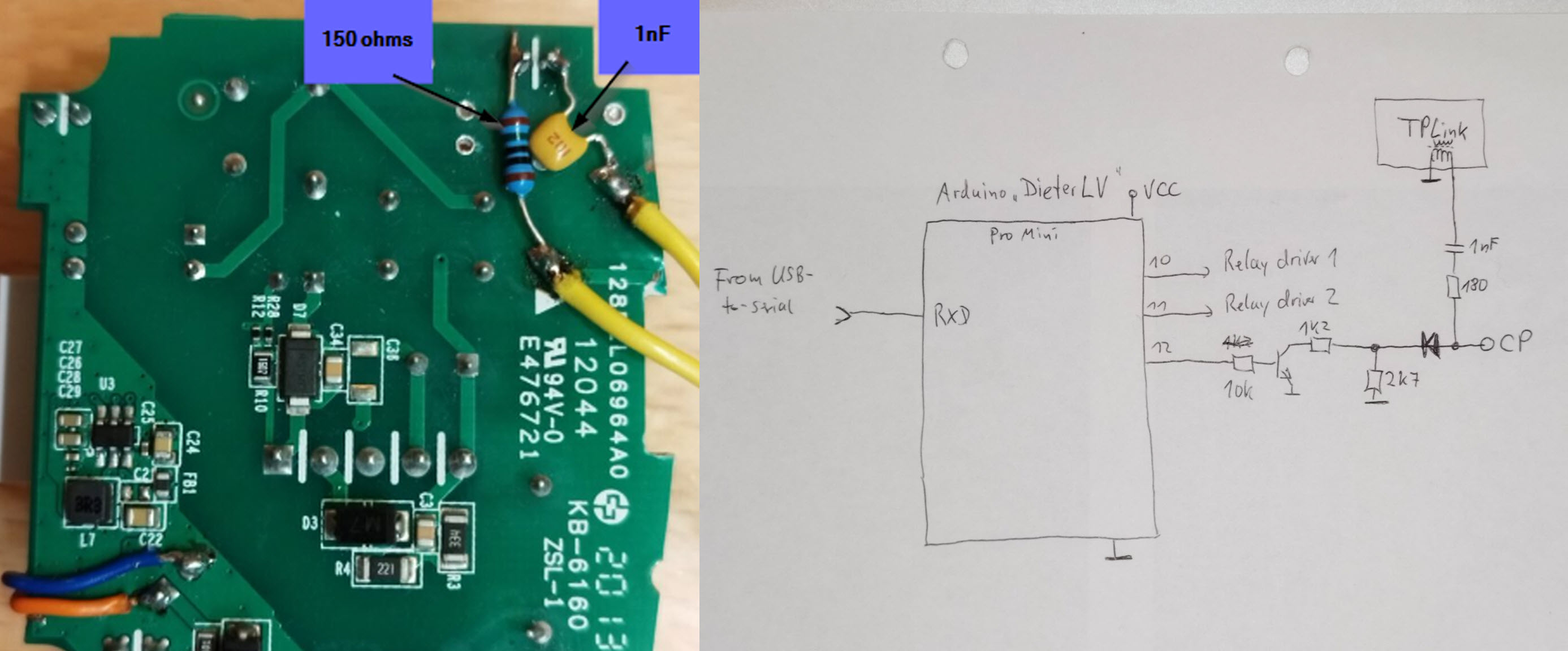

Ah, well, that's a help. I've added those jumpers, and I've now got some LEDs on, much thanks.
[Hah! you posted info on all the below just seconds before I posted, so below is all out-of-date now. Timing is all-imporant
Also, 150 ohm note on wiring, vs 180 ohm on schematic?
Hmmm, the schem. has them in series on one leg of the PLC to the CP and I couldn't reconcile that with the shown wiring (yellow leads). The other PLC leg is to GND . . . Oh, I'd forgotten that PE = GND, duh. I've been thinking of PE as an undefined symbol; it helps to more fully flesh out some of this mentally. I'm a bit slow.

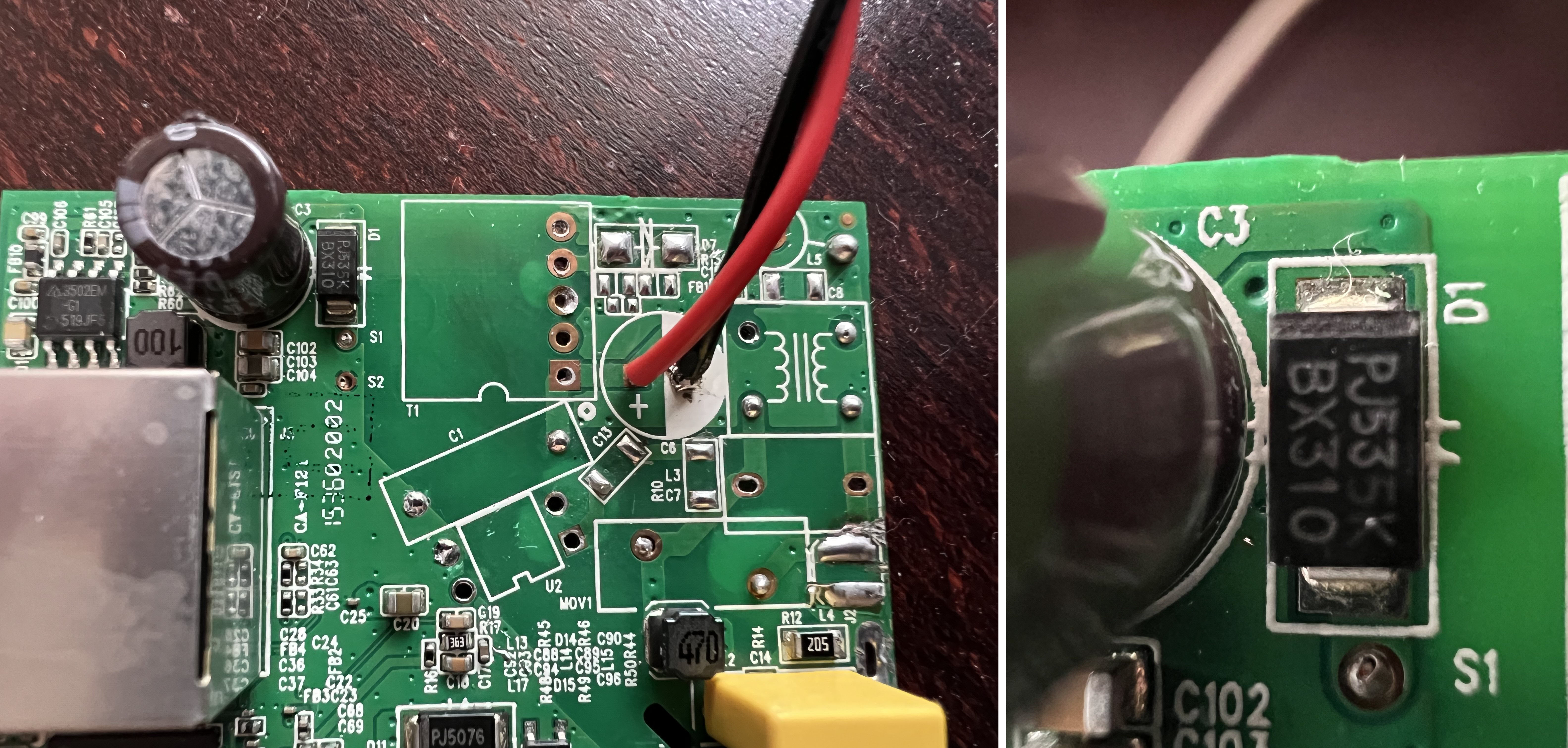

Regarding the supply, a good orientation gives the big electrolyte capacitor 470µF/16V. That's the point to connect the power (12V or 5V or something in between).
- asavage
- Posts: 379
- Has thanked: 366 times
- Been thanked: 119 times
I can see why Charlie selected the location he did, as it is handy for header pins. And, I think his choice also retains D1 (BX310) as reverse polarity protection. On reflection, S1 (+) and S2 (-) are where I should have placed my leads. Those vias are too small for header pins, but would work for surface leads.
That's where the original output from the PS connected, I think.
- uhi22
- Posts: 1143
- Has thanked: 231 times
- Been thanked: 638 times
Indeed, the points S1 and S2 are the secondary coil of the original power transformer, and the D1 was the rectifying diode. Using this as reverse-polarity protection makes perfect sense, if we have 12V supply. My modifications rely on 5V supply from USB power bank, that's why I skip the diode, to avoid additional voltage drop.

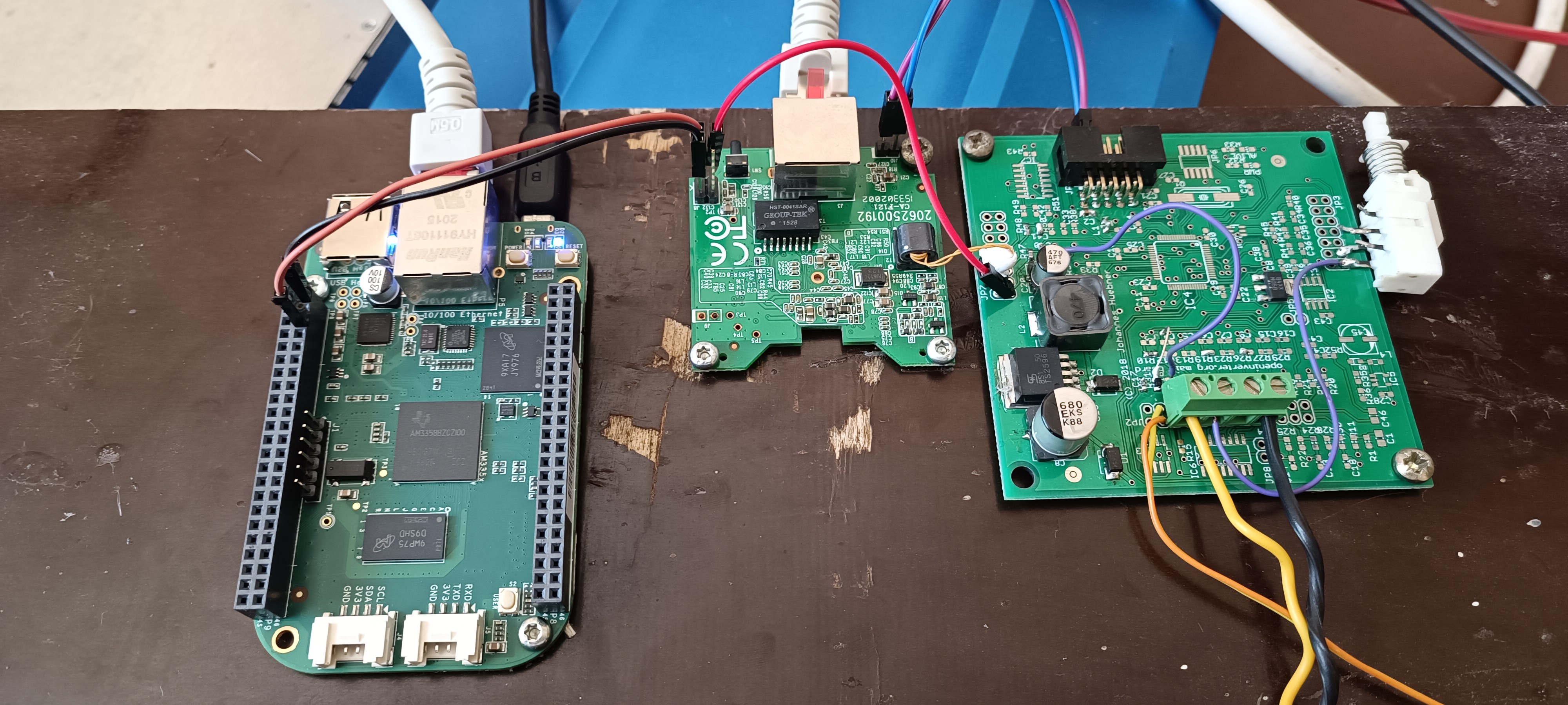

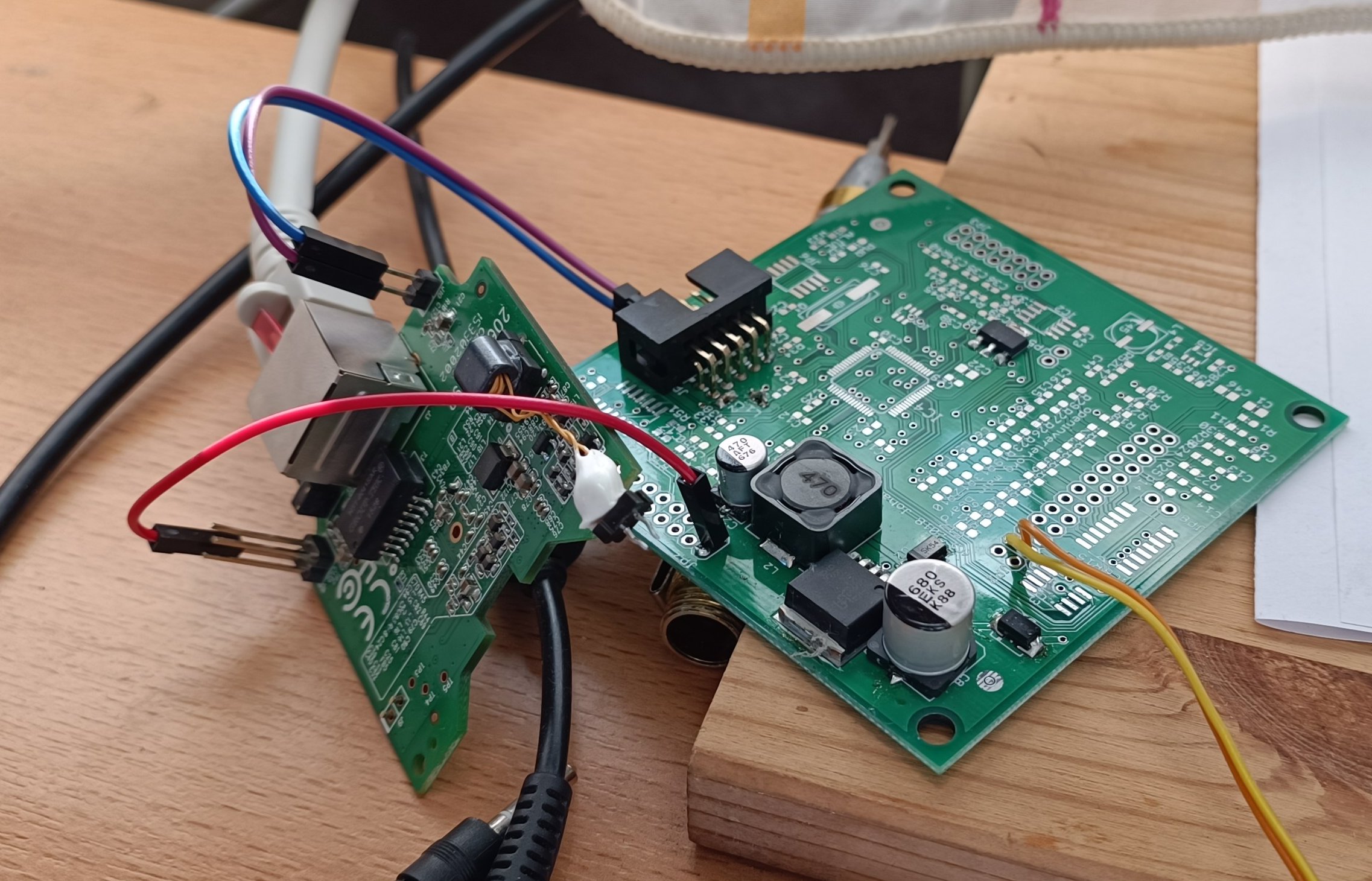

Alrighty, hardware is now set up. I'm using part of an OI board to generate 5V and 3V3 and also got the elcap on there. On the other end I'd plug into the cigarette lighter. Probably I could just use 12V straight but thought it was safer to have the regulator.
Now you mention open-plc-utils . Is there anything I need to do to enable SLAC or something?

Did follow uhis instructions and they worked flawlessly.
So now I can just drive up to an EVSE with some crocodile clips, connect the PLC transformer to CP and PE via 1nF/150R, run uhis script and start communicating. Oh and do the CP resistor thingy. If I'm so inclined I could take a kettle with me and boil some water. Right?

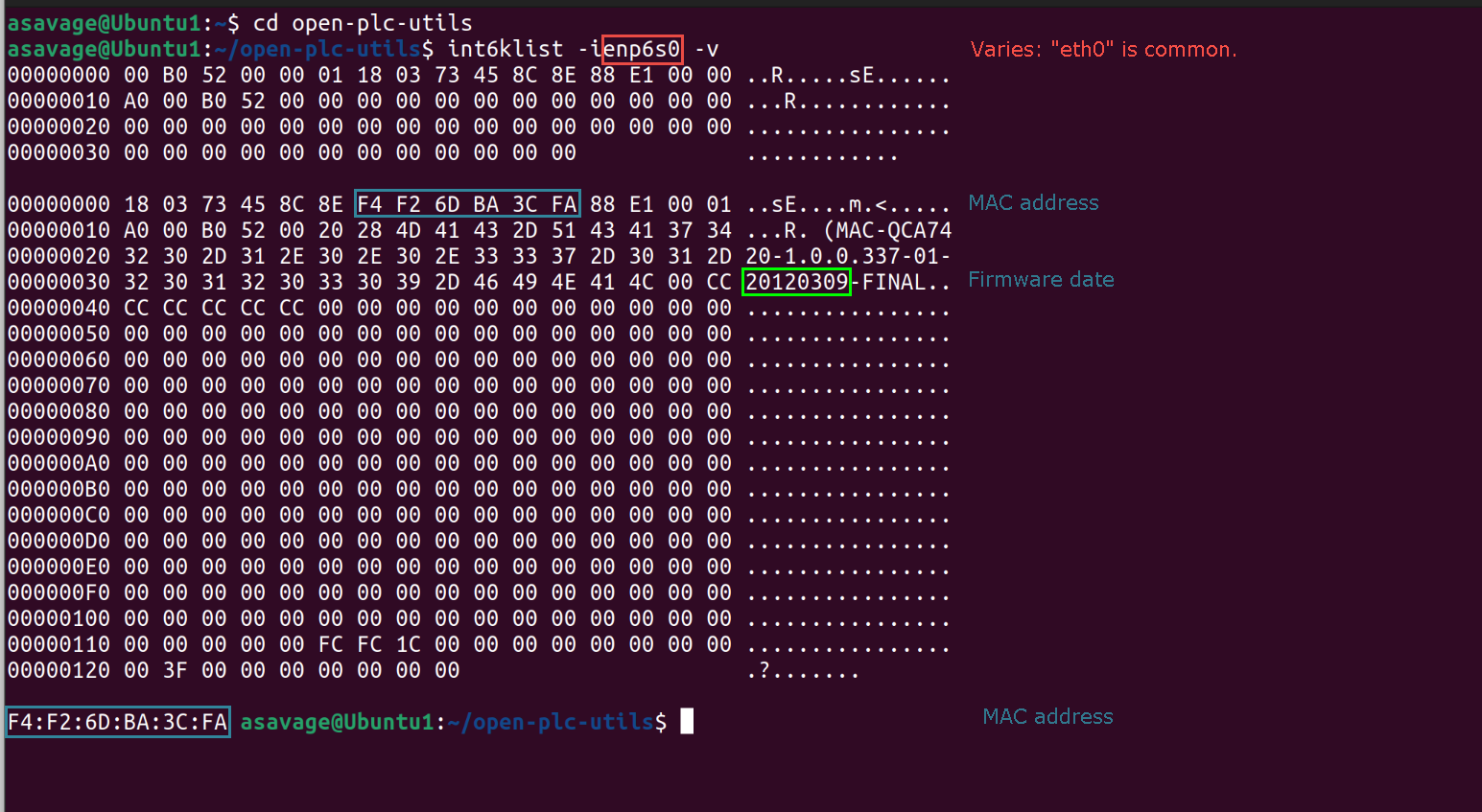

Take a copy of your unit's Parameter Information Block (PIB)
From the open-plc-utils folder . . .
asavage@Ubuntu1:~$ int6klist -ieth0 -v
Note: I don't have "eth0", I have "enp6s0", so be aware that your ethernet interface name may vary. If, when you run the above line, your output is something like: try to find your active ethernet interface name, and use it instead of "eth0". It will almost certainly begin with 'e'. If you have multiple interfaces whose name begins with 'e', you'll have to try them sequentially to figure out which one your TL-PA4010 is connected to. Here's the output on my system:
The output of int6klist should be similar to this:
. . . and the MAC address is listed in two places.
Alternatively, use:
asavage@Ubuntu1:~$ plcstat -t -i eth0
Output for my unit:
Copy the the MAC address (including the ':' separators), and use this command read the configuration (the PIB) from the PLC adapter and write it to a .pib file:
asavage@Ubuntu1:~$ plctool -ieth0 -p original.pib F4:F2:6D:BA:3C:FA // Change the blue text to your adapter's MAC address.
You can name this PIB file anything you like, and if you'll be working with multiple units, possibly from multiple markets (UK, EU, US, etc.) you may want to be more creative with the filename, to keep them discrete.

enp6s0 F4:F2:6D:BA:3C:FA Resetting ...asavage@Ubuntu1:~$ plcstat -t -i eth0
P/L NET TEI ------ MAC ------ ------ BDA ------ TX RX CHIPSET FIRMWARE
LOC CCO 001 F4:F2:6D:BA:3C:FA 18:03:73:45:8C:8E n/a n/a QCA7420 MAC-QCA7420-1.3.0.2134-00-20151212-CSI have been unable to locate catphish's QCA7420-MAC-QCA7420-1.5.0.26-02-20200114-CS as a package (ie NVM + PIB files), but the NVM alone can be found at https://mega.nz/file/ocNDhYzK#xuSQXd-b6CzzfpSXaK7r5BV4i3pXmnstYMjZX5WEWHc and he also uploaded it to OI earlier in this thread: https://openinverter.org/forum/download/file.php?id=19195. AFAICT, having a replacement PIB is not strictly necessary, as long as you have saved a copy of your unit's, or can locate a compatible one, and then only in the event of something screwing up. If you update the firmware, you'll want to pull another PIB from your unit to use anyway (read on).
asavage@Ubuntu1:~$ plctool -i eth0 -P QCA7420-WallAdapter-HomePlugAV_CE-ClassB_us_401030.pib -N FW-QCA7420-1.5.0.0026-02-CS-20200114.nvm -R F4:F2:6D:BA:3C:FA // Change the blue text to your adapter's MAC address.
LOC CCO 001 F4:F2:6D:BA:3C:FA 18:03:73:45:8C:8E n/a n/a QCA7420 MAC-QCA7420-1.5.0.26-02-20200114-CS
Modifying the PIB to enable EVCC use
I renamed "original.pib", which was in the unit with 2012 firmware, to something else. Then I took another copy of the PIB from the unit with 2020 firmware: it's different. Rather than modifying the early PIB, I used the later one. Use the same step as earlier:
asavage@Ubuntu1:~$ plctool -ieth0 -p 20200114_original.pib F4:F2:6D:BA:3C:FA // Change the blue text to your adapter's MAC address.
Use the setpib tool to modify this PIB for EVCC use:
asavage@Ubuntu1:~$ setpib 20200114_pev.pib 74 hfid "PEV"
asavage@Ubuntu1:~$ setpib 20200114_pev.pib F4 byte 1
asavage@Ubuntu1:~$ setpib 20200114_pev.pib 1653 byte 1
asavage@Ubuntu1:~$ setpib 20200114_pev.pib 1C98 long 10240 long 102400
Write the configuration file to the PLC adaptor:
asavage@Ubuntu1:~$ plctool -ieth0 -P TL-PA4010_20200114_pev.pib F4:F2:6D:BA:3C:FA // Change the blue text to your adapter's MAC address.
This takes about one second to accomplish, mostly the reset.
enp6s0 F4:F2:6D:BA:3C:FA Start Module Write Session
eth0 F4:F2:6D:BA:3C:FA Flash TL-PA4010_20200114_pev.pib
enp6s0 F4:F2:6D:BA:3C:FA Close Session
enp6s0 F4:F2:6D:BA:3C:FA Reset Device
enp6s0 F4:F2:6D:BA:3C:FA Resetting ...- asavage

Perhaps the order of your steps isn't optimum. This did not work for me with unmodified PIB. With the 2020 firmware:
asavage@Ubuntu1:~$ plctool -aI -ienp6s0
enp6s0 00:B0:52:00:00:01 Fetch Device Attributes
plctool: Identity2: Read timeout or network errorAfter modifying the PIB for pev, that command yielded similar results to yours.
I wasn't able to find a matching PIB for this firmware, and reading the 3-page thread over at TP-Link, others didn't either.
Because I updated the firmware, then pulled the PIB to modify, I didn't need to set the MAC; it was the same.
If I had had a "fresh" PIB with the 2020 firmware, I'm sure this would be necessary.

To stay on topic here is my test setup. It lacks the "Dieter" circuits so may have to patch the code a bit. The inverter board supplies 5V and 3.3V, has the 1nF and 180R resistor on it and also the CP circuitry. Tested with granny cable and works.
Also tried supplying the modem from Beaglebones 5V output but that is too weak and the power LED blinks. So for now I'll need to plug in to 12V. Might go out and test later today.
