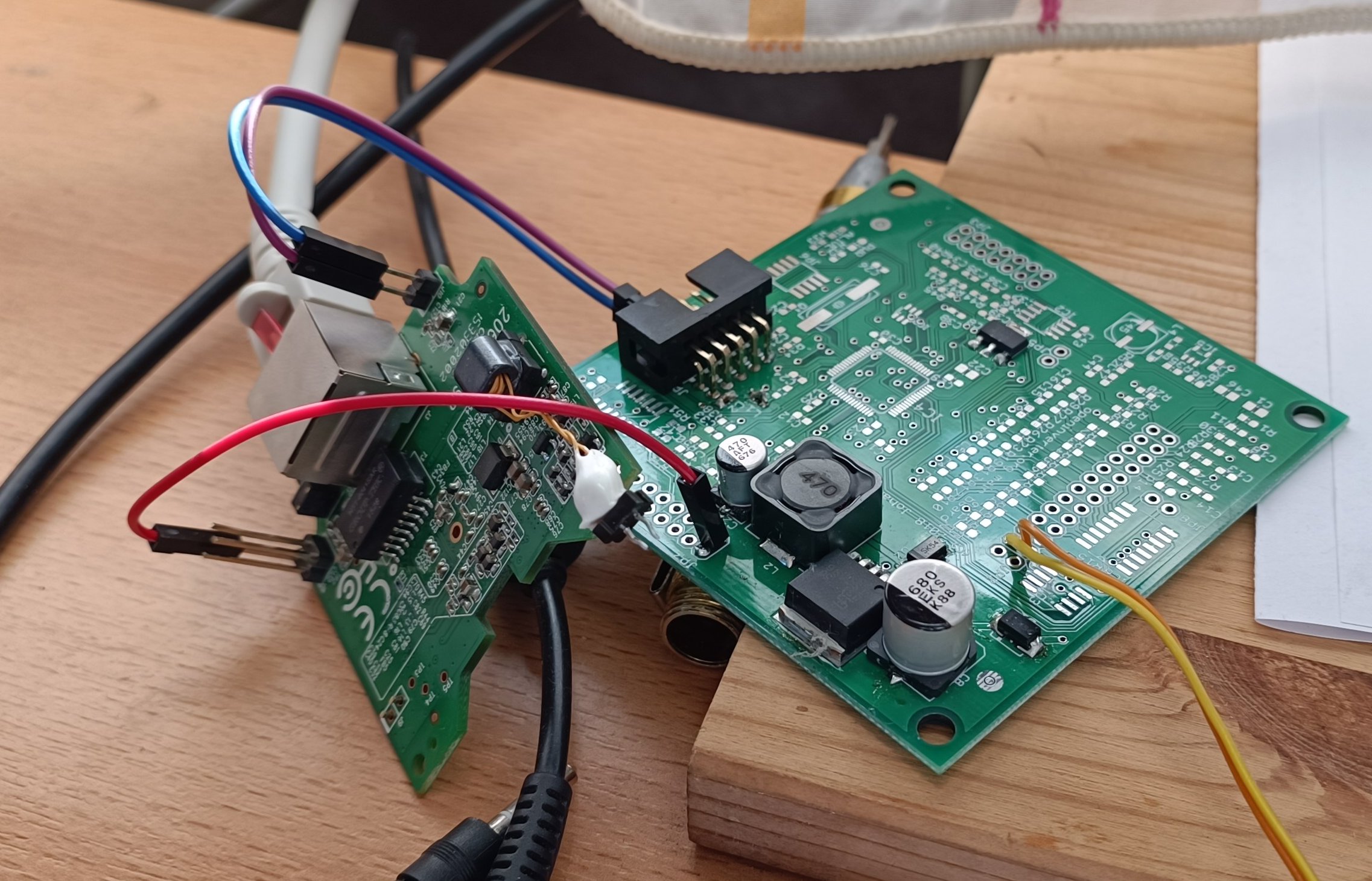

Found my solder sucker, in the wrong bin as usual.
Charlie's pic was enormously helpful, but I either bought a bum unit (foolishly, I forgot to plug it in to mains before attacking with the Dremel) or I managed to zap it, though I was being quite careful. It draws no current at all, either at 5V up to 12v, and of course none of the three LEDs light, button is non-op.
Off to buy another . . .
Charlie's on the left, mine on the right.

Uwe, the PLC wiring on these two pictures at https://github.com/uhi22/pyPLC/blob/master/doc/hardware.md don't seem to agree? Am I making a bad comparison?

Sorry, my fault for not being clear enough. See rear of board! Those 2 points on the board where I connect +12V are NOT actually the supply rails, I just use them as a convenient place to add pins to connect things.asavage wrote: ↑Sun Apr 02, 2023 12:31 am Found my solder sucker, in the wrong bin as usual.
I believe with the board you and I have, the protective components for the mains voltage are are still in place. Therefore you should be able to connect "L" to CP, and "N" to PE without the need to add any additional components in between. The big yellow box should be the necessary 1uF capacitor. In any case, the exact location of the capacitor and resistor shouldn't matter, as long as they're both in series somewhere between CP, PE, and the PLC.asavage wrote: ↑Sun Apr 02, 2023 12:47 am uhi22, the PLC wiring on these two pictures at https://github.com/uhi22/pyPLC/blob/master/doc/hardware.md don't seem to agree? Am I making a bad comparison?

You are right, the pictures show different orders of the transformer, the R and the C. The important point is, that these three components are in series between the CP and the PE. The order does not matter, also the polarity does not matter. And the precise values also not, I guess everything between 33 ohms and 220 ohm should work, and also 0.5nF, 1nF and 2.2nF. Higher capacitor values could slow the edges of the 1kHz PWM, so this should be avoided.asavage wrote: ↑Sun Apr 02, 2023 12:47 am uhi22, the PLC wiring on these two pictures at https://github.com/uhi22/pyPLC/blob/master/doc/hardware.md don't seem to agree? Am I making a bad comparison?

Ah, well, that's a help. I've added those jumpers, and I've now got some LEDs on, much thanks.
[Hah! you posted info on all the below just seconds before I posted, so below is all out-of-date now. Timing is all-imporant
Also, 150 ohm note on wiring, vs 180 ohm on schematic?
![Wink ;)](./images/smilies/icon_e_wink.png)
Hmmm, the schem. has them in series on one leg of the PLC to the CP and I couldn't reconcile that with the shown wiring (yellow leads). The other PLC leg is to GND . . . Oh, I'd forgotten that PE = GND, duh. I've been thinking of PE as an undefined symbol; it helps to more fully flesh out some of this mentally. I'm a bit slow.

Regarding the supply, a good orientation gives the big electrolyte capacitor 470µF/16V. That's the point to connect the power (12V or 5V or something in between).

I can see why Charlie selected the location he did, as it is handy for header pins. And, I think his choice also retains D1 (BX310) as reverse polarity protection. On reflection, S1 (+) and S2 (-) are where I should have placed my leads. Those vias are too small for header pins, but would work for surface leads.
That's where the original output from the PS connected, I think.

Indeed, the points S1 and S2 are the secondary coil of the original power transformer, and the D1 was the rectifying diode. Using this as reverse-polarity protection makes perfect sense, if we have 12V supply. My modifications rely on 5V supply from USB power bank, that's why I skip the diode, to avoid additional voltage drop.

Alrighty, hardware is now set up. I'm using part of an OI board to generate 5V and 3V3 and also got the elcap on there. On the other end I'd plug into the cigarette lighter. Probably I could just use 12V straight but thought it was safer to have the regulator.

To stay on topic here is my test setup. It lacks the "Dieter" circuits so may have to patch the code a bit. The inverter board supplies 5V and 3.3V, has the 1nF and 180R resistor on it and also the CP circuitry. Tested with granny cable and works.
Also tried supplying the modem from Beaglebones 5V output but that is too weak and the power LED blinks. So for now I'll need to plug in to 12V. Might go out and test later today.
