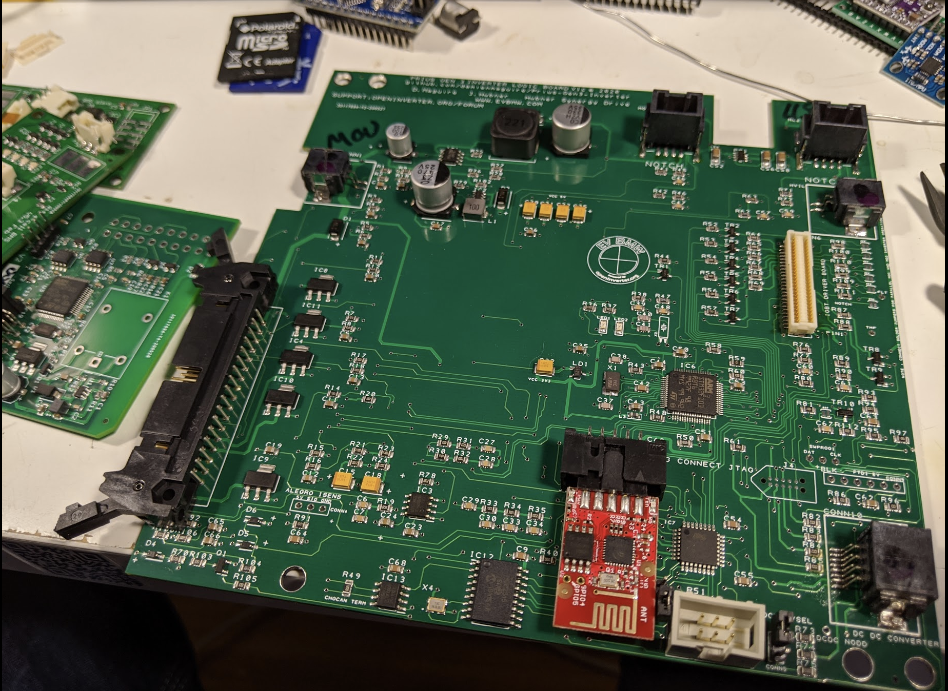

Above was assembled today with all the connectors needed salvaged from a dead OEM board. I'm getting quite good at quickly harvesting parts from dead boards with my toaster and tweezer methods. I have 4 spare sets of reclaimed connectors now if anyone on my side of the pond needs the bits and bobs to assembly their board, Send a PM. Also have all the connectors for wiring it up to your whips wire loom. Let me know if you need some stuff, I've got spares of almost all of it.

Post by bobby_come_lately »
I am in awe of your desoldering skills @Bigpie. I turn connectors to goo even with a hot air gun.

bobby_come_lately wrote: Tue Jun 16, 2020 5:55 am I am in awe of your desoldering skills @Bigpie. I turn connectors to goo even with a hot air gun.
Don't use a hot air gun.
Use a junked toaster oven. Disable the top heat element. Place an 8mm-ish thick aluminum sheet in the oven that will allow the door to close. Install one of these: `https://www.ebay.com/itm/254470543520` to control the temp. Place your salvage PCB upon the aluminum plate. Start at 200ºc, and work your way up, 5º at a time. Keep an eye watching the solder for signs that it is melting. tip: most boards use lead-free solder, it melts at around 215-220°C Use long tweezers to remove the parts that you want.
It's easy.
