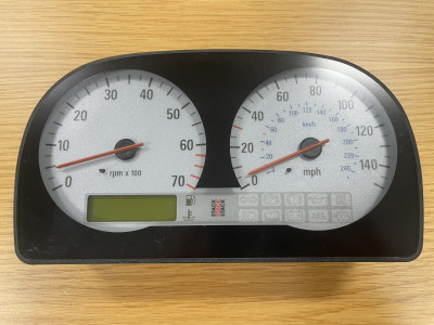

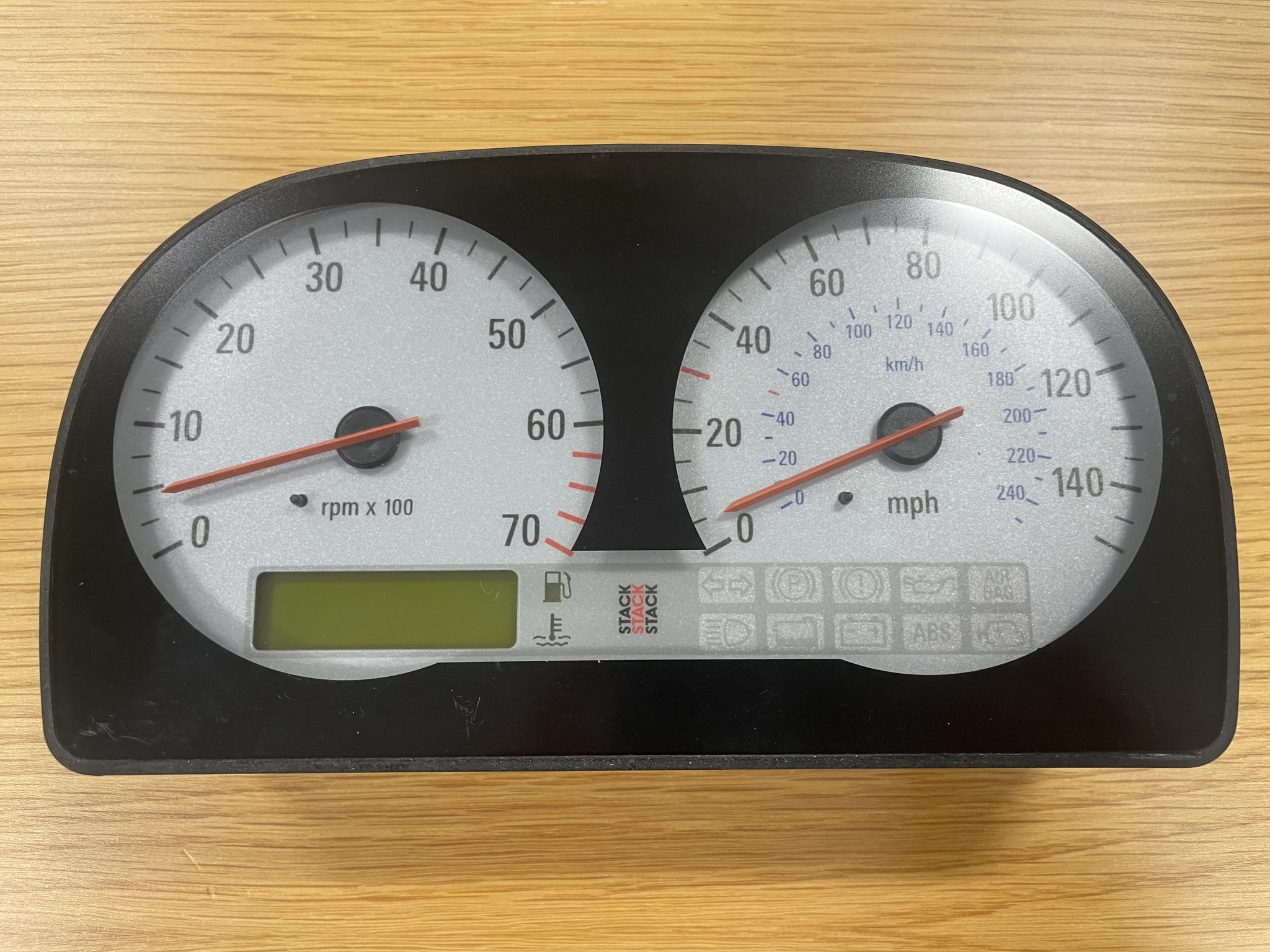

The last 3 weeks I've been rather consumed with testing improvements to the induction motor firmware and this car has been the guinea pig! With my new current control firmware, things are much smoother and more responsive, and I'm very happy with the way it drives, but no regen for now.
Last week I also bought a duplicate OEM gauge cluster:
My plan is to try to modify it to display motor current in place of RPM, and display voltages and temperatures on the LCD. I didn't want to risk breaking my existing cluster, as it currently displays MPH correctly, which is rather important :)
andybpowell
Posts: 334
Location: Southend,essex,uk
Has thanked: 219 times
Been thanked: 257 times
Re: VX220 with Tesla SDU
Post by andybpowell »
I was considering a similar thing there are some round tft displays available but limited sizes and lacking any real information I think I'll hold off for now
