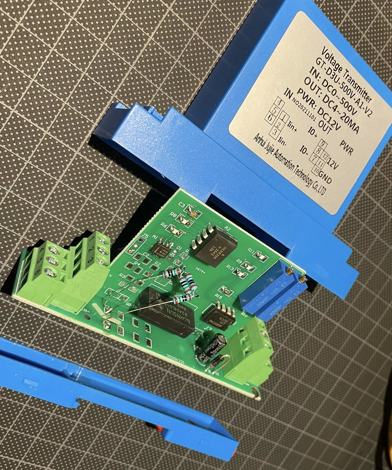

I'm not using the LIM, But I have ordered a HDH-21 to mess about with for the DC Voltage monitoring.
12v powered, 4-20mA output, 0-400V input (Likely 0-500V).
https://www.aliexpress.com/item/1005003767797166.html
I reckon that with some adjustment of the Zero / Span pots, it'll be possible to mimic what the LIM is looking for.
Seems like it's an isolated design, but I'll be cracking mine open to investigate.
Would gladly accept a IVT-S replacement! buying one new was by far the most painful cost justification of the whole build.

Post by larsrengersen »
I once ordered a similar unit. After opening it I decided to go another route and develop the Voltage Sense Board.
This is what it looked like:
Mitchy
Posts: 147
Has thanked: 7 times
Been thanked: 91 times
Post by Mitchy »
Not quite a robust design! :o
