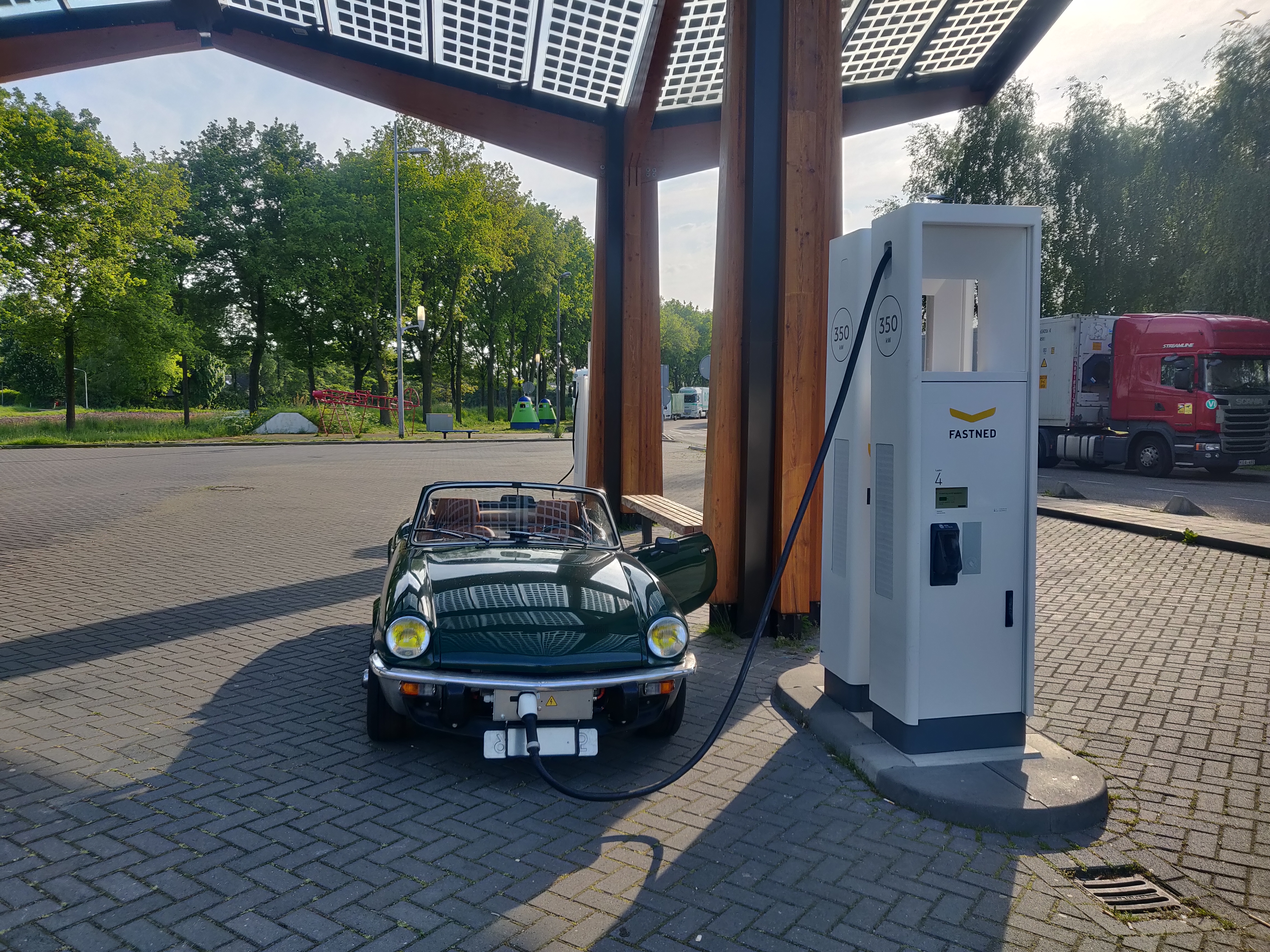

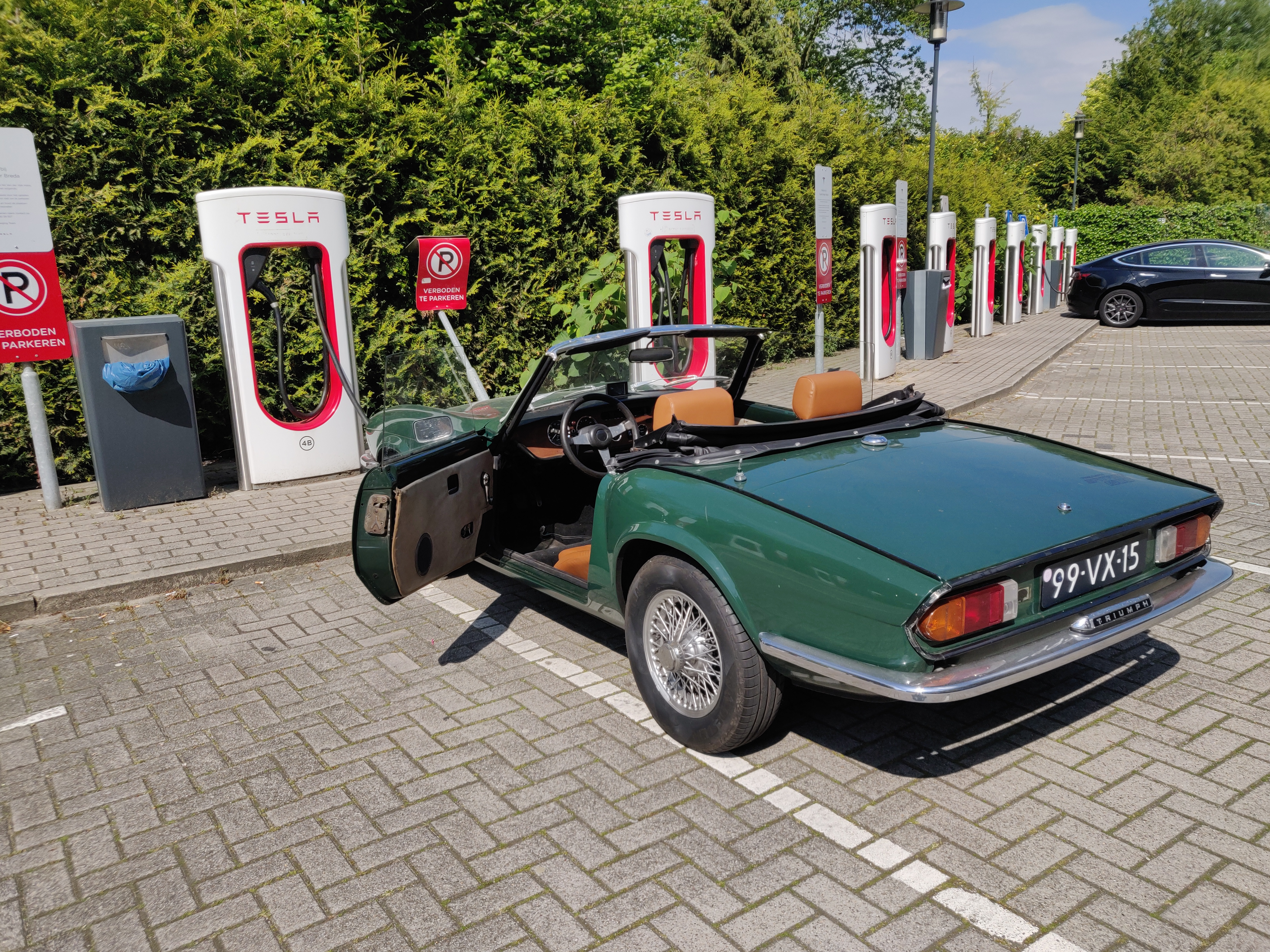

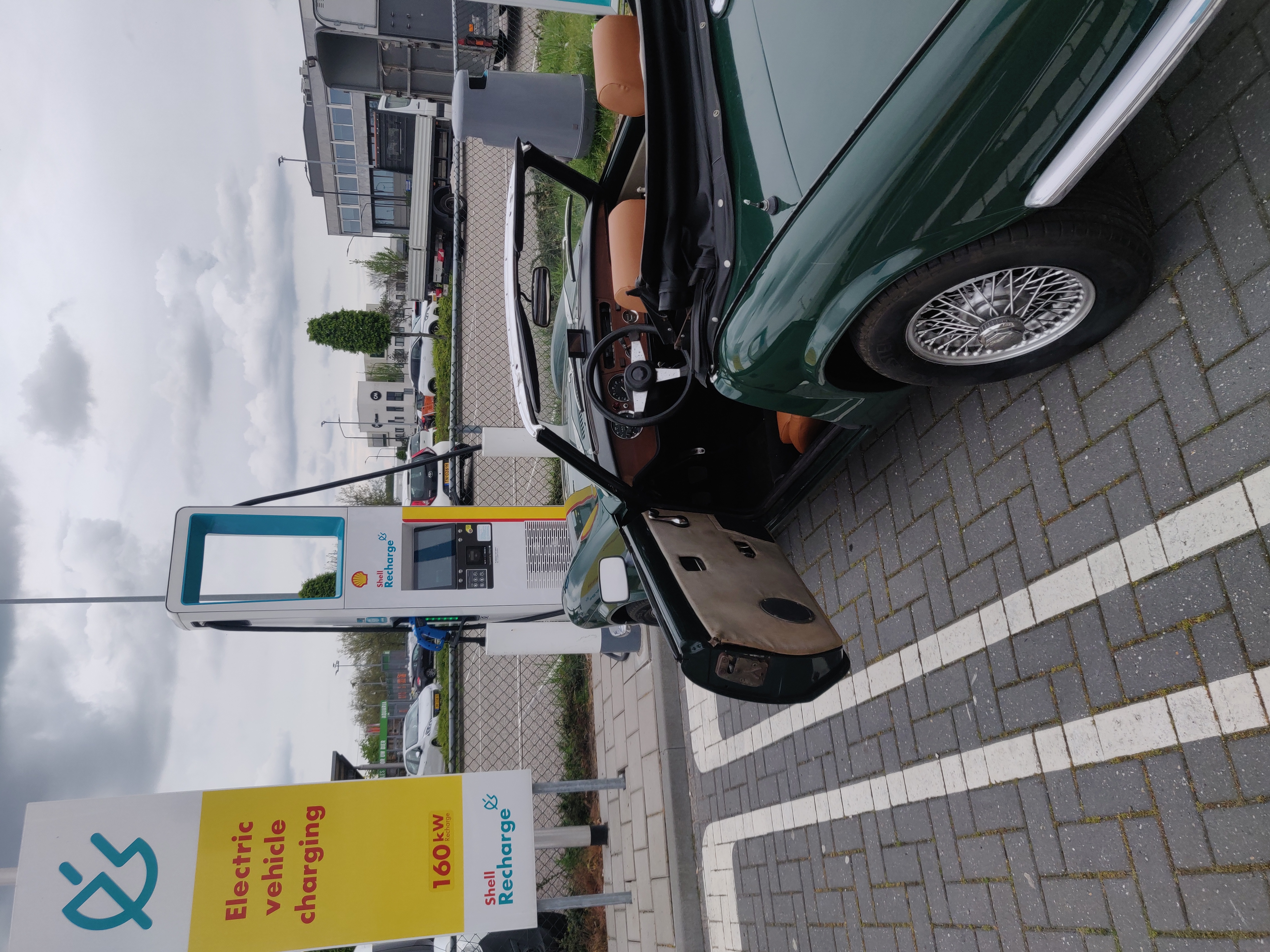

I can confirm that every CCS try until now was working perfectly, even the Tesla superchargers! And also fastnet, big one here in the Netherlands
Super happy!
Super happy!

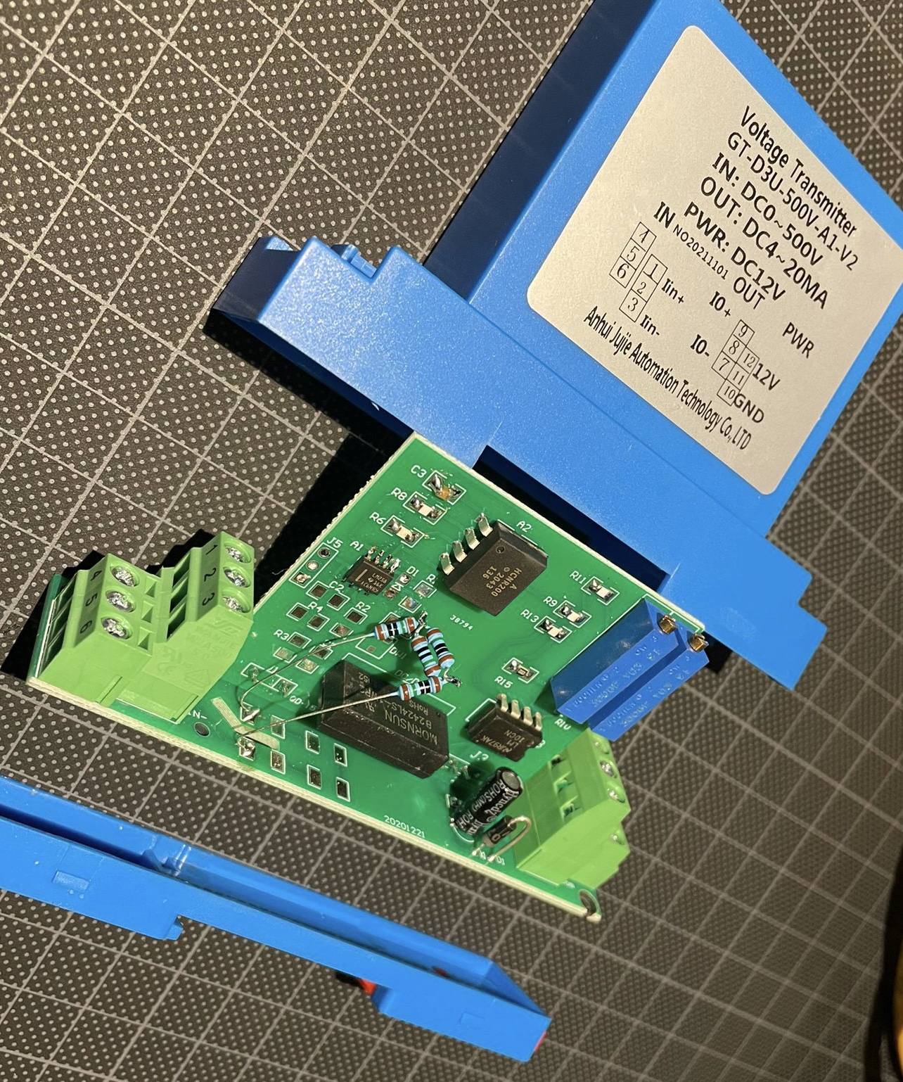

I'm not using the LIM, But I have ordered a HDH-21 to mess about with for the DC Voltage monitoring.
12v powered, 4-20mA output, 0-400V input (Likely 0-500V).
https://www.aliexpress.com/item/1005003767797166.html
I reckon that with some adjustment of the Zero / Span pots, it'll be possible to mimic what the LIM is looking for.
Seems like it's an isolated design, but I'll be cracking mine open to investigate.
Would gladly accept a IVT-S replacement! buying one new was by far the most painful cost justification of the whole build.

I once ordered a similar unit. After opening it I decided to go another route and develop the Voltage Sense Board.
This is what it looked like:
