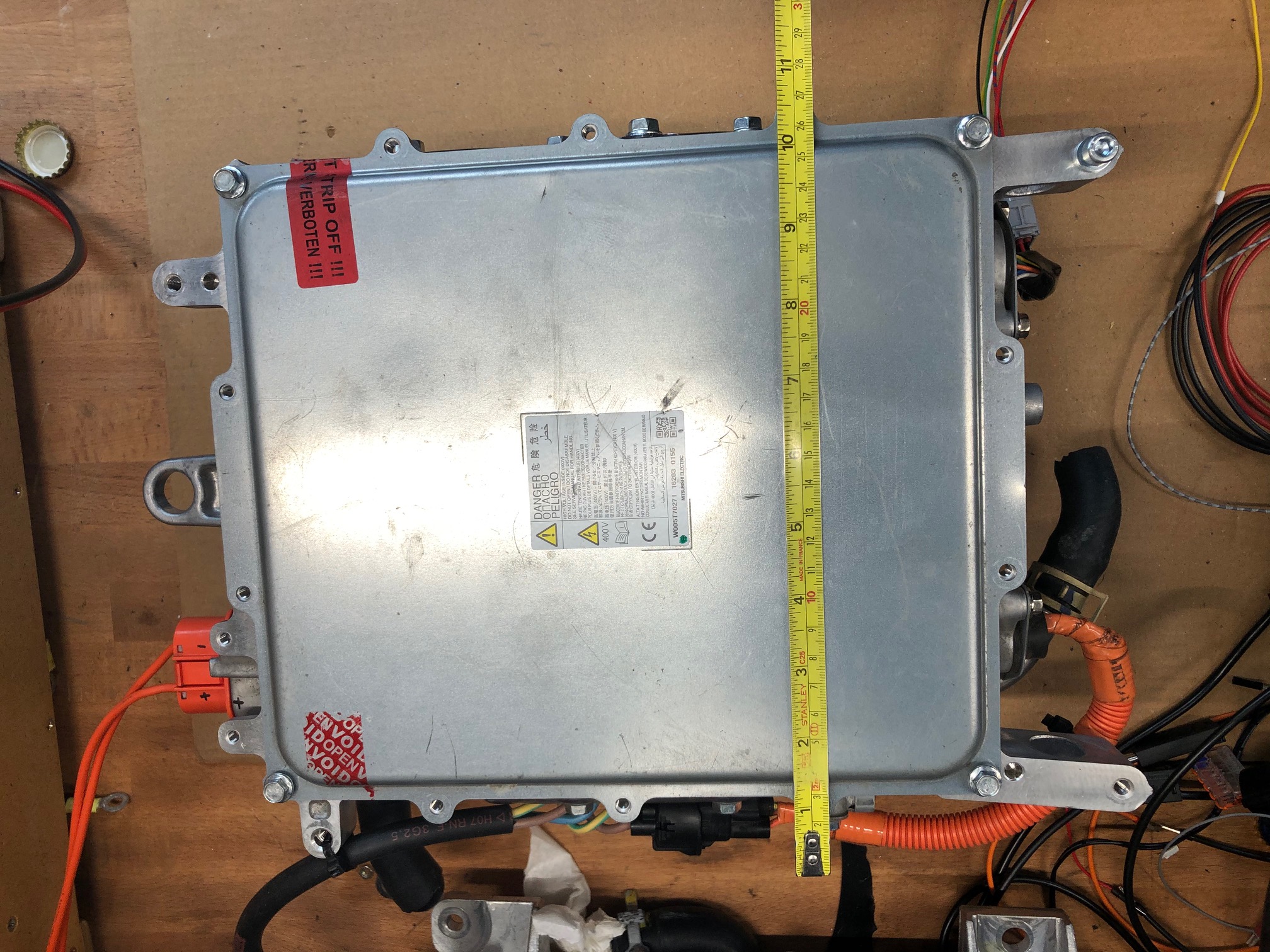

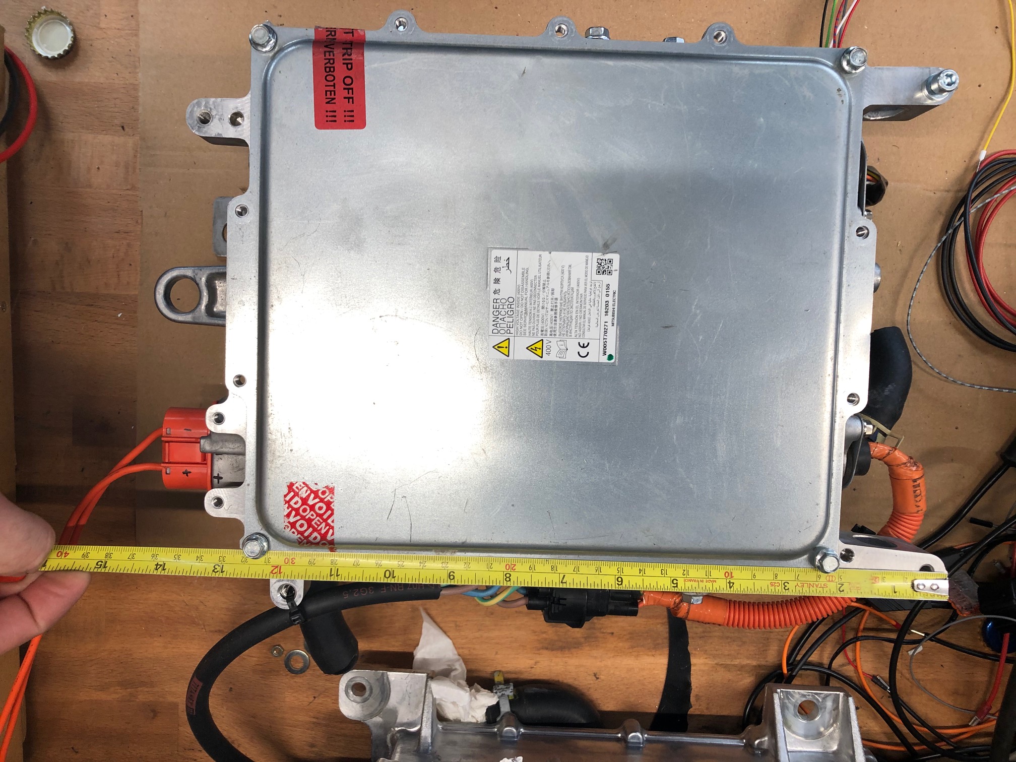

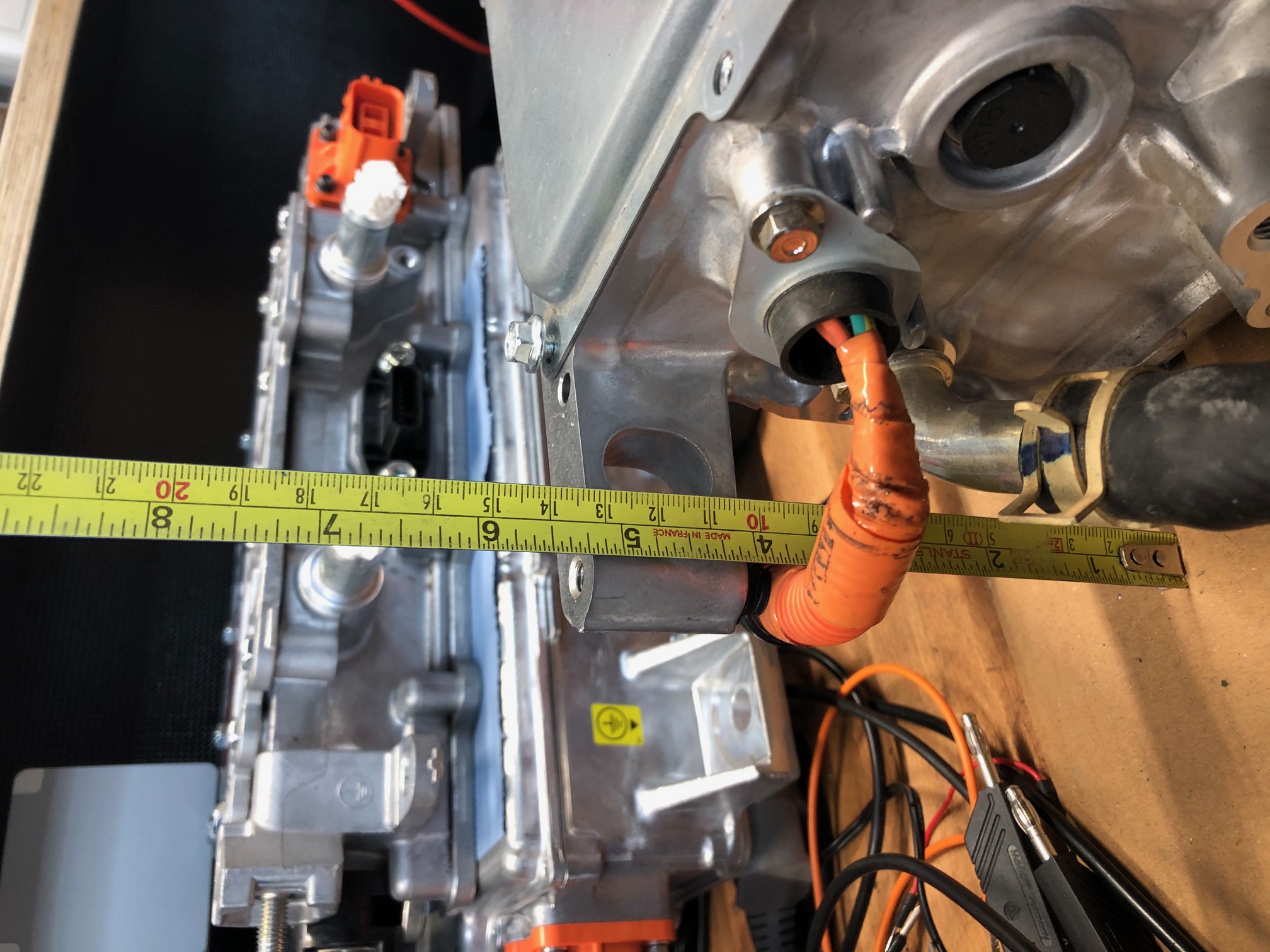

Measurement for the older unit with the connectors and coolant stumps sticking out.bobby_come_lately wrote: ↑Sun Nov 01, 2020 2:11 pm Thank you.
Would anyone be able to stick a tape measure on it? I have a space under my bonnet where it may fit bit it's going to be tight height-wise.
Length 370mm
Width 270mm
Height 150mm

Thank you.arber333 wrote: ↑Sun Nov 01, 2020 6:10 pmMeasurement for the older unit with the connectors and coolant stumps sticking out.bobby_come_lately wrote: ↑Sun Nov 01, 2020 2:11 pm Thank you.
Length 370mm
Width 270mm
Height 150mm
I've gone for one despite it not fitting. Some fettling required probably to shrink my battery box a little bit, or do a cut-out of the lid. But got one for a very good price so made sense.
