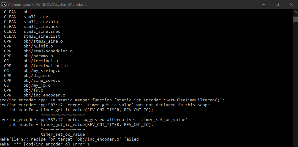

Attempted to build (under Windows) Can't seem to find timer_get_ic_value from inc_encoder.cpp (searched all files)
Used your copy of custom libopencm3 and libopeninv
EDIT: Changed line 587 ...compiled OK.

Builds fine for me (linux)
did you run:
make get-deps
I wrote a little script:
$ cat build.sh
#!/bin/bash
make get-deps
CONTROL=FOC make clean
CONTROL=FOC make

dima wrote: Mon Jan 20, 2020 10:55 pm EDIT: Changed line 587 ...compiled OK.
 int measTm = timer_get_counter(REV_CNT_TIMER);
Of course thats not the same but then this code won't be used in FOC mode most likely.

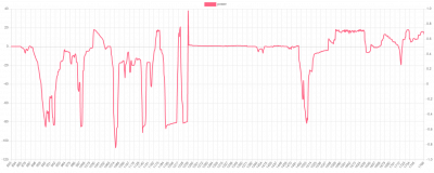

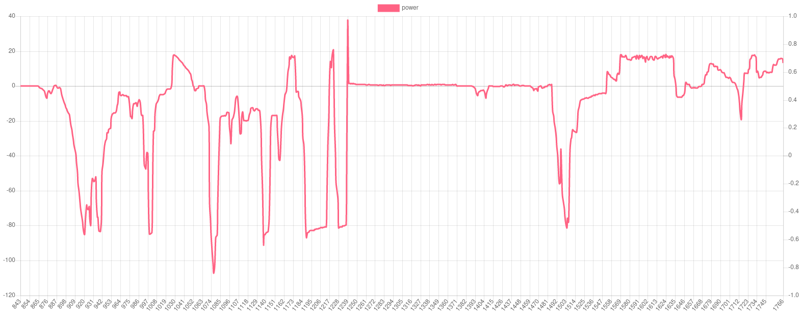

Alright everyone, this is crazy! I just drove with curki cranked up to 20000 and all the various kludges that I added in the last months disabled. Result: awesome!
No unwanted regen, smooth acceleration to 9000rpm (didn't dare spin faster with my vibrato coupler), no over current trips on wheel spin. It just drives.
All that pain because I didn't have da ballz to crank up the integral controller gain :D
Did a quick measurement and reported a power peak at 110kW, 20 kW regen. I never sniffed cocain, but I'm sure this is better 8-)
By disabled kludge I mean the frqfac parameter, the separate regen controller and the ramp between the two. All unnecessary.
Parameter attached, will release the cleaned up firmware in a minute.
