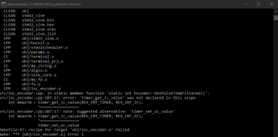

Attempted to build (under Windows) Can't seem to find timer_get_ic_value from inc_encoder.cpp (searched all files)
Used your copy of custom libopencm3 and libopeninv
EDIT: Changed line 587 ...compiled OK.
 int measTm = timer_get_counter(REV_CNT_TIMER);

Builds fine for me (linux)
did you run:
make get-deps
I wrote a little script:
$ cat build.sh
#!/bin/bash
make get-deps
CONTROL=FOC make clean
CONTROL=FOC make
Been thanked: 1918 times

dima wrote: Mon Jan 20, 2020 10:55 pm EDIT: Changed line 587 ...compiled OK.
Of course thats not the same but then this code won't be used in FOC mode most likely.
