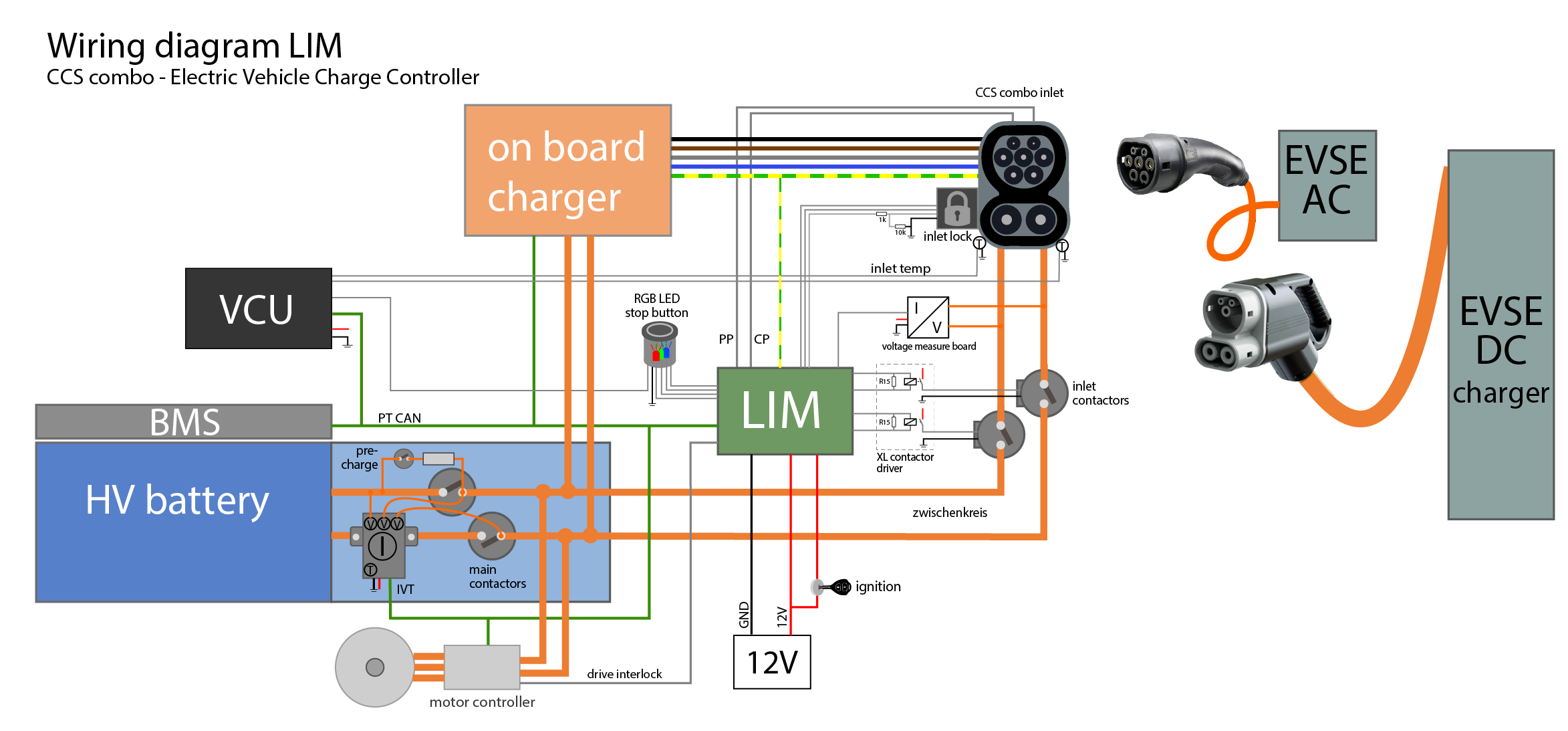

Sorry if a little off topic, but what controls the main contactors in this setup? They'd need to be closed for any of the charging and non-polarized to be able to interrupt charging, if I understand correctly.
EV_Builder
Posts: 1205
Location: The Netherlands
Has thanked: 18 times
Been thanked: 37 times
Re: BMW LIM based CCS2 Controller
Post by EV_Builder »
That depends on design but what I have seen is key switches battery positive coil.
VCU or BMS switches battery negative coil en pre-charge.
larsrengersen
Posts: 171
Has thanked: 16 times
Been thanked: 36 times
Post by larsrengersen »
In other words, in that setup 'nothing controls the main contactors'. The LIM just needs a "yes, ready to receive charge" from the car. How you get to that point is up to you and like EV_Builder says there are many possibilities.
I prefer the option where the BMS does contactor control (main+, main-, precharge and charger contactor).

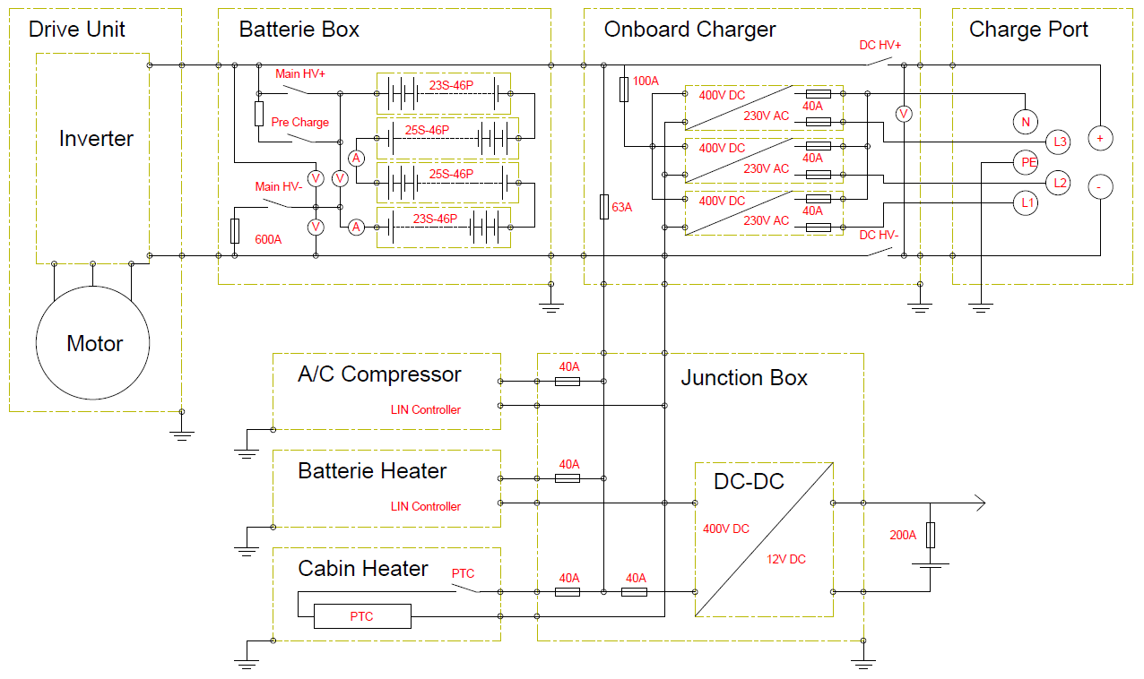

muehlpower
Posts: 807
Been thanked: 186 times
Post by muehlpower »
In my case the motor is in the back, the battery box with the main contactors in the middle, AC charger with the fast DC contactors and the voltage sensing board in the front and the charge port in the front bumper. Auxiliary units branch off from the charger. When driving or charging, all devices are live. The advantage is that the DC-DC converter, A/C, battery heater, fan and water pump work while charging. As long as no 12V goes into the battery box, no 400V comes out either. That means you can work safely on the car. I have a lockable switch for that. that makes the TÜV happy. Actually, only the motor while charging is unnecessary under Voltage and the AC charger while driving.

DkubusEV wrote: Sun Sep 18, 2022 3:58 am wouldn't it be safer to not require the "main contactors" to be energised?
I'd always ensure your BMS has the direct possibility to open the charger contactor in case of an emergency.
In my V1 high voltage design I had the following setup:
- Aux devices (DC/DC, aircon, heater) on in charge and discharge mode
- Inverter only energized in drive/discharge mode
- Charger only connected in charge mode
Now in my V2 high voltage design I do it a bit different:
- In discharge mode, aux devices on and inverter as well
- Charge mode = discharge mode + charger contactor
So now I also energize the inverter in charge mode (which is (ideally) not needed, but simplifies other things.
And in charge mode the BMS can open the charger contactor independently of whatever the DC contactors do.

larsrengersen wrote: Sun Sep 18, 2022 5:26 pm
muehlpower wrote: Sun Sep 18, 2022 2:19 pm In my case the motor is in the back, the battery box with the main contactors in the middle, AC charger with the fast DC contactors and the voltage sensing board in the front and the charge port in the front bumper. Auxiliary units branch off from the charger. When driving or charging, all devices are live. The advantage is that the DC-DC converter, A/C, battery heater, fan and water pump work while charging. As long as no 12V goes into the battery box, no 400V comes out either. That means you can work safely on the car. I have a lockable switch for that. that makes the TÜV happy. Actually, only the motor while charging is unnecessary under Voltage and the AC charger while driving.
Thanks guys, really appreciate the descriptions of how you implemented the system safety with bms control over at least one of the contactors. I'm now thinking perhaps is best to use negative pack contactor (via fuse) to the DC charge contactor (inside battery junction box) so it (pack negative) is operated by bms and then have the DC charging positive contactor on battery side of main "positive pre charge contactor" so that I get the back-up safety of a bms controlled battery contactor (at negative) and without having to pre-charge and energise the main positive contactor. Thus leaving the inverter/motor isolated. My DC/DC is built into my on board charger and if I fit air-conditioning I guess I'll need one extra small contactor just to keep all "high voltage" and the related contactors inside the battery breakout-junction box. If I'm not possibly over complicating it but I'd rather not have voltage running anywhere that's not required during either driving or charging. Sincerely appreciate your input and ideas. Thanks guys.

Can an inverter get damaged if BMS drops contactors to it? I don't quite understand how, but there was a note on that somewhere here regarding Tesla SDU.
larsrengersen
Posts: 171
alexbeatle wrote: Wed Sep 21, 2022 5:48 am Can an inverter get damaged if BMS drops contactors to it? I don't quite understand how, but there was a note on that somewhere here regarding Tesla SDU.
Depends on the inverter. But yes, this applies to Tesla SDU and LDU and maybe more.
When the motor is spinning there is energy there and without the battery connected there is nowhere to can go.
Azure DMOC645 and Leaf inverter can handle this.
But this is a reason for my V2 design. VCU controls main + and main - and ensures drivetrain is disabled before opening contactors.

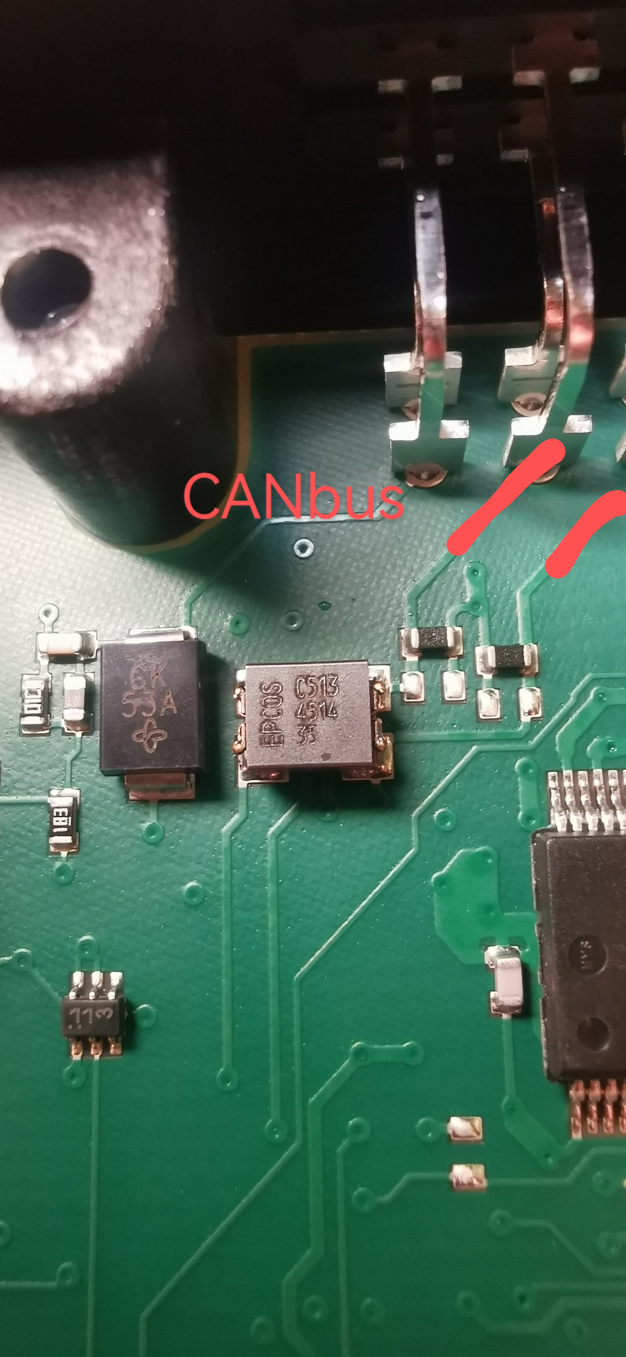

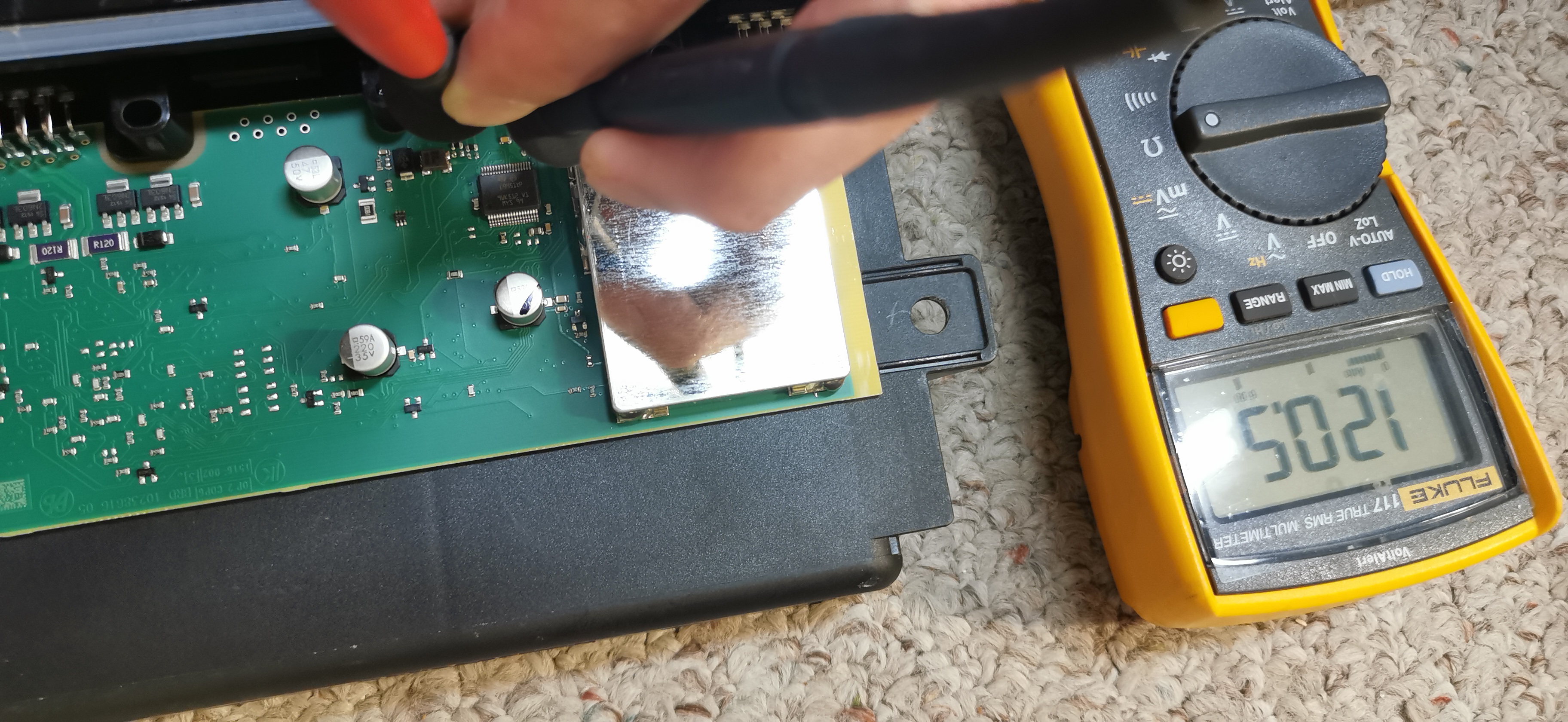

Must the LIM module be at the end of the CANbus and no workaround?
Reads 120Ohm between the CAN-H and CAN-L.
Posts: 2962
Has thanked: 328 times
Been thanked: 847 times
alexbeatle wrote: Fri Feb 23, 2024 1:48 am Must the LIM module be at the end of the CANbus and no workaround?
You answered your own question there. 120 ohm terminations are the ends of the bus.

I don't have a LIM anymore, but . . . is it possible to disable the LIM's termination? Desolder a resistor on the PCB?
Al Savage
2014 RAV4 EV
NissanDiesel
alexbeatle
Posts: 292
Has thanked: 82 times
Been thanked: 35 times
Post by alexbeatle »

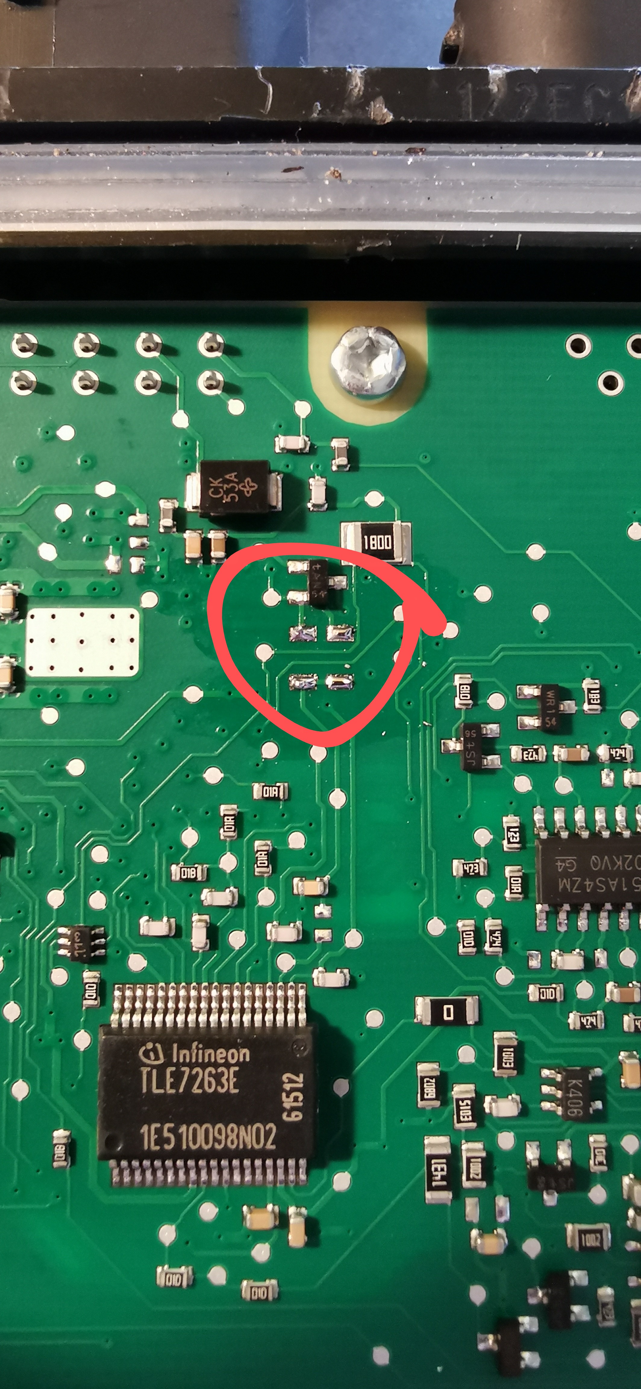

Cannot seem to locate the termination resistor. Right on the inputs it has the filter circuit (zeners and chokes), then then traces disappear into another layer.
royhen99
Posts: 265
Location: N. Wiltshire. UK
Has thanked: 22 times
Been thanked: 134 times
Post by royhen99 »

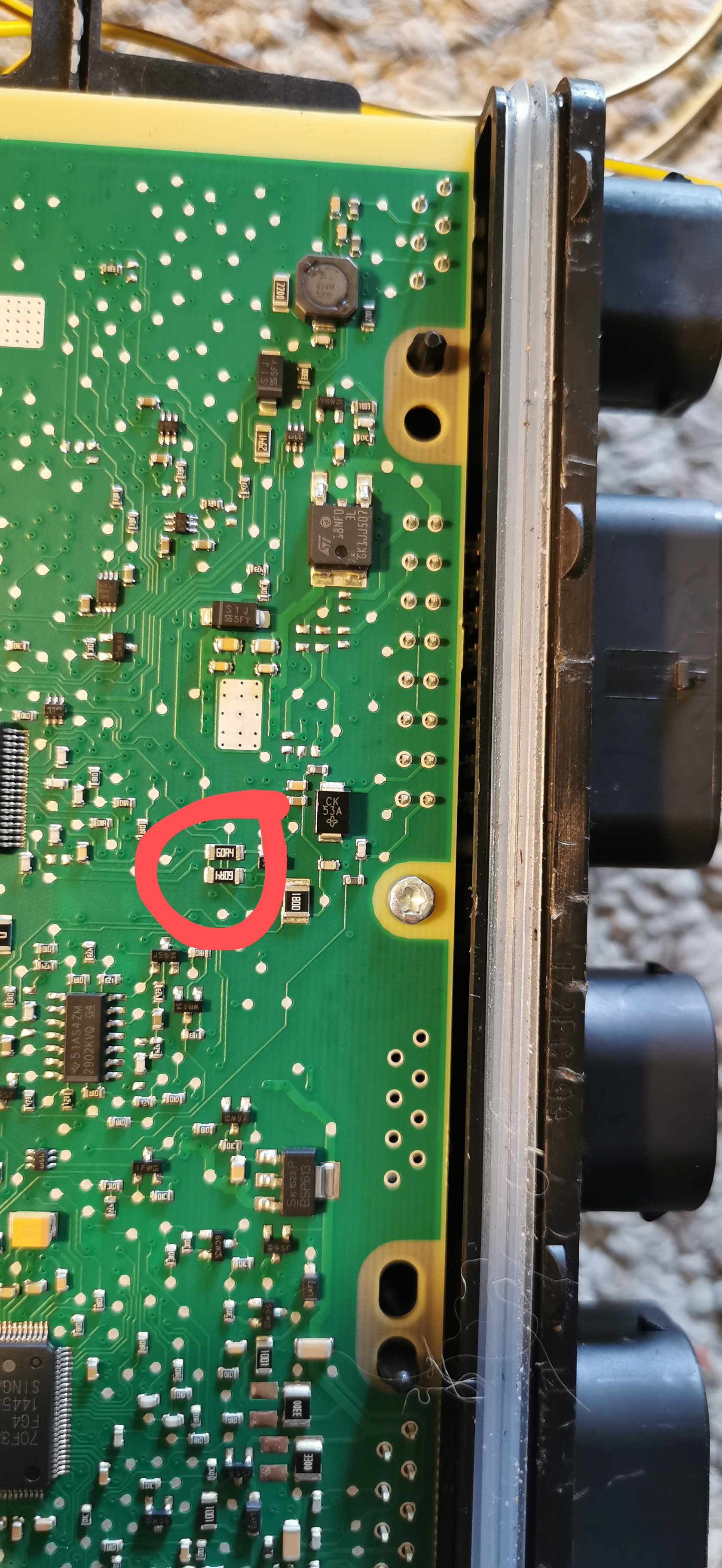

From photos here viewtopic.php?p=19851#p19851 the termination is two 60R4 resistors on the reverse of the board.
alexbeatle
Posts: 292

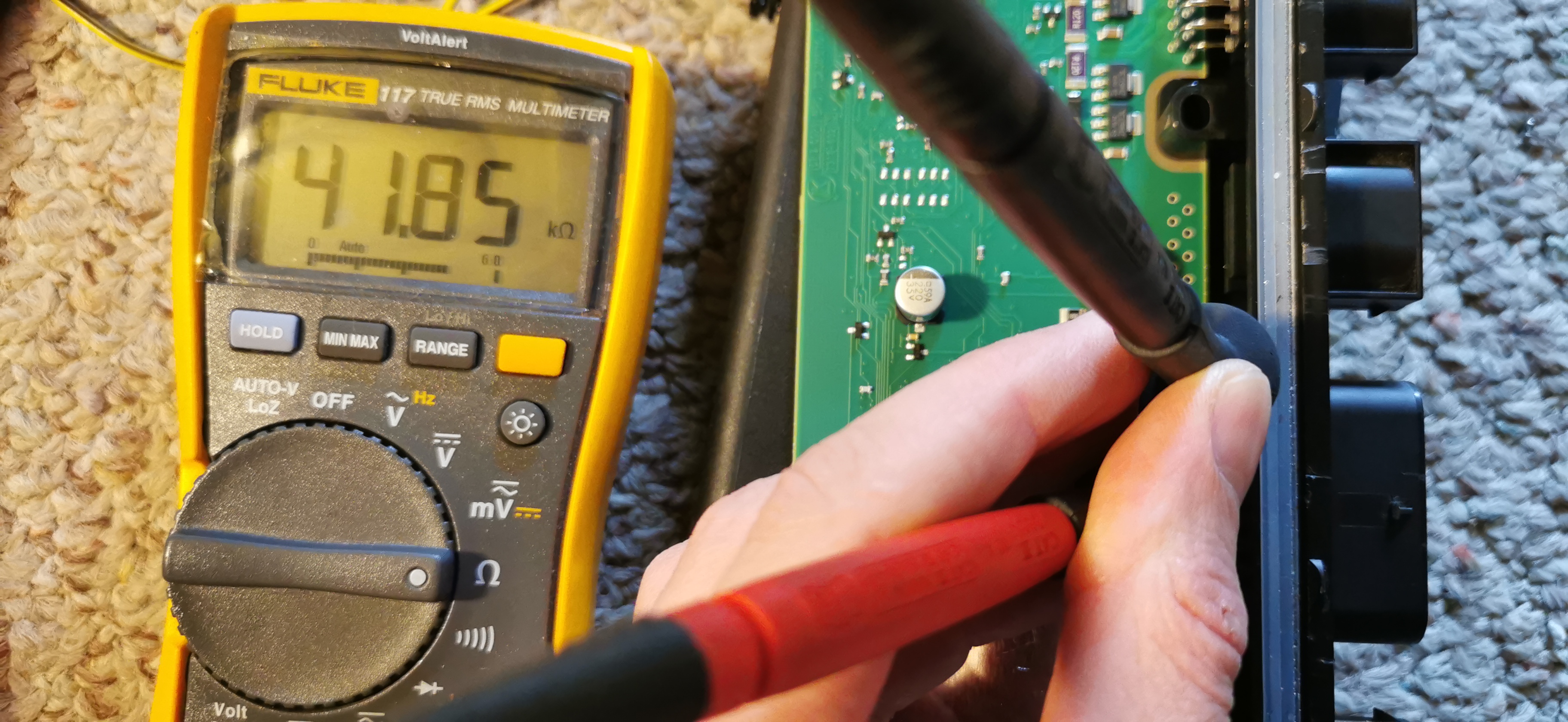

Cool. Looks like removing these two 60ohm resistors joined in series removed the CANbus termination, so the LIM can be put anywhere on the bus.
Thanks.
Edit.

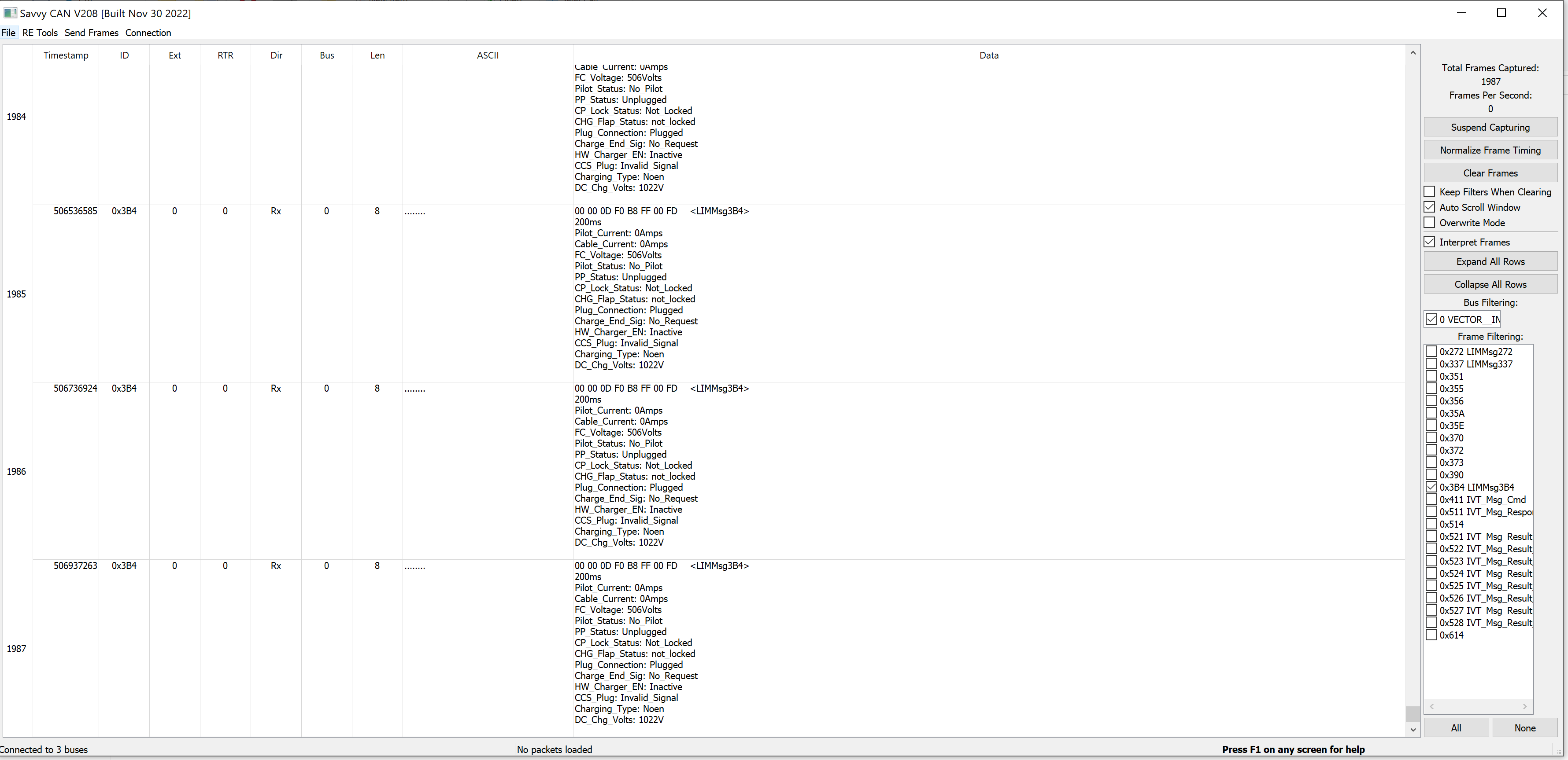

Now that my CANbus is wired and I'm coding my VCU, just wanted to circle back and show that LIM CANbus is alive and talking, so nothing got damaged from removing the components.
