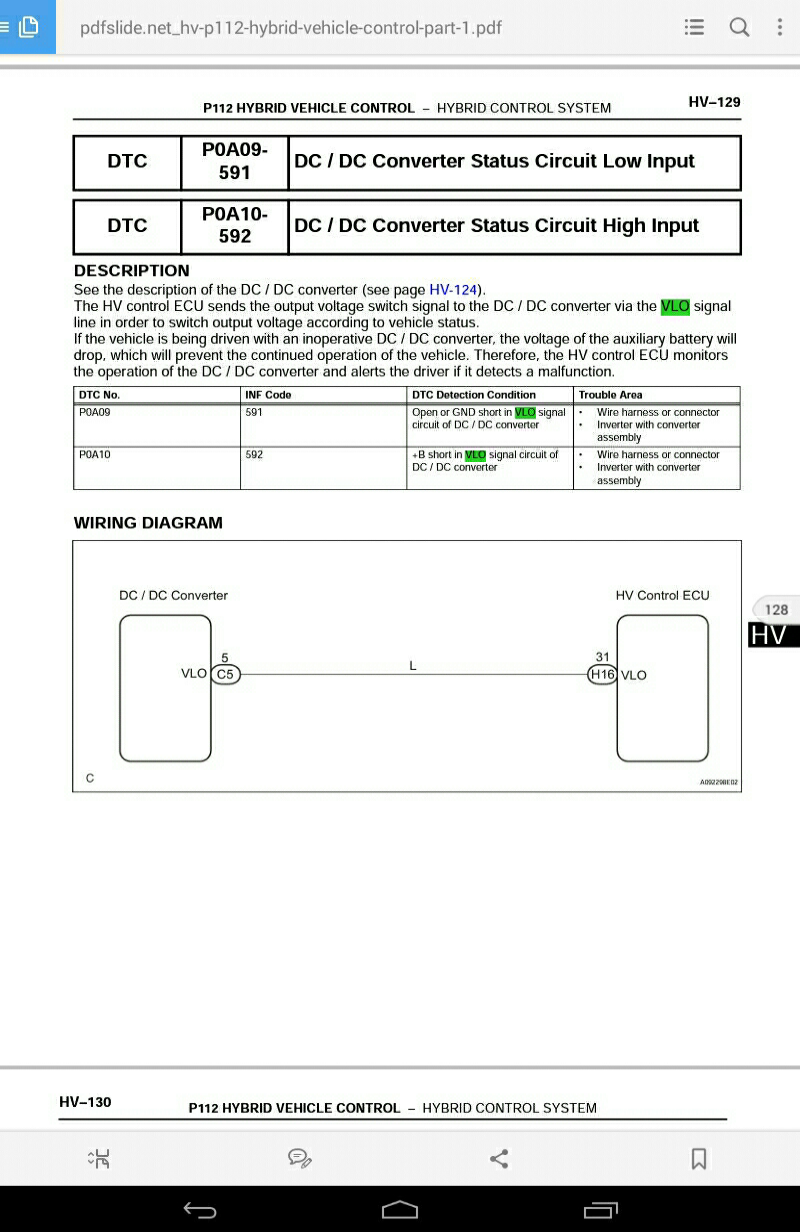

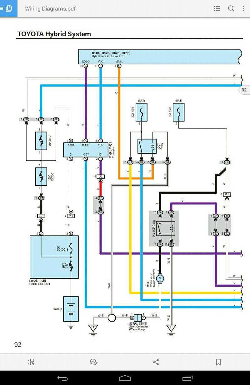

Trying to upload a few pages of what I found. Is there a way we can share the Toyota manuals or it's illegal? For now just trying to upload screen shots of C5 connector signals.

NODD and VLO are the ones giving me a headache at the moment because I don't have anywhere to test them.

johu wrote: Fri Apr 17, 2020 12:26 pm Is there any info on the part number of those control input connectors for the DC/DC converter (and aux inverter)?
I attached a photo above with the pin map for the 12v DC-DC system, the p/n for the C5 connector shell is 90980-11034 and for the C6 90980-11963. Those are the only two external connections needed for the DC-DC to function. It is able to supply 100A of "12v" power, so should be fused accordingly.
Any info on the 2 pole connector for power, next to the 32-pin one?
That is THE 12v enable circuit for the internal inverter / converter systems, completely unrelated to the DC-DC converter functions, which is convenient. Connector p/n is 90980-11148, Red to "12v", black to Ground (vehicle common B-), draw is pretty low, will measure it and report when I get the damned blue-pill running.
Any info on the aux inverter in general?
Voltage output is between 13.2v & 15v nominal, depending on the voltage applied to the C5 #4 terminal. 5V results in 15.2 no-load volts, but I will be testing the loaded output in the next few days.
There is also a lid interlock connection, I plan on using that to complete the GROUND for the HV relay coils ;) Lid off = no HV :)

If I understood correct, one 12V supply is monitoring one coming from battery and the other one is from ignition relay

I have both 12v wired to the "Ignition" circuit, there is no voltage monitoring on either wire from the documents I have. NODD (pin #4) and VLO (pin #5) are "responsible" for voltage conditioning, but VLO is not needed or even useful for our purposes.
Current draw is on my list to do ;), but 2A protection should be more than adequate.

ZooKeeper wrote: Fri Apr 17, 2020 1:50 pm I have both 12v wired to the "Ignition" circuit, there is no voltage monitoring on either wire from the documents I have.
I believe there is a reason why one connector is hooked up straight to battery. Maybe converter itself monitoring voltage even when ignition is switched off.

Remember, this device works with engine OFF to supply 12v to vehicle loads in the factory configuration and it would be unwise to do so in an EV conversion. I suspect the B+ connection is related to that ability, but there is scant documentation in the book.

ZooKeeper wrote: Fri Apr 17, 2020 11:04 pmI am able to get output from the DCDC with ONLY terminal #1 being tied to 12v as "ignition".
Heh, well, other than losing your mind, fewer wires is better for the rest of us :p

Pin #1 is labeled IGCT and is Ignition on according to this attachment.
