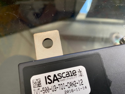

I'll PM you, put me down for 1 - IVT-500-U3-TOI-CAN2-12. Thanks.

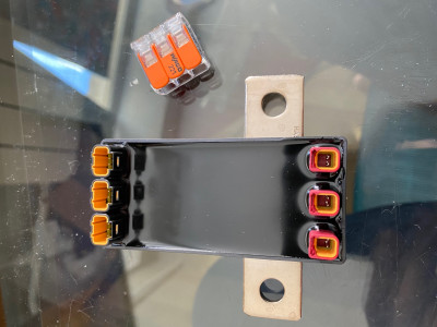

Just a quickie, My IVT-S just arrived and I’ve rigged it up to DM’s Leaf VCU board running V1.5 firmware.
The board communicates with the ISA Shunt through the ISA.h file. The only version I could find of this file is from EVTV But it had some issues with it:
http://media3.ev-tv.me/ISA.zip
I tried editing the file by replacing “ISA2.h“ with “ISA.h“ Within the code but I might be using the wrong file.
Does anyone have a correct version of ISA.h to work with the IVT-S shunt please?

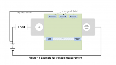

james@N52E01 wrote: Sat Jun 06, 2020 3:22 pm Just a quickie, My IVT-S just arrived and I’ve rigged it up
Some comments on the photo;
(1) you have a red twisted pair cable going to the shunt voltage measurement pins. Can you confirm these wires are shorted together not from different voltages?
(2) It looks like you have a CAN termination resister installed. Is this on the two centre or two outer pins? It's not clear from the photo.

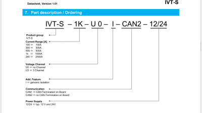

(3) Can you confirm you have the ISA Shunt without internal CAN termination? I don't know what part was supplied to you.
** recommend you test at low voltage and with current limiting resister to begin ;)
james@N52E01
Posts: 144
Joined: Wed Sep 18, 2019 7:02 am
Re: Isabellenhütte IVT-S shunts available
Post by james@N52E01 »
1) yes the voltage measurement wires are twisted just to keep them out of the way but they both go to the same point as per the wiring diagram.
I believe they are internally shorted so I’ve just used 2 for redundancy.
2) The 120R CAN Termination resistor is across pins b & c (the middle 2) which I believe are CANLo and CANHi according to the manual.
3) Yes this is a non-terminated CAN shunt. The model number on the shunt is IVT-S-1K-U3-CAN2-12/24.
The CAN2 means non-terminated according to the manual.
Good call on the current limiting resistor, I’ve gone for a 12v bulb.
