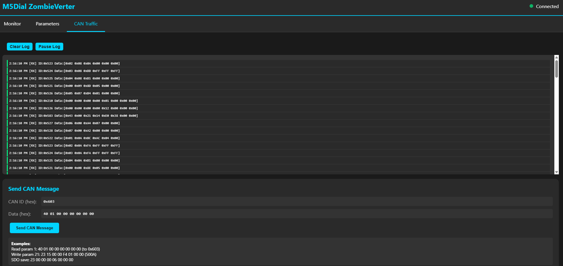

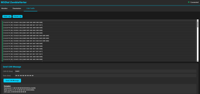

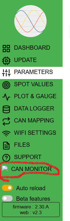

Continuing to evolve the dial. Latest release:
https://github.com/robertwa1974/Zombiev ... y/releases

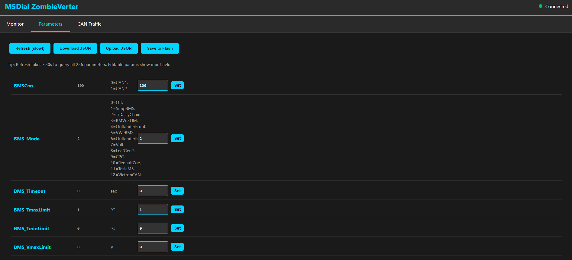

Playing with the dials web interface to read parameters. Have some scaling issues need work

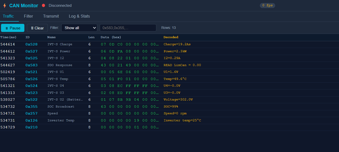

Added tab to show can log
Thinking more on the Web UI and don't want to reinvent the wheel. Jamie already has a great CAN based derivative of the Openinverter one so I'm going to pivot to that. I've been able to run that on the dial successfully but not yet without killing dial functionality. Will keep working on this as time allows
This whole Claude AI thing has been an experience. It's so easy for AI to go off track and, as someone who doesn't know code, is easy to get sucked in. Many times, I've had to call a timeout (akin to a board meeting) and reinforce the objectives. It's been fun, but quite a detour from my car build. On the plus side, I've learned about SPIFFS and JSONs and SDO and all sorts of other stuff. I've had SavvyCan running along with Openinerter CAN tool together.

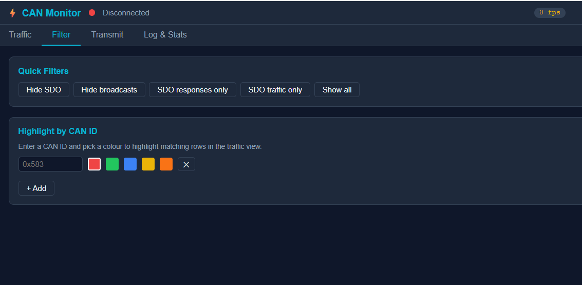

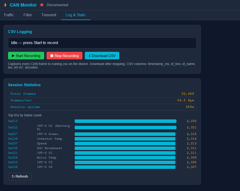

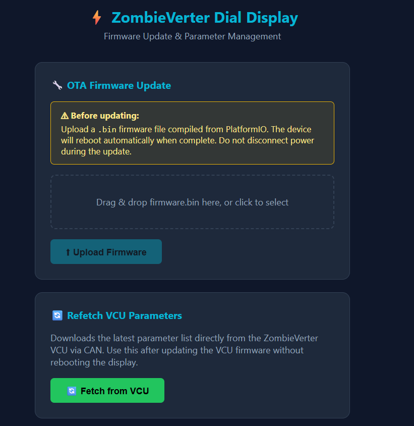

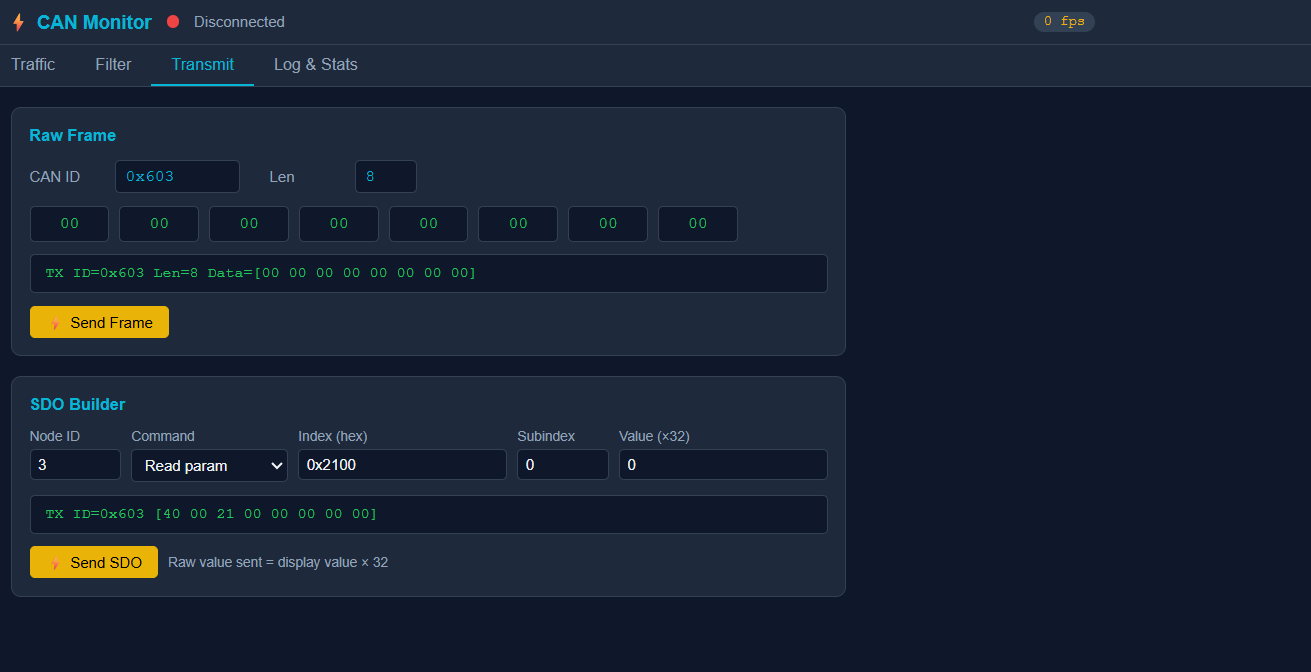

Released v2.3.0.
Full release notes: https://github.com/robertwa1974/Zombiev ... tag/v2.3.0
Key changes:
- Changed gearchange, motor select, regen to SDO, no more need for parameter mapping.
- Added tab to web UI screen showing CAN traffic, decoding, transmit single packet and logging
- Added OTA FW updates on web UI
-Added parameter fetch on web UI (in addition to fetching automatically on dial boot)
-Fixed bugs on parameter fetching on dial boot
-General file cleanup and dial graphics optimization

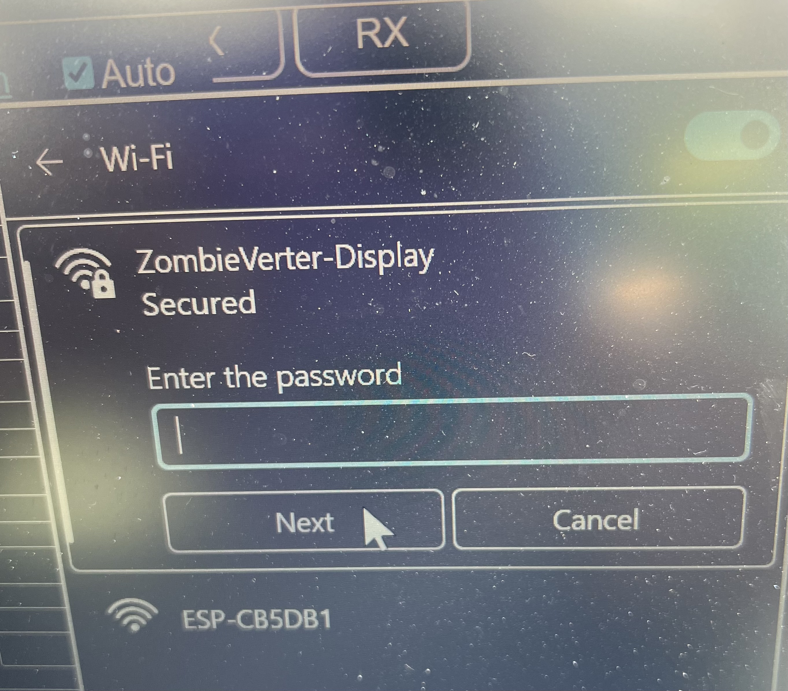

Hi Robert, what is the Zombieverter-Display password when using a M5Stack Dial…I’m stuck!?
What Can H Can L did you use on the Zombieverter…I was going to use pin 25 and 26 (which is free) but I have the Can to the BMW Sbox or Outlander charger available?

Ghia66 wrote: Tue Apr 21, 2026 3:47 pm IMG_3777.jpeg
Password should be
zombieverter
if I'm not mistaken
Zombieverter

Correct, password is 'zombieverter'
Instructions here:
https://github.com/robertwa1974/Zombiev ... /README.md
I connect to CAN 1 on zombieverter as that is confirmed to work with SDO. Not sure about CAN 2. You will want it in on the same bus as you have your shunt/S-box wired to
