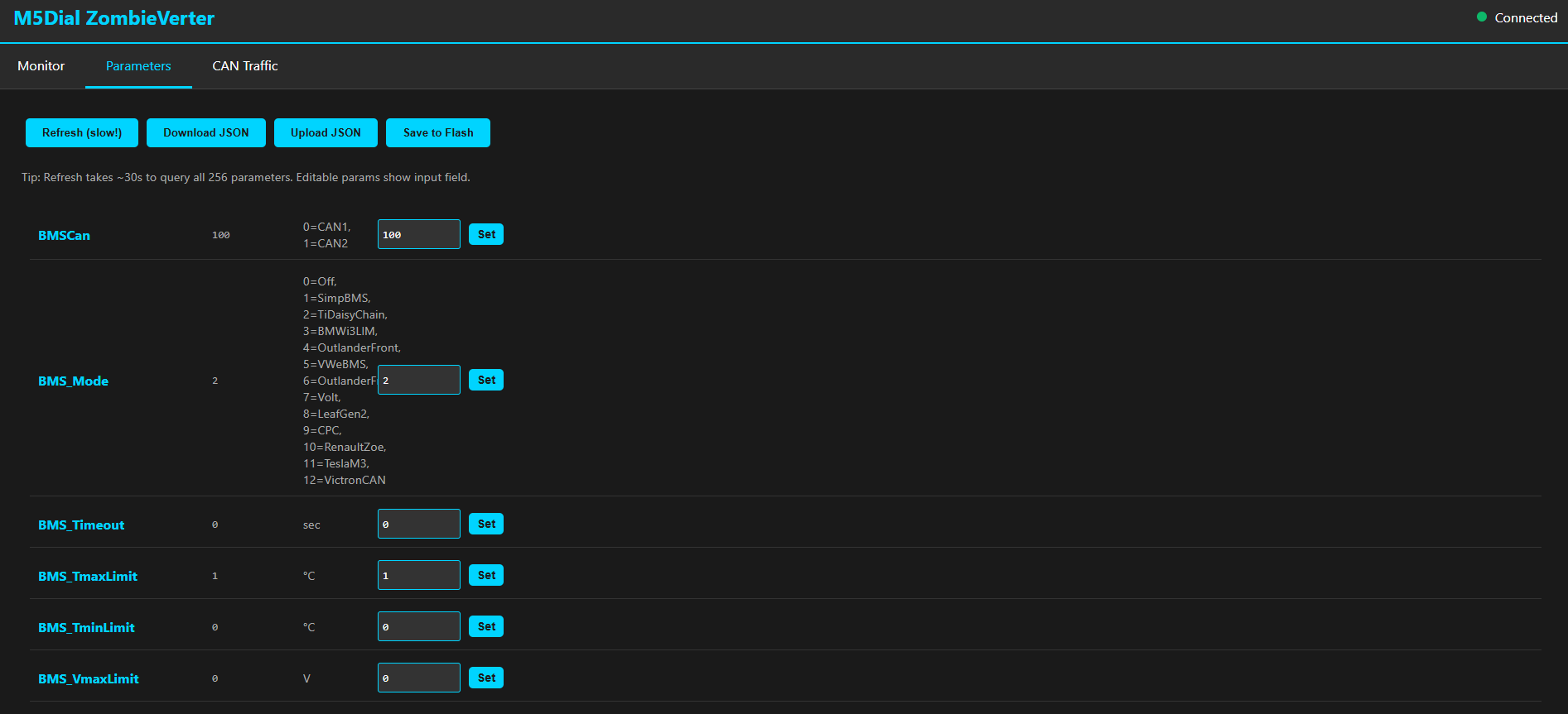

Got the Dial fetching parameters from zombieverter on boot. Also created a one-click install link in the release notes below in case anyone is interested. Again, all coding done by ClaudeAI

The display now downloads its parameter list directly from the ZombieVerter VCU at boot via SDO segmented transfer — no more manual `params.json` upload required.
**Boot sequence:**
1. On first power-up with the VCU connected, the display fetches the full parameter schema (~30KB) from the VCU over CAN
2. The splash screen shows live progress: **"Fetching params from VCU..."**
3. On success: **"VCU params loaded!"** — the file is automatically saved to internal storage for future use
4. If the VCU is not connected at boot, the display falls back to the last cached parameter file
5. If no cache exists, a minimal set of default parameters is used

- Parameter fetch uses CANopen segmented upload protocol on SDO index `0x5001` (the ZombieVerter strings index)
- Download runs synchronously before SDOManager starts, reading directly from TWAI to avoid FreeRTOS queue conflicts
- On a typical 200-parameter VCU, the download takes 3–5 seconds (~4400 segments × 7 bytes)
- Fetched file is saved to SPIFFS as `/params.json`, overwriting any previously uploaded file

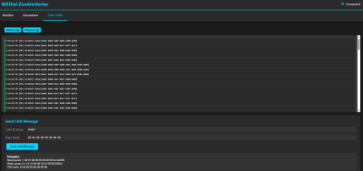

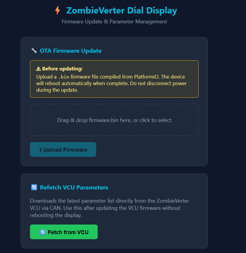

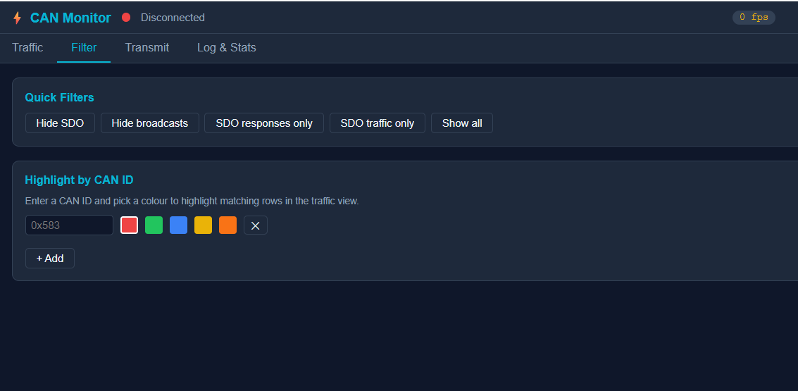

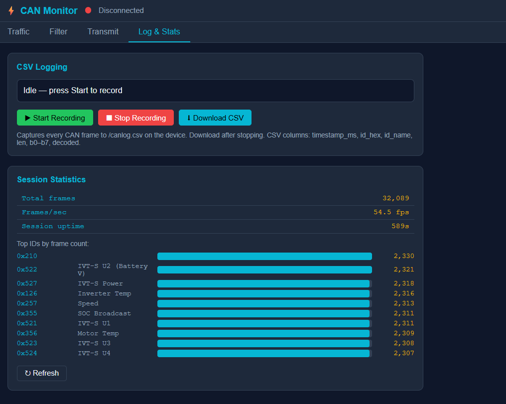

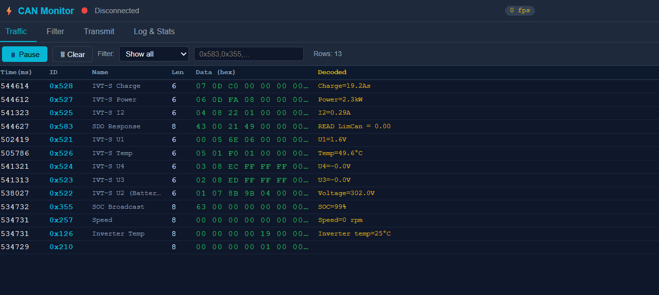

Released v2.3.0.
Full release notes: https://github.com/robertwa1974/Zombiev ... tag/v2.3.0
Key changes:

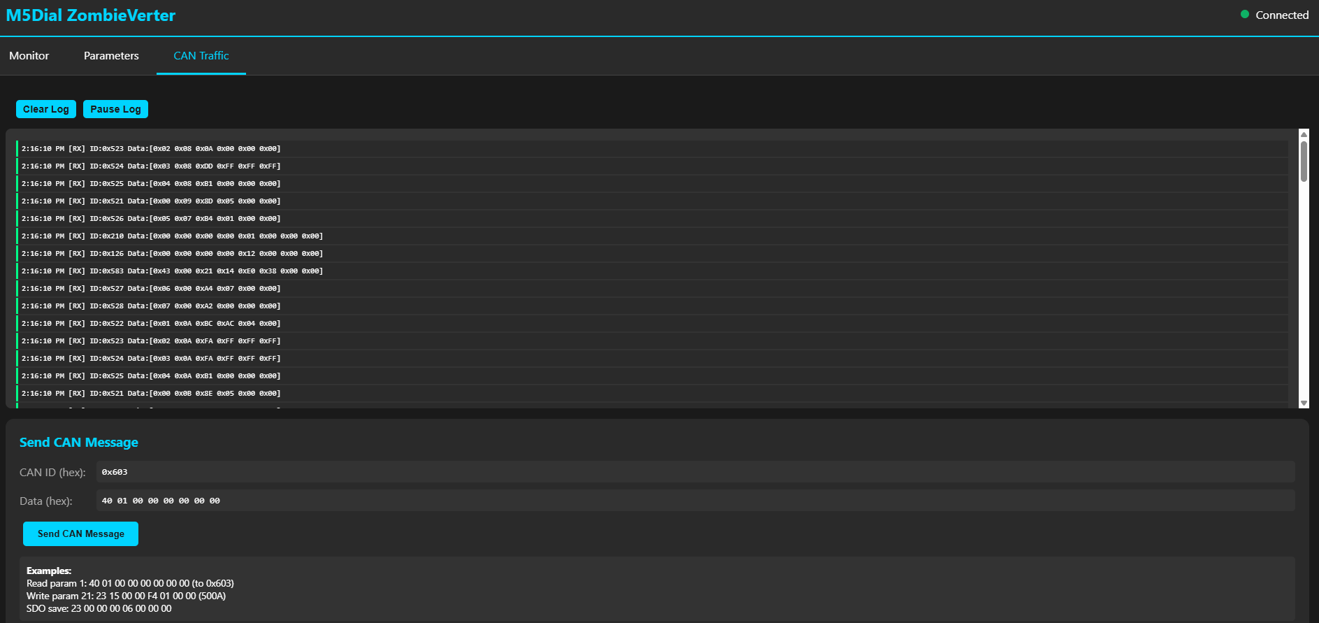

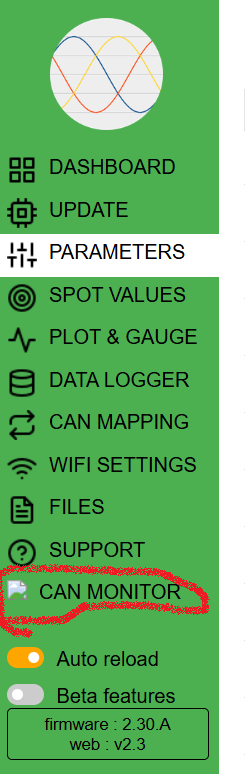

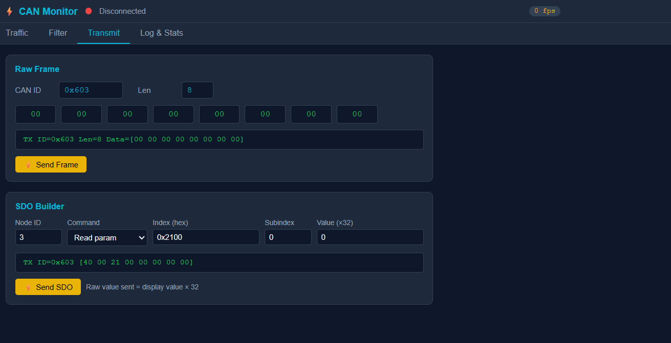

- Changed gearchange, motor select, regen to SDO, no more need for parameter mapping.
- Added tab to web UI screen showing CAN traffic, decoding, transmit single packet and logging
- Added OTA FW updates on web UI
-Added parameter fetch on web UI (in addition to fetching automatically on dial boot)
-Fixed bugs on parameter fetching on dial boot
-General file cleanup and dial graphics optimization
Key changes:

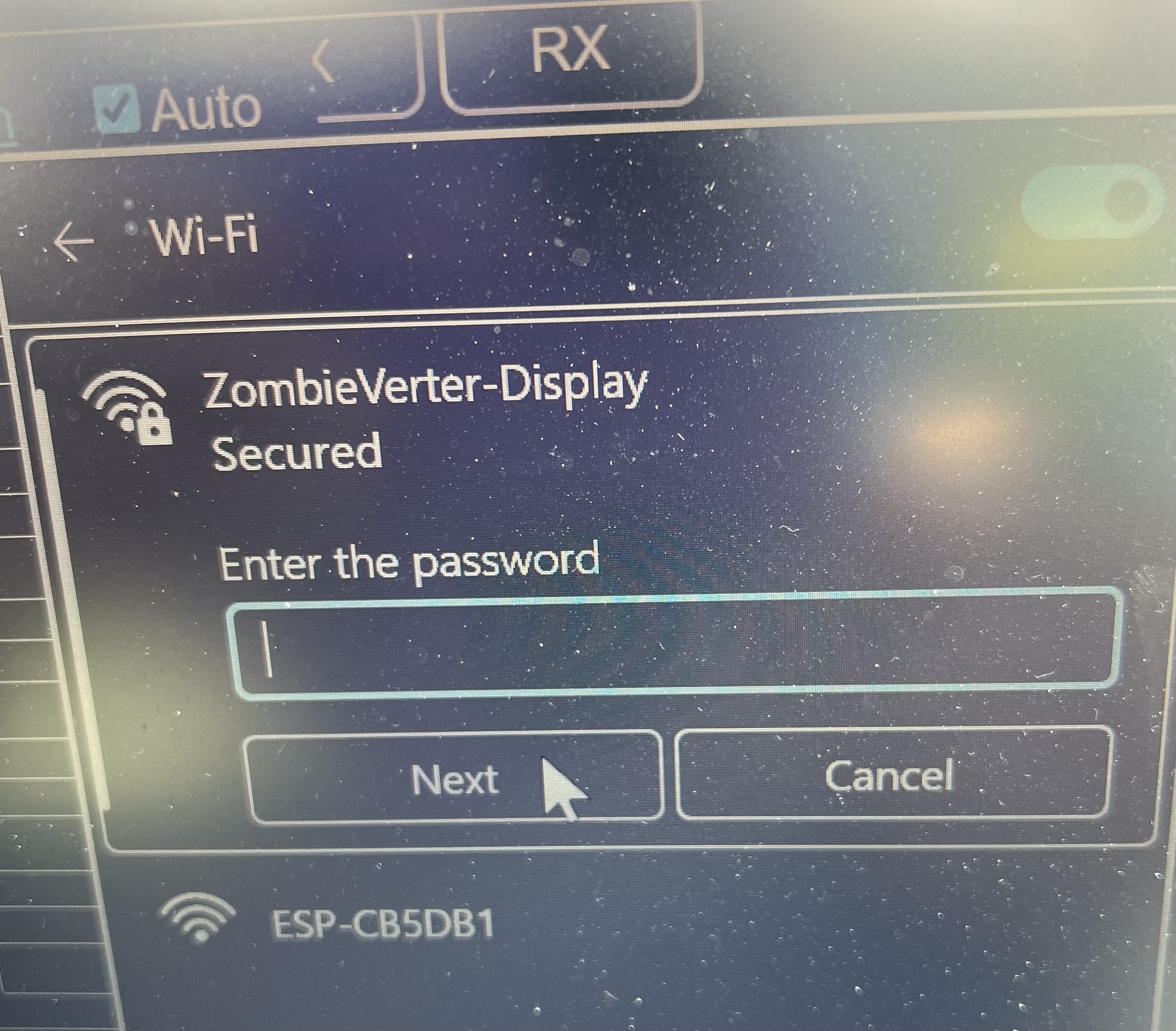

Hi Robert, what is the Zombieverter-Display password when using a M5Stack Dial…I’m stuck!?

Password should be
zombieverterZombieverter

Correct, password is 'zombieverter'
Instructions here:
https://github.com/robertwa1974/Zombiev ... /README.md
