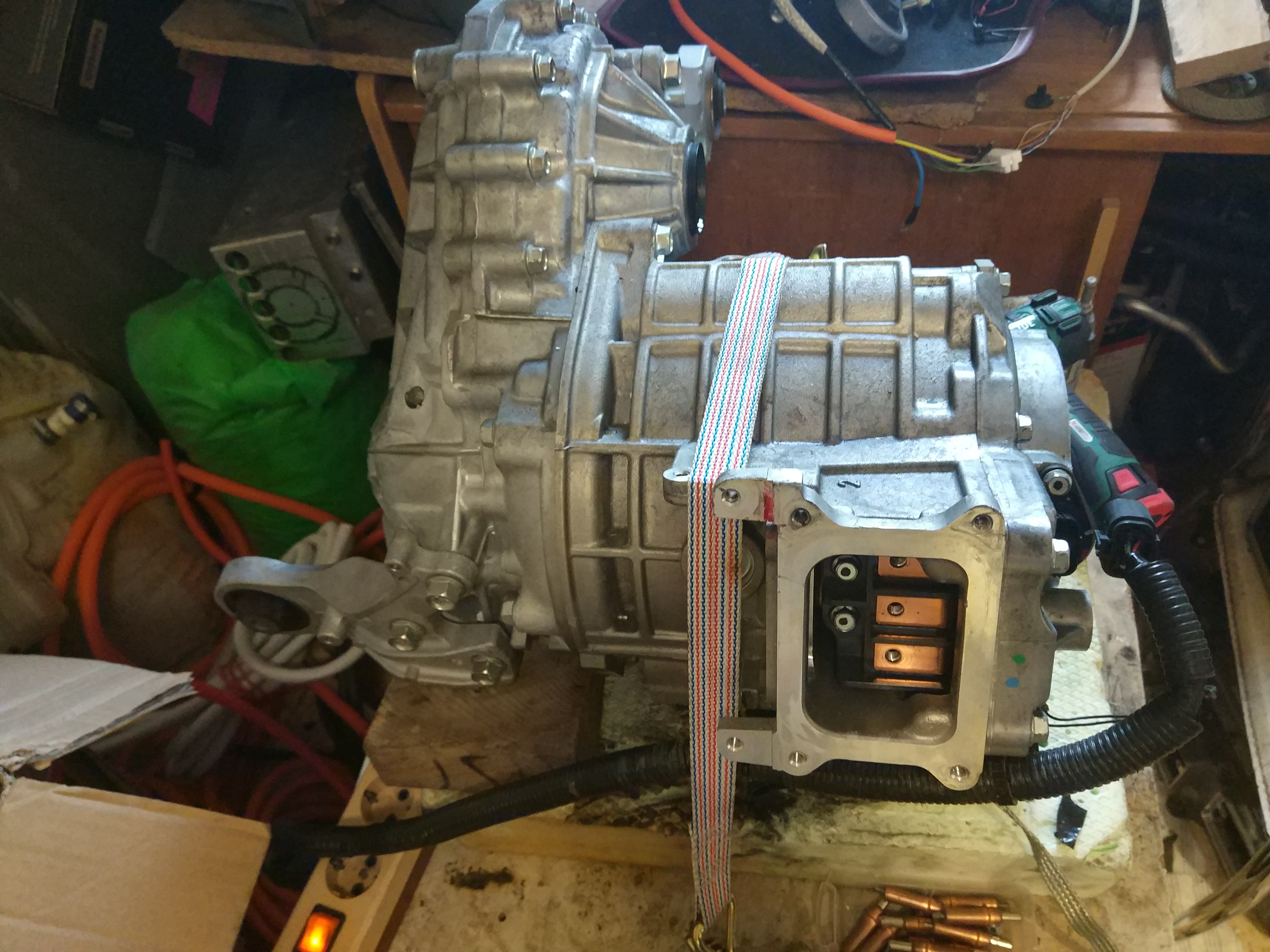

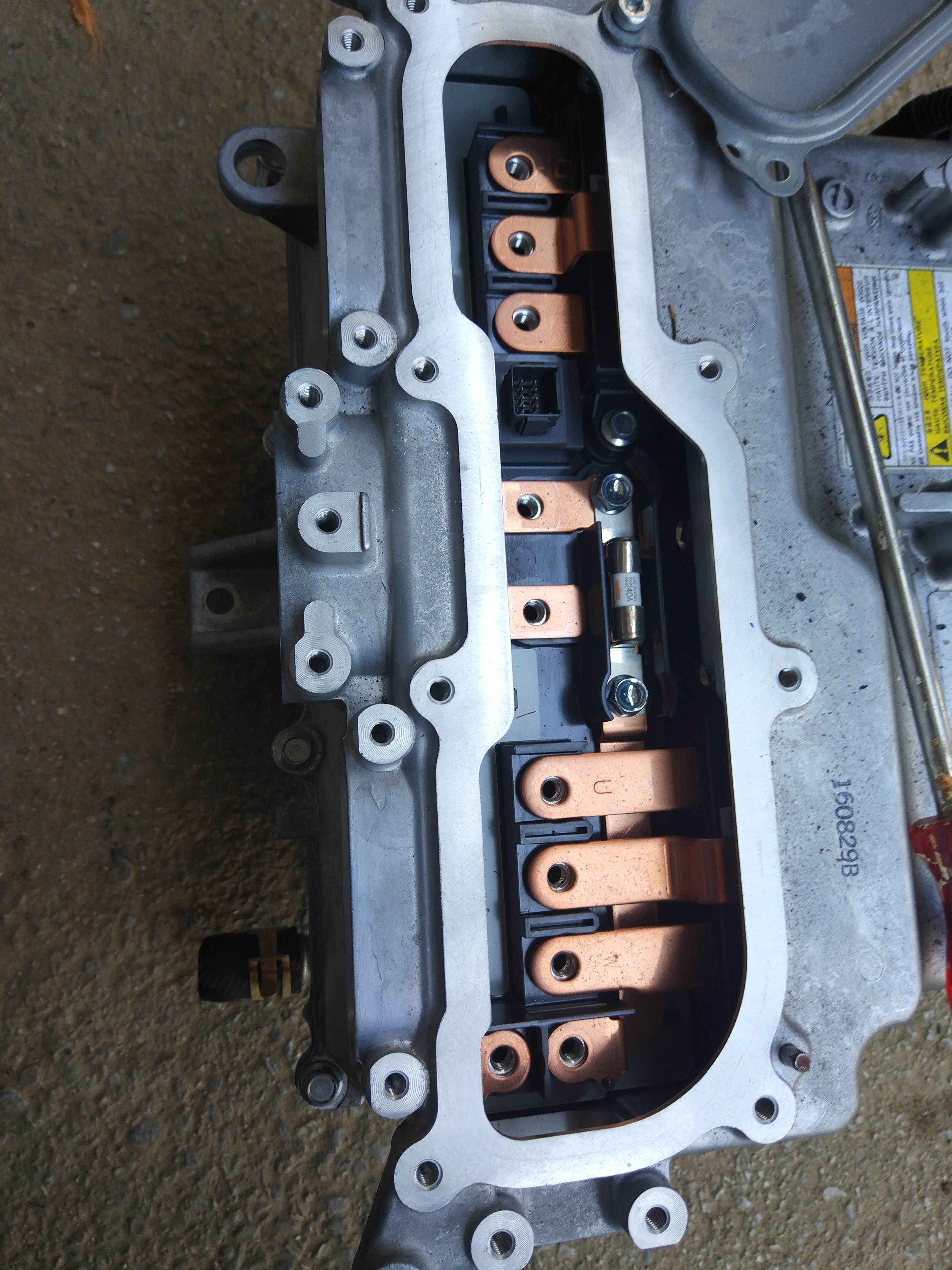

Now I have Outlander inverter in my workshop. I still need to figure out which one is it exactly, but i think it is rear one.
It has only 3 phase cables yes?

Re: Mitsubishi outlander charger and DC:DC
two round holes and one oval hole on the bottom.
2x 14pin LV connectors on flanges. Then it is a rear.

I have this motor and controler at home now, damn it is a front inverter and rear motor! Do you have a P/N for the rear one?
Also is driving a front one with CAN realisticaly possible?

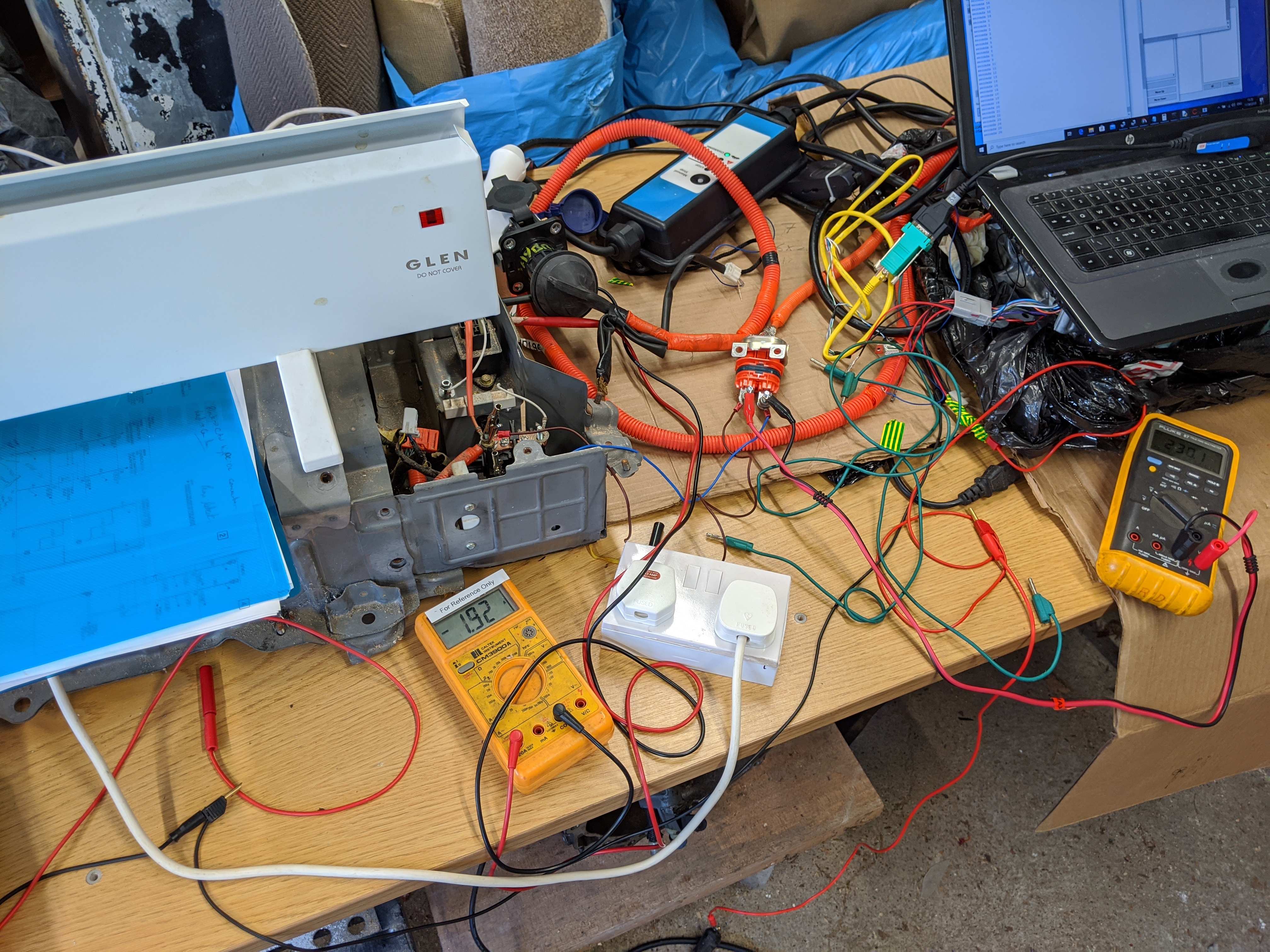

I got the charger connected to a Prius battery, sitting at 150v.
The system still only pulls on the evse for one second before dropping the evse, when I send the 285 message with b6.
Probally because you have too low a DC voltage. The inverters have a cut off of around 200V.
Ok I'll try charge the pack via a big resistor.
I can understand the charger not wanting to charge the pack, but I didn't think it would drop out the evse.
I currently have nothing connected to the proxy signal as that normally goes to the phev ecu. As far as I know the evse does not read the proximity signal, it is just a few resistors in the j1772 handle

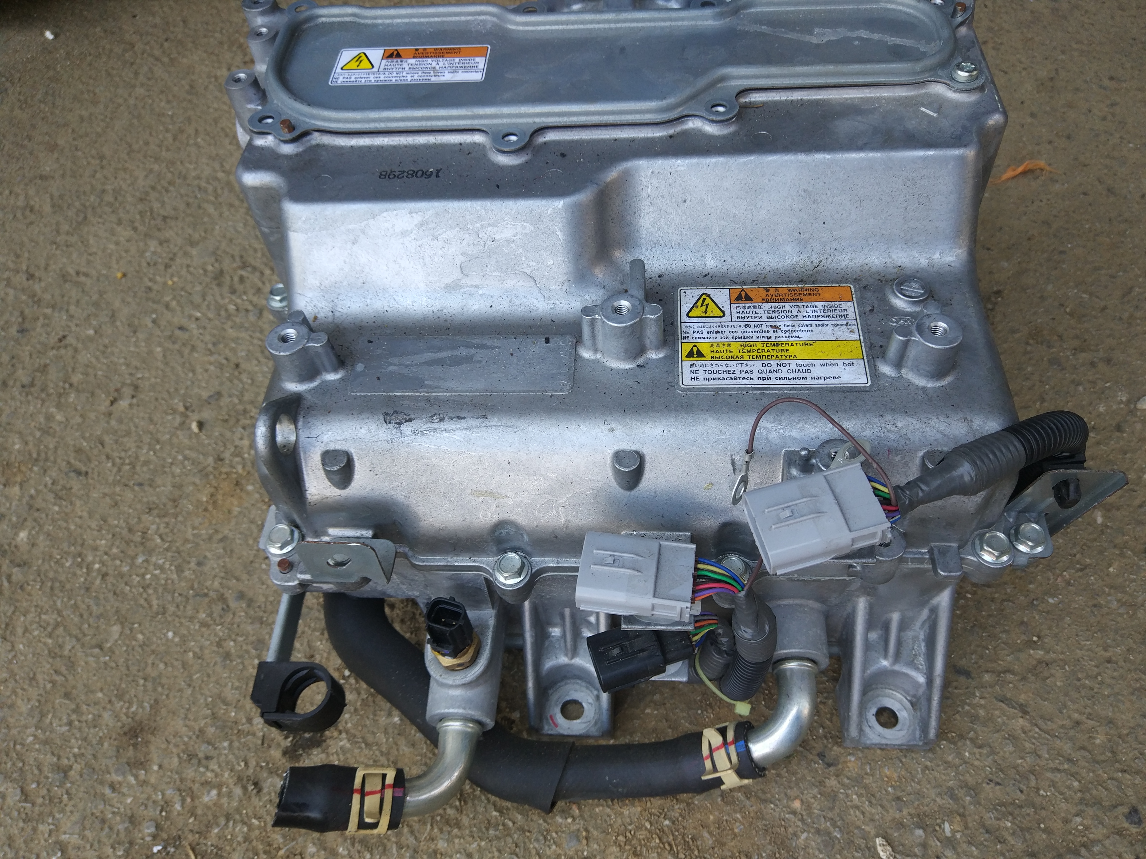

Hi
Does anyone need Mitsubishi Outlander front inverter? It is PN 9410A095 with dual motor port as well as AC HV connector.
I am willing to part it for 120€. Interested?
I managed to negotiate another shipment, this time i will get correct rear inverter.
I've successfully got the Outlander charger to charge the prius battery
I needed to get the battery voltage up closer to 200V, before the charger would keep the EVSE contactor pulled in all of the time. I had to be a little creative to get some current into the battery and bring up the voltage so the charger would not fault out.
I could then command the charge current by using the 0x286 message. For anyone who is interested I've attached a python script which I used with the KVASER CAN tool to send the frames.
So overall, i'm quite happy, can now design something to detect when the handle is attached via the proximity signal and power up the charger. When the charger powers up if I can see the pilot duty I will be able to request that it starts charging.
I can't get the charger to start a second cycle without powering it on/off, so i'm not sure if its faulted out by how i'm stoping the cycle, or it's just part of the code that once it does the charge cycle it won't do it a second time. In my python script which is very much hacked together on the garage floor, i requested that the charger go back to 0 current before dropping the EVSE out, but didn't seem to allow me to start a second charge. I need to review the logs from the car again.
One other thing I learned by accident, i used my 2kw office heater as the pre-charge resistor, and i started a charge cycle with the heater in the circuit. I commanded 2Amps and when i looked down at the meter i had 2A in the battery and the charger output was up over 400V
So it looks like this charger will possibly be able to charge higher voltage packs.
My plan is to use the above setup to test the DC:DC Converter next week. There doesn't seem to be any output control for the DC:DC, which is controlled via an enable pin.
Very happy with the above, these chargers are using in a range of PHEVs, so should give a cheap charging and DC solution. It will also easily fit where the spare wheel goes and the AC input cable is long enough that it will go as far as the petrol cap on any car.
My prius battery isn't in good condition so i didn't want to pass too many amps into it, so I was just using 2-3A targets. But when I charged the battery via the pre-charge (heater), the charger output went to 420V. So it went above the 370V ceiling (3700) which was being commanded.
I'm speculating that there is a constant current mode for the bulk of the charge and then a constant voltage mode that would be used at the end of the charge cycle and during cell balancing etc... but i could be wrong about this.
