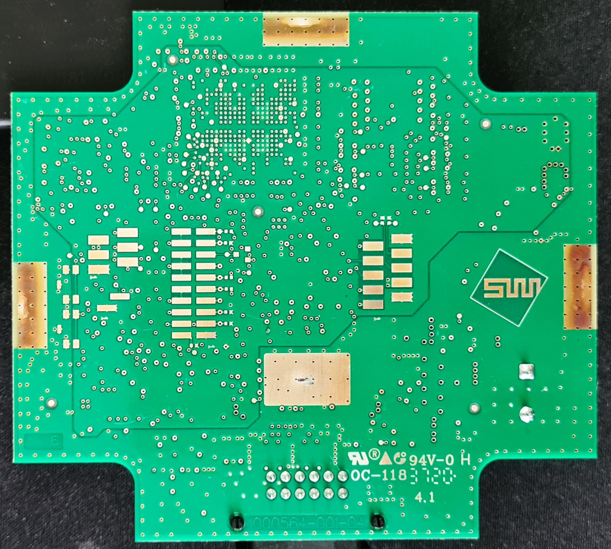

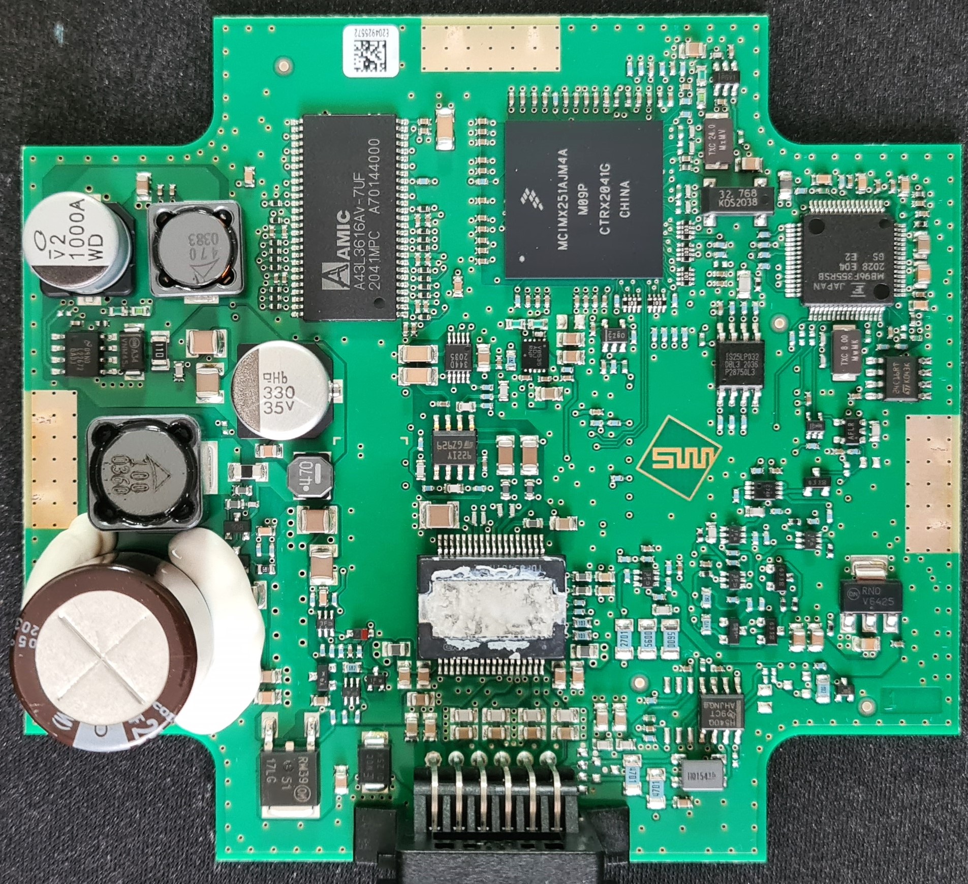

Did you also have success with the software version 1.00 VESS? I was not able to convince it to play. But now managed to copy the SW 1.01 from the good unit, and flash it on the old unit. Now it plays
Documentation of the update procedure is on github: https://github.com/uhi22/Ioniq28Investi ... controller

Found myself looking for Hyundai VESS parts and stumbled upon this, the Kona VESS seems to be further hacked
Do I understand this correctly that you can configure this via Rs-232 and there is a command line user interface for the VESS?

Interesting. This is a completely different hardware design.
I can only speak for the ioniq unit. This has the pins for a serial, and some related texts in the bootloader. Rest to be found out.

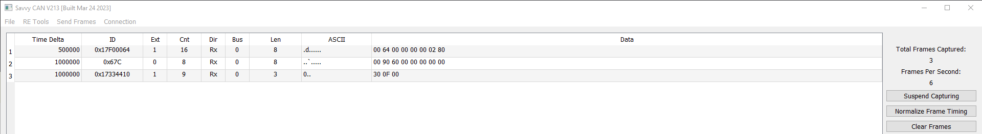

Now I have received the Taycan control unit from the USA, I have connected everything according to the circuit diagram, but there are no CAN messages, the power consumption is about 400mA, Does anyone know the exact pin assignment? I can't figure it out from the circuit diagram.
edit, i forgot to apply a 120ohm resistor, now we have 3 Messages, but i don´t know what now and a log file
