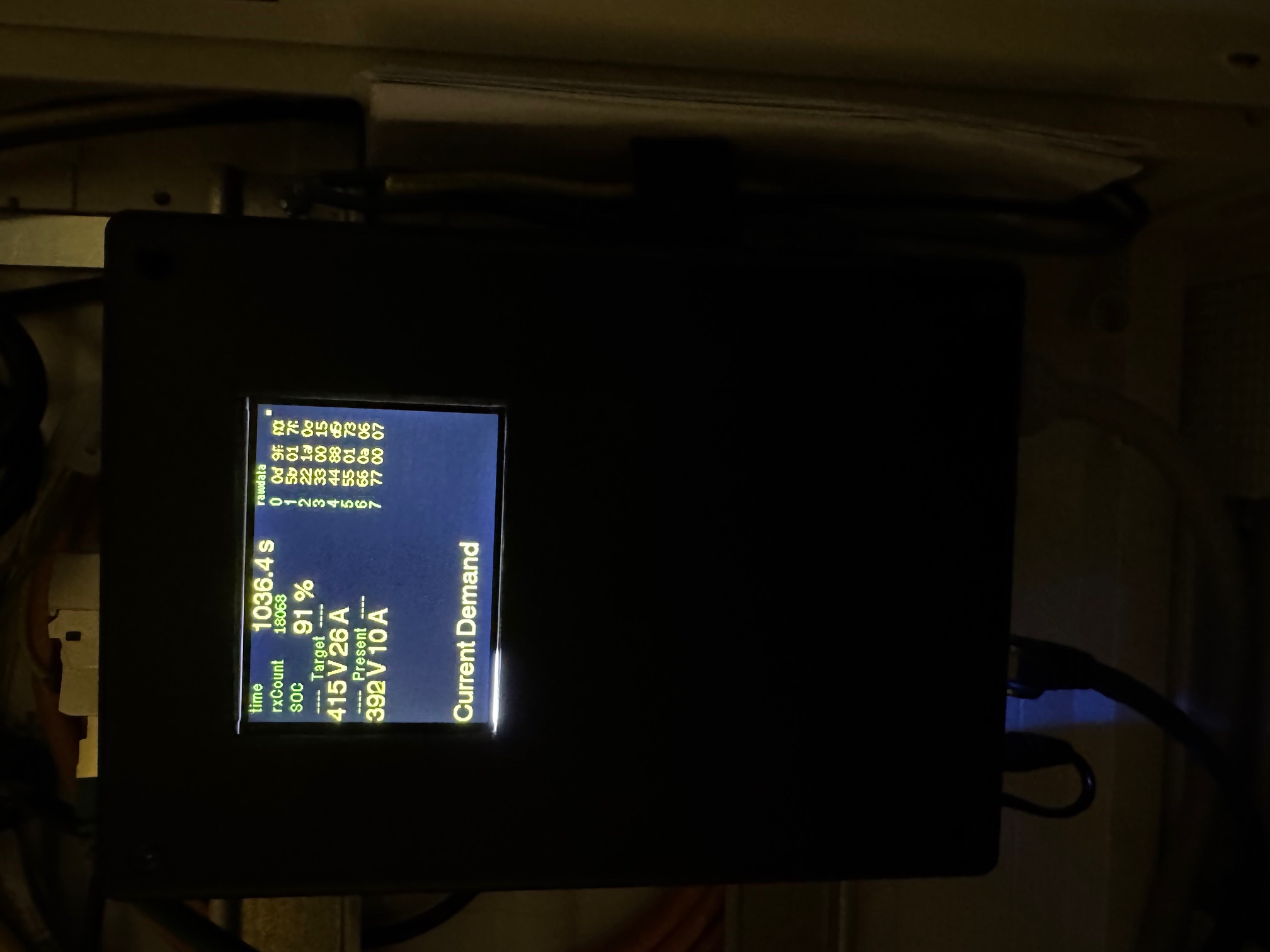

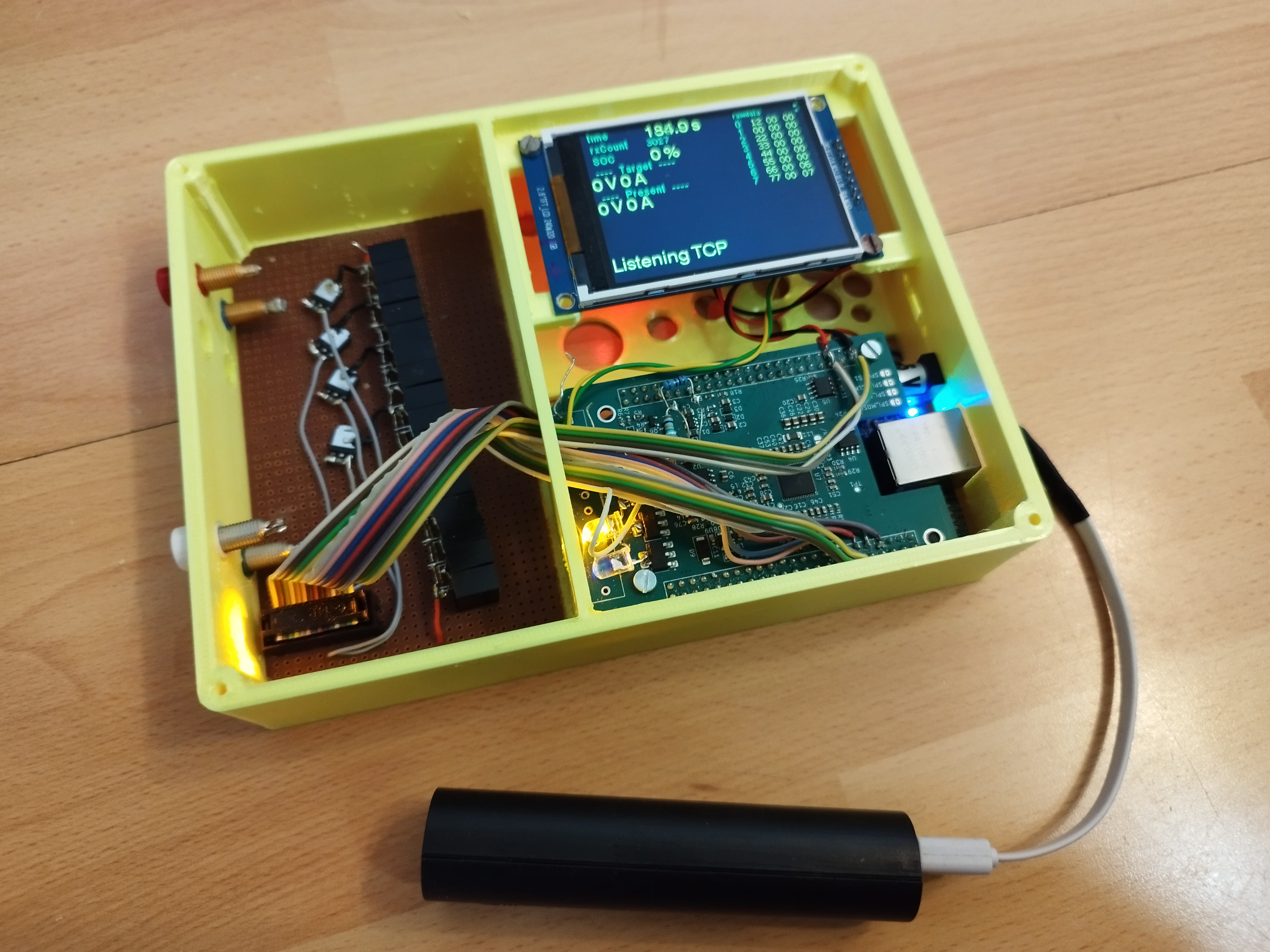

I can't believe, the i3 light is blue. evseNoGui is reporting the following.
[addressManager] will give local MAC BA:F0:F2:E5:43:A4
udplog started with ownMac BA:F0:F2:E5:43:A4
logging to UDP Syslog is disabled
sniffer created at eth1
[addressManager] pev has MAC F0:7F:0C:15:D5:73
[240, 127, 12, 21, 213, 115]
[addressManager] pev has IP fe80:0000:0000:0000:f27f:0cff:fe15:d573
V2GTP (10bytes) = 01 FE 90 00 00 00 00 02 10 00
Ok, this was a valid SDP request. We are the SECC. Sending SDP response.
SDP payload (20bytes) = FE 80 00 00 00 00 00 00 B8 F0 F2 FF FE E5 43 A4 3B 0E 10 00
V2Gframe (28bytes) = 01 FE 90 01 00 00 00 14 FE 80 00 00 00 00 00 00 B8 F0 F2 FF FE E5 43 A4 3B 0E 10 00
And all what I have changed is the duty cycle back to the original value in the cppwm.py
uhi22
Posts: 1243
Location: Ingolstadt/Germany
Has thanked: 244 times
Been thanked: 684 times
Re: Energy Controller including CCS interface
Post by uhi22 »
Wow, I would be interested in the pcap.
jrichl
Posts: 27

uhi22 wrote: Sat Feb 21, 2026 5:36 pm Wow, I would be interested in the pcap.
I'm very excited, here is the pcap. Inside the car, the display things it would be charged :D
0256_tcpdump.pcap.txt
(1.32 MiB) Downloaded 4 times
uhi22
Posts: 1243
Post by uhi22 »
Congratulations, this looks very good.
I have some remarks:
1. Which model year is the i3? It is interesting, it announces only the good old DIN70121 from year 2012. BMW seems to have no urgent update plans ;-)
2. You are using an older version of openV2Gx, which still reports "Not ready" during the cable check. Seems not to disturb the i3, but nevertheless I recommend to pull the latest revision and make again.
3. Funny thing: The i3 requests 415V in the first precharge request, and 390V later.
4. The log shows that we are more than 5 minutes in the current demand loop, then the log ends. Would be interesting to know how long the i3 is tolerating this situation.

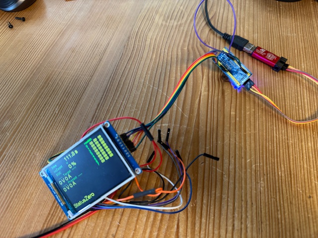

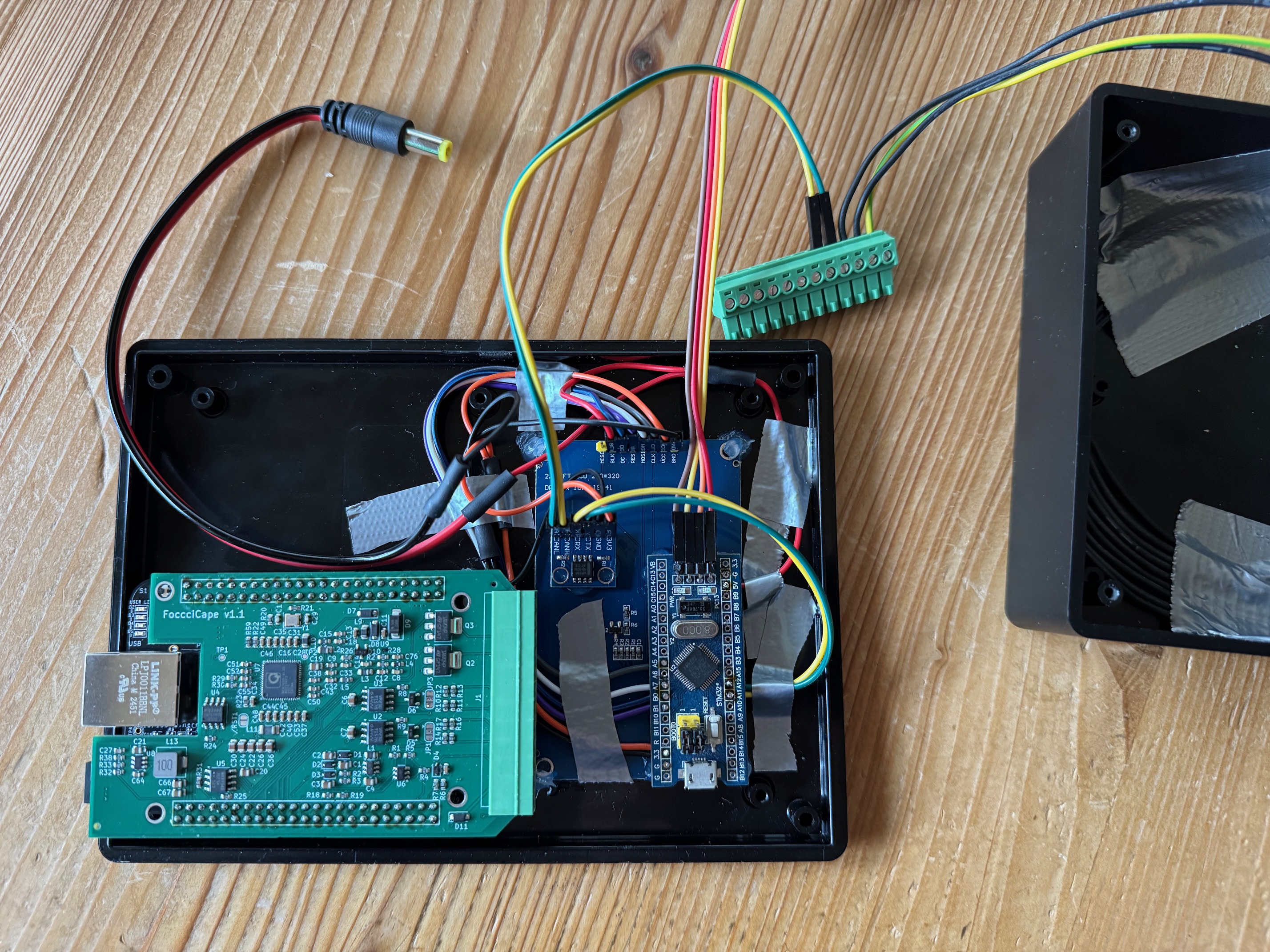

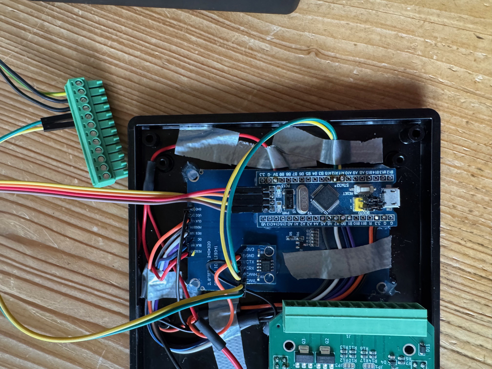

https://github.com/uhi22/TFT-with-CAN/t ... playbranch

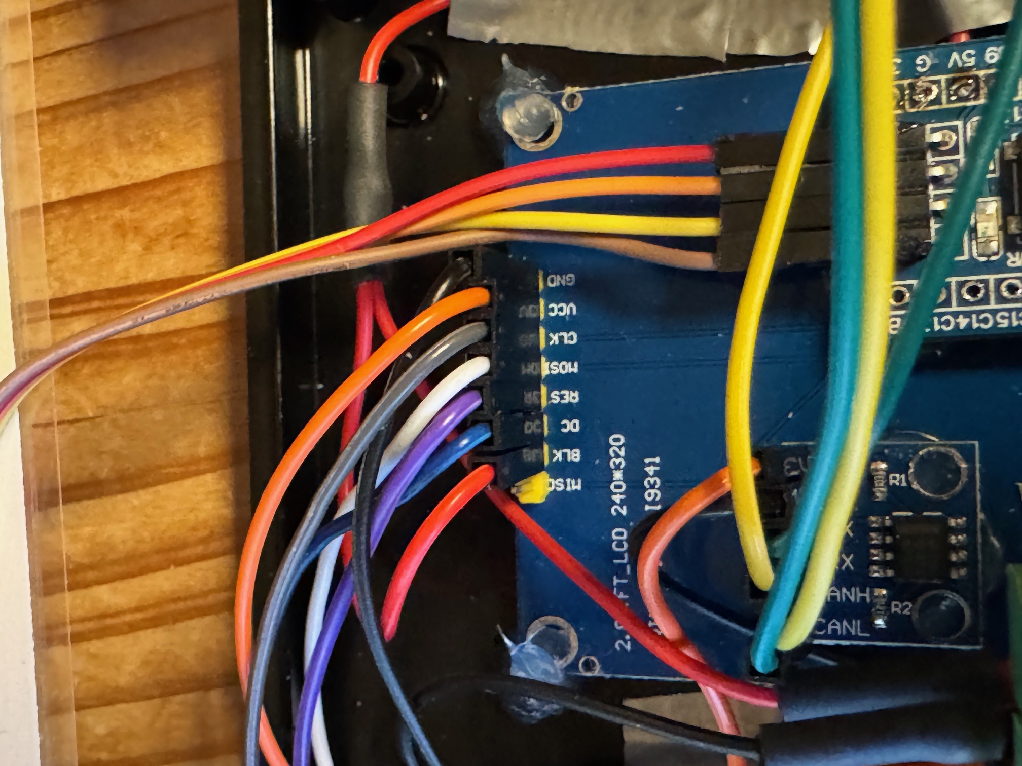

I See the CAN Messages with the candump can0, but the display only shows the backlight and nothing else. The Display is from here
https://de.aliexpress.com/item/10050037 ... pt=glo2deu
It should have an ILI9341, although I have read that the cheap Chinese Modules not necessarily have one. Is there something to care about regarding the cabling. Maybe somethings is wrong with the binary which I build with the STM32cubeIDE on my MacOS System? I flashed it with an ST-Link V2. Need those Display also some software?
uhi22
Posts: 1243
Post by uhi22 »
No, the display itself does not need any software. I also use the CubeIDE, and the STLink v2 (clone) to flash. Does the flash process work? I had issues with some faked bluepill boards, which seem to have a slighly different controller. The flash process failed.
Other thing are the cheap CAN transceiver boards. Not all of them work as they should. One thing to check is the resistance between CANH and CANL while not powered, this should be in range 60 to 120 ohms (in theory each end of the line should have 120 ohm termination, but we can ignore this if it is only half a meter).
To exclude a CAN transceiver issue, you could remove the CAN transceiver and bridge CANRX and CANTX on the STM32. With this setup, the controller is happy to run and should send data to the display. If this does not help, only idea would be a wrong display type or wrong wiring.

To simplify analysis, added an LED-blink feature to the display software. The green onboard-LED of the bluepill blinks slowly (~once per second) after startup, and fast (~4 per second) if a CAN message was received.

uhi22 wrote: Sun Feb 22, 2026 4:01 pm No, the display itself does not need any software. I also use the CubeIDE, and the STLink v2 (clone) to flash. Does the flash process work? I had issues with some faked bluepill boards, which seem to have a slighly different controller. The flash process failed.
I fear it is the display. Measuring the resistance between CANH and CANL show something around 115 ohms. Also the bridge of CANRX and CANTX on the STM32 doesn't light up the display (still only backlights). The flashing seems to be ok, see Logfiles attached. When I start only the STM32 the red light is permanent on, and the green light is flashing at intervals of maybe 1 sek, when the foccciCape comes up and CAN messages are flowing the green light flashes much faster, maybe 250ms - as mentioned from you.

Post by uhi22 »
This sounds half-way good, the green light says that the software is running, and the CAN reception works fine.
I just soldered a new device (display+bluepill+cantransceiver), this works here, even if the bluepill is a fake (not recognized in the cubeIDE). I added new fotos and description of pitfalls in the github https://github.com/uhi22/TFT-with-CAN/t ... playbranch
The only remaining idea is to re-check the wiring of the display, maybe a shorted line or a bad connector / jumper cable.

uhi22 wrote: Sun Feb 22, 2026 6:58 pm This sounds half-way good, the green light says that the software is running, and the CAN reception works fine.
I have measured now all the jumper cables, and all of them look good. It only could be just the display now anymore. The only optical difference that I can see between your Display and mine are the GND solderpoints on the Display, I had to connect the GND Points by cabling. Don't know if it helps but on the packaging of the display is a label that tells the following: If LCD no work, please contact with us. We have code send to you.
Don't know which code they mean but I send them an email, that my display doesn't work, we will see if I get something.
Otherwise I have to order a new display. Which one do you have?

uhi22 wrote: Mon Feb 23, 2026 11:32 pm I have them from Aliexpress, similar to Amazon
amazon.de/-/en/Fasizi-Module-ILI9341-Colour-Display/dp/B09Z27TYMK/ref=sr_1_35
The pinning is exactly the same as yours, but the print on the PCB is slightly different, I have the pin description on the front side, not on the back side. Also 2.8 inch, 240x320. Part number on PCB is ZJY280S0800TG01-ILI9341.
Single row, 8 pin, no touch, blue PCB.
hard to believe, but it wasn't the display. I'have changed the ESP32 and look how it works now. The software flashed on the STM32 is the same as on the old STM32 - no changes.

Always good to have a spare bluepill board for such cases. Maybe an even worse clone, or a pin was killed by ESD or something like this.
PS: But I see no CAN communication yet, hopefully the CAN reception works with the new STM32.

uhi22 wrote: Tue Feb 24, 2026 7:30 pm Yeahhhh, time to celebrate :-) Congratulations.
It is running. Thank you very much for your advice. It wouldn't have been possible without your great work and installation description. Next step will be the lightbulbs, then we will see how long the i3 is happy.

FoccciCape &Co are moving to their new home
Plan is to integrate a controllable step-up for precharge and HV measurement.
