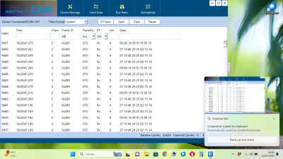

How my car is connected to inverter
1. I provide 12 ignition through the key to IGCT pin and 0V to GND
At this time VCU is online and in ready mode. This means it is actively sending 0x285 telegram at 30ms in drive mode
There is NO CAN from inverter at this time!
2. When i provide START pulse precharge relay raises voltage and then DC+ contactor goves HV. You should see active inverter CAN reports then
I use charger CAN signal to verify correct voltage just a precaution with precharge
3. When i put car in drive mode all inverter messages are flying on the CAN bus
To summarize;
1. You need to connect 12V to IGCT
2. You need to connect HV to inverter (by precharge)
3. Inverter CAN reports are active when HV is online.
4. Only then you can read and command inverter with your VCU
EDIT: I went out in the -10°C cold to demonstrate this via screen grab... it says -6 but i assure you it is lower than that :)...
0x289 is one of the inverter CAN reports
0x285 is BMS heartbeat that all Mitsu components require for operation
I sugget you make all connections with your motor, resolver and HV first in your workshop as you would in the car. Then start the "car".

arber333 wrote: Sun Jan 11, 2026 7:22 pm Hm... strange
I connect car saux battery with ignition so i provide inverter, OBC and heater with 12V so it is more than 1A.
But even if i provide 12V and 0x285 telegram i only get response from inverter is when i give it HV via precharge process.
To verify this i use ECAN USB interface
https://www.ebay.com/itm/315582425941
or
https://www.aliexpress.com/item/1005010 ... in_prod%3A
Yes its very strange
Now is fine :-)
i dont ask!

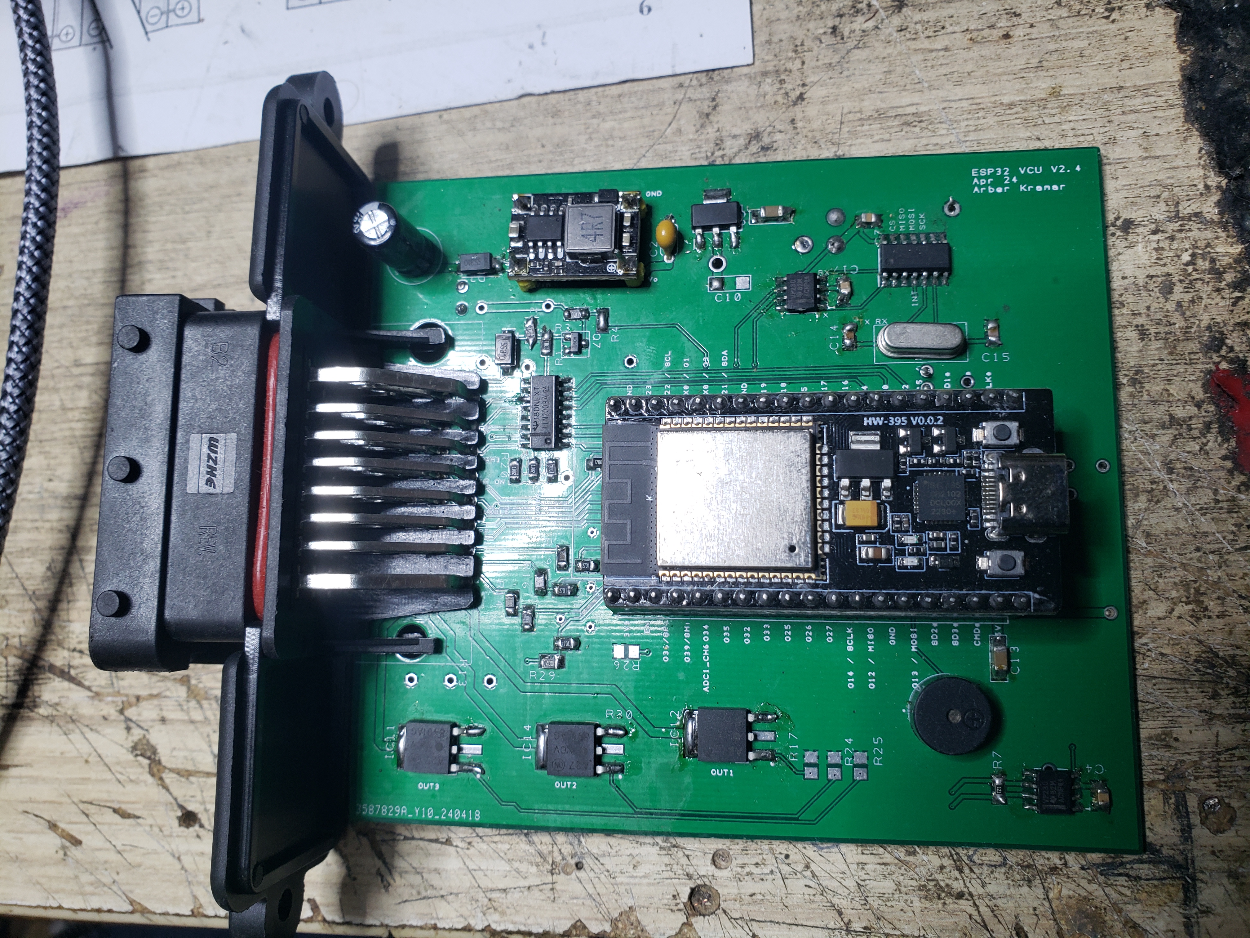

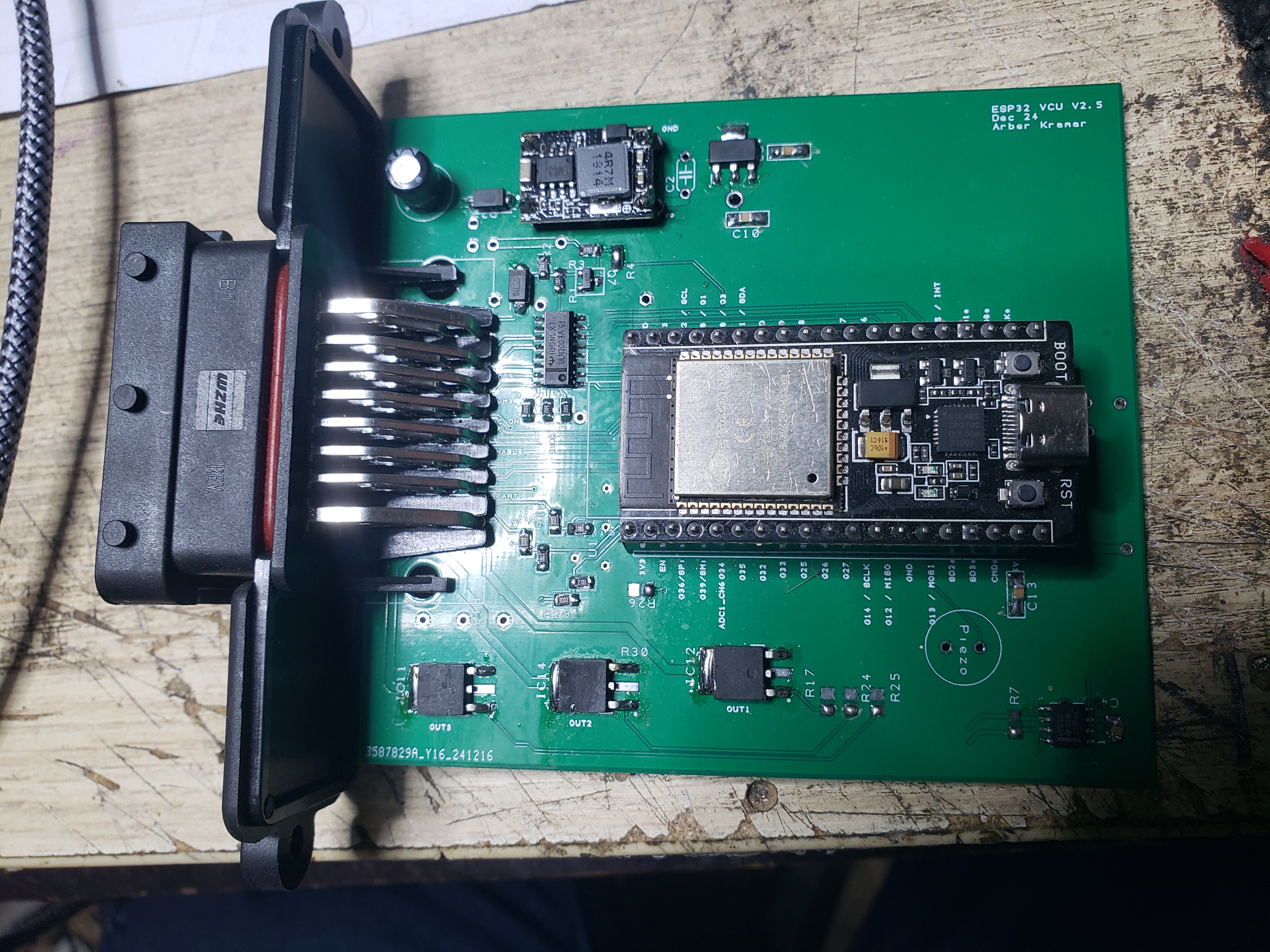

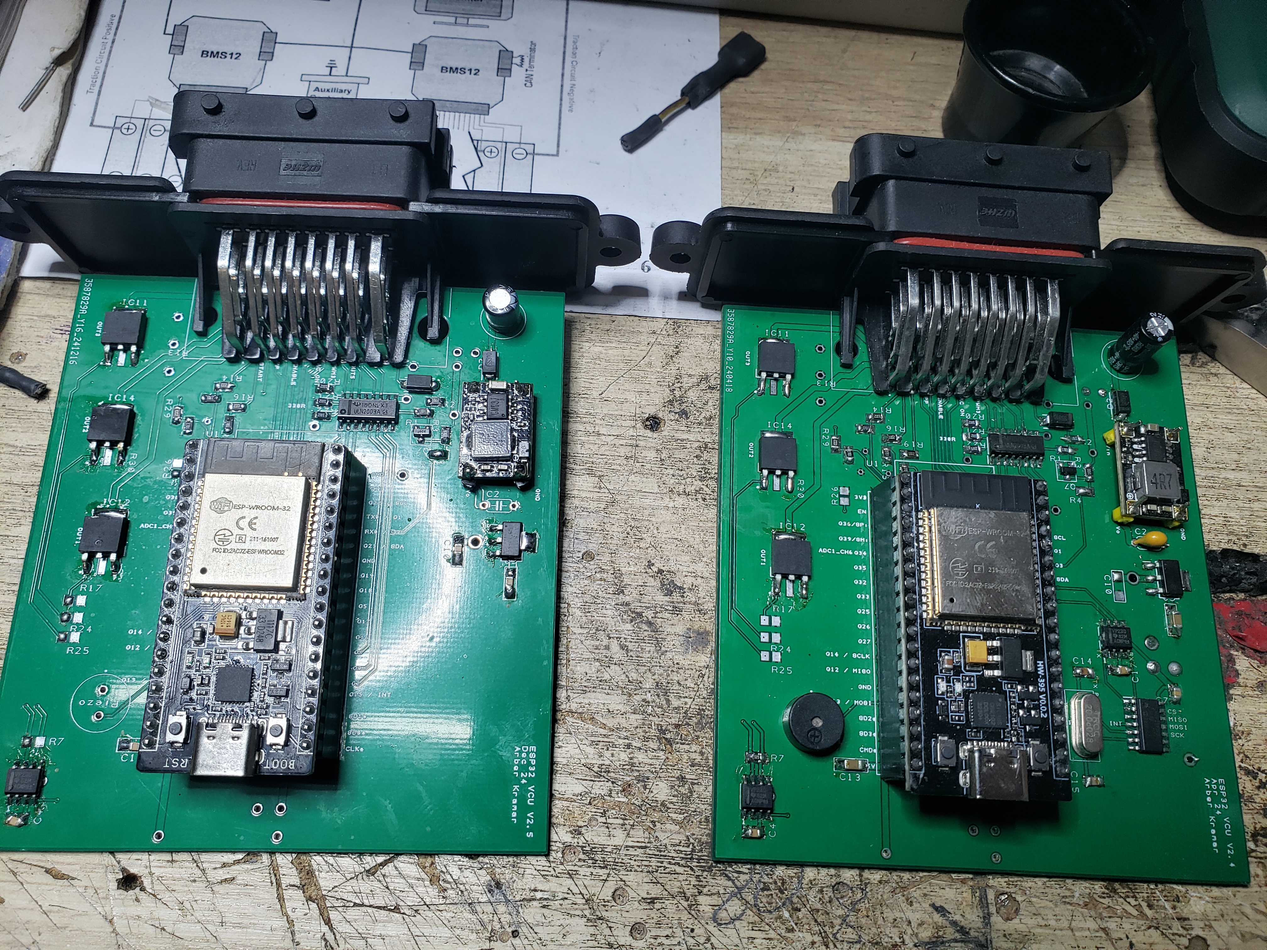

OutlanderTry wrote: Sun Jan 11, 2026 7:40 pm ########################
Very IMportant
I love the new 2026 calendar
where can i buy that ?
can you sendme ESP32 VCU interface
as pdf and schematic ?
I updated files in my ESP32 repository
https://github.com/arber333/ESP32-VCU/tree/main
Search for the latest version 2.4 and 2.5
2.4 is meant for application with 2x CAN ports controling chademo fast charging or receiving BMS updates
2.5 is simpler, only single CAN but it can drive more PWM outputs
I put schematic on paper somewhere and i would have to redraw it. I will add schematic at a later time. For now let the pcb file guide you :).
It was drawn with Designspark PCB.
There are also pinouts for VCU that i envisioned. You can certainly adapt them to your use...
If you want a single blank PCB board for testing i can quickly send you one...
