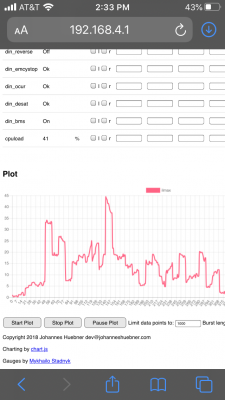

I have some updates-
1. I soldered the current input 5V connection and now have equal voltage on all test points and no more maxcurrent stop code.
2. I tested continuity between every pin on connector 10 and the corresponding devices on the schematic. No bad solder joints, everything checks out.
3. I tested voltage on the three pins 8, 16, 24 on connector 10. Those are the three temp inputs from each heatsink. Each gave a reading of 1.39VDC. Since each incoming voltage is equal I would assume they are giving the correct temperature signals so the toggling to a spike in temp reading causing the temp code is probably a software issue related to interpreting those temps.
4. I started the inverter with high voltage and without high voltage. In both scenarios a currentlimit derate code appears. Can we add this to the software checklist with the temp code? Does a different parameter that isn't ocurlim create the currentlimit code? If so what is it?
5. Attached is the max amps with the inverter running with and without high voltage. In the high voltage scenario I add throttle and get a max of 40 amps or so.
Hoping to get the software worked out so I can start the actual car install. Coding is out of my realm of knowledge so I can only help troubleshoot with runability tests if there are software updates to flash.
Thanks!

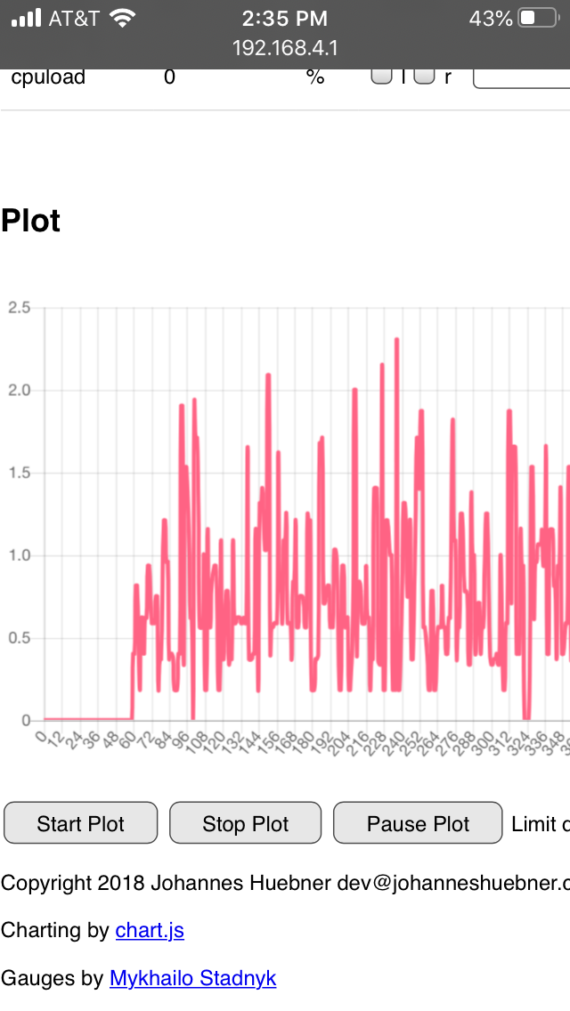

wigman, it seems johannes did find and correct something in the code; he posted a new draft of the firmware for testing in the Open Tasks thread that damien linked in earlier post.wigman wrote: ↑Tue Apr 07, 2020 1:47 am I have some updates-
Thanks!
I got it and tried it. Below is what I posted in that thread. I'll add it here for LDU users following this thread-
I just tested this verison-
1. The temp codes are gone and the graph reading looks normal!
2. One spot value changed from OK to ERROR- din_mprot. I tried my starter switch and even though I could see the signal incoming on a graph, the control board would not close the main relay. I went back to my previous version and verified that spot value was OK and my relay was still in working order. Something about the new code changed this.
Also, I posted in the other thread, but I was previously having currentlimit derate codes even when no HV was connected. Can I put in a task request to look at that issue as well. I can't tell if the new version has it or not because the relay won't close so it never goes into run mode.
