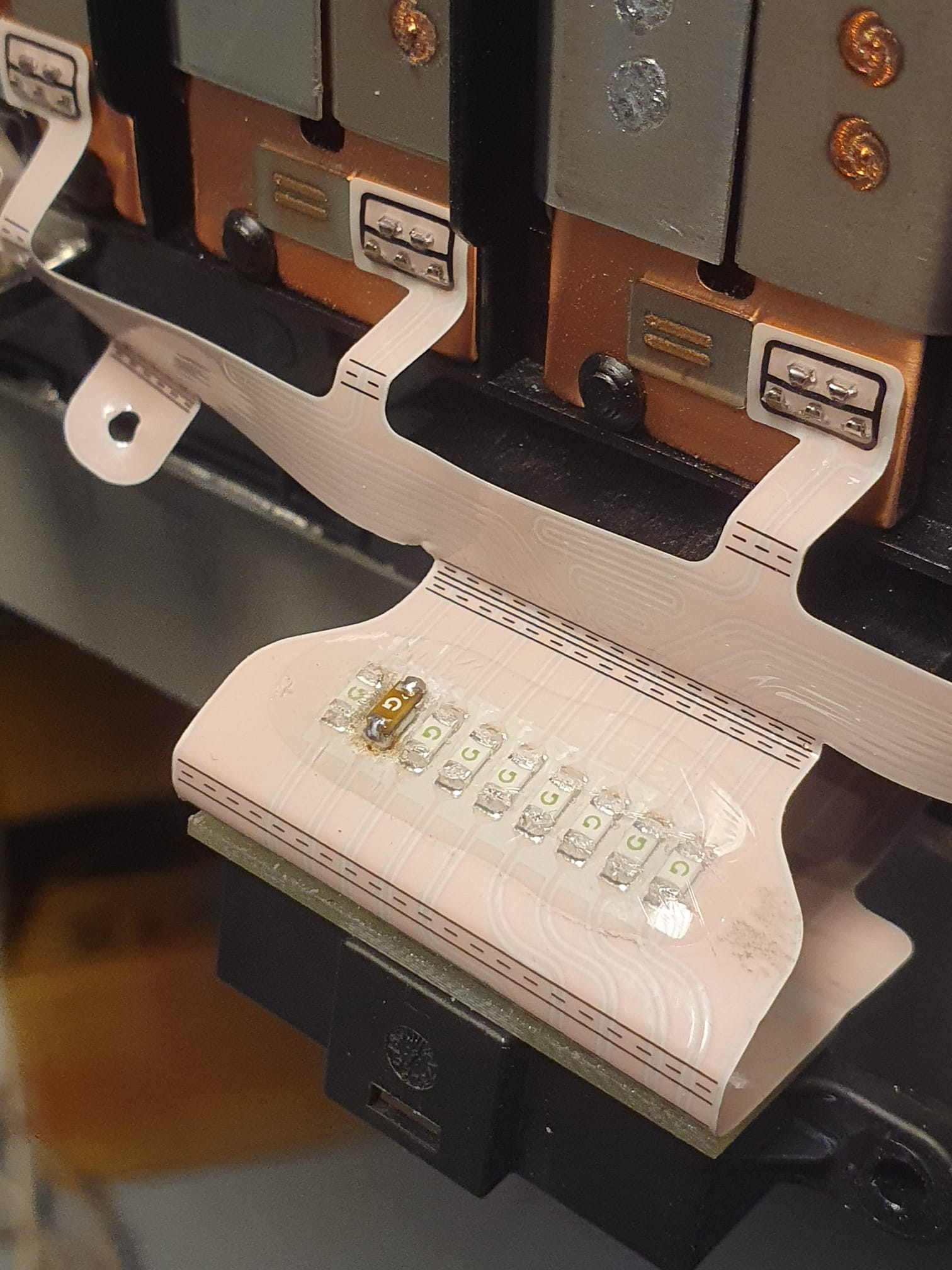

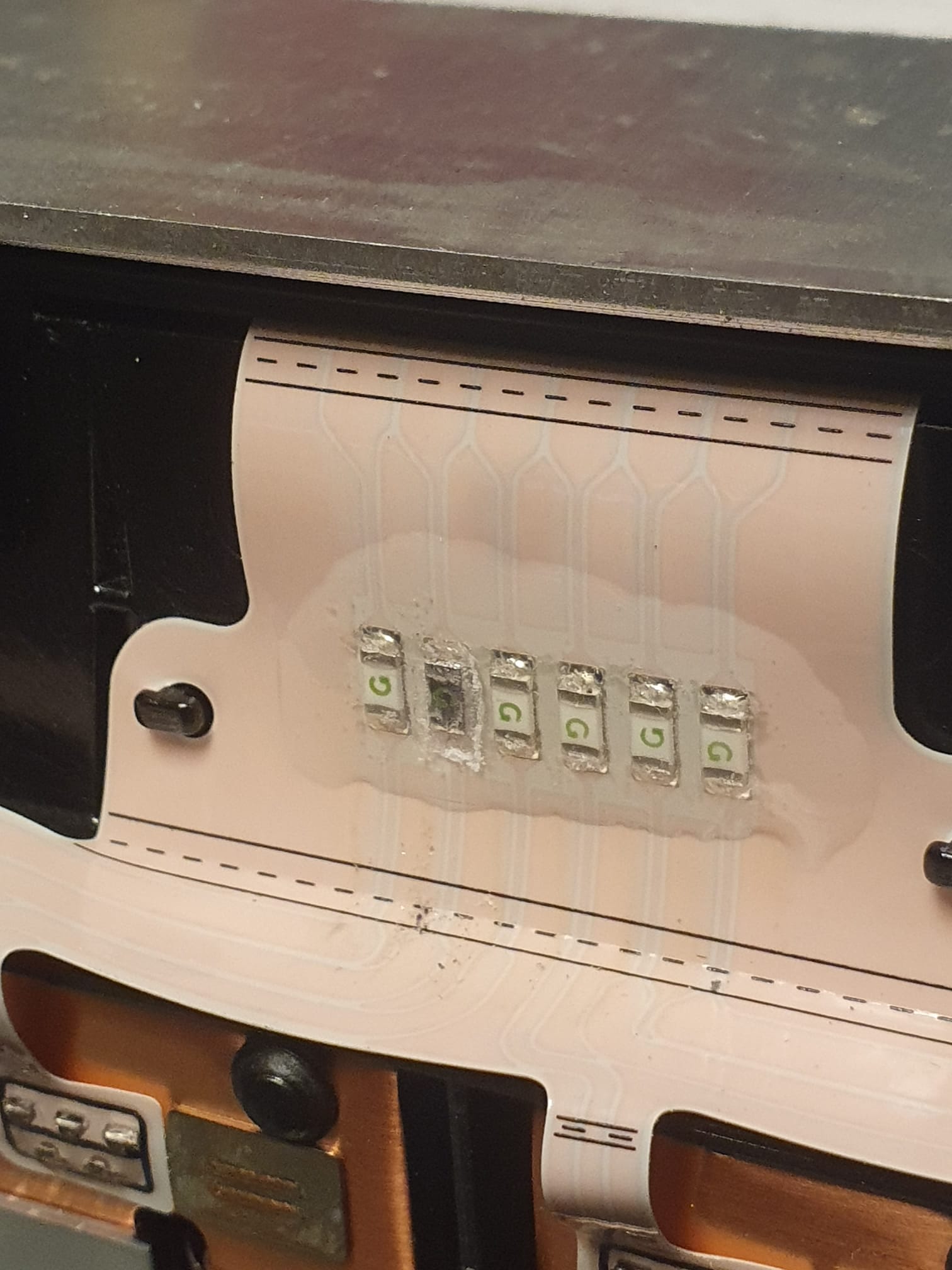

Do you have a log of this happening? I can take a look.skojon wrote: ↑Wed Mar 19, 2025 9:56 am Yes thats the code that i based on. Im sure im doing everything correctly. It just sometimes stops working. I noticed that it somehow depends on cell voltages. If they above 4V its disables, but when it drop, it starts balancing again. Do you know what cell charge and discharge voltages was in volkswagens?
Hi skojon, did you managed to sort this out? I am also facing similar bahaviour at one of the projects. below 4V seem balancing fine, but then it stops. Not sure if it is precicely the 4.0V, but anyway it stops at hig voltages. First i believed it was the delta getting too high, but manually balanced modules. Now delta is closer ~60mV, no difference.

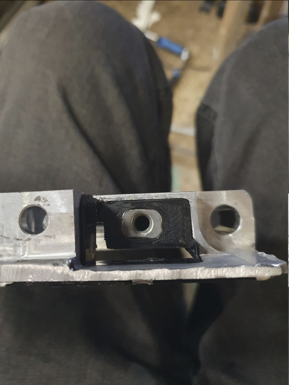

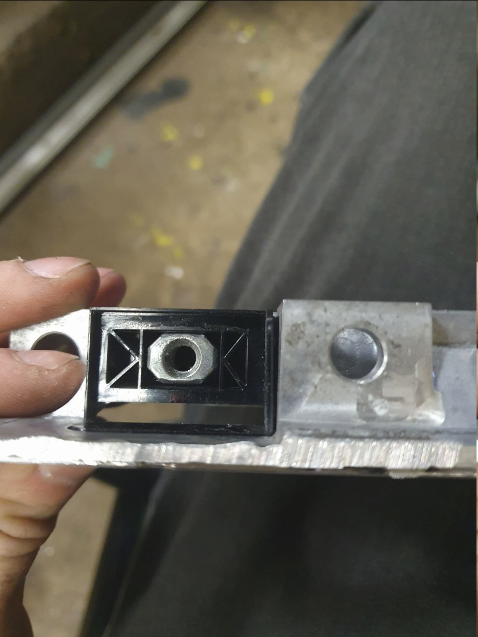

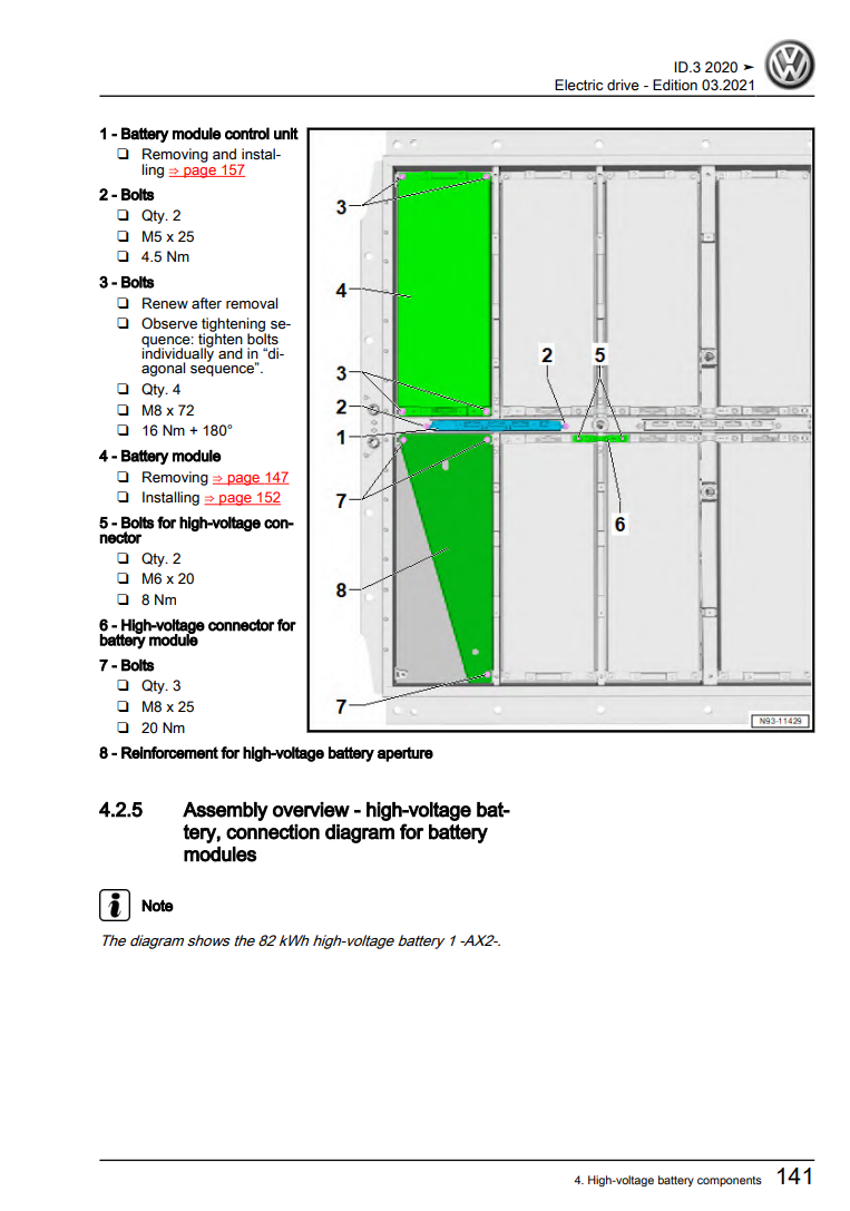

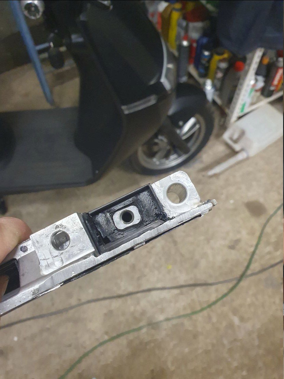

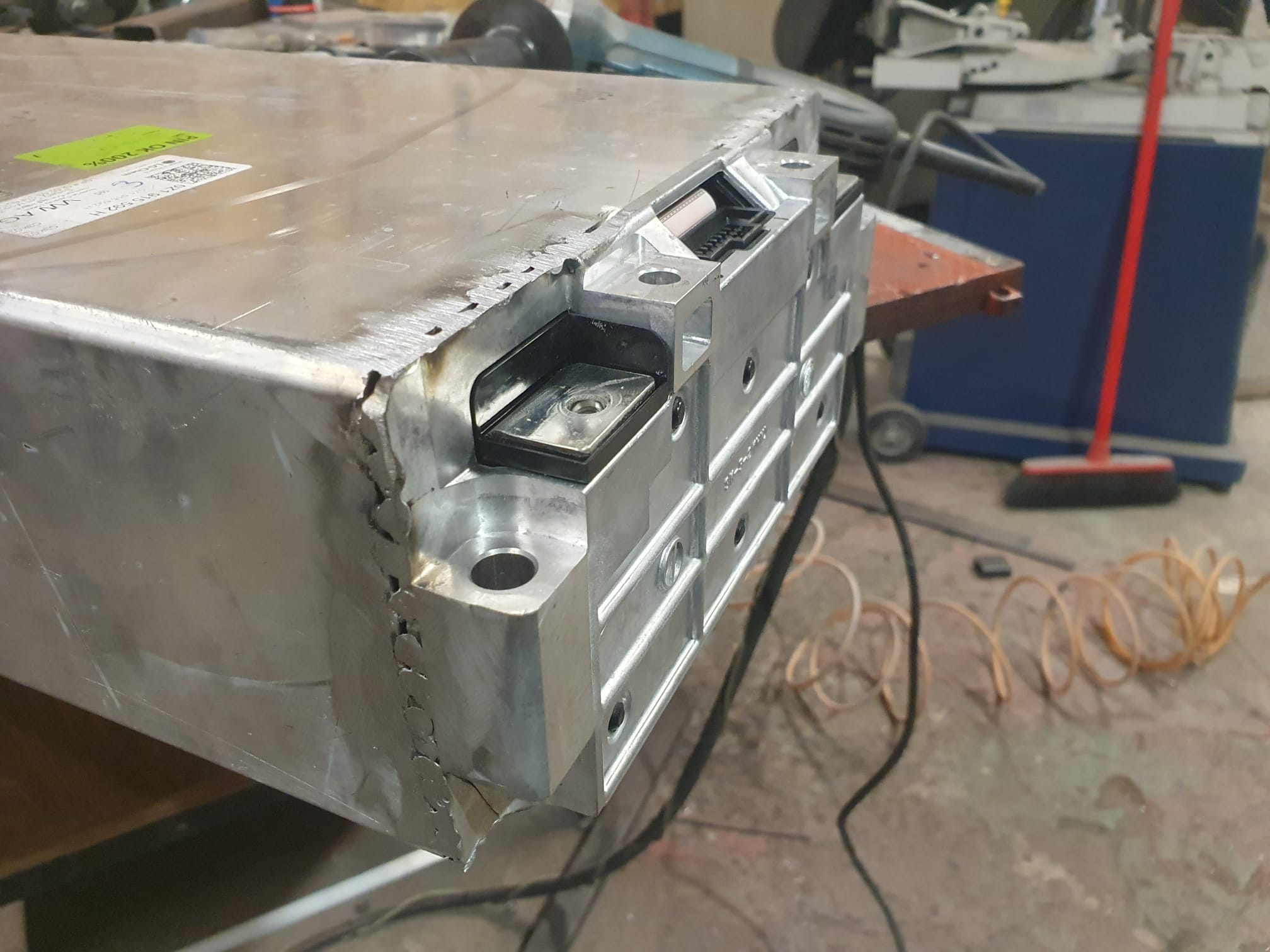

VW specs for cell module HV contact tighteningskr wrote: ↑Wed Jun 11, 2025 1:08 am Just a heads up for anyone building with MEB modules-
The captive nuts on busbars are designed in a way that excessive torque may make it start turning inside of the module
I would advise to use contact grease on these busbar connections, if you are afraid of the bolt coming out - a spring washer and/or a height limiting 3D printed cap could help here probably. If a bolt ever siezes there- it is pretty much game over for the nut holder. Use sane amounts of torque when tightening as well, don't be me.

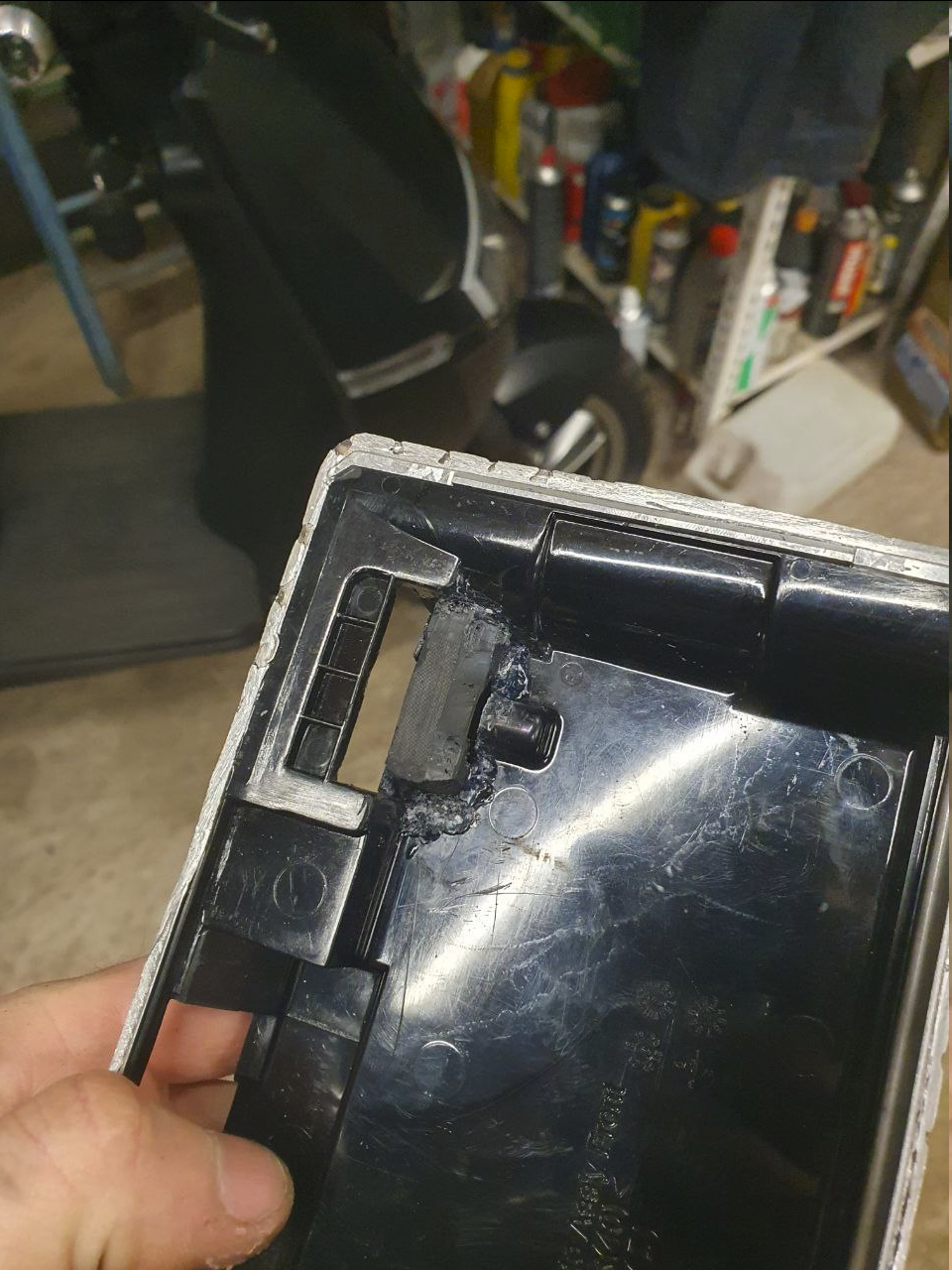

inside the battery cell... I would add my 20c here from empyrical testing....skr wrote: ↑Mon Jul 14, 2025 1:51 am .....
I went on to look at how much gas, what gas and what can actually be generated and what we can detect.
Majority of gas generation happens at first charge, gas generation dramatically increases above 4.15V~4.18V, below 4.15V it is even hard to detect.
For the 157Ah electrode area at average 300k km with very mild cycling approx half a liter of gas would be generated, if data from .3Ah cells scales realistically. Fast charging increases that a lot, I presume.
My research so far leads me to think it is perfectly normal that a module you cut open at the ends smells in a detectable manner. As I posted above from my "repairs" - I tacked the lids at various positions leaving a lot of gaps for molecules to come out, maybe what I am smelling is those gaps. It is possible that some of that smell is ofgassing of various chemicals used in the module production, not the cell production.
I will calibrate my nose with kinetically persuaded pouches to compare to the faint smell I feel from my battery bay.

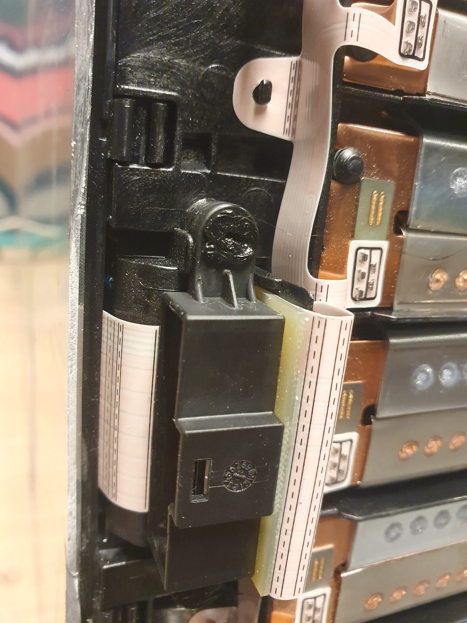

Hi all,tom91 wrote: ↑Tue Mar 18, 2025 6:10 pm Yes I had similar issues, so did a customer and so did someone else I spoke to.
No real idea why it did not work, it worked fine then it stopped. Swapped the CMU (cell monitoring unit) and it immediately worked again.
Someone else even just plugged the same CMU back in and it worked again too. So no idea what it was maybe bad or loose connection.
