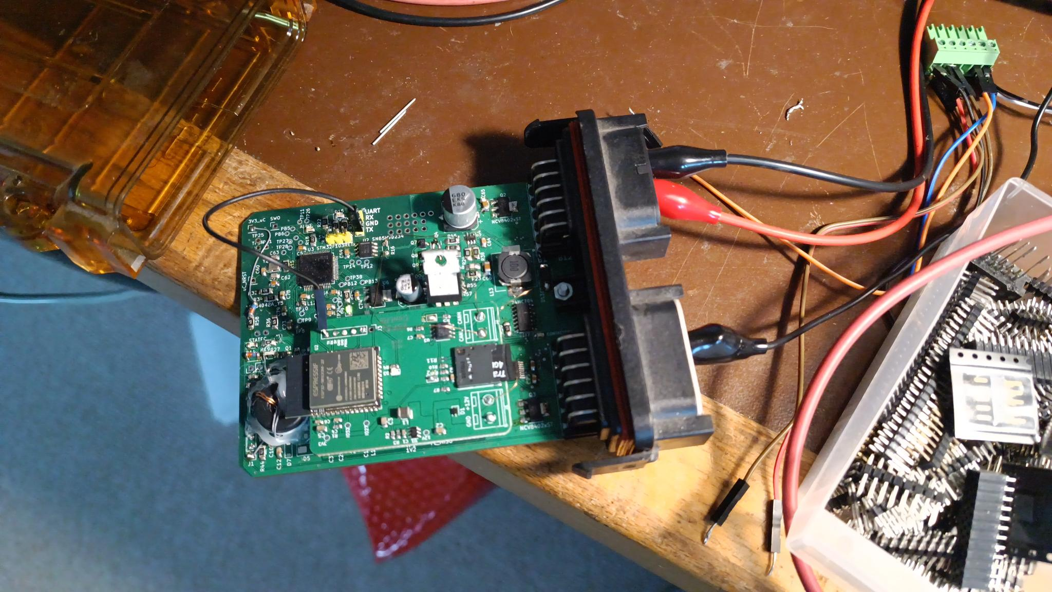

So it seems like I have (at least partially) killed my Foccci with over voltage.
I recently added the changeover relay between stationary battery and EVSE connected one.
I am currently travelling and the relay was connected to the stationary battery. That means the small HV source hasn't got anything to work against that stops the voltage from going sky high. I wouldn't be surprised if it reaches multiple kV with the way I have it set up right now.
My wife decided to plug in the car because it was quite sunny. I saw the state machine reach Precharge and then it dropped back to off. After that I could not get any communication going anymore. plctools still find the EVSE modem so that seems fine.
My wife then drove to the shop and reported the EPC signal was blinking. That is very unusual as the EPC light reacts to the P-FET that is switched on when PP goes low.
So not 100% sure what is damaged and why. Maybe the high voltage somehow made it over to the PFET and killed it on some weird way that it now blinks? Or it traveled through the temperature sensors that have good thermal connection to the HV pins.
This is an old revision Foccci with no protection on PP. So this might not have any implications for current revisions. Quite sure I need to swap the board though

Following up on that it turned out Foccci is fine, only the FET haf failed. So I replaced it and now it broke again on our long road trip
Worked fine in the morning then broke during handshake on the next charge stop.
Replacing it with a physical switch so we can drive on. Will probably swap in a fresh Foccci when back home

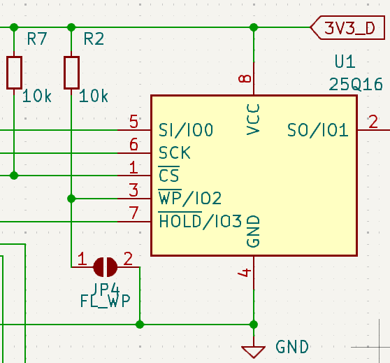

- Been thanked: 1913 times
Re: Develop a QCA7000 board?
Somehow doesn't sound like pulling /WP low will write protect the flash as-is:
and reading on it isThe Write Protect (/WP) pin can be used to prevent the Status Register from being written. Used in
conjunction with the Status Register’s Block Protect (CMP, SEC, TB, BP2, BP1 and BP0) bits and Status
Register Protect (SRP) bits, a portion as small as a 4KB sector or the entire memory array can be hardware
protected. The /WP pin is active low.
That should do it: Close JP4 after programming flash and see if we're still good. Maybe I'll try beforehand on an older boardAfter power-up the device is automatically placed in a write-disabled state with the Status Register Write
Enable Latch (WEL) set to a 0. A Write Enable instruction must be issued before a Page Program, Sector
Erase, Block Erase, Chip Erase or Write Status Register instruction will be accepted. After completing a
program, erase or write instruction the Write Enable Latch (WEL) is automatically cleared to a write-disabled
state of 0.
Tested this all in reality today and simply pulling down /WP does nothing at all. It only prevents the ability to change the write protection, but the actual write protection itself takes place in the chip.
And that is good news, because it means: no HW change!
When programming the flash chip we simply issue the command
Of course after programming the image.
I tried it by setting the USR string (defaults to YURA CCM SOP DEFAULT) to PEV and indeed the change is now rejected. Before it was possible.
Charging itself still works as before.
Maybe the QCA chip could be instructed to do the same and maybe the QCA chip can be instructed to remove write protection. In the latter case we'd indeed need to pull low the /WP pin. But this is already an improvement.
