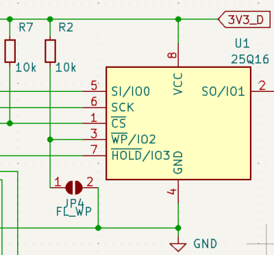

Somehow doesn't sound like pulling /WP low will write protect the flash as-is:
The Write Protect (/WP) pin can be used to prevent the Status Register from being written. Used in
conjunction with the Status Register’s Block Protect (CMP, SEC, TB, BP2, BP1 and BP0) bits and Status
Register Protect (SRP) bits, a portion as small as a 4KB sector or the entire memory array can be hardware
protected. The /WP pin is active low.
and reading on it is :)
After power-up the device is automatically placed in a write-disabled state with the Status Register Write
Enable Latch (WEL) set to a 0. A Write Enable instruction must be issued before a Page Program, Sector
Erase, Block Erase, Chip Erase or Write Status Register instruction will be accepted. After completing a
program, erase or write instruction the Write Enable Latch (WEL) is automatically cleared to a write-disabled
state of 0.
That should do it:
Close JP4 after programming flash and see if we're still good. Maybe I'll try beforehand on an older board
Posts: 6968
Has thanked: 454 times
Been thanked: 1771 times
Re: Develop a QCA7000 board?
Tested this all in reality today and simply pulling down /WP does nothing at all. It only prevents the ability to change the write protection, but the actual write protection itself takes place in the chip.
And that is good news, because it means: no HW change!
When programming the flash chip we simply issue the command
flashrom -p linux_spi:dev=/dev/spidev0.0,spispeed=2000 --wp-range=0x00000000,0x00400000 --wp-enable
Of course after programming the image.
I tried it by setting the USR string (defaults to YURA CCM SOP DEFAULT) to PEV and indeed the change is now rejected. Before it was possible.
Charging itself still works as before.
Maybe the QCA chip could be instructed to do the same and maybe the QCA chip can be instructed to remove write protection. In the latter case we'd indeed need to pull low the /WP pin. But this is already an improvement.

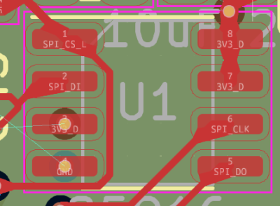

catphish
Posts: 965
Location: Dorset, UK
Has thanked: 99 times
Been thanked: 195 times
Post by catphish »
uhi22 wrote: Fri Oct 25, 2024 8:45 pm Is it possible that they can selectively control the amount of solder paste?
The solder mask (the area the solder can spread into, F.Mask) and the paste stencil (the area they actually apply the paste to, F.Paste) are separate files that you generate and upload. If you want less solder, just make the paste aperture (ie the area of the rectangle on the F.paste area) smaller. In kicad, you can adjust "clearance overrides" on the properties for a pad.
