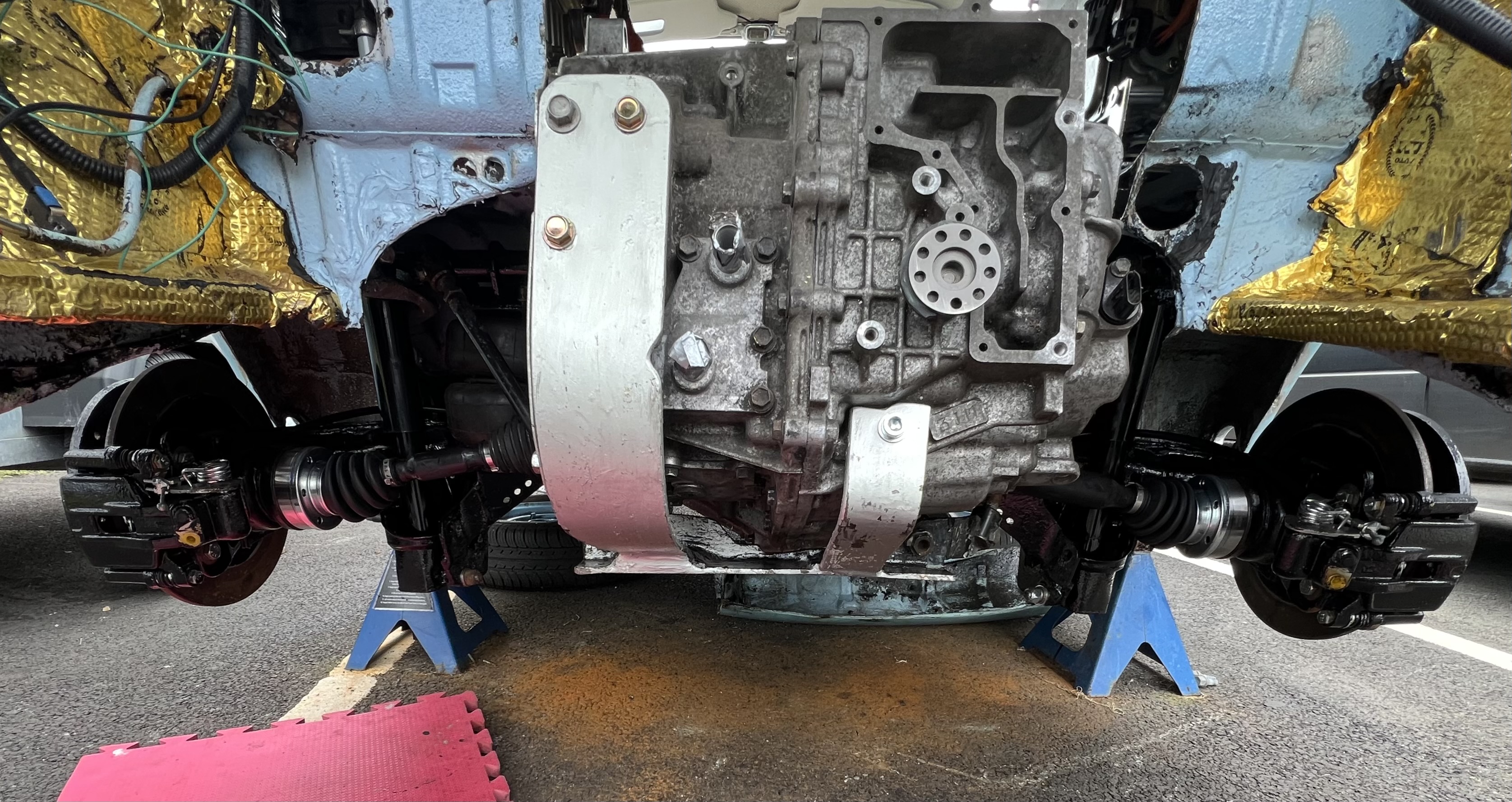

Unlocking the power/torque of Prius gen 3 drive train?

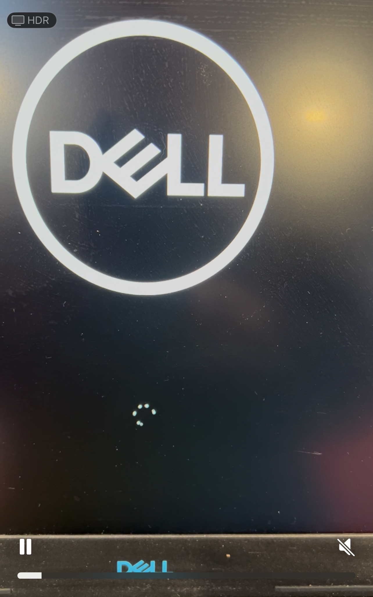

Sorry Tom.
Went yesterday to the shed for a test run but the laptop decided that it wasn’t going to open until Windows 11 installed, so no joy!

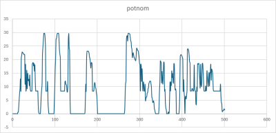

I went out with my grandson (handling the logging) and we had a very good drive!
Accelerator is much more receptive.
Regen is brilliant!
Didn’t get above 104kph

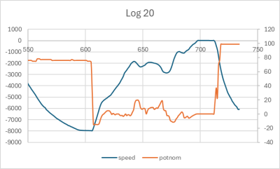

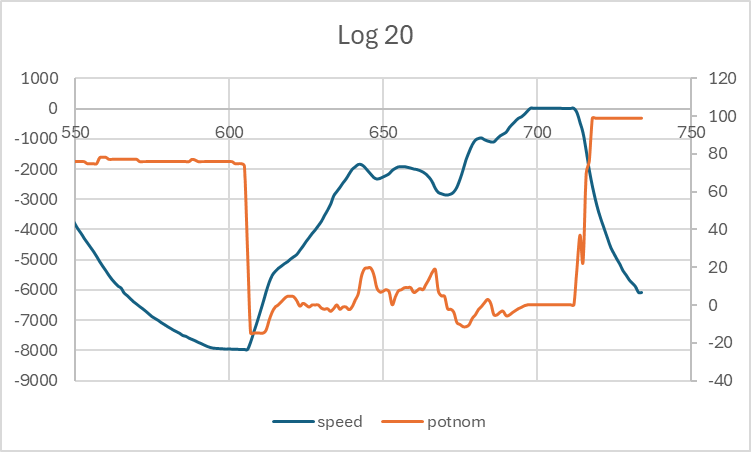

log (20).csv
(46.56 KiB) Downloaded 30 times
Posts: 2962
Has thanked: 328 times
Been thanked: 847 times
Re: Unlocking the power/torque of Prius gen 3 drive train?
Your 8000 revlim seems to still be present. Is that param increased correctly?
Small note on log, we need idc andnot INVudc :)

Thanks Tom, revlim set to 13,000

Look from the data we indeed have reached some sort of Toyota internal Rev limit.
Potnom (throttle) flat and speed stays flat

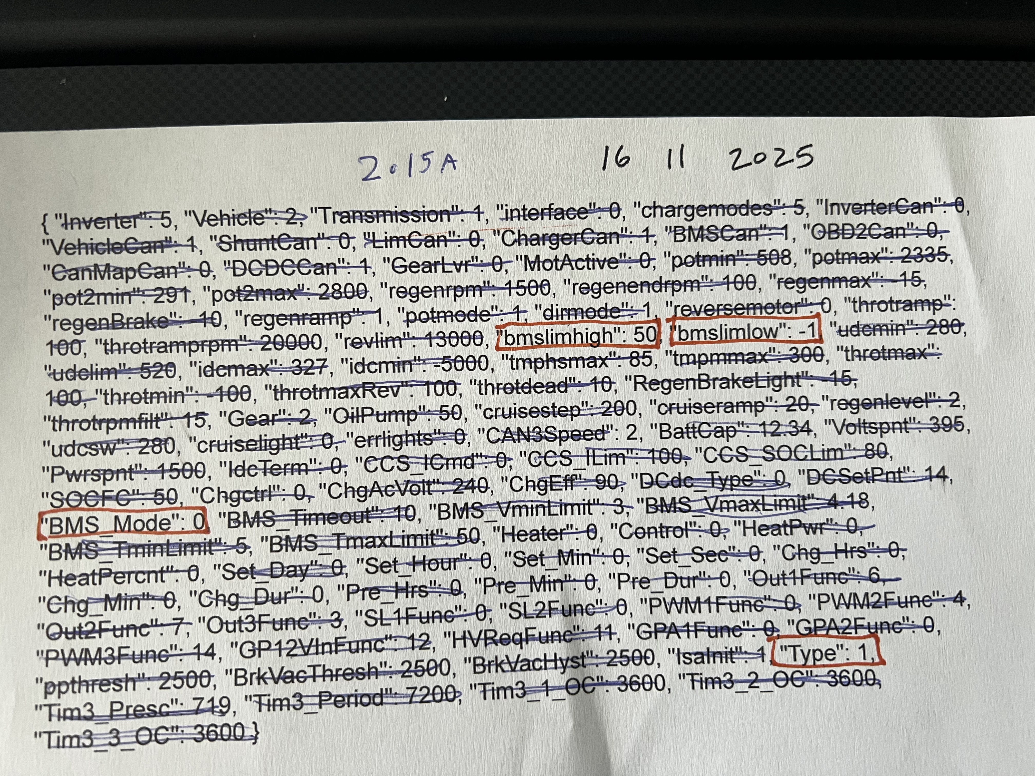

Here are the parameters from the last drive
params (16).json
(1.96 KiB) Downloaded 22 times
Battery pack is fully charged
Any changes required before next test drive?

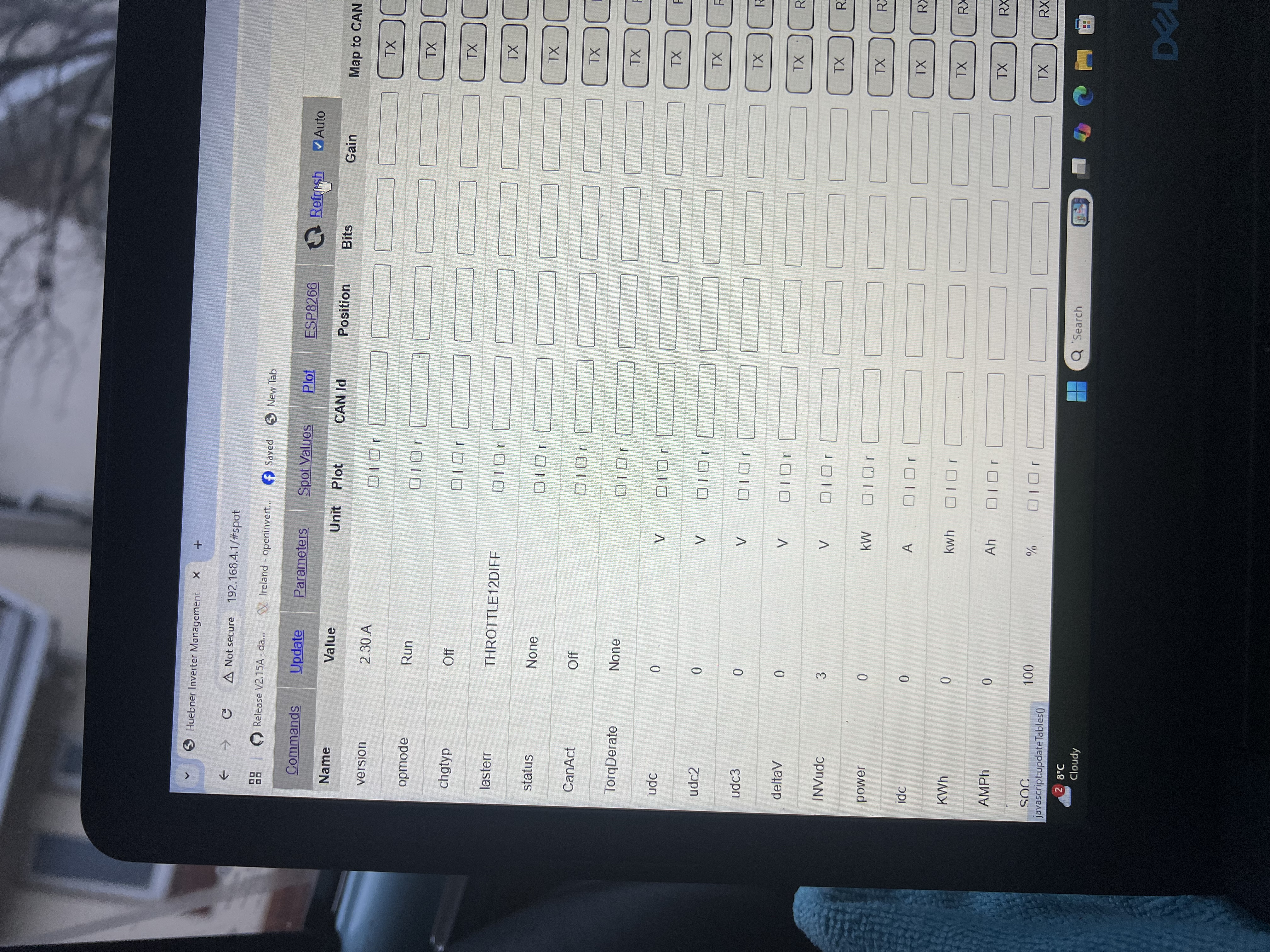

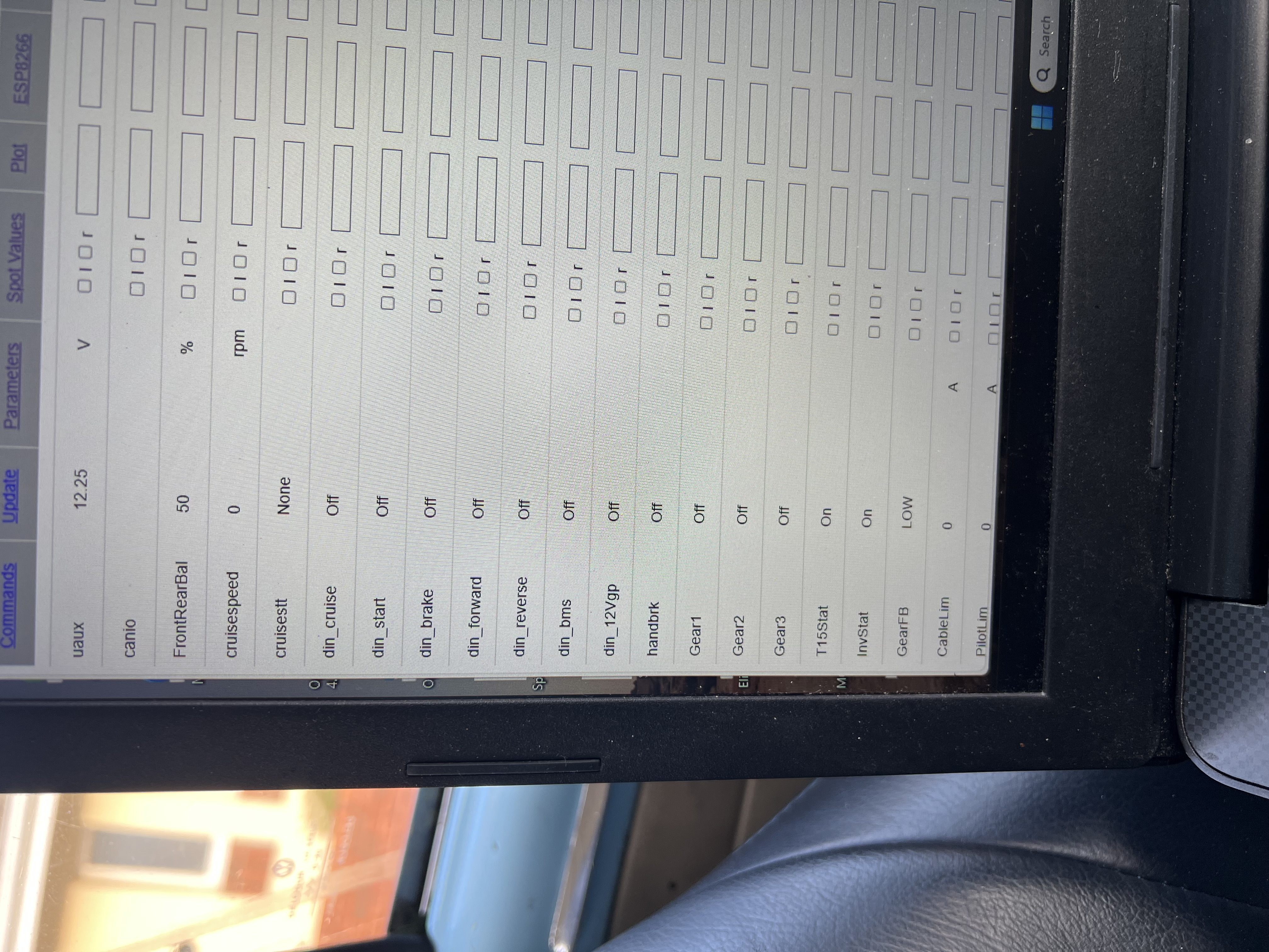

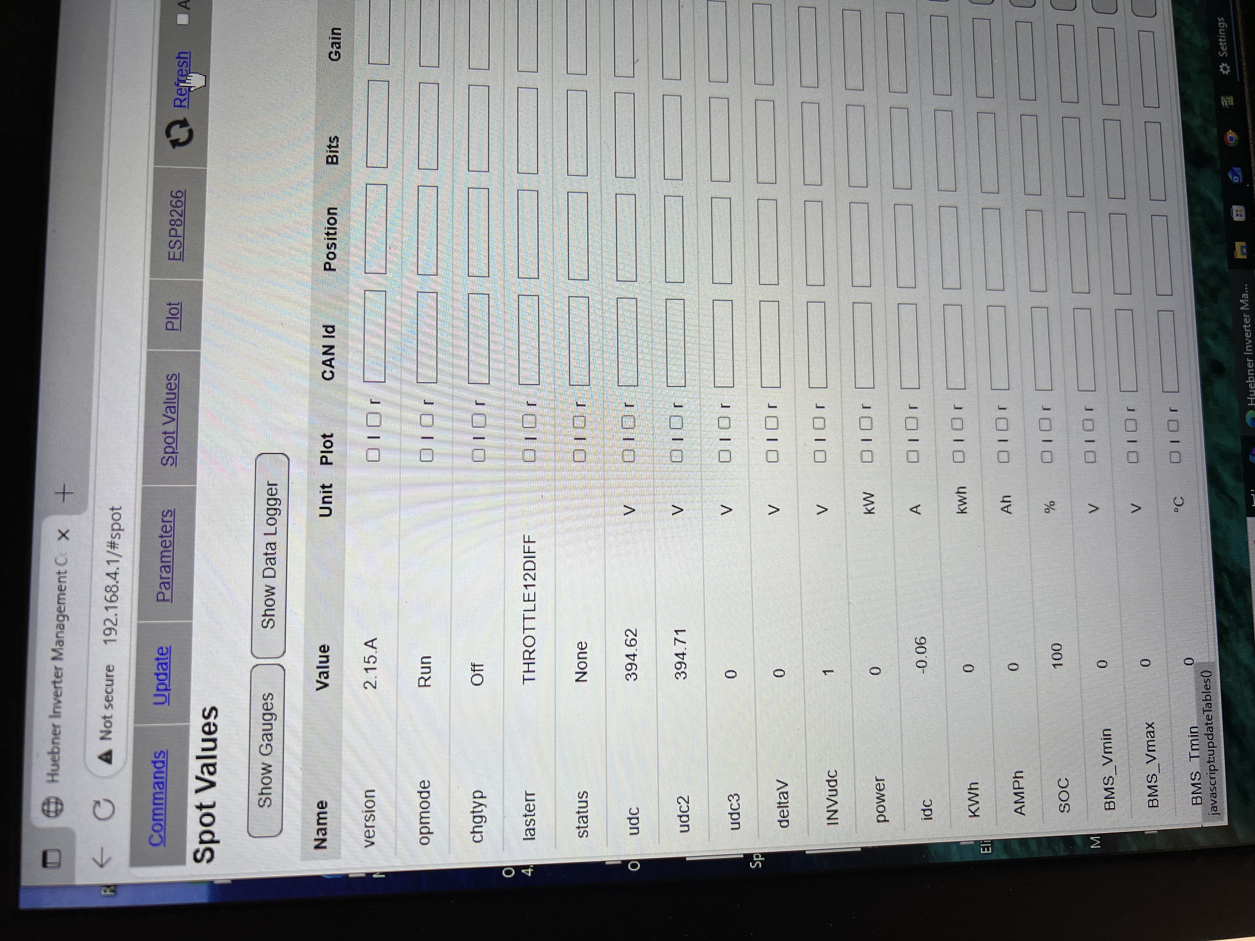

Just updated to 2.30A and then uploaded my saved parameters.
Had to then change from ISA shunt to BMW safety.
I noticed that drive is now reverse and reverse is now drive on my gear stick.
Unfortunately the car now doesn’t move… what have I missed?
log (26).csv
(3.97 KiB) Downloaded 4 times
Posts: 2962
With a direction selected to you see the potnom param increase when plotting it?
Posts: 2962
You logs indicate that selection a direction generates a torque request. This is strange, did you fully power cycle (12V removed from everything) after the update?

Ghia66 wrote: Mon Dec 29, 2025 2:32 pm Yes, I removed 12volt and then restarted.
I thought it strange!
So even after a 12V power cycle it does not work.
Can you please try a release that is older? like V2.22A or 2.20A It is possible a change I made for the testing Greg was doing in his VW Rabbit causes issues for your setup.
