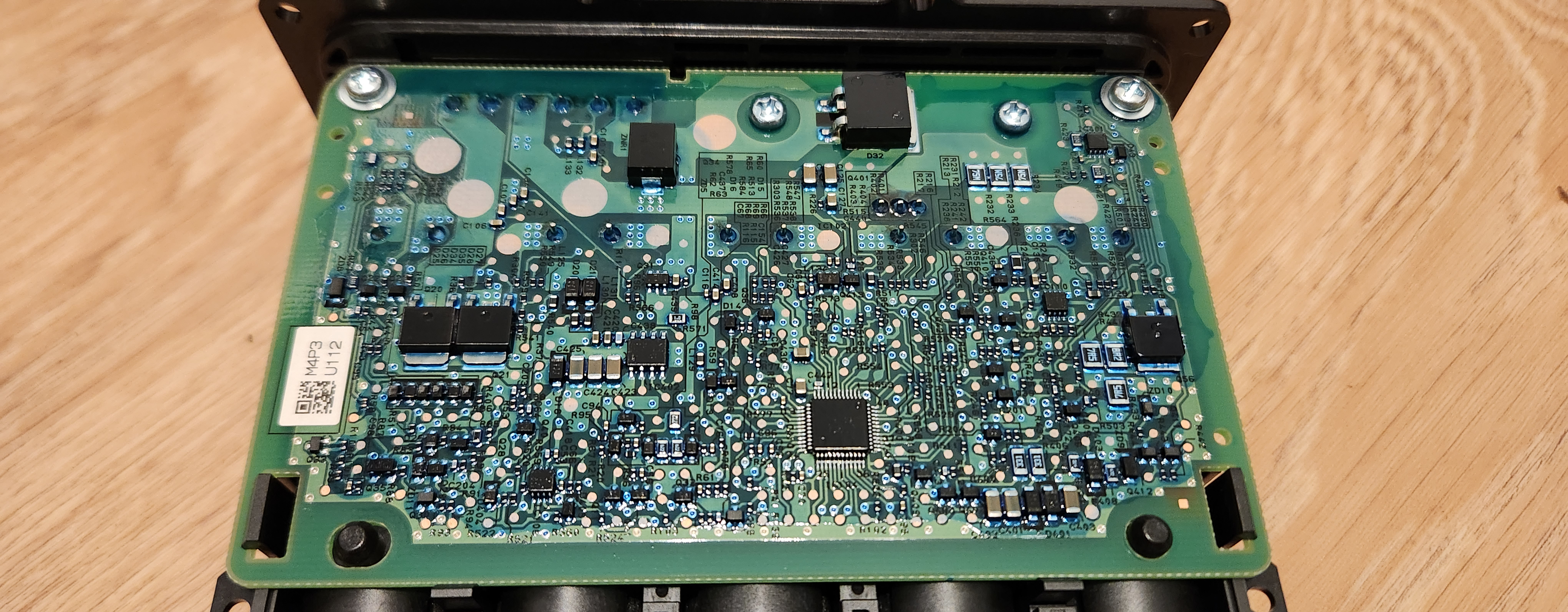

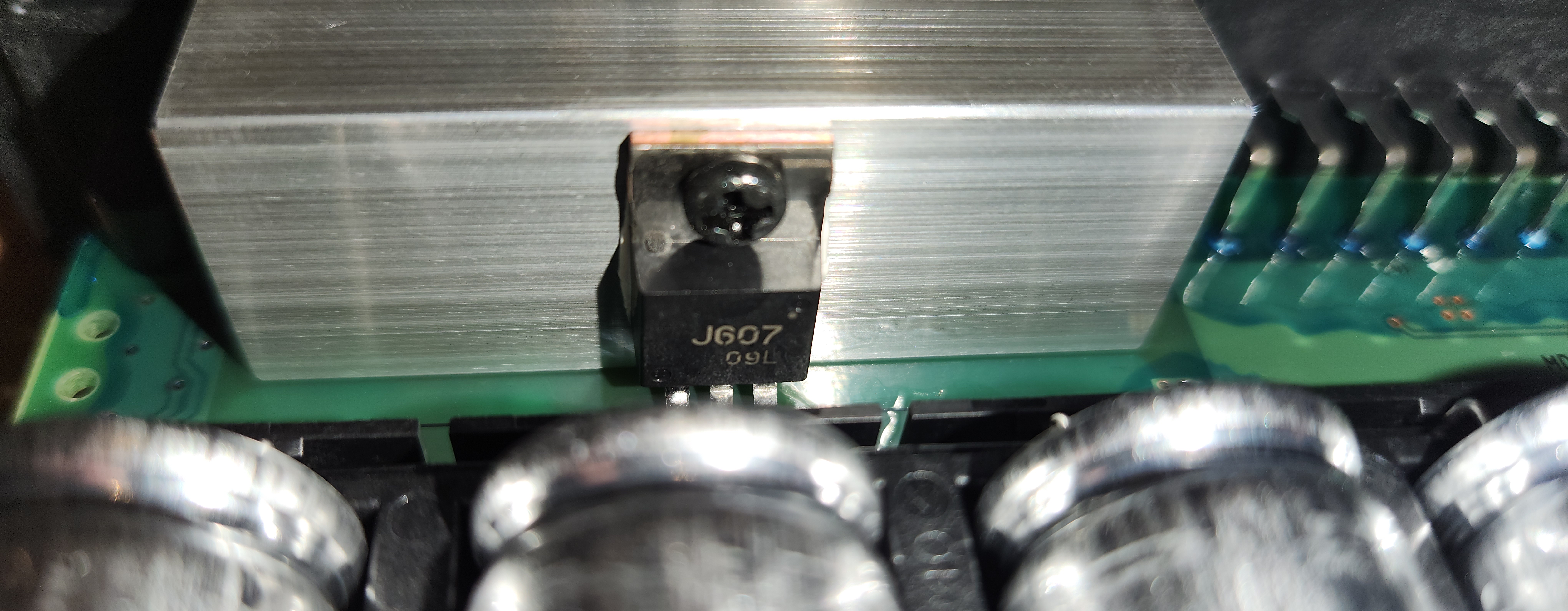

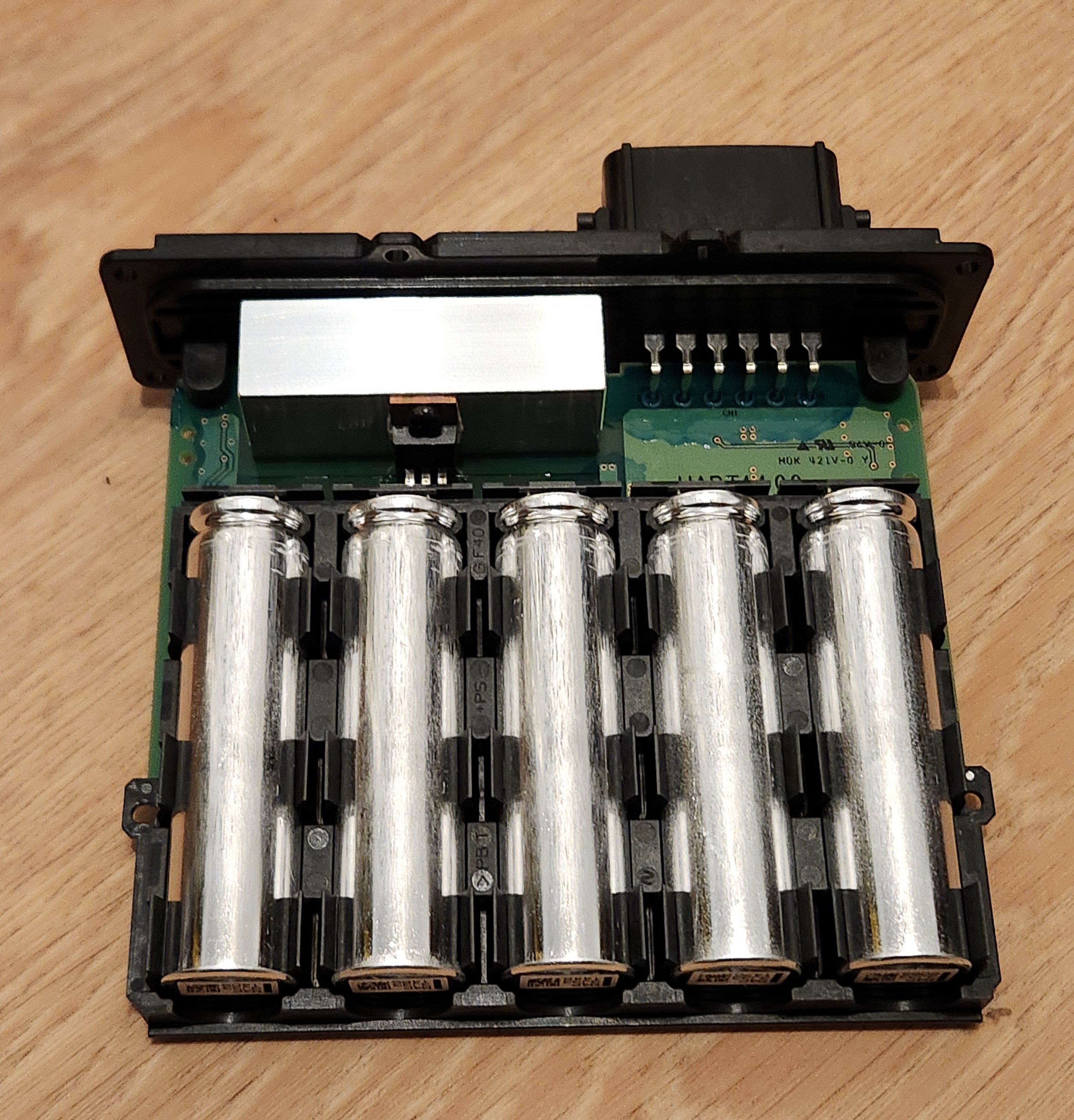

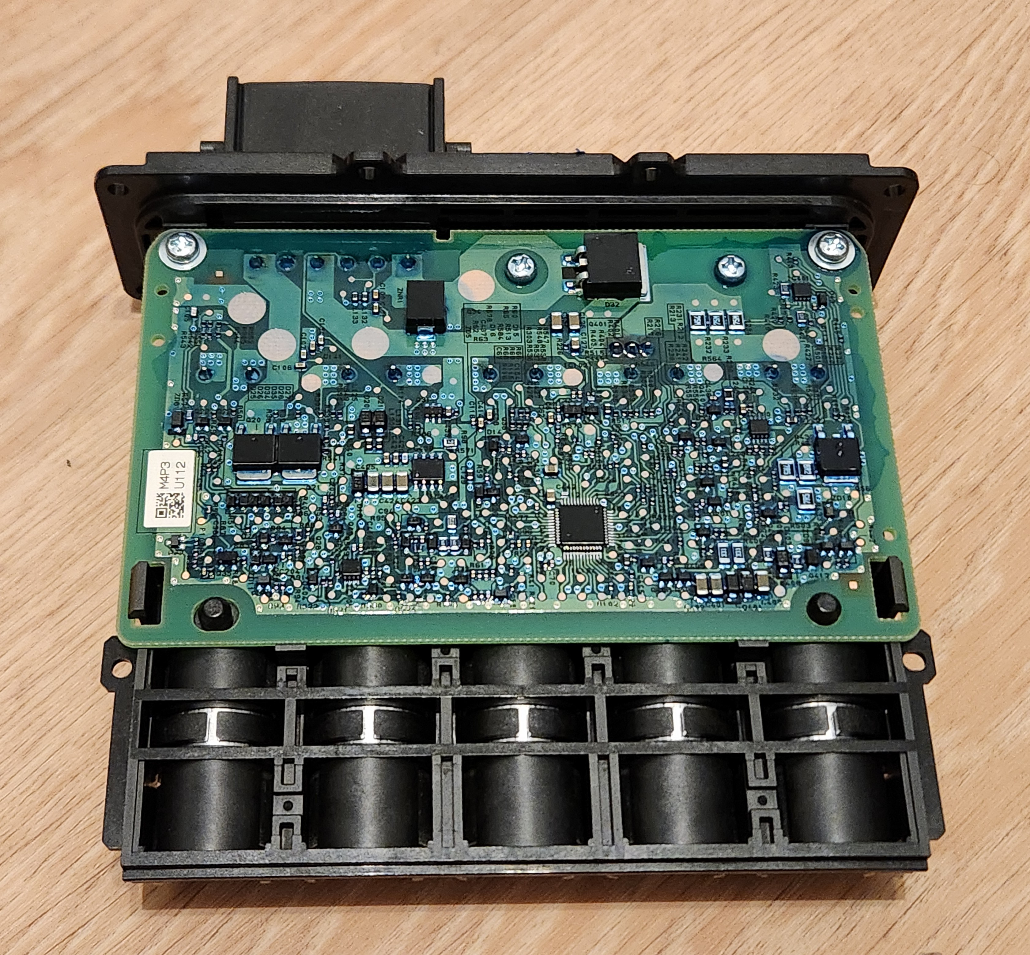

peakPWR
Posts: 35
Joined: Tue Dec 17, 2024 6:49 am
Has thanked: 6 times
Been thanked: 13 times
Re: Yaris Gen4 iBooster Gen2
Post by peakPWR »
itiuk wrote: Fri Jan 03, 2025 8:47 pm I might buy a second one to tear apart if sniffing is unsuccessful.
I took one apart and the safety power supply part is kind of obvious:
itiuk
Posts: 28
Joined: Tue Jan 16, 2024 12:36 pm
Has thanked: 9 times
Post by itiuk »
peakPWR wrote: Tue Nov 25, 2025 5:21 pm I took one apart and the safety power supply part is kind of obvious:
Wow, very nice! Thanks for doing that! Can you tell whether those ultracaps or cells?
As I learn more about these systems (dealing with them at work...) I now understand that they are primarily used as power modules to avoid voltage dropout during high draw events of the associated doohickey (i.e. when the iBooster draws high current under high load, the 12V supply in general doesn't get negatively affected).
peakPWR
Posts: 35
Post by peakPWR »
I'd say these are supercaps. But I can't say what capacity as there are no labels and I did not desolder one to test.
