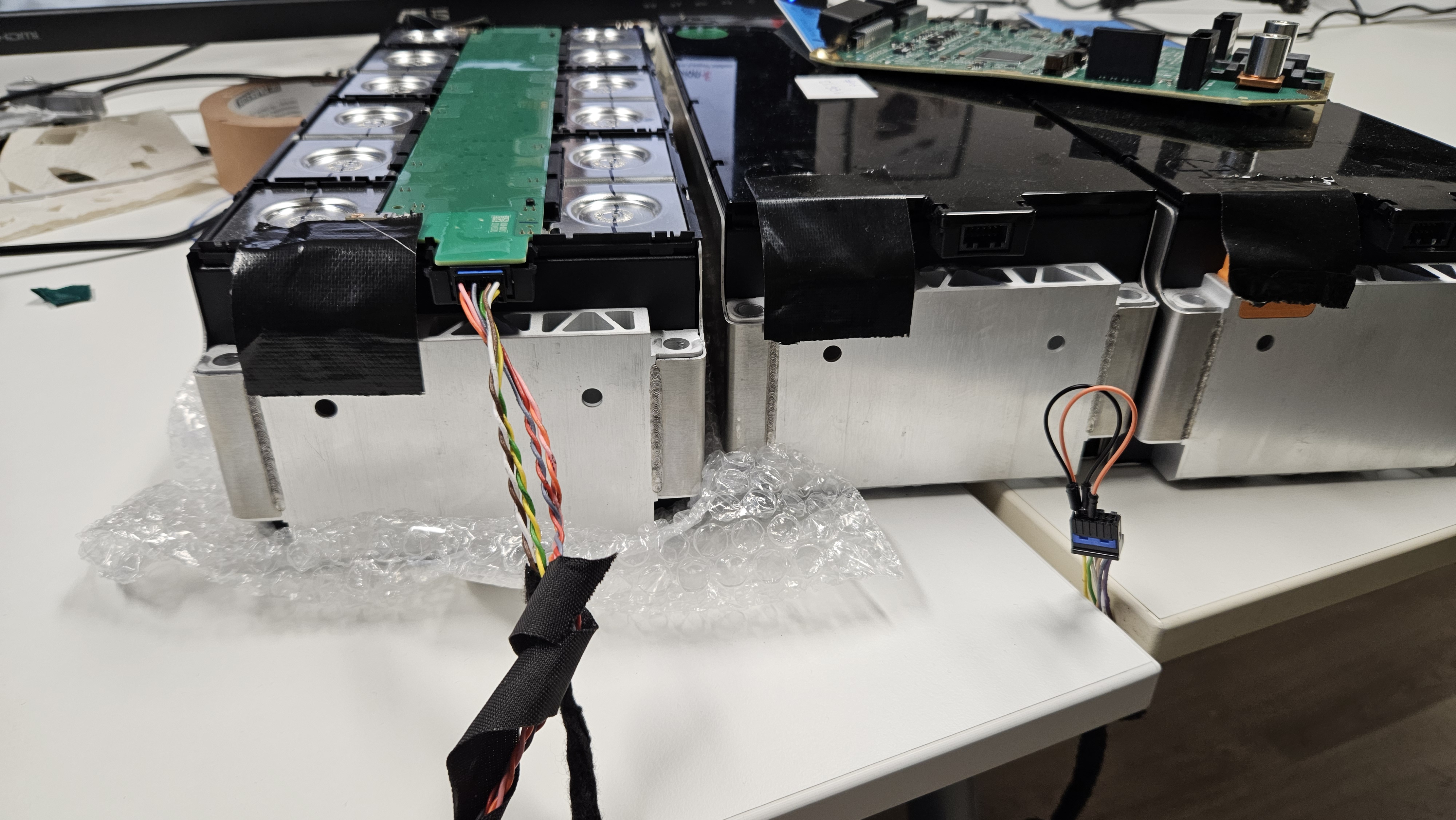

Im currently working on my project with A Peugeot E-208 battery pack. The modules use MAX17854 chips and I use the PCB design from Manny with Arduino pro mini, MAX17841B along with BMS2_7_4.ino code, but I running into a problem where the serial monitor says:
errorByte cleared writeAll
transmitQueue WD timeout
2
Then transistions into:
WRITEALL fail
6
Could someone help me figure this out? I have no clue what it could be. Thx in advance!

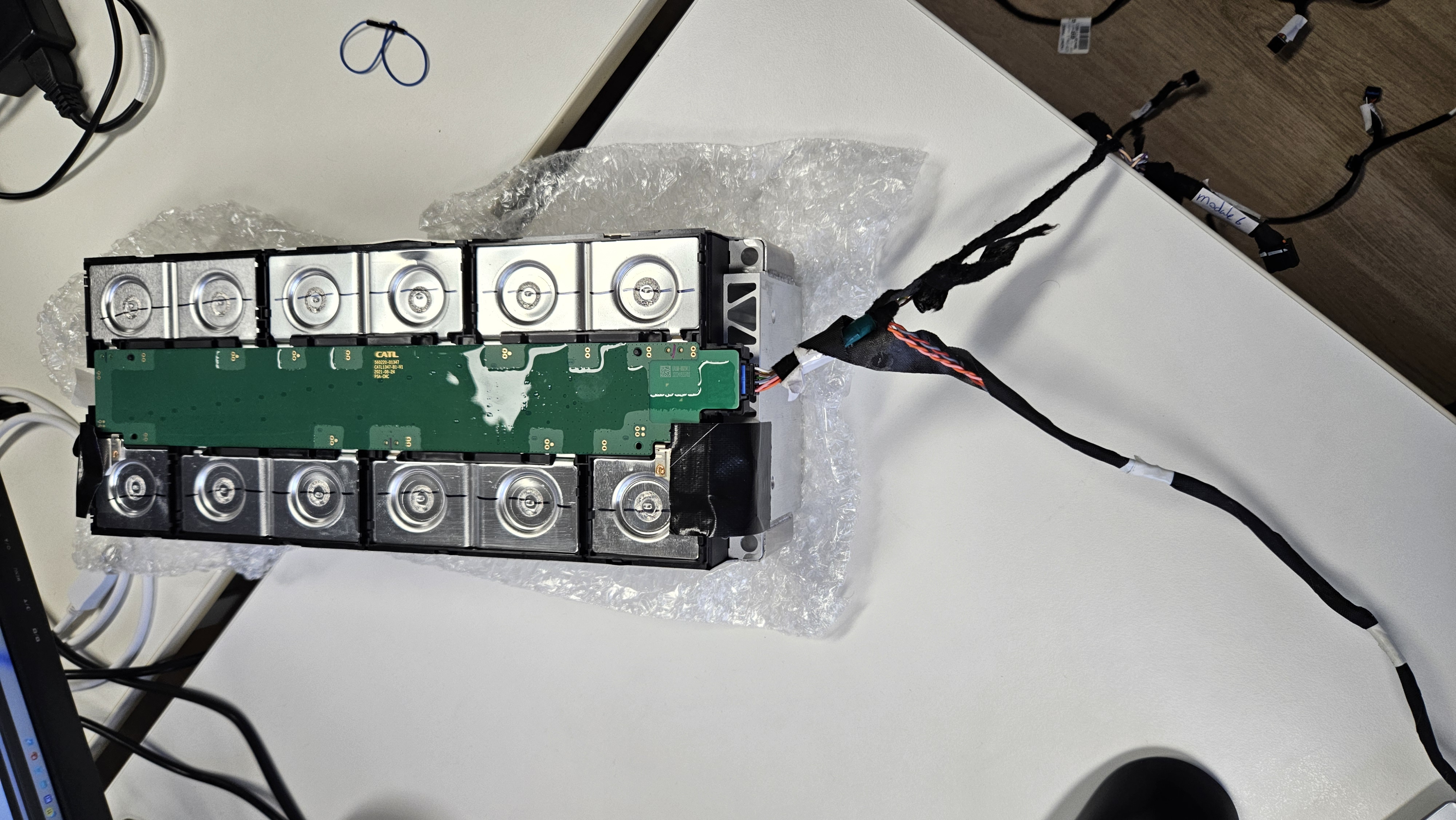

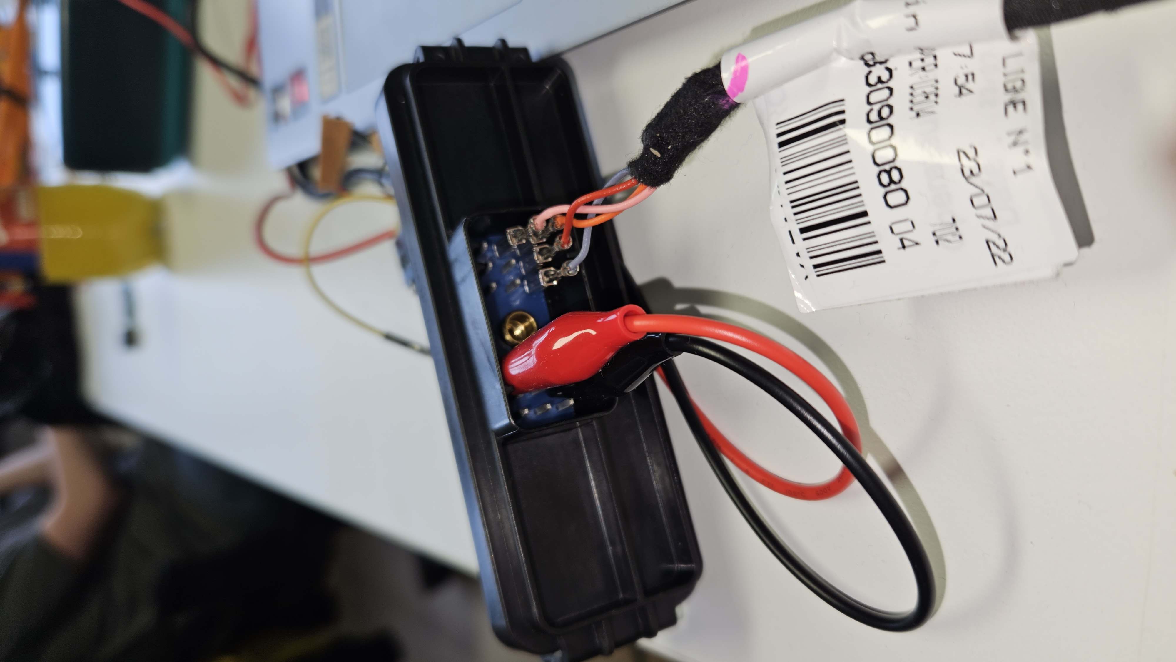

I have currently one module connected which has 6 cells and im using the original wiring harness from the E-208 pack. I have also changed that in the code to my setup. Im using a ATmega328P (5v, 16MHz).
The wiring harness pinout I got was from a document "Manual CMC Devices". In that document are a couple pinout listed for the Tycan, Kona, E-208/E-Corsa and Fiat e600 (See attachment). I tested with a DMM for continuity and all the cables were fine. I connected TXLP/TXLN -> RXLP/RXLN and RXLP/RXLN <- TXLP/TXLN. I think the MAX17854 is powered by the module? Module is fine sitting at 3.6v each cell.

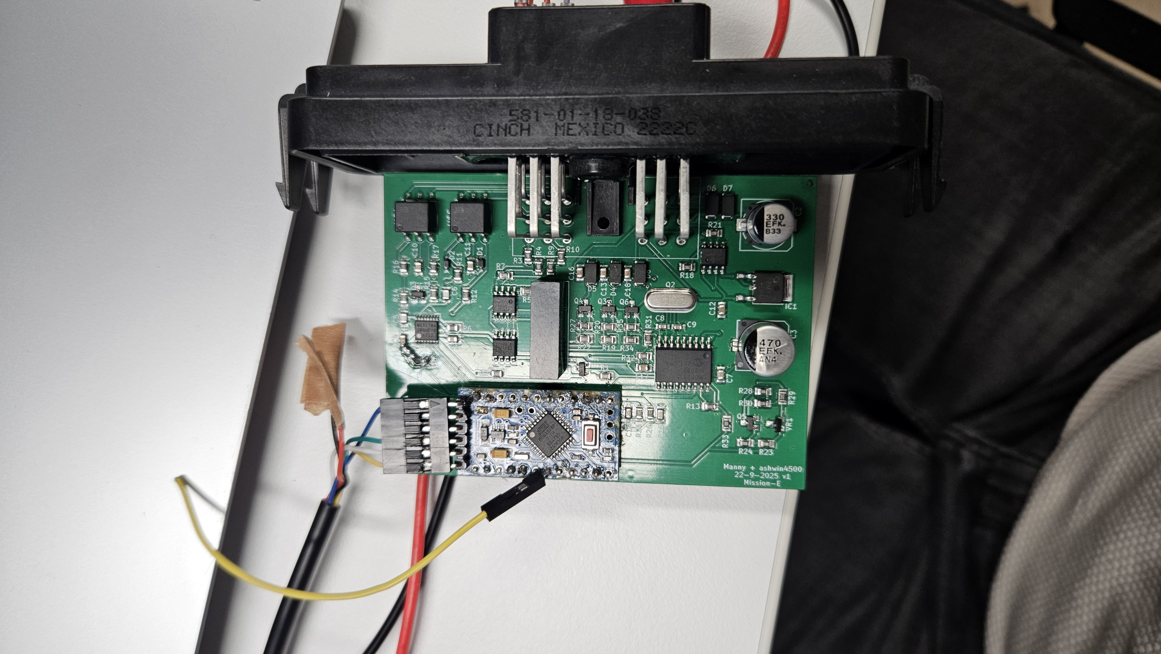

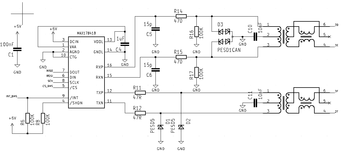

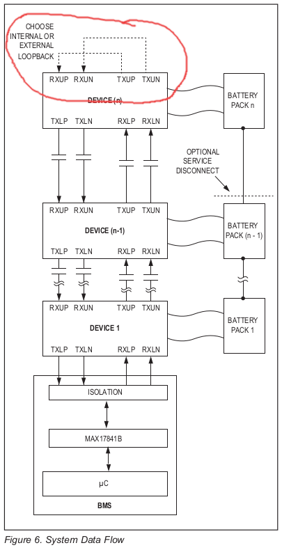

Thank you, I will look at my wiring for RX and TX. My test setup is only minimal with the BMS PCB, original harness wiring from the E-208 pack and the module self. PCB is powered at 5V with a DC power supply. (The same setup I ran the code on, nothing has changed)
Where did you get that figure from? Is it from the datasheet of the MAX17841B?
bexander
Posts: 897
Location: Gothenburg, Sweden
Has thanked: 78 times
Been thanked: 102 times
Re: Kia Niro BMS
Post by bexander »
If understand correctly you are using the original cables but only one slave module connected, without modifications to the cabling? That will result in no rx-tx top loop. You would need to to a loop-back where the next module where do be connected. Or connect all slave modules as per original wiring.
Or have you already made this modification and there is another error?
Yes, picture is from MAX17841B datasheet, page 9.

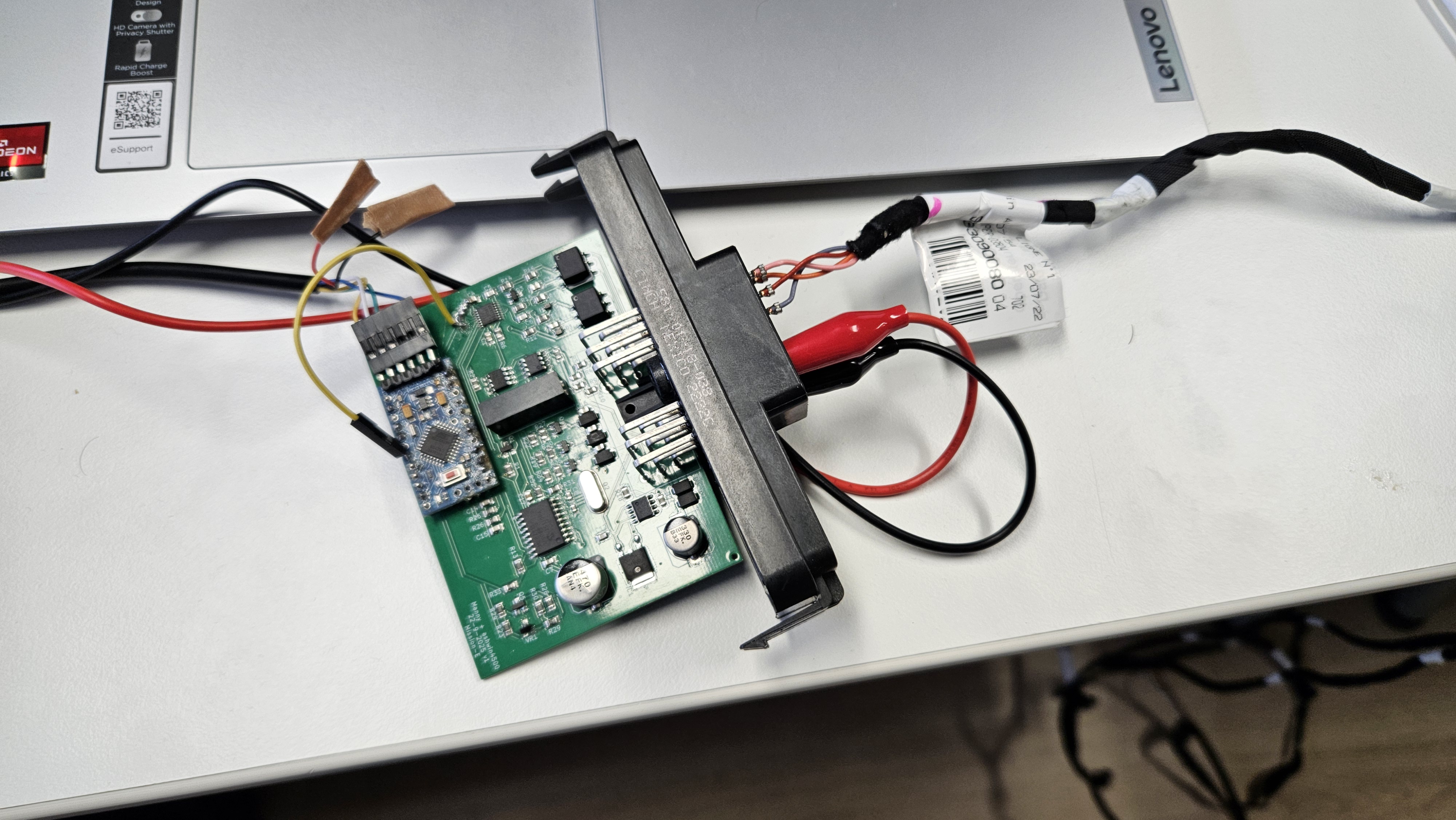

Is my circuit for the MAX17841B chip correct? On page 1 of this tread there was a PDF document linked by you named "BMS.pdf". And your circuit is different than mine. Im using Manny's PCB listed on page 5 of this tread. I did a loop-back as listed in the "CMC devices" document attached to a earlier post of mine, is that way correct? I still haven't got it working.
Im using all original OEM cables without modifications to the cabling.
manny
Posts: 195
Location: Netherlands
Has thanked: 58 times
Been thanked: 159 times
Re: Kia Niro BMS
Post by manny »
To use the code with one module you will need to change the number of modules in the code.
The wiring needs to be looped. If my notes are correct.
If you connect the module to the first connector on the chain. Than in the second connector you will need to link. pin 1 and 9 (white and green) and pin 2 and 7 (brown and yellow).
Good luck.

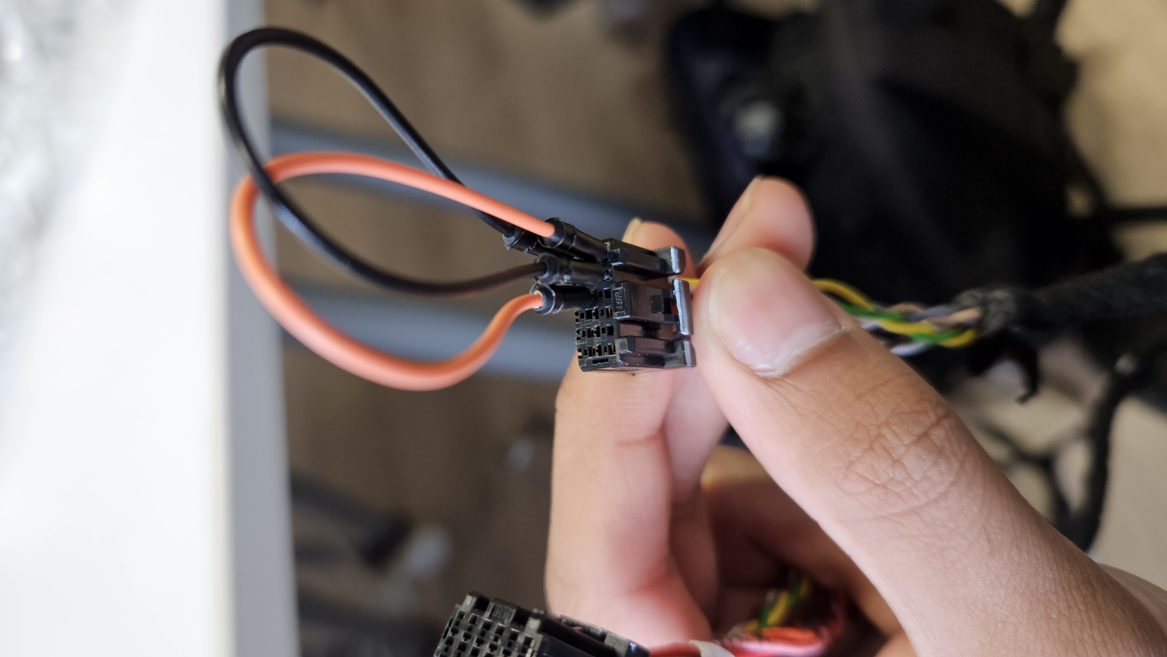

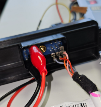

Post by bexander »
The BMS.pdf was my first attempt and is incorrect. A bit further down in the thread you will find BMS_5.pdf, that is what I use for all my bms:es. The difference is you use 10nF and I use 1nF to gnd on the center taps on the transformers. Also I use 1,5k where you use 470R on rx lines. Don't think this is the main concern right now.
How have you done the loop-back? Please take close-up pictures.
Also, is the pink wire broken or is it just a funny angle?
Broken wire.png (149.04 KiB) Viewed 2458 times
zuuus
Posts: 39
Joined: Wed Sep 10, 2025 9:27 am
Has thanked: 4 times
Re: Kia Niro BMS
Post by zuuus »

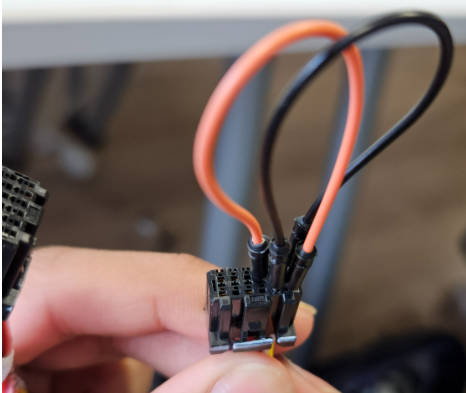

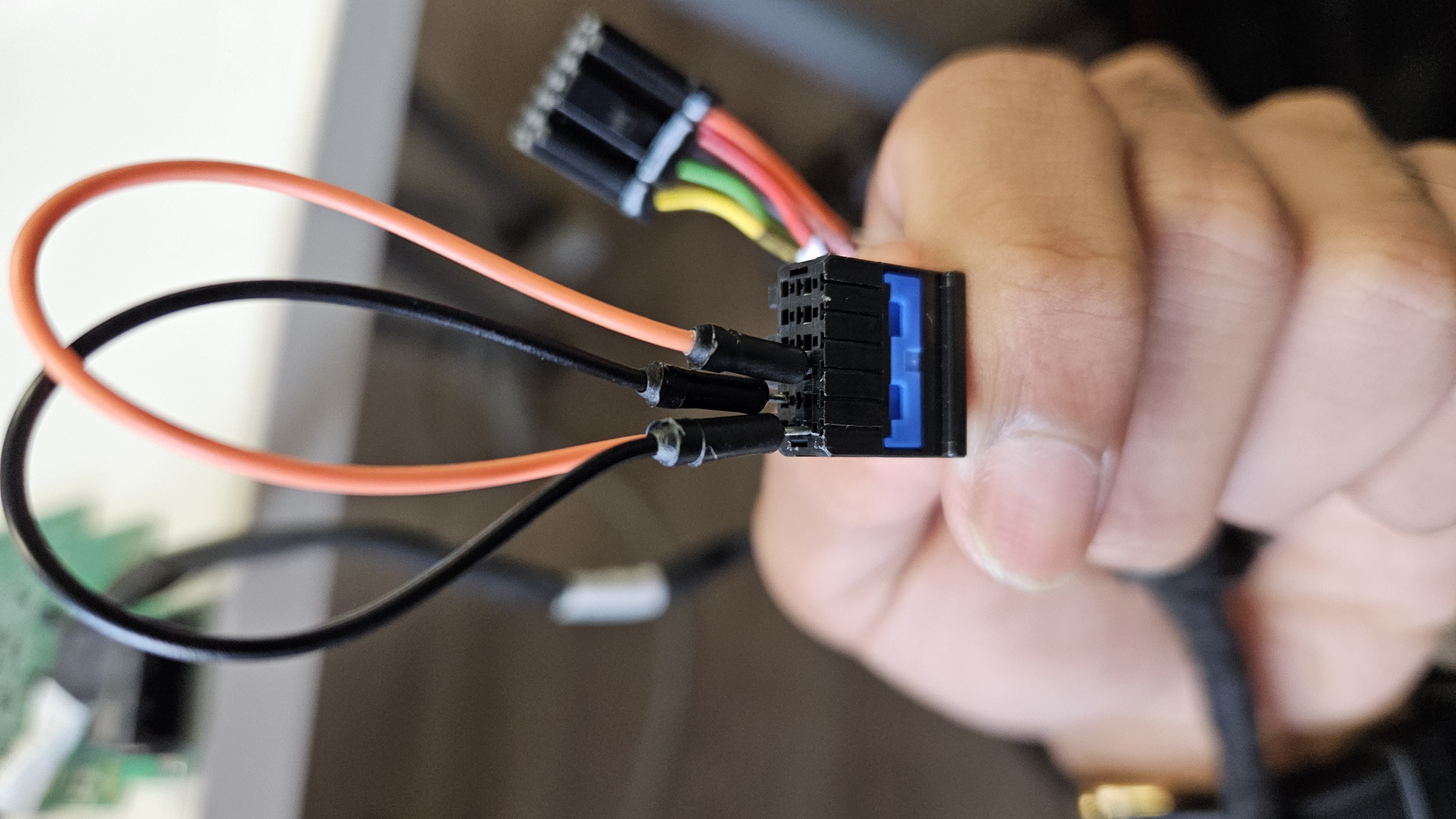

Yes I have done a loop-back and wired it to the BMS like Manny said, the pink wire is just at a funny angle
Ignore yellow wire on BMS PCB, that just for resetting MAX17841B chip
bexander
Posts: 897
Re: Kia Niro BMS
Post by bexander »
To me it looks like your pinout for the loop-back is wrong?
From the CMC documentation:
And looking at your loop-back:
Seem like loop-back is connected from pin1 to pin9 and pin2 to pin7?

manny
Posts: 195
Re: Kia Niro BMS
Post by manny »
It's hard to see, but are D1 and D2 the right way round?
the cathode (line side) should be on the side of the transformers.
and if you can scope the pins that connect to the transformers.
