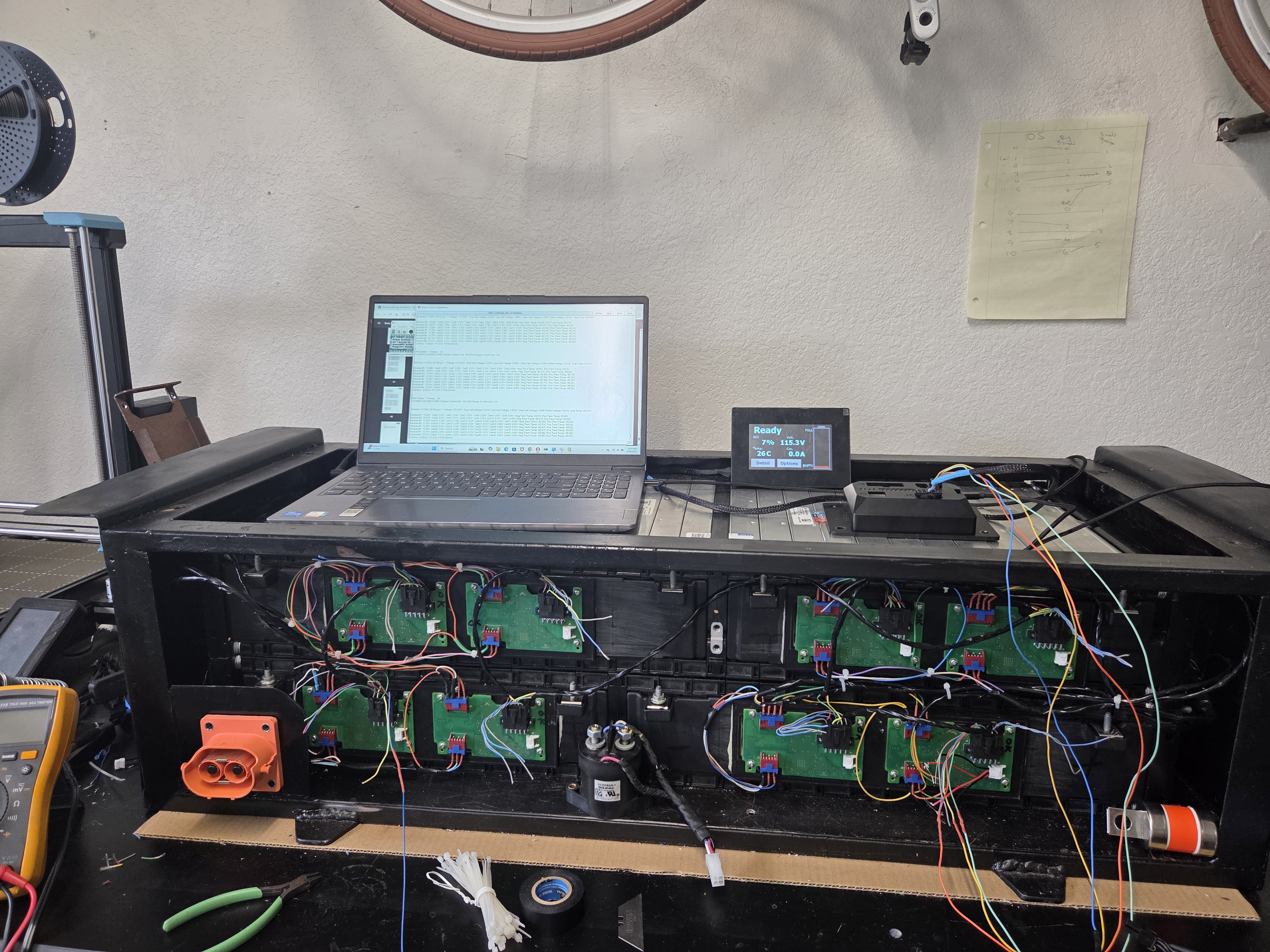

Re: [WIP] 1964 Scout LS600H conversion

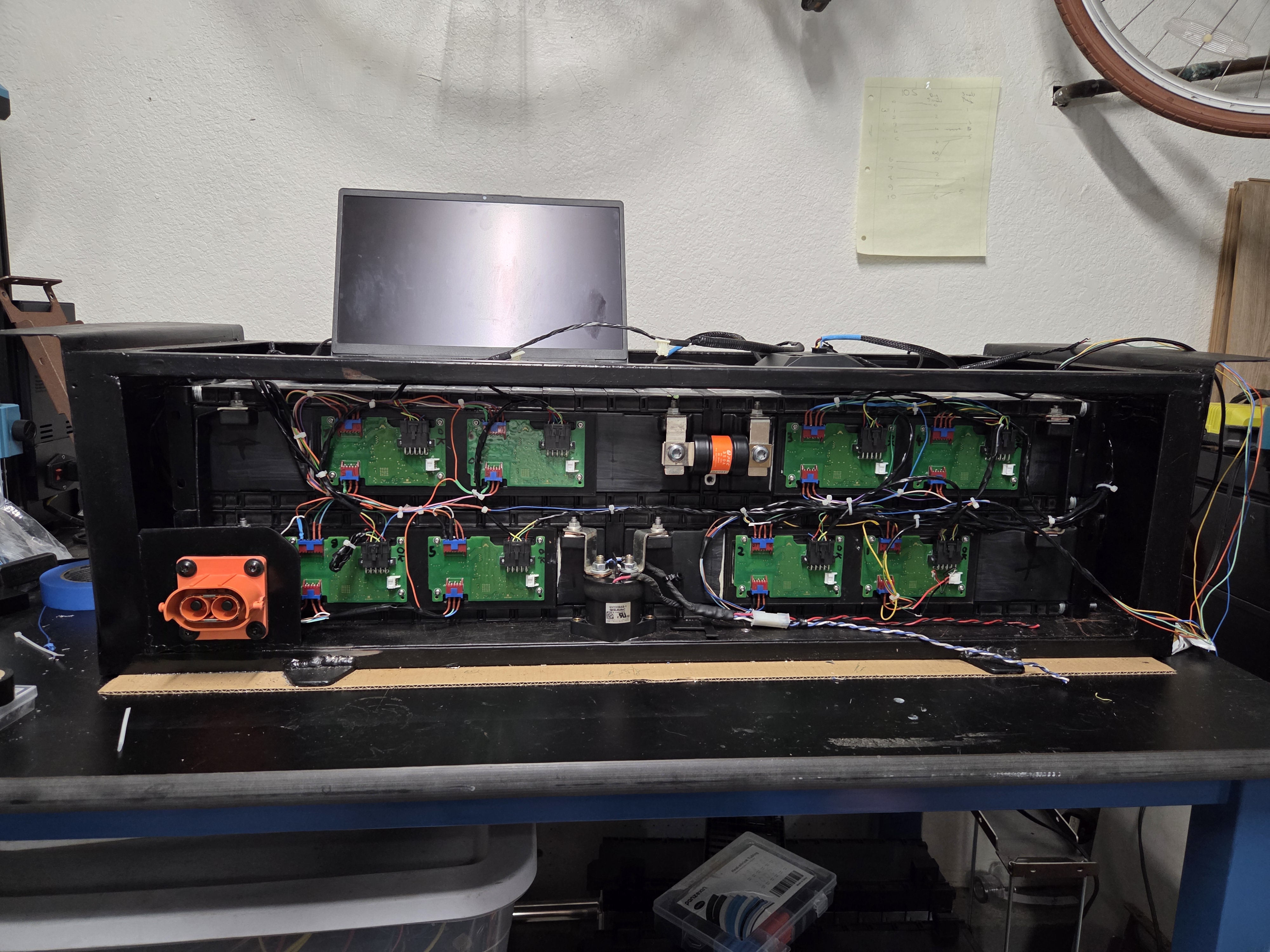

Making progress on the rear bench pack. Lots of wiring, slow going for me. All 8 bmb's now reporting correct voltages. I have a couple of thermistors reading temperature for now, will use the original Bolt temperature sensors which slide deep into the modules. I checked, and the Bolt sensors read pretty close to ambient temps.
On the HV side, current plan is to use a fuse mid row on the upper deck, and a contactor mid row on the lower deck (both between the left hand and right hand modules).
I have a nice run of HV cabling with connectors I got from a local friend who picked up some stuff from a EV company liquidation. It's 35mm^2. It's a smaller diameter than what I have been used to seeing on some builds, but I've seen differing opinions on what is needed. Modules will be connected (per picture) top left -top right-bottom right-bottom left
Welcome any feedback on the fuse & contactor configuration as well as the HV wire size before I get too far into these areas!

Getting close to finishing my rear bench seat battery pack a.k.a. 'the electric chair'. Added mid pack fuse and contactor, and was able to cut down and reuse bus-bar material from the original pack

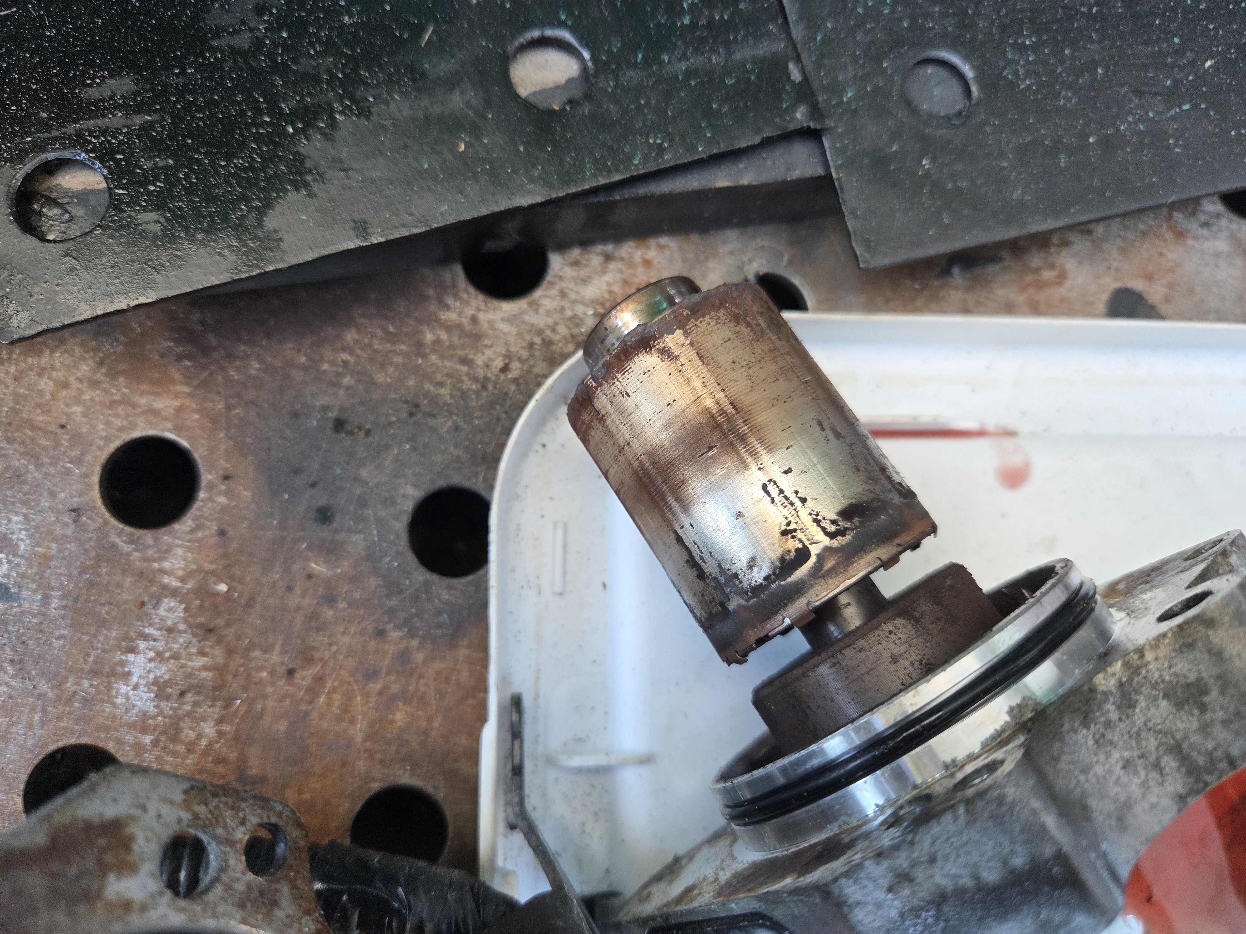

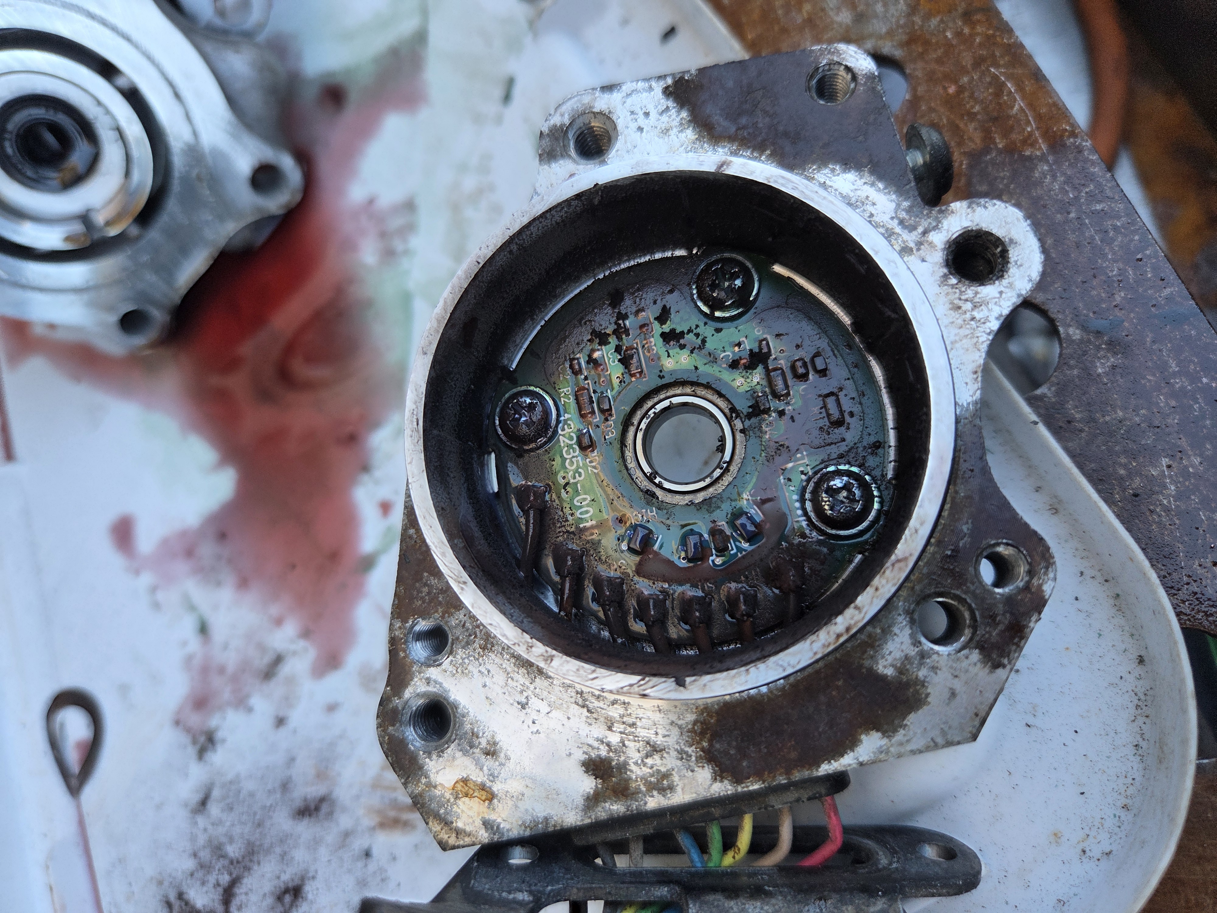

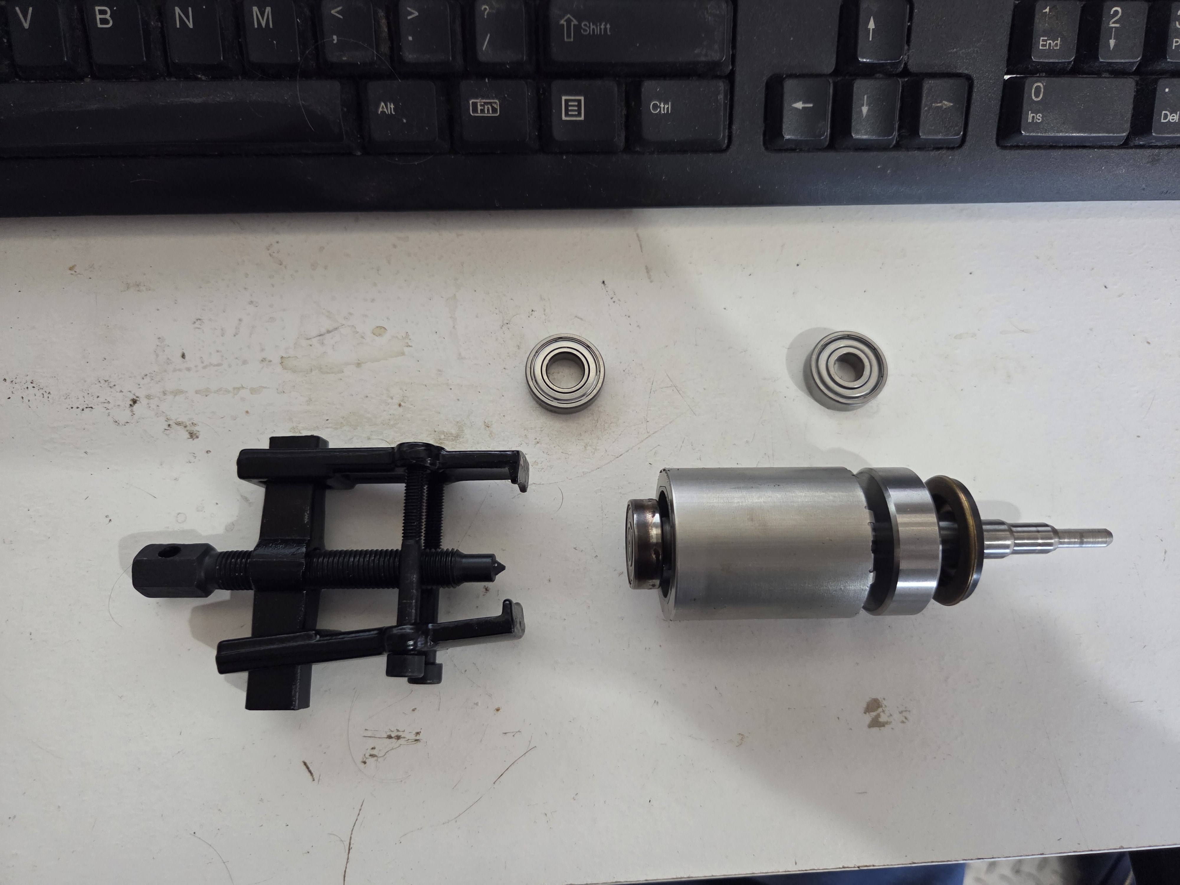

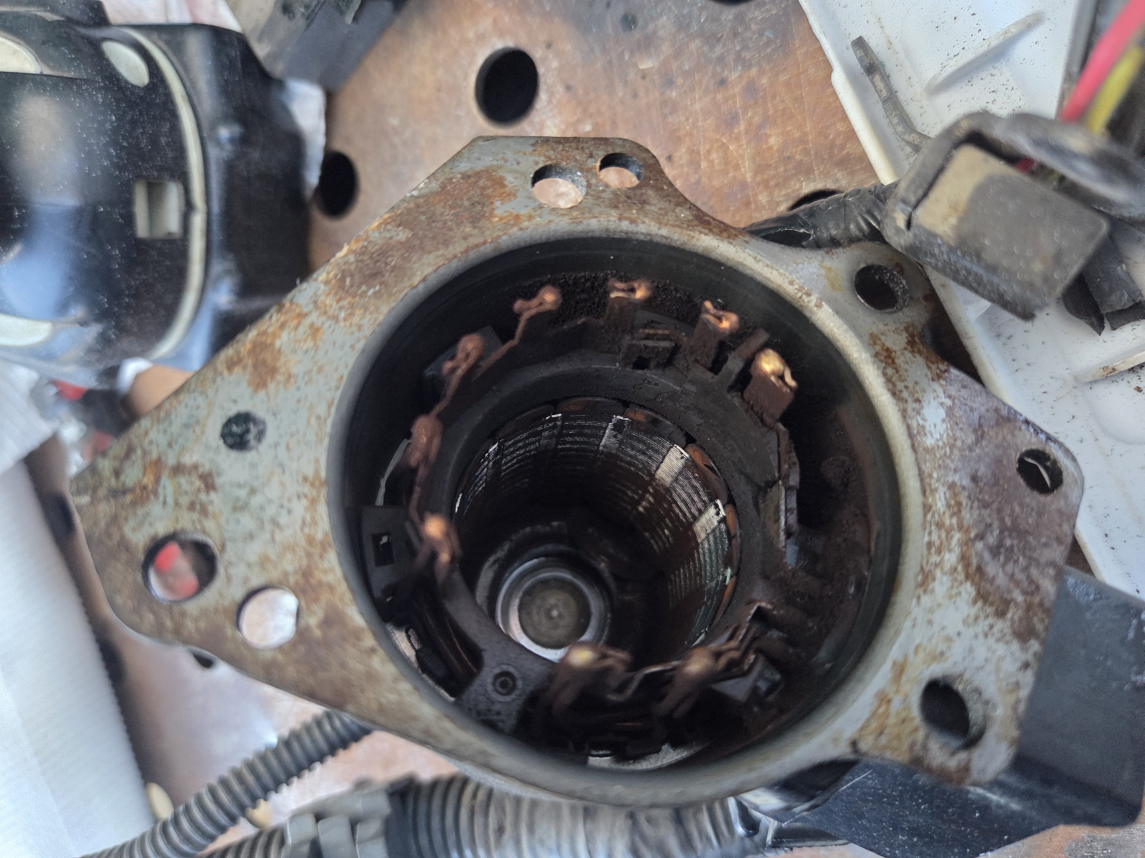

I haven't changed out my oil pump bearings, and it's really noisy, so decided it is time. I have a spare transmission, so started changing out its pump bearings in order to do a quick rotor swap over onto the Scout:
That pump was clearly in better condition than the Scout pump, and it didn't quite turn out to be a quick pump rotor swap
It's all cleaned up and back together. It's quieter, but not as quiet as I would have hoped. The intermittent metallic rattly sounds have gone, and now it's just more of a drone.

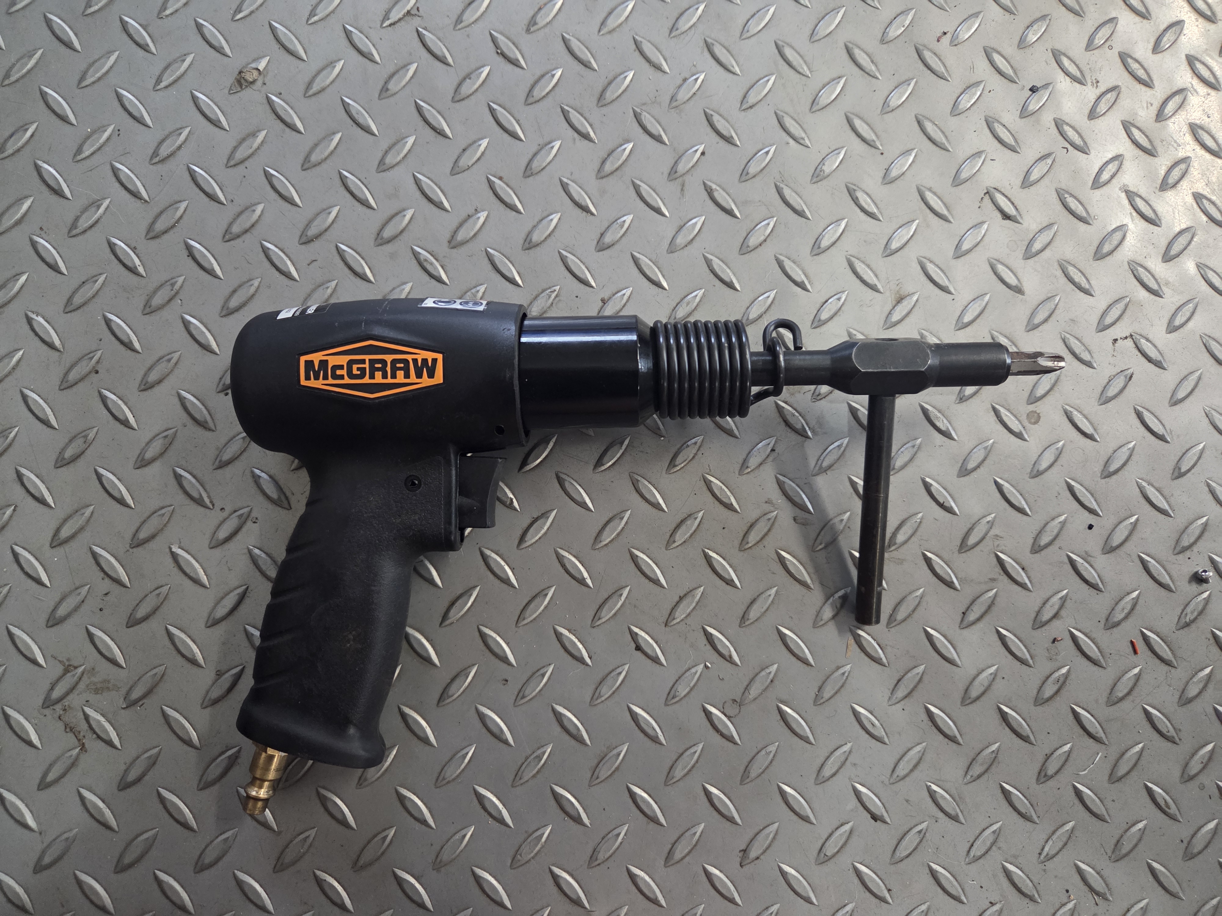

Started working on my doors - something I have been putting off for a long time. They are in really bad shape and I may need to look for a better set somewhere.
The hinges are frozen solid onto the doors with Phillips screws. I had to go all Scarface on them and 'say hello to my little friend'
Noisy, but very effective
